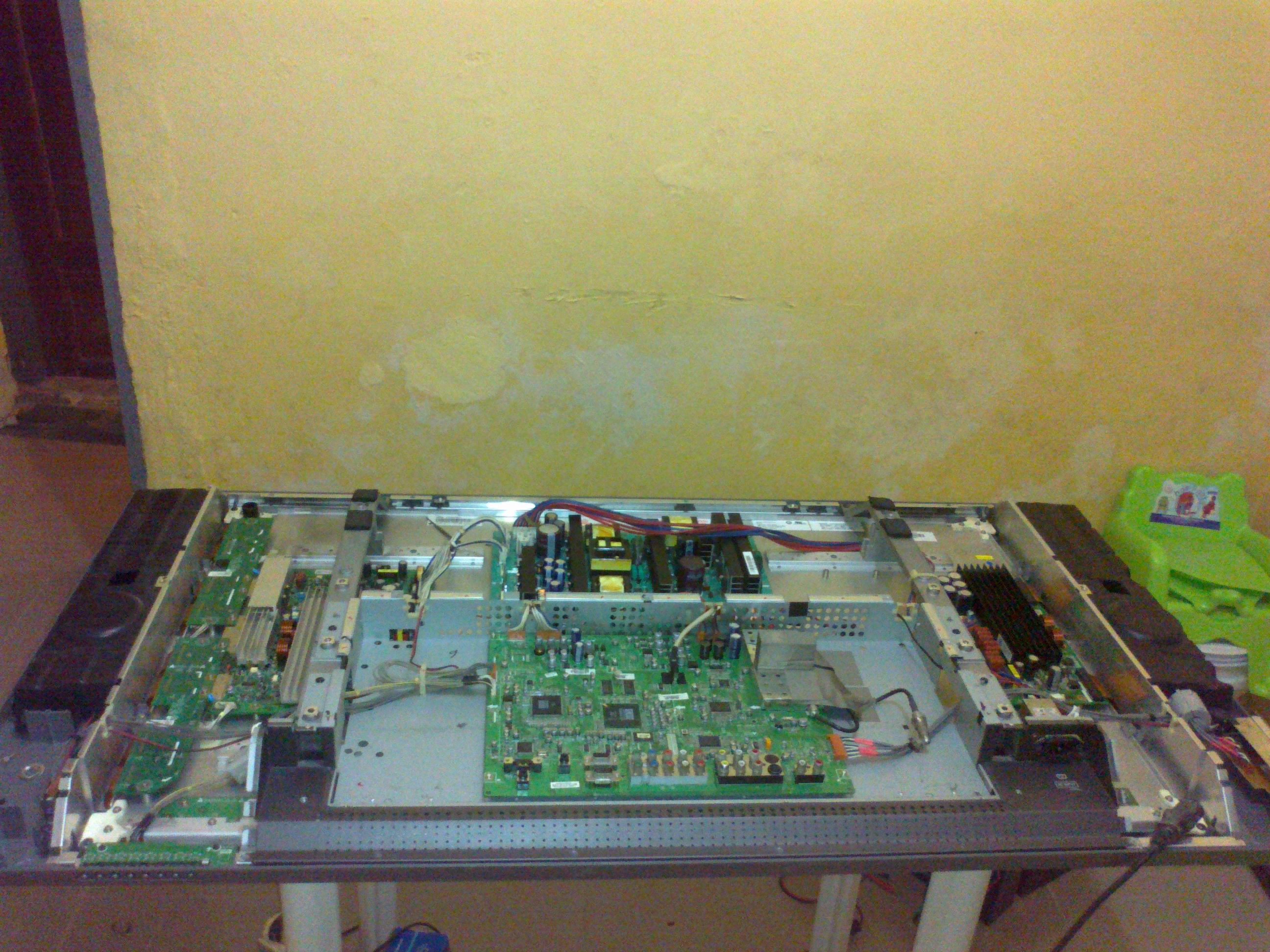

    Hello everyone, there is a Lg LCD 42PX4RV-TA i am working on, it powers up and produces sound when connected to cable but the screen is black, no picture or even backlight. Can anyone please help?

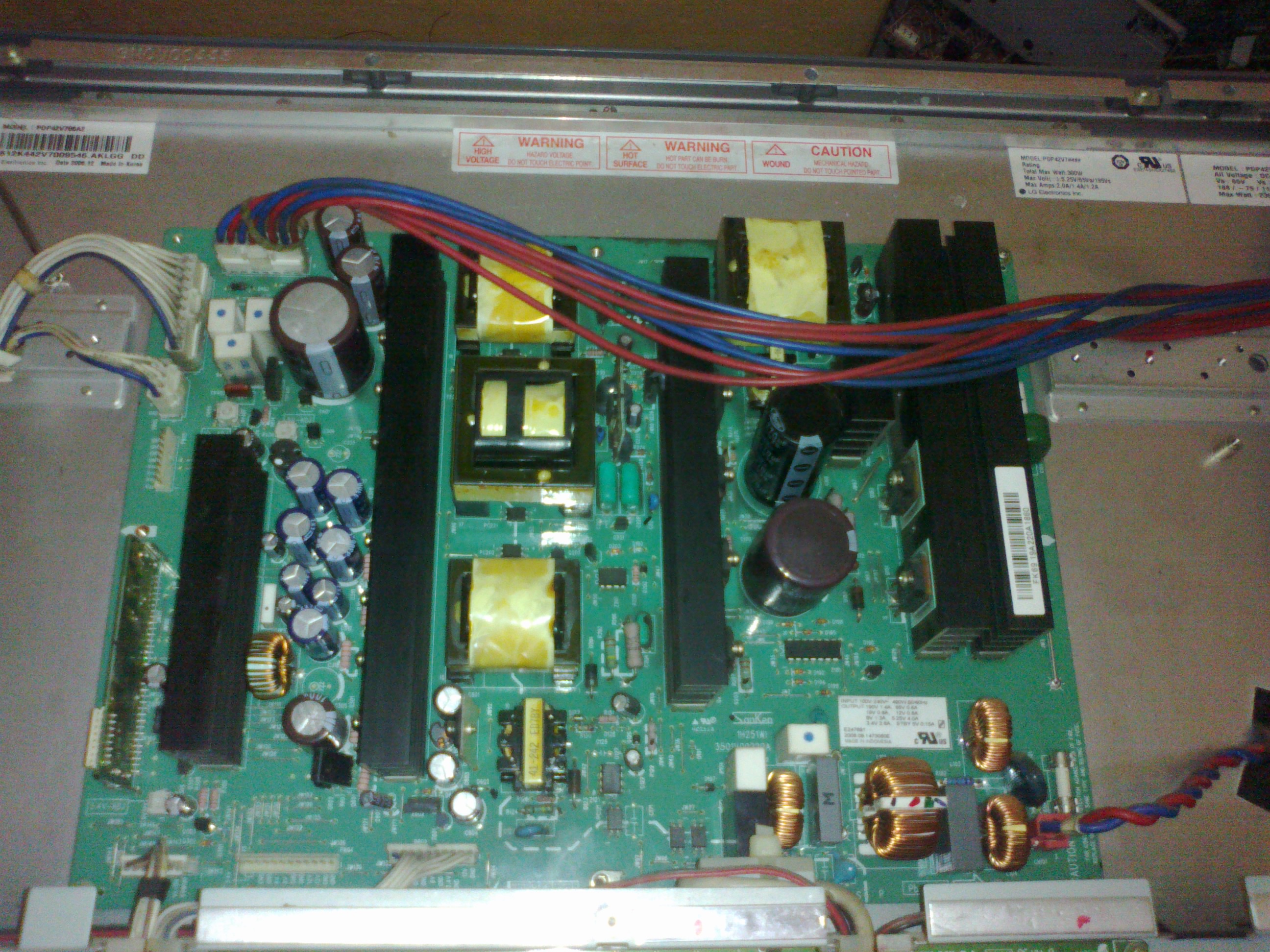

    Pics of boards... one of each board, one of entire back of set so we can see all boards together... and pics of any silk print next to any connectors on the PSU

      Re: LG 42PX4RV-TA, Black screen but sound ok
      Thanks a lot Newtothis for noticing my thread, i was wondering.
      Please, here are the pics;

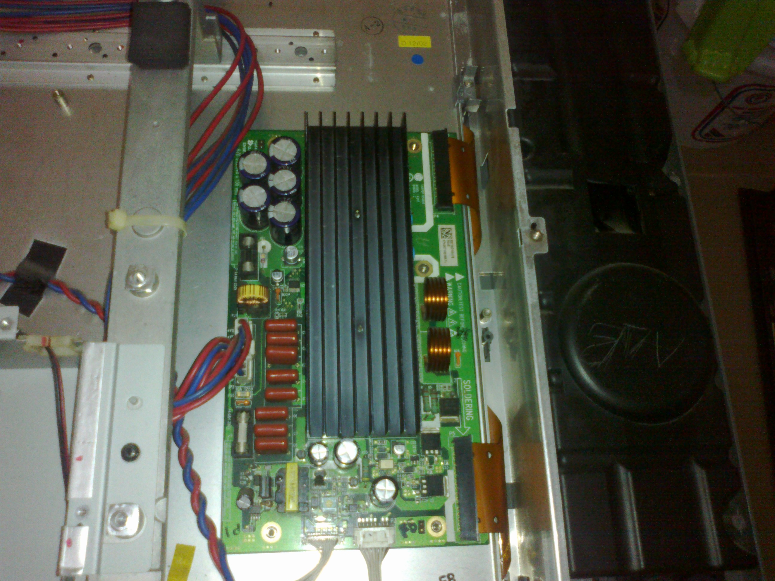

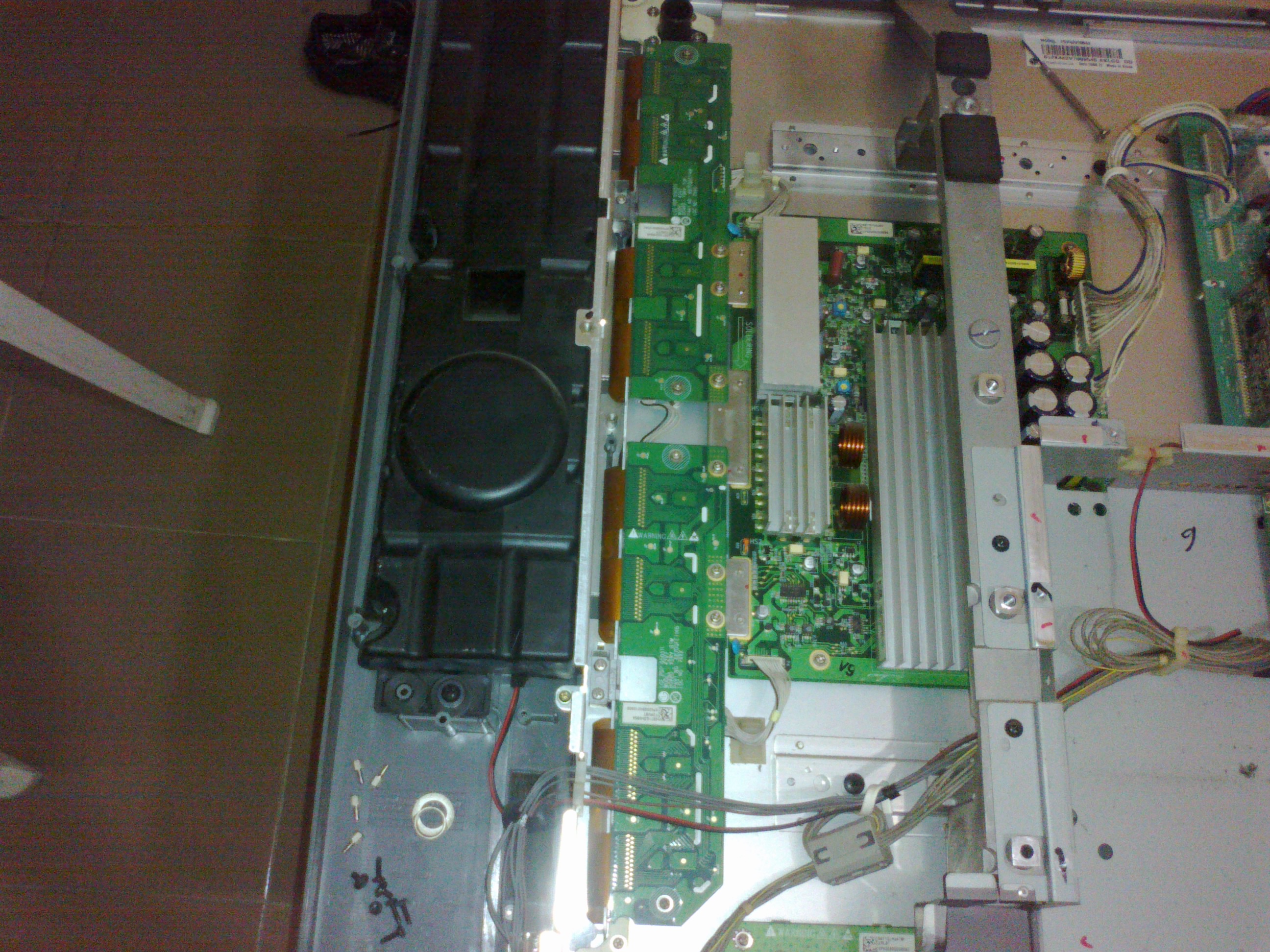

              The boards to the left and right of the power supply are your sustain boards (the ones with the large heatsinks on them). Chances are, the one on the left, the Y-sustain, has gone out. Do you have a digital multi meter? If so, check the fuses on that board. It wouldn't hurt to check the fuses on the board on the right as well.

                Thank you! I have checked all the fuses in both the Y-sustain and Z-sustain and they are good.
                  Do you have good Vs, Va voltages going to your Z- and Y-sustain boards? Compare to the plasma panel label.

                      Also monitor the heat coming off the heat syncs on the far right and left boards. One of them warm and one cool? Both should be warm after 10 minutes or so of operation. A bad buffer board can blank out the picture. But yes check voltages first.

                        Plasma panel board board indicates Va=65v, Vs=188 while my meter reads Va=67v, Vs=190v. All heat sinks in both the Z-sustain and Y-sustain boards are warm few minutes of operation.
                          Those voltages are good. Now turn out all the lights in the room and close curtains. Can you see a glow emitted from the screen?

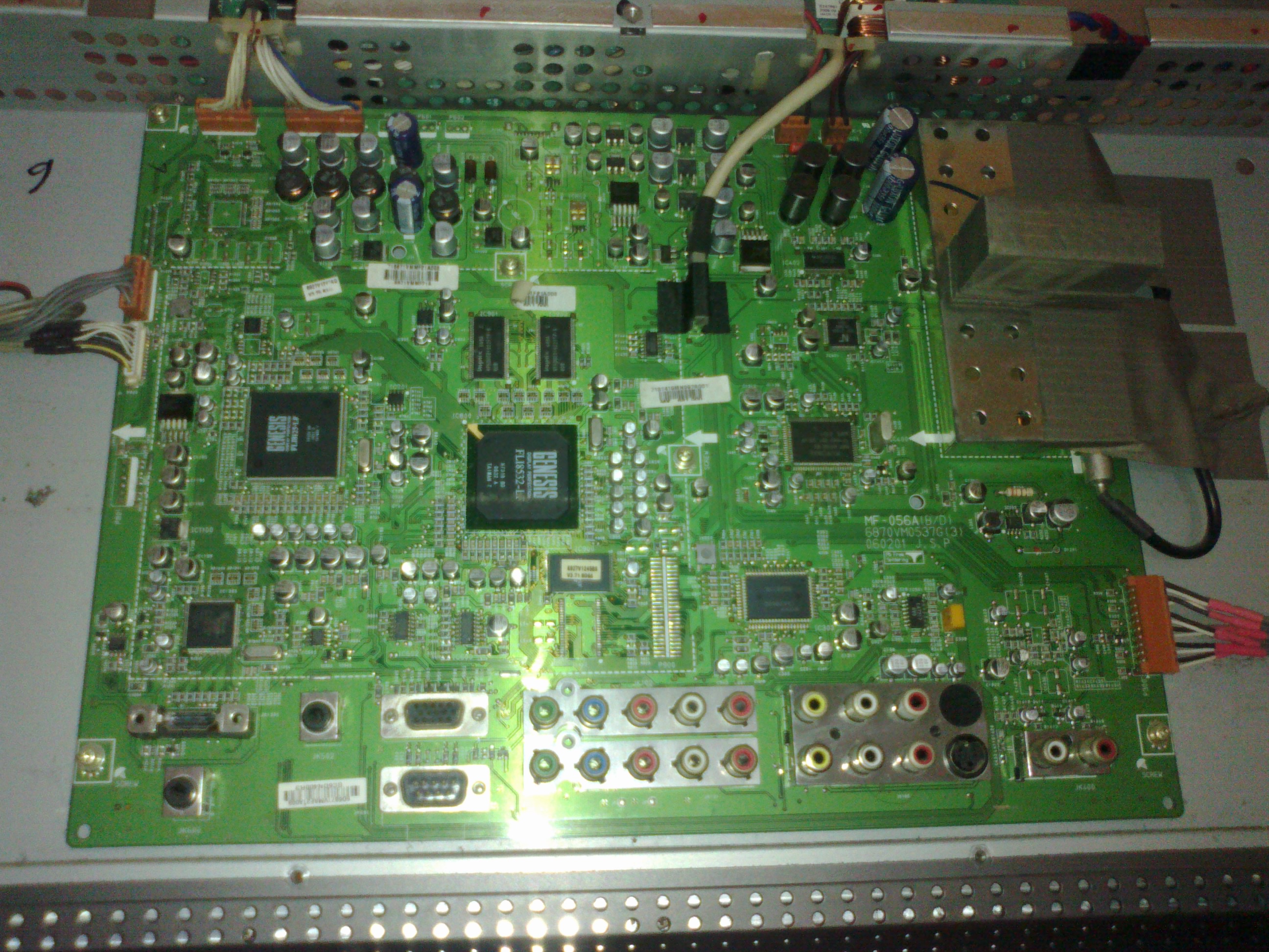

                                      If you do not have any panel glow then the fault may be on the control board, which is underneath the main video board (which has the A/V inputs and TV tuner.)
