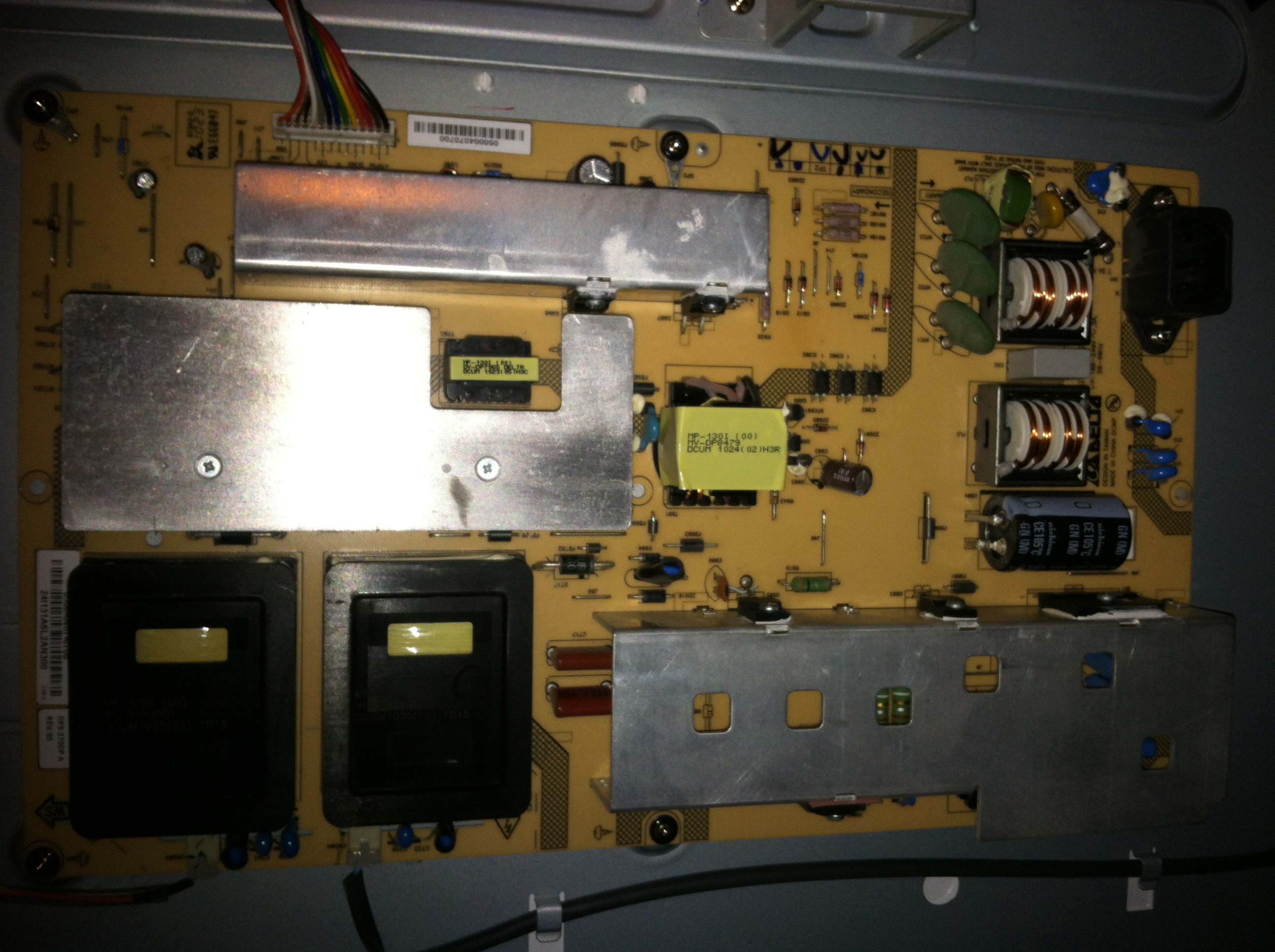

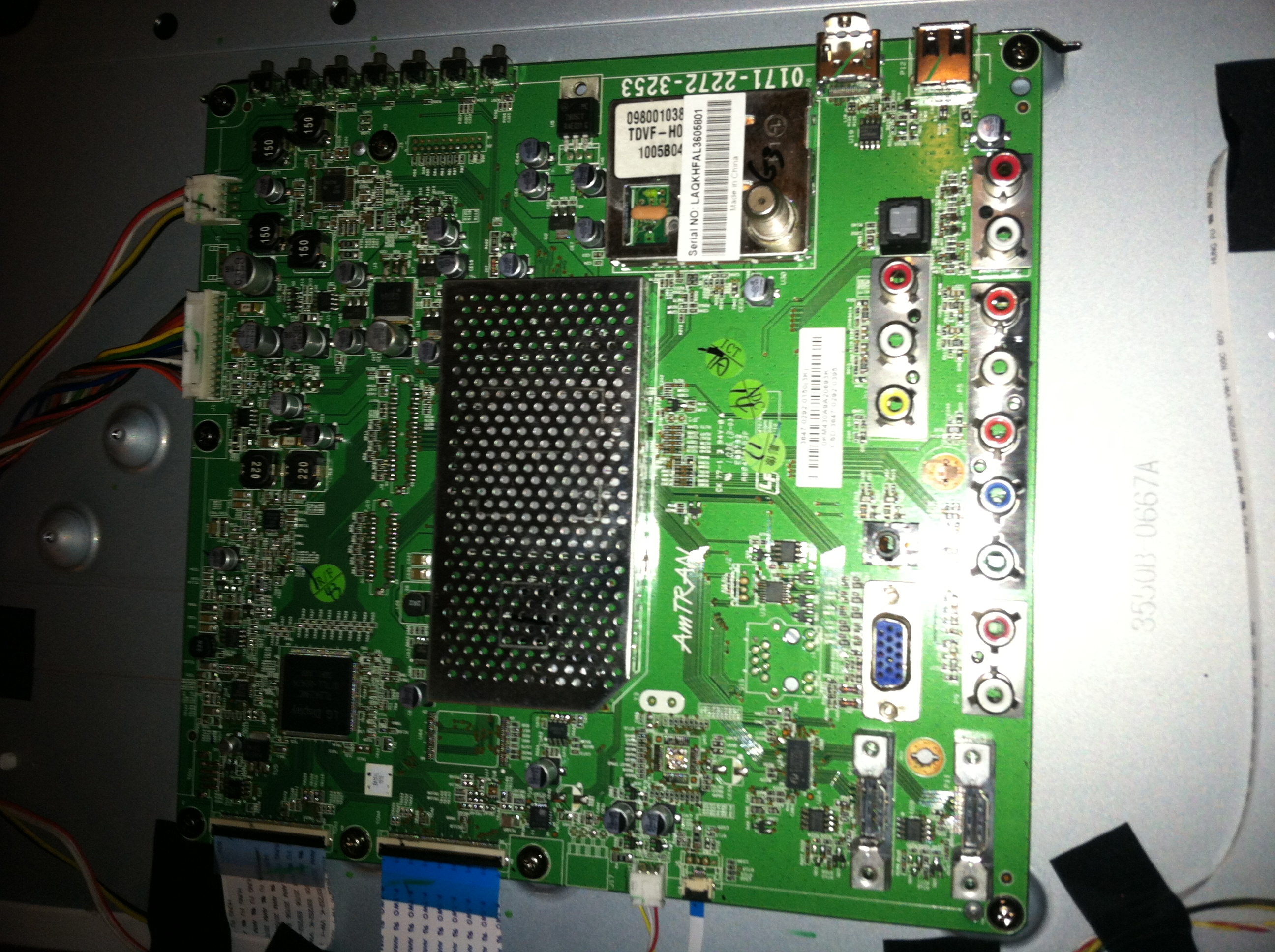

    I've been suspicious of the main board (perhaps misguided) which is why I attacked it first. At this point I need to know where to go from here. Any help would be huge!!
    Pics of my main and power board are attached.

        Re: Visio E470VL - Has Power, Wont Turn On
        Your reported regulator output are normal (add 1.25v to pin 1 = expected output on pin 2 within 2%)
        U33 (4953GM) is the dual MOSFET, it looks like it does not getting any GATE control voltages.

                  The Gate control voltages probably are from the microcontroller of the main board, it will be tough to trace out the connections.
                  U8 is the 78XXX series, this one is 5V regulator, middle pin/tab is the Ground pin, Left pin is the input, right pin is the output, it is OK.

                            It is for in-rush current limiter when the TV is first getting power to the power supply.
                            http://www.ametherm.com/inrush-current/
