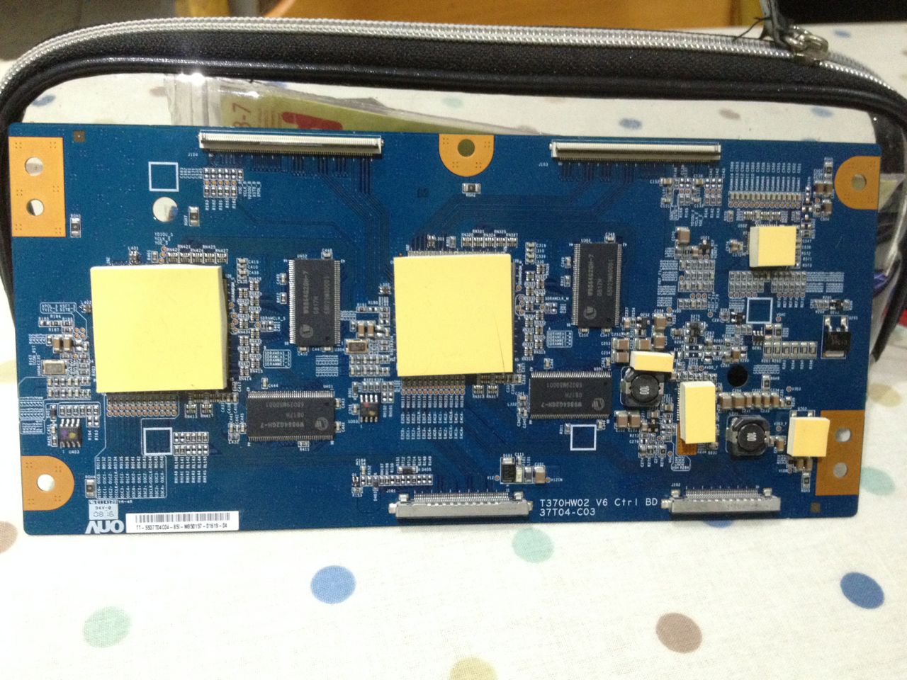

      Thanks for speedy response. Here is one of the TCON, but I'll get the others ASAP, may not be until Tue though as work rather inconveniently gets in my way!

        Sorry about the dreadful quality photo - I'll redo that too if needed. The VGAMAs are in the top right, 1-14.
          Re: Fault with Samsung LE37A656A1FXXU
          The IC on the top right of the board is the Gamma Voltage ref IC, can you remove the thermal transfer pad and see if it has AS15 printed on top?
          AUOPTO tends to have the bad AS15 Gamma IC.

            The chip is AS15. What's my next move, check the voltages at the VGAMA points? Swap the board?

              Trying to help out, considering the immense help I've received here. If you scroll towards the bottom of my post:
              https://www.badcaps.net/forum/showthread.php?t=33405
              You'll see some discussions about identifying that AS15 chip as bad via measuring the gamma voltages. What mine look like (bad) and what they should look like.
                Replace the IC, you will need SMD hotair work station or replace the board.

                  Looks a bit challenging to change the IC with no experience, but might give it a to as nothing to lose. Better check the voltages first though.

                            Just reconnected the board - voltages all over the place. I only connected it by the board-board leads and din not bother with the ribbons - will that affect the readings. Th reason I did not connect them is that the cables are glued to the metal cover which means if I connect them access to the board is severely restricted for testing.
                            VOltages:
                            1 - 6.84
                            2 - 12.16
                            3 - 7.28
                            4 - 0.04
                            5 - 7.04
                            6 - 7.29
                            7 - 7.29
                            8 - 6.51
                            9 - 6.43
                            10 - 4.74
                            11 - 4.48
                            12 - 3.93
                            13 - 0.31
                            14 - 0.21
                            • markhambly

                              Just a quick note to say that I ordered a new board on ebay and now TV works perfectly.
                              Thanks for all the advice guys.
                                As a note for future users yes those voltages are very bad, and you can leave the connectors disconnected. Thanks for repair feedback.
