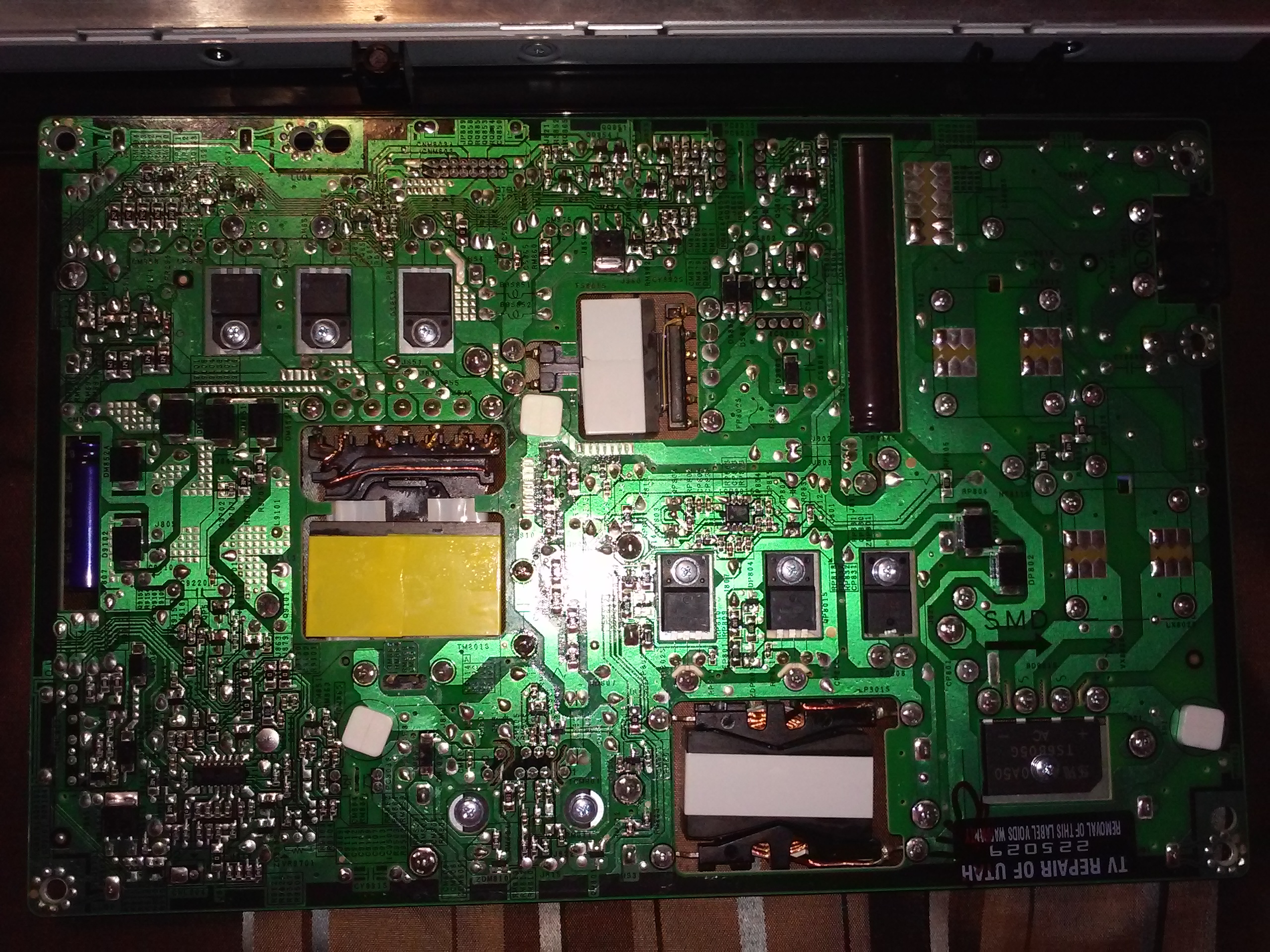

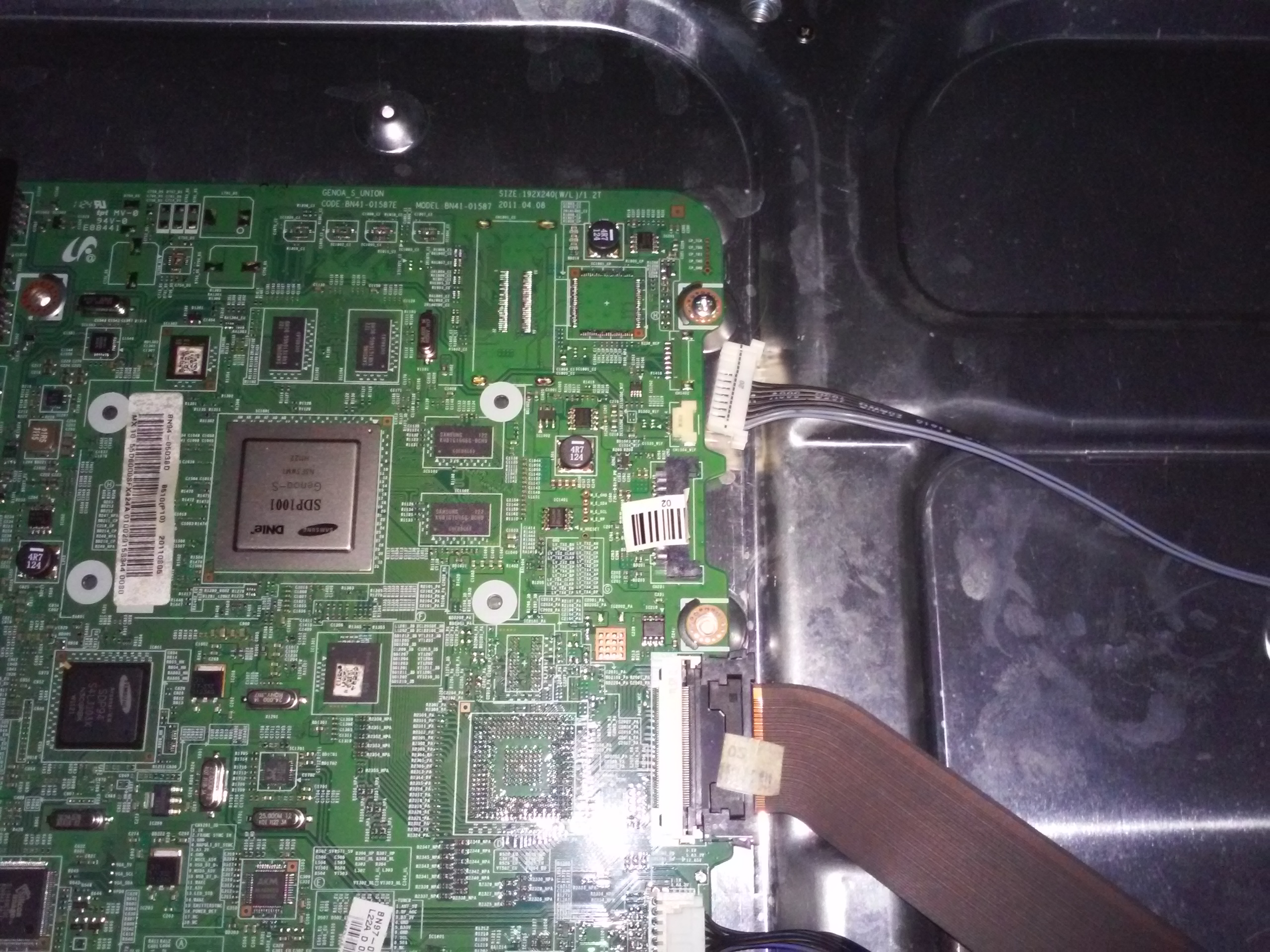

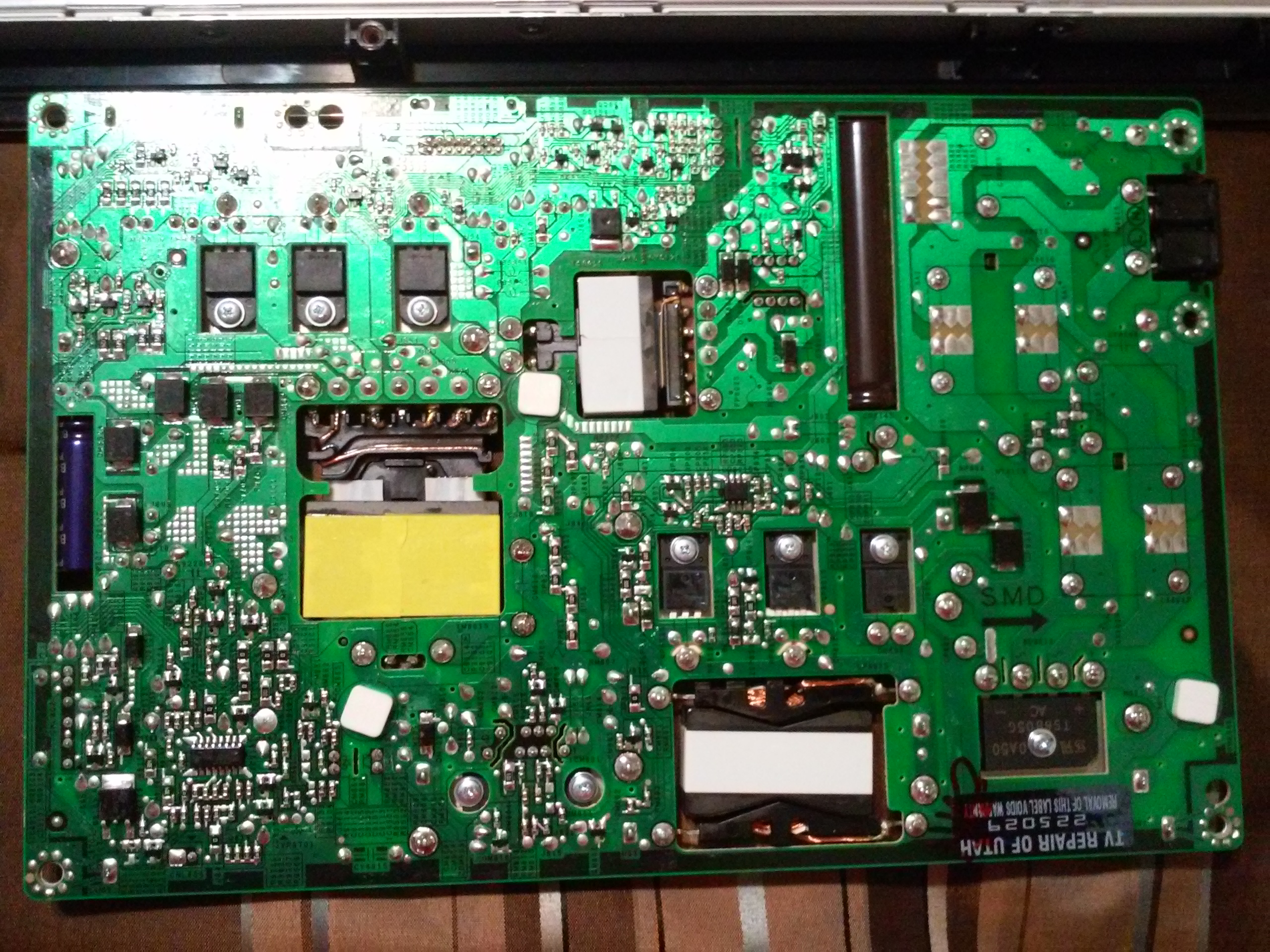

    I have tried everything I can and TV model UN46D6050TXFZA is really getting on my nerves. Like I have mentioned before, I purchased that TV and there was sound, but no picture. Luckily I purchased a broken screen TV that came with the same mainboard and t-con, the only different part was the power supply. I changed mainboard and t-con, nothing, I used one and one, nothing. I purchased a power supply online, and nothing. The smart logo is not visible, never visible, there is sound, but no picture. When you change channels, you can see the lights on the back of the screen change, and the sounds comes back again pertaining to the channel, but no picture.
    I have changed all the electronics parts, mainboard, power supply board and t-con with no luck.
    I remember I fix a 32" TV, thread here by following member Wizard steps. I found the diode online, replaced it and the TV worked.
    Perhaps TV UN46D6050TFXZA has a diode somewhere that its not working?
    Someone with more knowledge than me, perhaps can gimme a hand.
    Thanks a lot

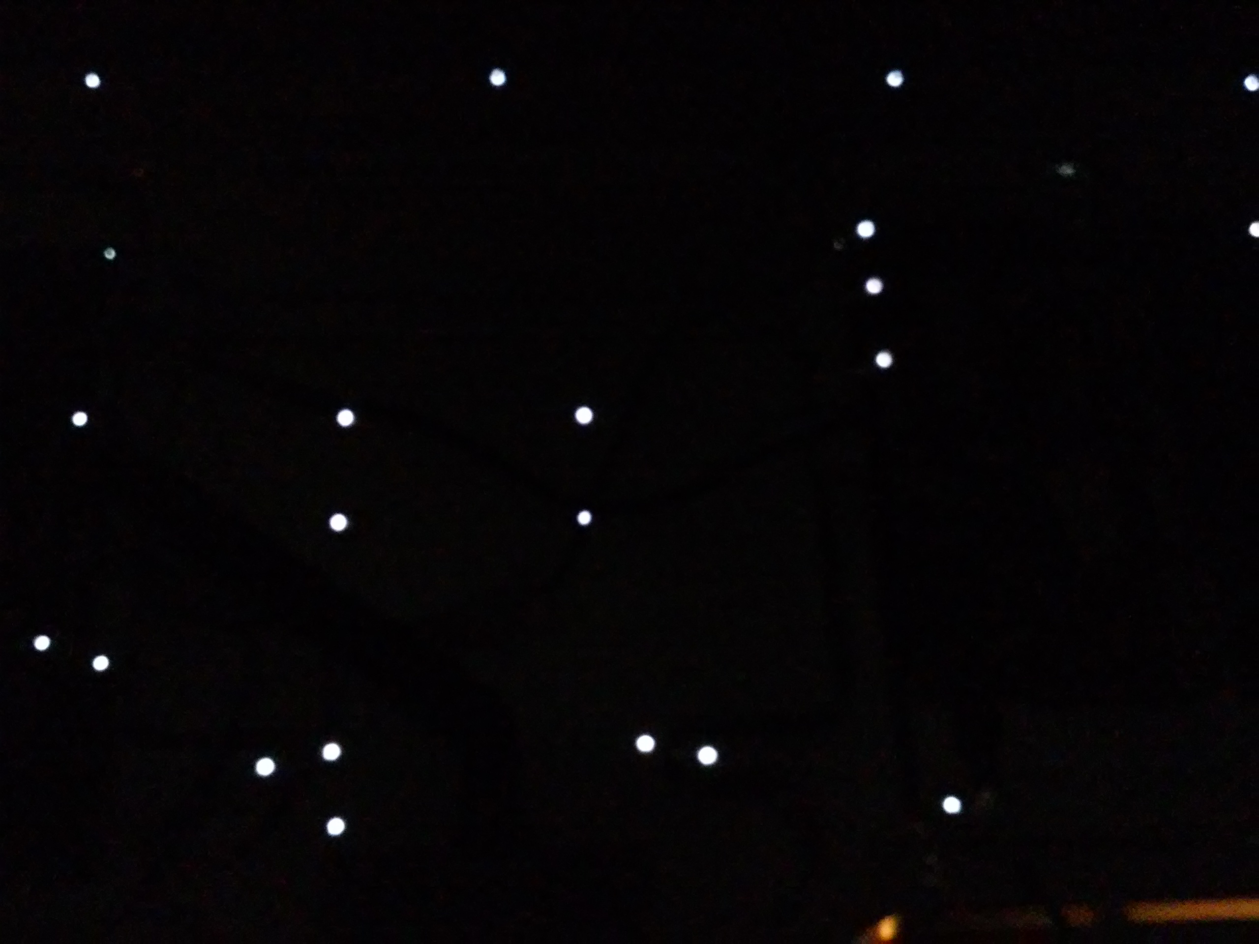

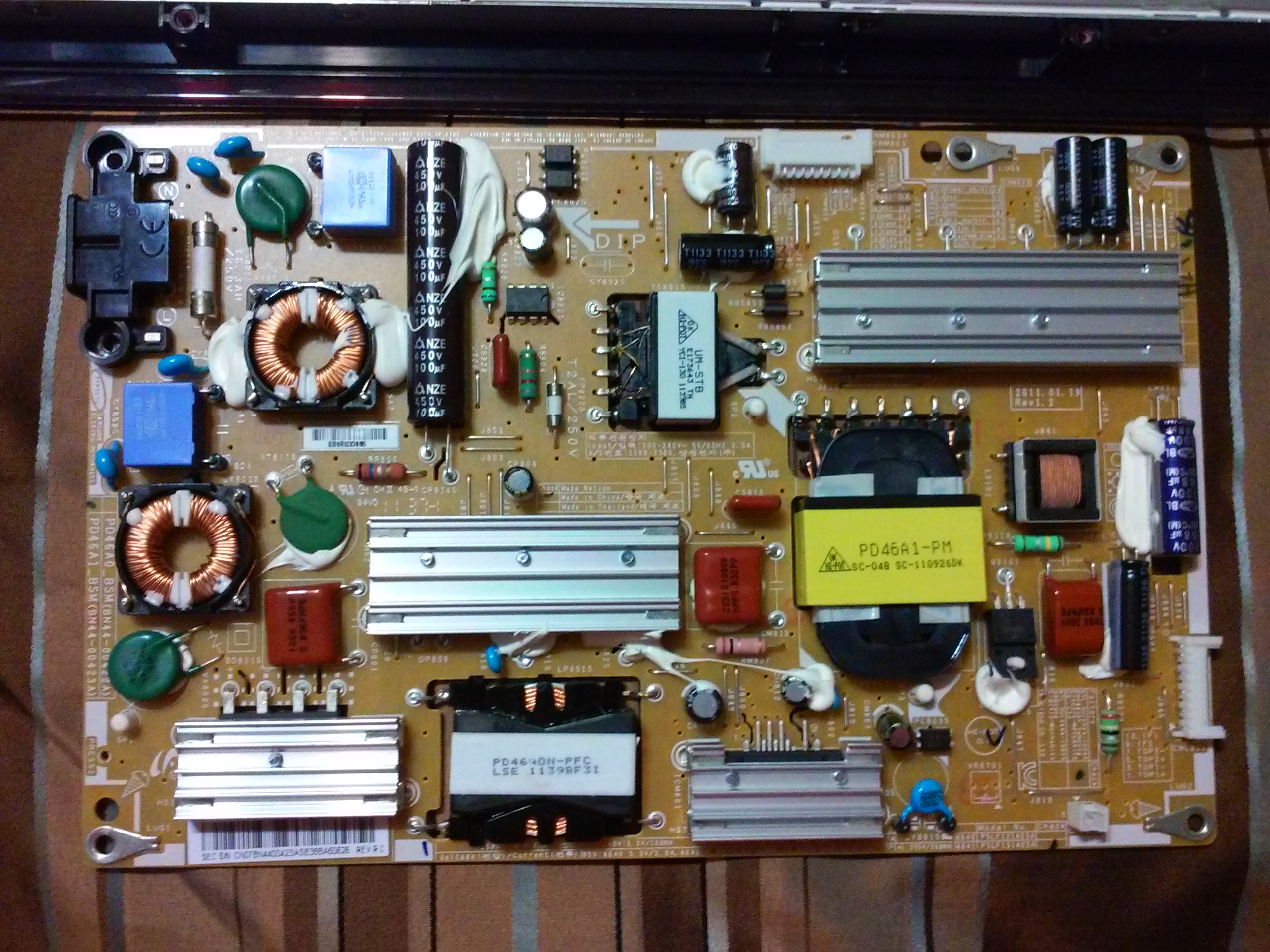

              Ok, I removed a flex cable from the t-con, nothing. I removed the other flex cable side, nothing.
              I shined a flashlight to the screen, I do not see anything, its completely black.

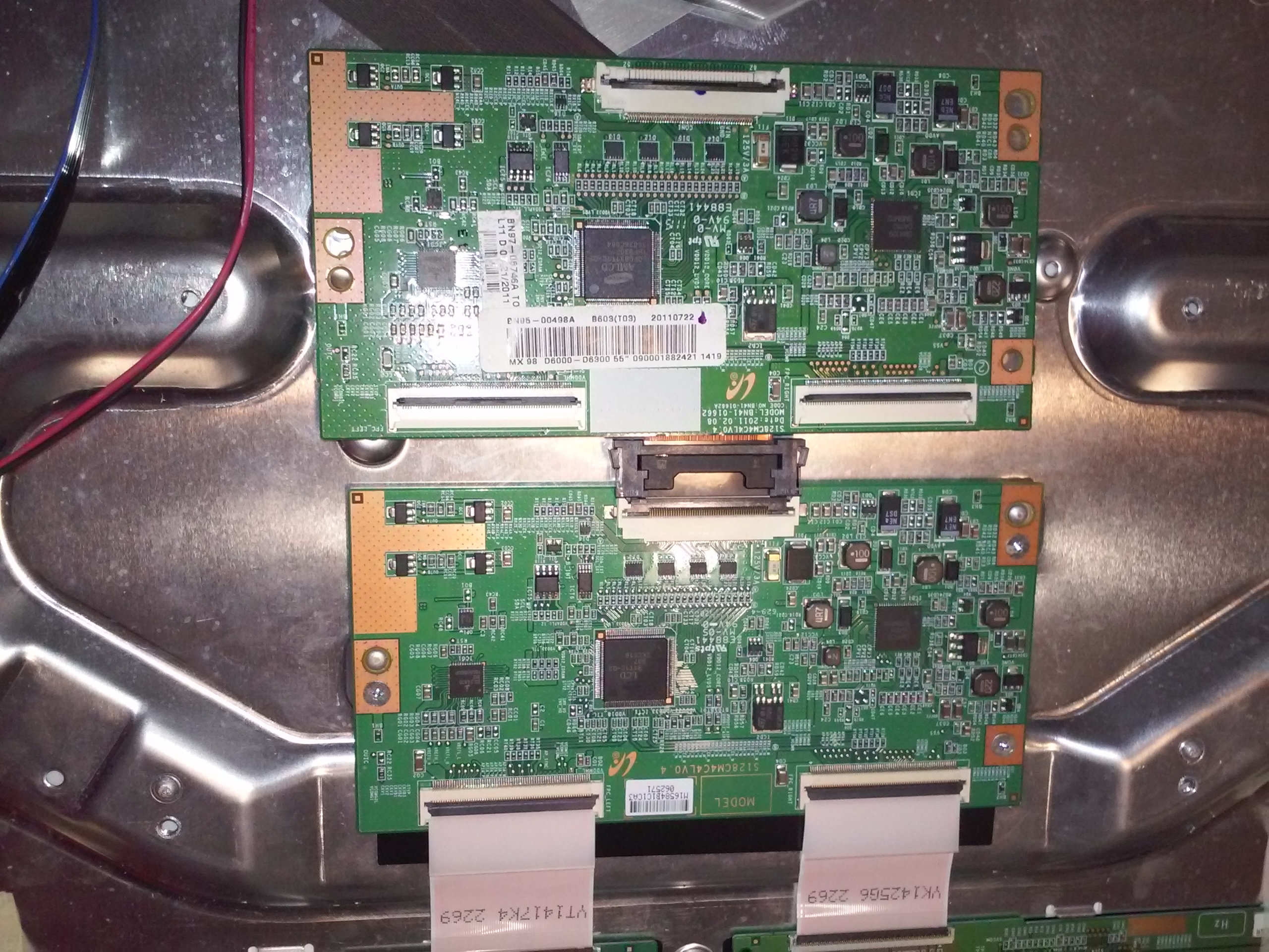

              I did see that post #3 from tom66 he mentions about a fuse on the t-con. I checked continuity on both of the t-con boards I have and they are fine, but when I measure voltage while the TV was ON, I did not get any readings. Can someone confirm if I'm suppose to be getting any reading? According to the fuse info displayed on the t-con it shows 125v / 3a.
              Also, can someone gimme a hand how to test the transistors?
              I'm attaching four pictures. One showing the two t-cons I have and the other 2 pics (one with flash / one without) is the back of the power supply I got online which it gives me all the correct readings I have done (not including transistors), and front of the power supply.
                Re: samsung UN46D6050 sound but no picture
                You should get usually 12V both ends, can you try checking both ends of the fuse to ground on the resistance range, you are looking for a short (use 200 ohm range if you have a manually ranging meter)
                • rlega
                  • Jan 2014
                  • 93
                  I got 12v reading on both t-cons.
                  So my question is this, eventhough I see the backlight turning ON when I turn on the TV, and when I change channels, what else gives light to the screen?
                  If its the backlight, how come I see it ON?
                  With the TV on standby, I disconnected the cable that goes from power supply board to the mainboard and the backlight came on.
                  As you can see, I'm trying not to give up on this TV until I have no other test to perform.

                      If you removed one of the ribbon cables coming from the T-Con to the LCD panel, with the lvds cable from the main board plugged in and the screen stays black, that sounds like the LCD is bad. Maybe you could borrow an oscilloscope and check the main board for video to narrow it down some more?

                              @CapLeaker - Yes, the screen stayed black. I used a flashlight, and nothing is displayed on the screen.

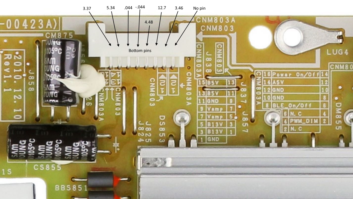

                                      #38

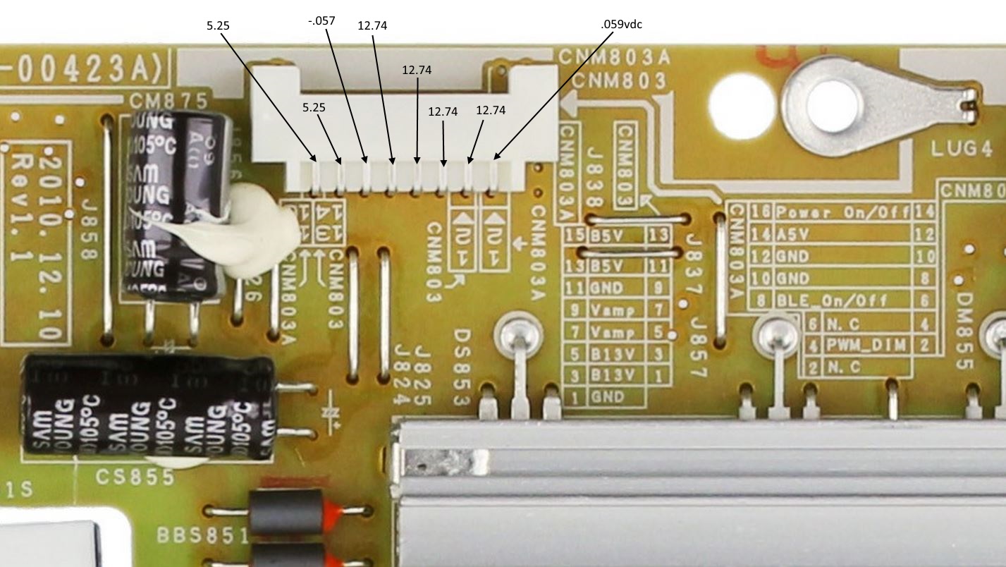

                                      I took some voltage readings. I hope you guys understand it. I do not understand the legend on the power supply board. Perhaps someone can let me know if the readings are OK.
                                        #39
                                        OK, it uses CN803A (16 pins connector, CN803 is 14 pins connector),
                                        All the pins that you labeled are the ODD number pins, 1, 3, 5, 7, 9, 11, 13, 15.
                                        So according to the chart for the ODD number pins, the Voltages look OK,
                                        You cannot get to the EVEN number pins, you have to probe on the bottom side of the board, there is Voltages chart for the EVEN number of the CN803A.
                                        • rlega
                                          • Jan 2014
                                          • 93
                                          #40
                                          Thanks budm,
                                          The bottom pins voltage are as follow. I inserted my digital voltmeter point lead on the white connector while the TV was on and that's how I got the even pins volatges.
                                          That's what I understood from your reply.
