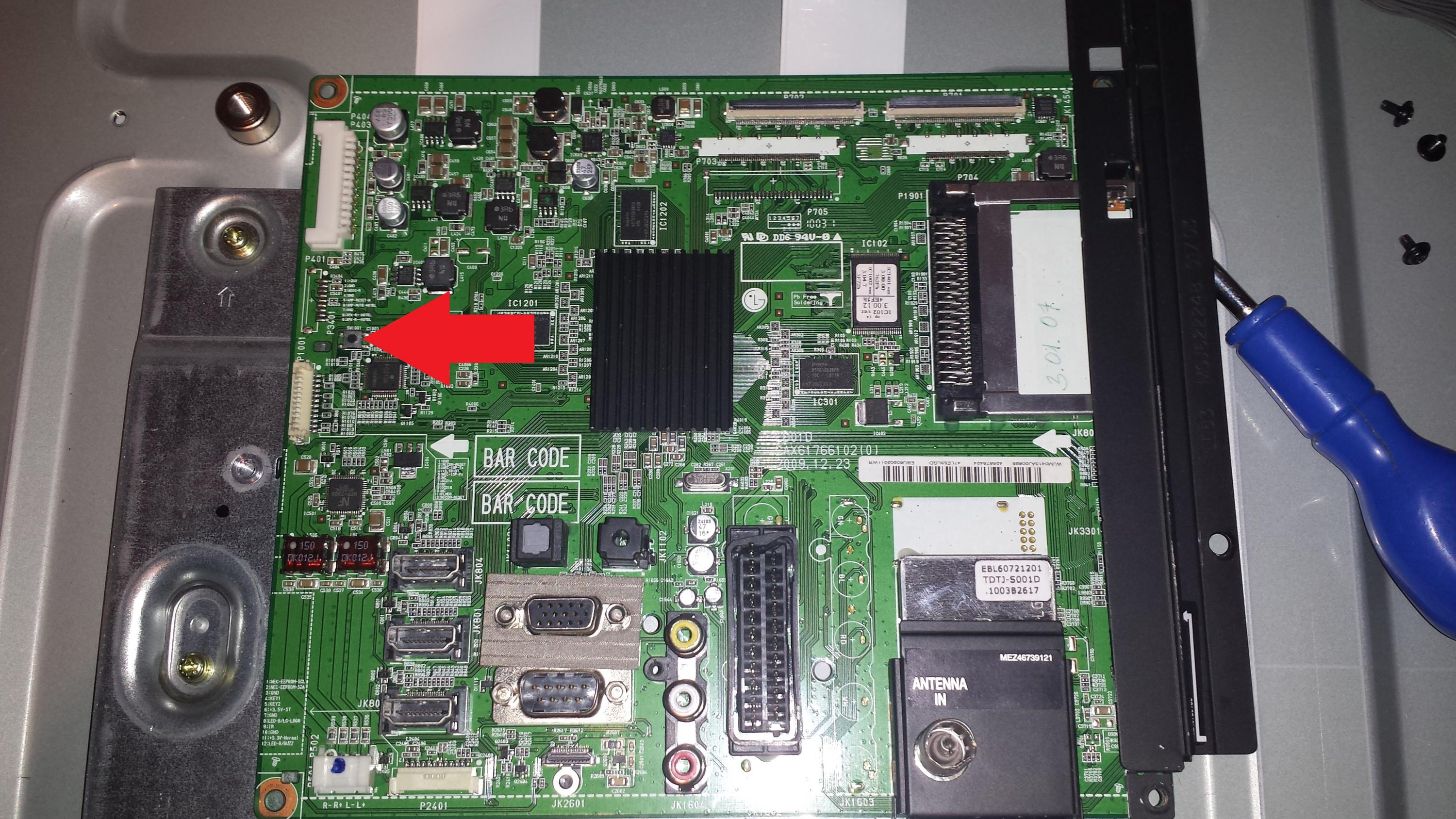

    Re: 47le5300
    Start by checking BL ON/OFF from main board.

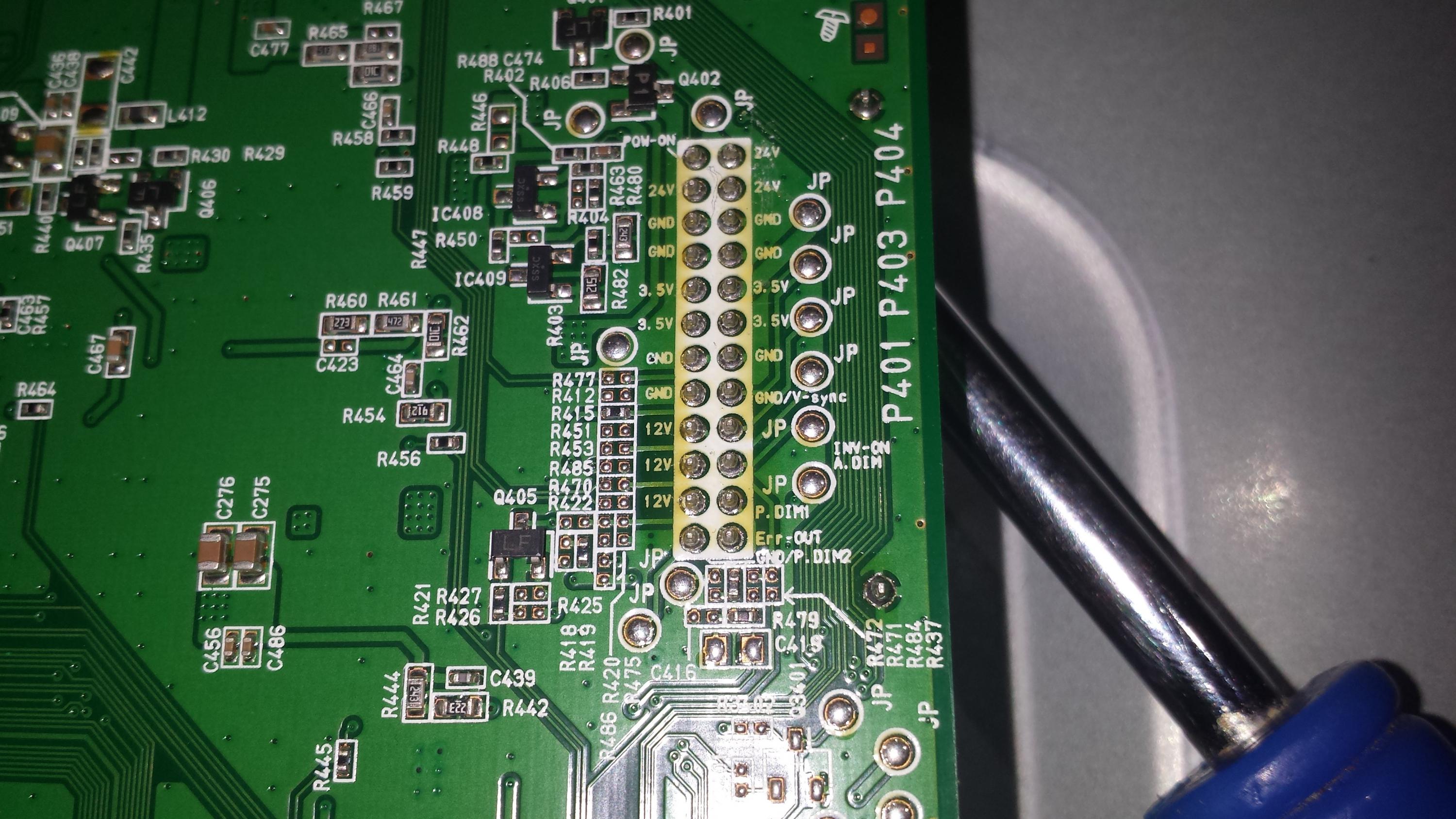

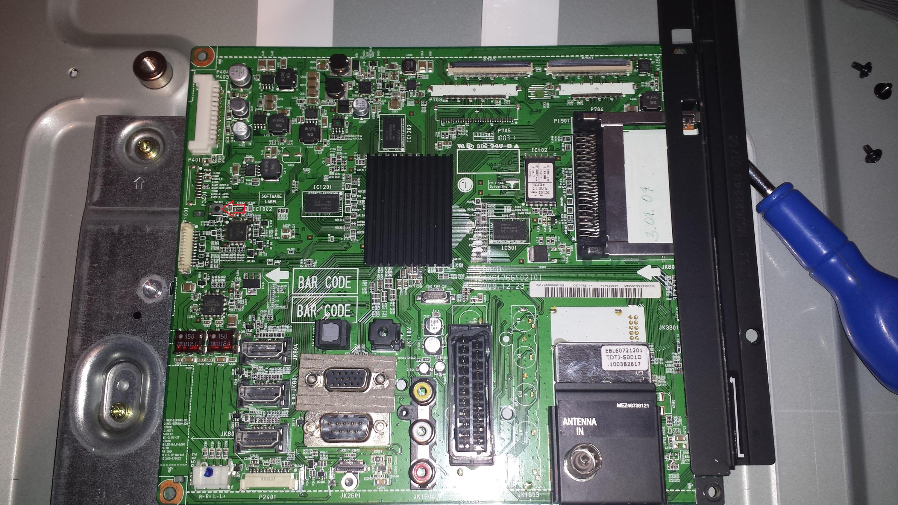

      Re: 47le5300
      sorry tom which one is the BL ON/OFF ive attached some pictures
      also tom if i press the button in the picture the backlight comes on

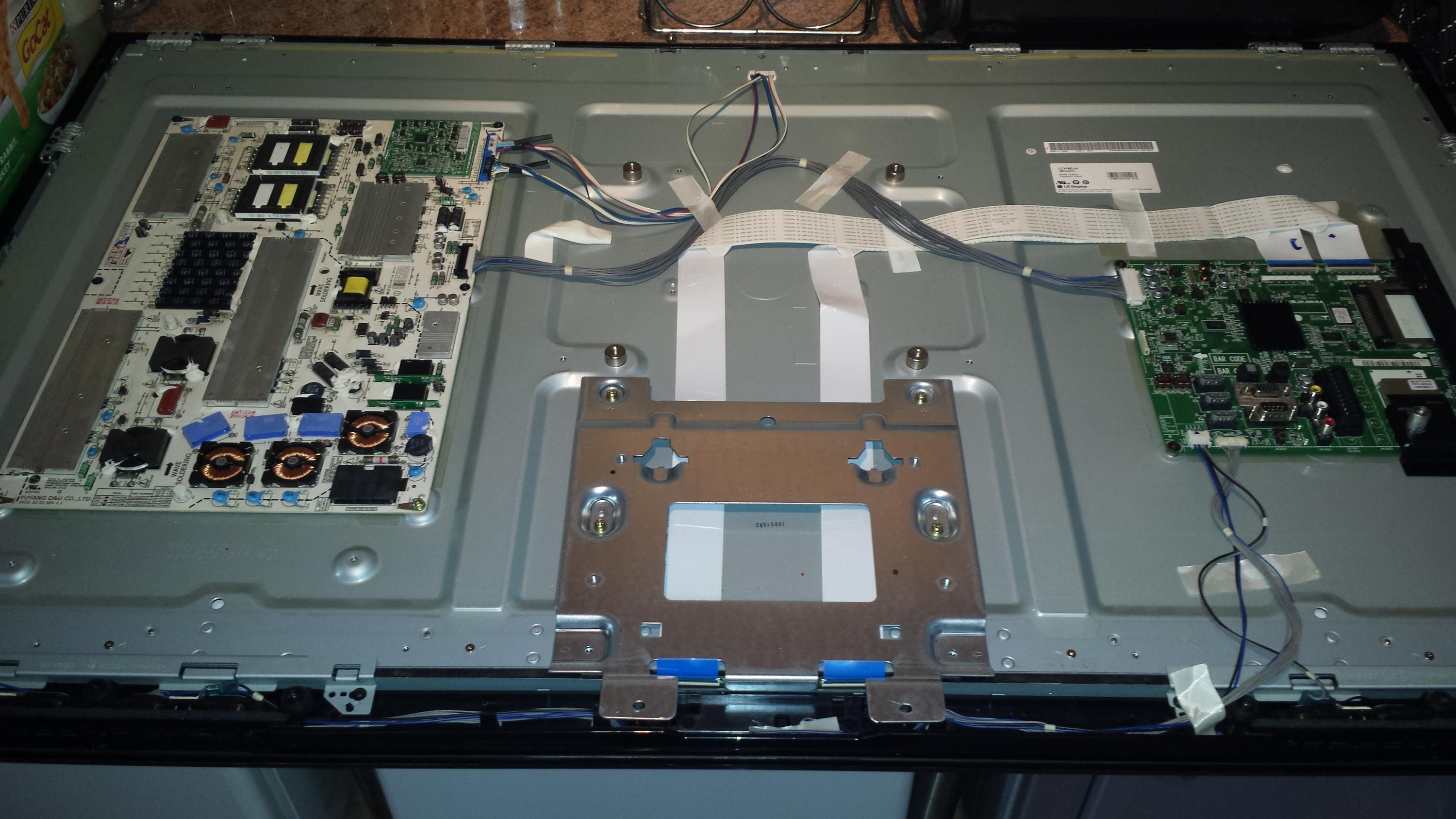

                  Re: 47le5300
                  So no back lights and no image.
                  The LED driver board is built into the PSU on these models.
                  Which button have you pressed in post #3?
                  @ Tom, There are no references on the boards to indicate what pin is for what... This board is slightly different to the one I was working on the other day but same will apply.

                    Re: 47le5300
                    heres the picture m8
                    SW1001 is the button i press to light the backlight up it only stays on for as long as you hold the button in

                      Re: 47le5300
                      just want to bump this up decided to get back to this tv after so long but basically suspect main board failure tv totally dead so does anyone have a idea how i can jump the power supply to see if its the main board,looked in a service manual but not much info
