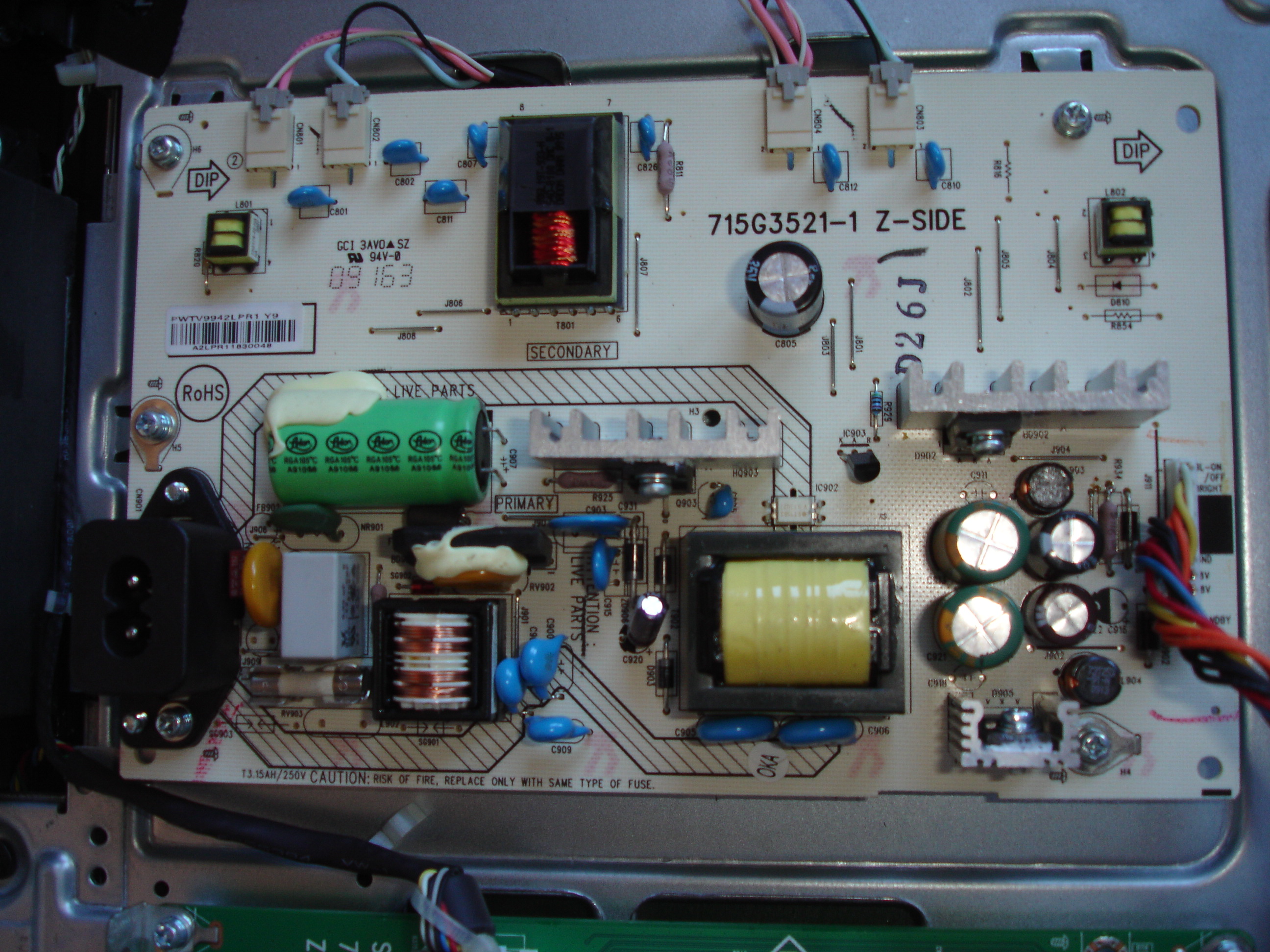

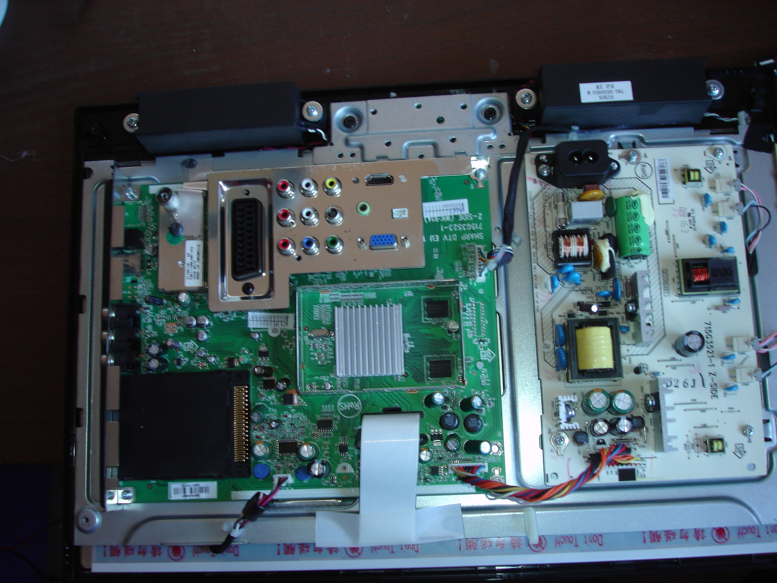

    I have a sharp lc-19sh7e-bk and most of the time it will not come out of standby but then some times it will you can tell when the tv is going to come on because the standby let is very bright and if not going to come on standby led very dill. I have done some voltage measurement's in the fault mode witch are.
    BL-on 0.08
    /OFF 0.05
    BRIGHT
    5.17
    5.17
    GND
    GND
    GND
    18.26
    18.26
    STANDBY 0.00
    I have put a picture of the psu and psu and main board.
    any help please

    Seems the power board is working. These TVs are TVE (TopVictory Electronics China) and have lots of problems with the main board. Nothing SHARP about this TV but the name. Check voltage regulators on main board. You might be dealing with a BGA soldering problem (not uncommon with main boards these days...)

          You won't find the dry joints by inspection. Same fault as Xbox360, PS3 etc., due to cracked solder joints under processor, if the fault is intermittent. Not saying this is definite, but it happens quite a lot with TVE main boards.
          Voltage regulators could also cause this problem so I'd check inputs and outputs.

            I bet it is that because if I leave tv on it will come in about 5min when it as warm up
              Re: sharp lc-19sh7e-bk
              You could use a can of compressed air (invert for freeze spray) which can be purchased from Poundland. Can help with temperature sensitive faults.
              • gary19610
                • Dec 2012
                • 74
                • uk
                well I did what you do to ps3 and working so far used a bit of flux and hairdryer thanks for your help tom
