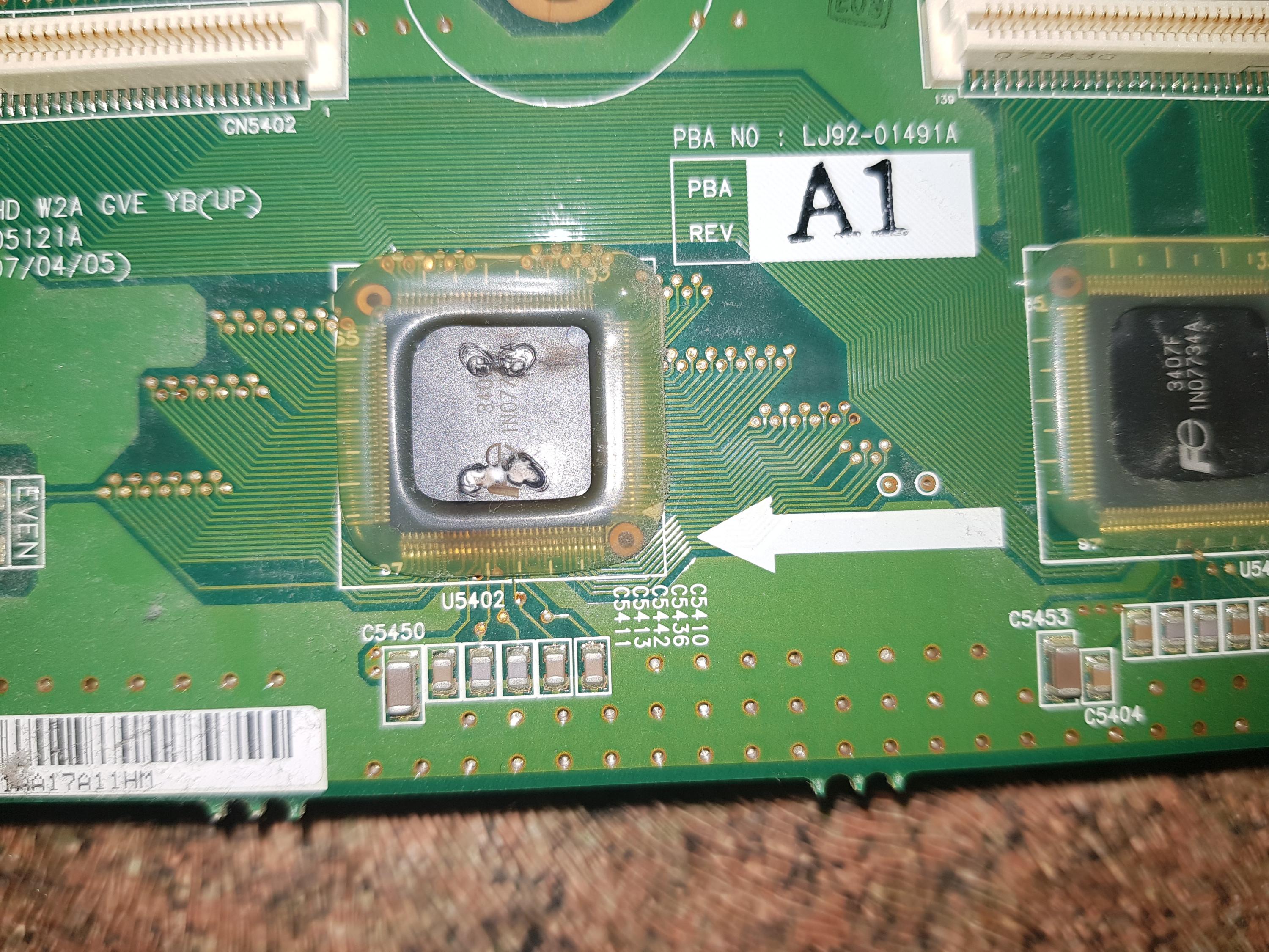

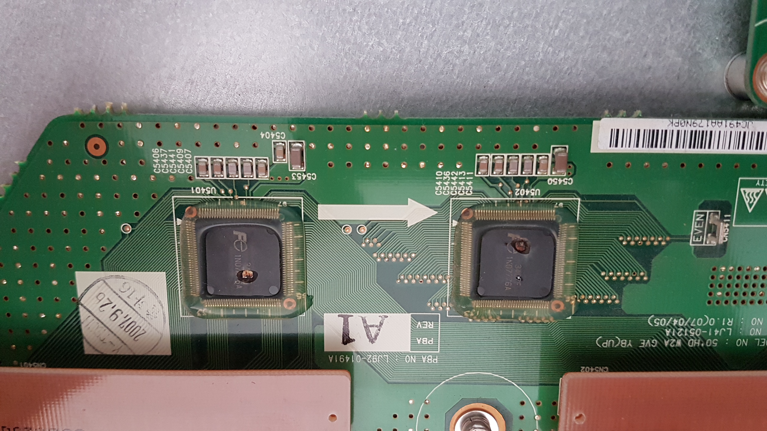

                Originally posted by tw2005
                One thing to be careful with are those E,F,G buffers at the bottom which I would not mess with. This is the model I learnt what happens if you reconnect the power cable to those boards whilst there is residual charge after the PSU is turned off.
                They get spiked and blow(non repairable chips on the panel ribbons)
                There is a aluminium strip that sits across those too(heatsink) I thought was just a bracket, they fry quick smart and same deal, dead panel.
                Check out the attached photo.
                • sordids999
                  • May 2013
                  • 2161
                  • uk
                  #48
                  Re: Samsung PS-50C96HD - No picture - help needed
                  Collected one of these tonight free
                  Top buffer IC burnt
                  All fuses on Ysus and Zsus ok but fuse F803 on power supply blown
                  Had a spare buffer so changed but still trying to work out what else is blown on the psu
