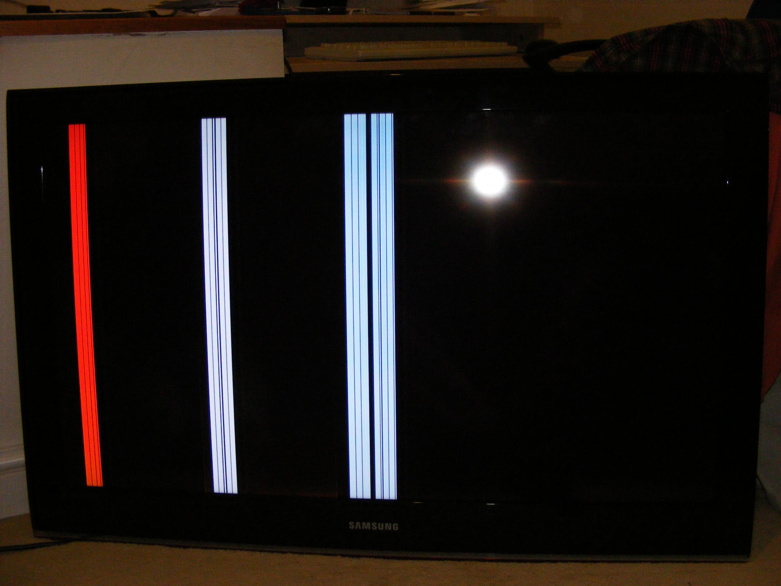

    This one came to me today and I haven't popped it open yet - will leave it till tomorrow. Guy said sound but no picture but I turned it on and it does this. The lines change when pressing buttons for menu etc.
    What might I be looking at here? T-con? Tab-bonds? What's the betting?

    I have seen this before and it was a bad panel. Not saying this one is but consider the possibility.

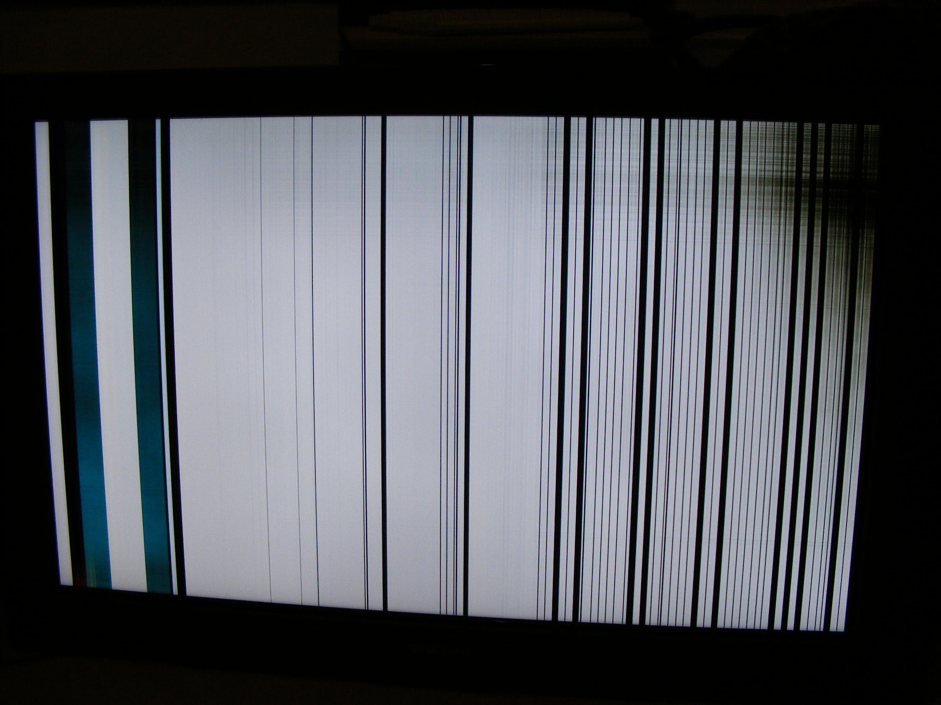

        This was mine
        http://www.youtube.com/watch?v=kAIbSEuW94s

          So I've got it apart. The tabs all look fine, no holes or burns - though they are getting a bit hot. Pressing on them makes no difference and freeze spray did nothing too. I've checked over the t-con and reseated cables but still the same. Display symptoms are a lot like yours Tom minus the burned out tab. Is it worth trying another t-con or will I be throwing money away? Anything else I can check?

            Found a t-con for £10 so taking a chance that it's that. Fingers crossed.

                Turns out it's a bad panel as you suspected tom66. The new t-con changed nothing. After watching this vid: http://www.youtube.com/watch?v=GcBwTums_mI I tried disconnecting either t-con ribbon to panel and one half is working ok. I guess this one is going for parts then.
