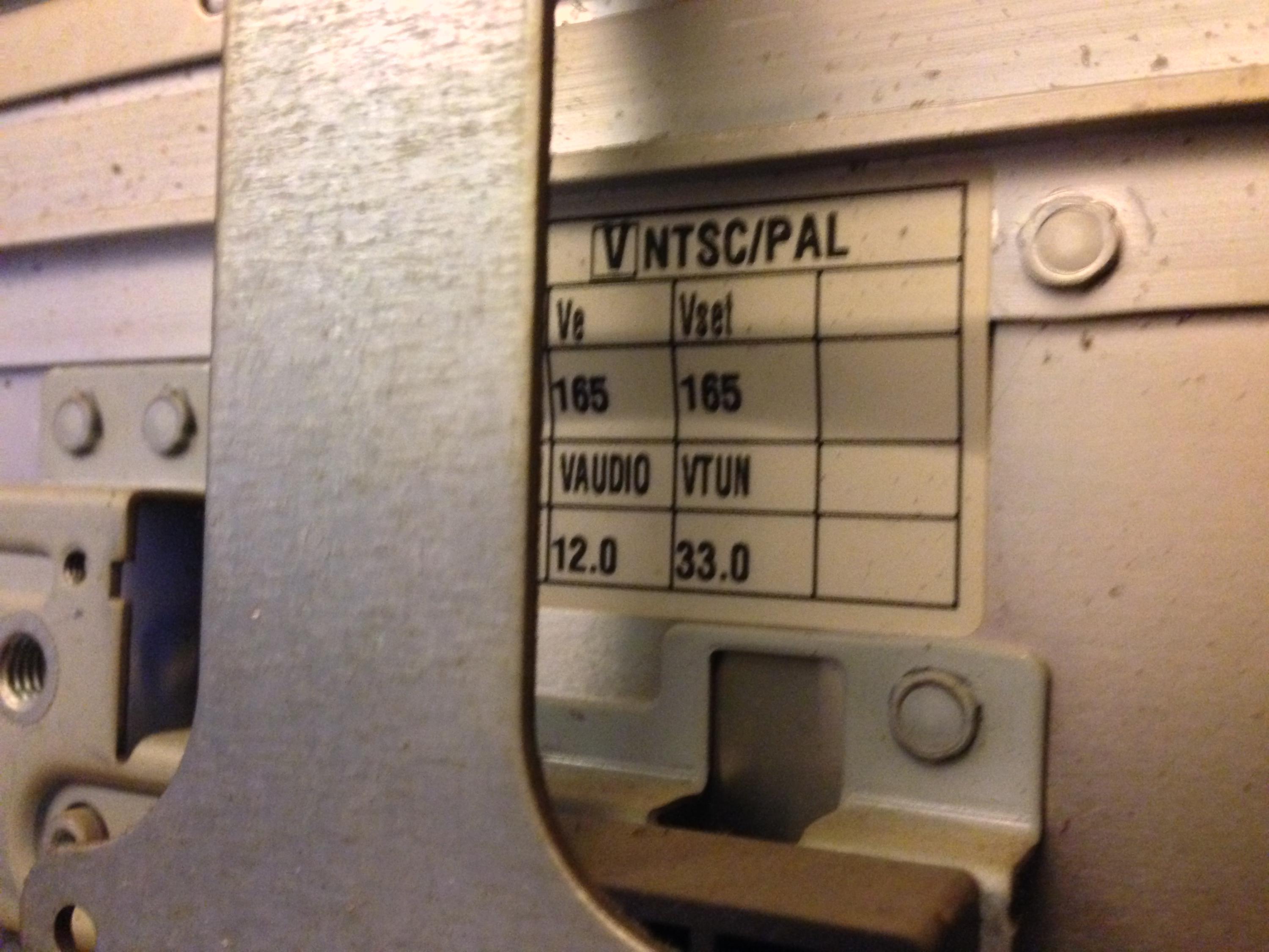

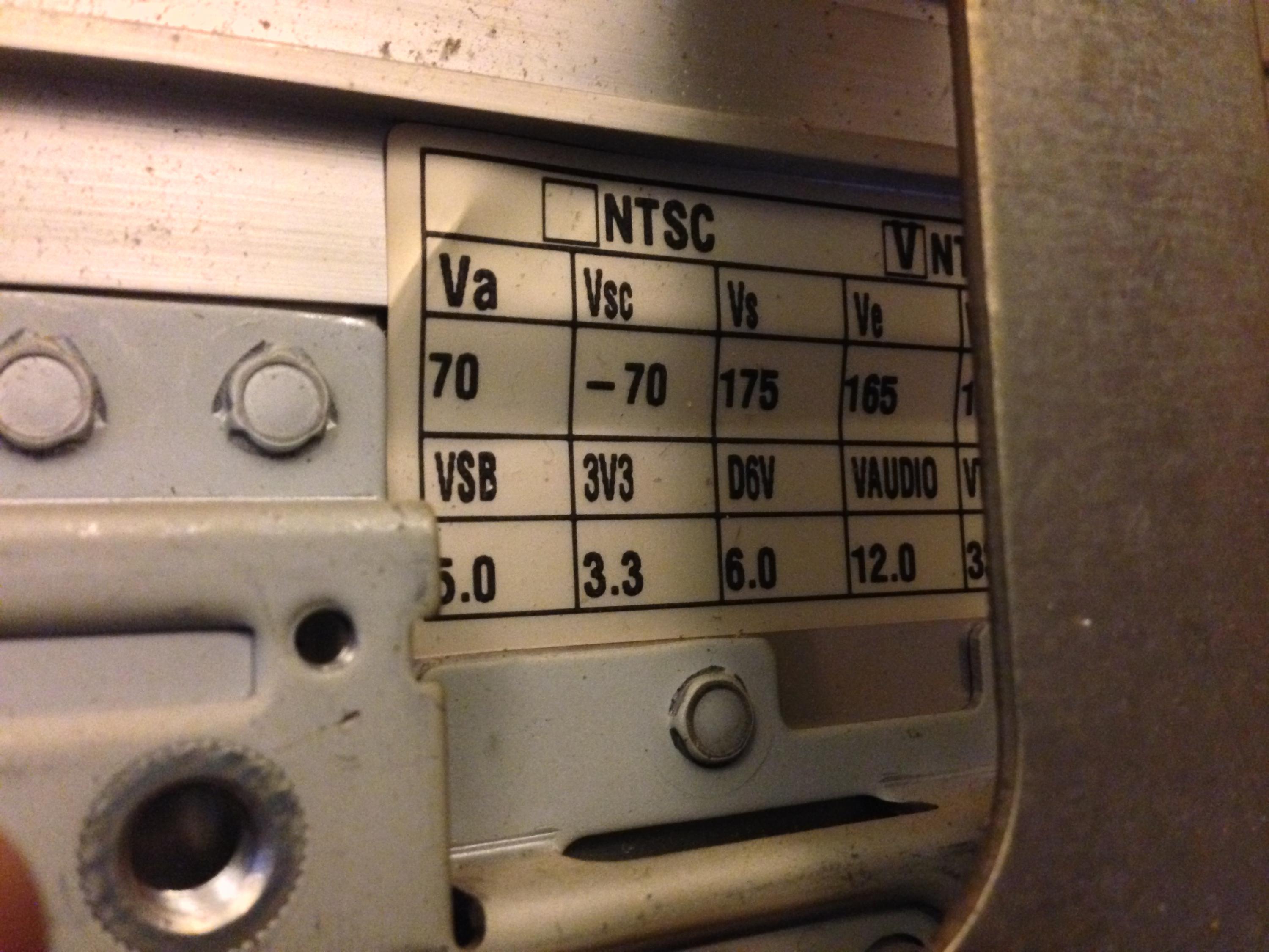

    I've run into a problem. The power lead is chased into the wall and the only other one I have powers the PC.
    I'll have to grab one from work tomorrow.
    I assume you mean the left most connection marked Vs and I stick the probe down into the connector where the wire connects - I can just see the end of the exposed internals of the connector
    Many thanks
    Fritz

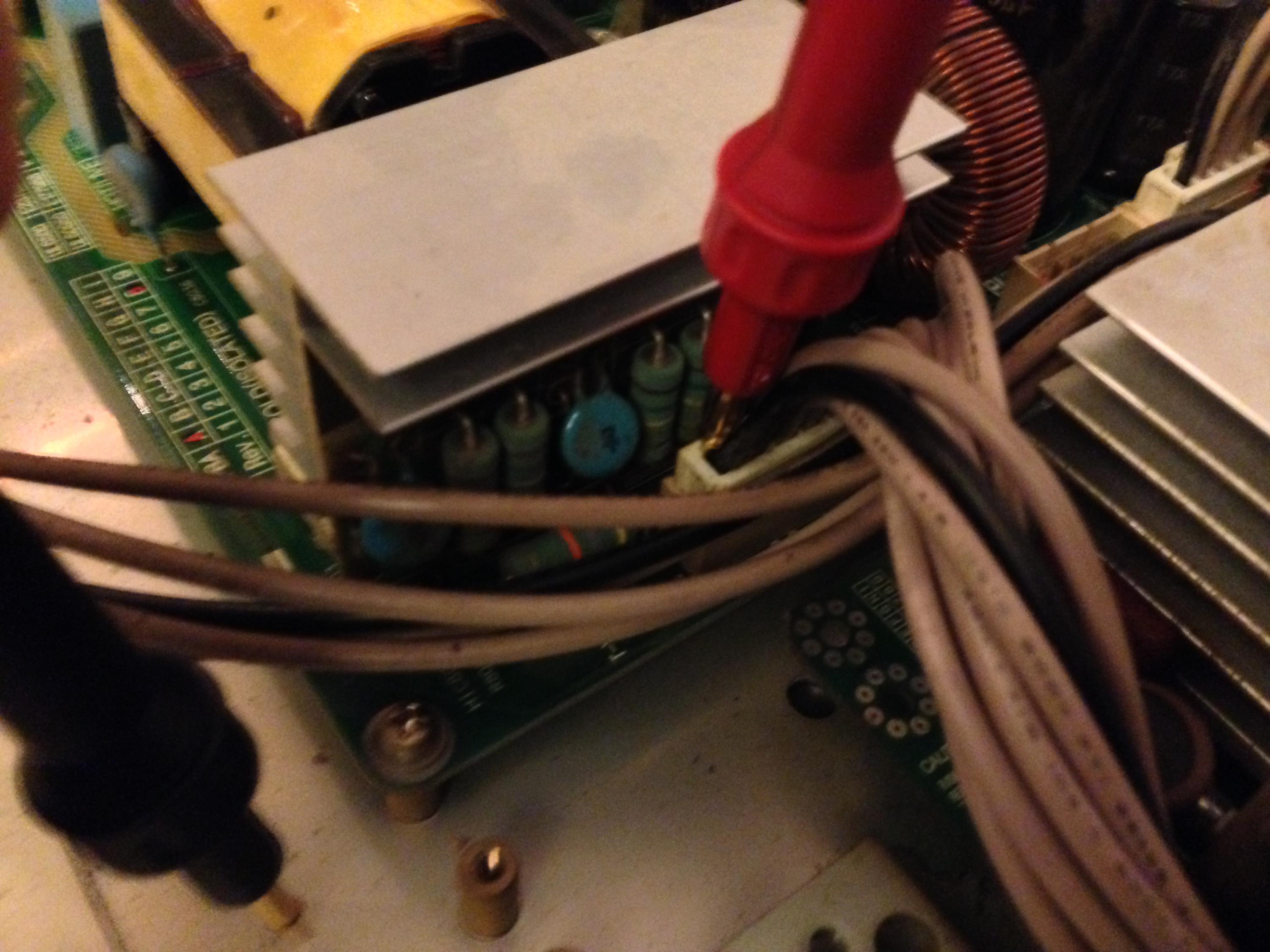

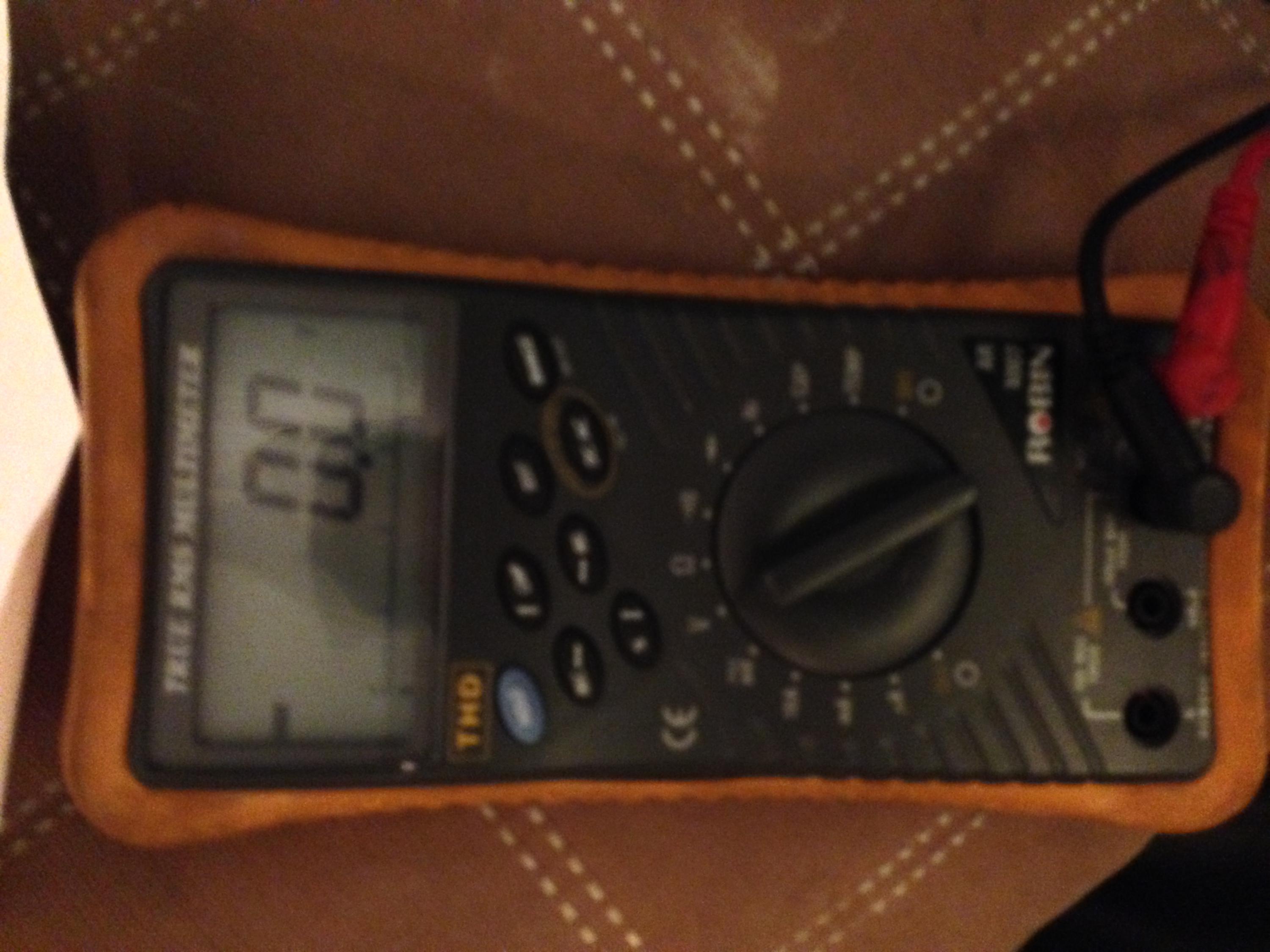

      Re: Bush PDP42TV006 Problem No Picture
      Hi Tom
      Well I'm not sure I'm doing this right but when I put the probe in either of the pins marked Vs I'm getting a reading of 20 v which gradually drops off to zero over about a minute. I can hear some clicking and various lights come on then some go off again. There's also a crackling sound when I push the probe in but guess that could be as the probe connects. It's just once, then it goes.
      Attached is a photo of how I'm testing; how the meter is set; and also a couple of photos of the sticker on the back of the panel that I think is telling me what voltages I should get.
      Many thanks
      fritz
        Is the red probe in the VOLT jack, black probe in COM?
        The PSU looks likely to be the fault, but there are some other tests that can be done.
        That connector goes to a board on one side of the plasma panel.
        There will be a board on the other side too.
        You need to unplug both big thick power connections to these boards then measure Vs.
        If it rises to 175V, you should then get sound (though this depends on if the set is switched to a source with sound and if all is connected right.)
        This will mean one of these boards is defective. Through process of elimination you can locate which one is defective. (Note, only change the connectors after switching off the set by unplugging it, and leaving it alone for 5 minutes, or damage/arcing may occur when reconnecting.)
          Hi Tom
          Yes probes are connected correctly.
          I unplugged both connectors and re-tested all Vs pins and still get voltage dropping although it now peaks at about 50 v as the set is switched on but drops off much faster.
          Fritz
            It would seem the fault is definitely with the power supply. It may have something to do with that bulged capacitor, so I would consider that first. What is the part # on power board (usually LJ44- or BN44-)? In many cases a new power board is cheaper than replacing parts, especially considering the time taken to diagnose and repair.
