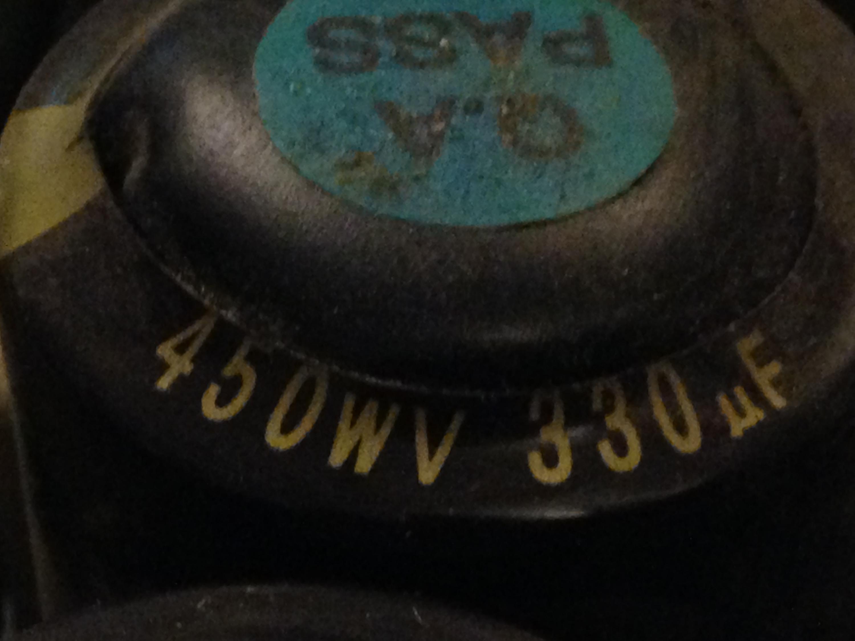

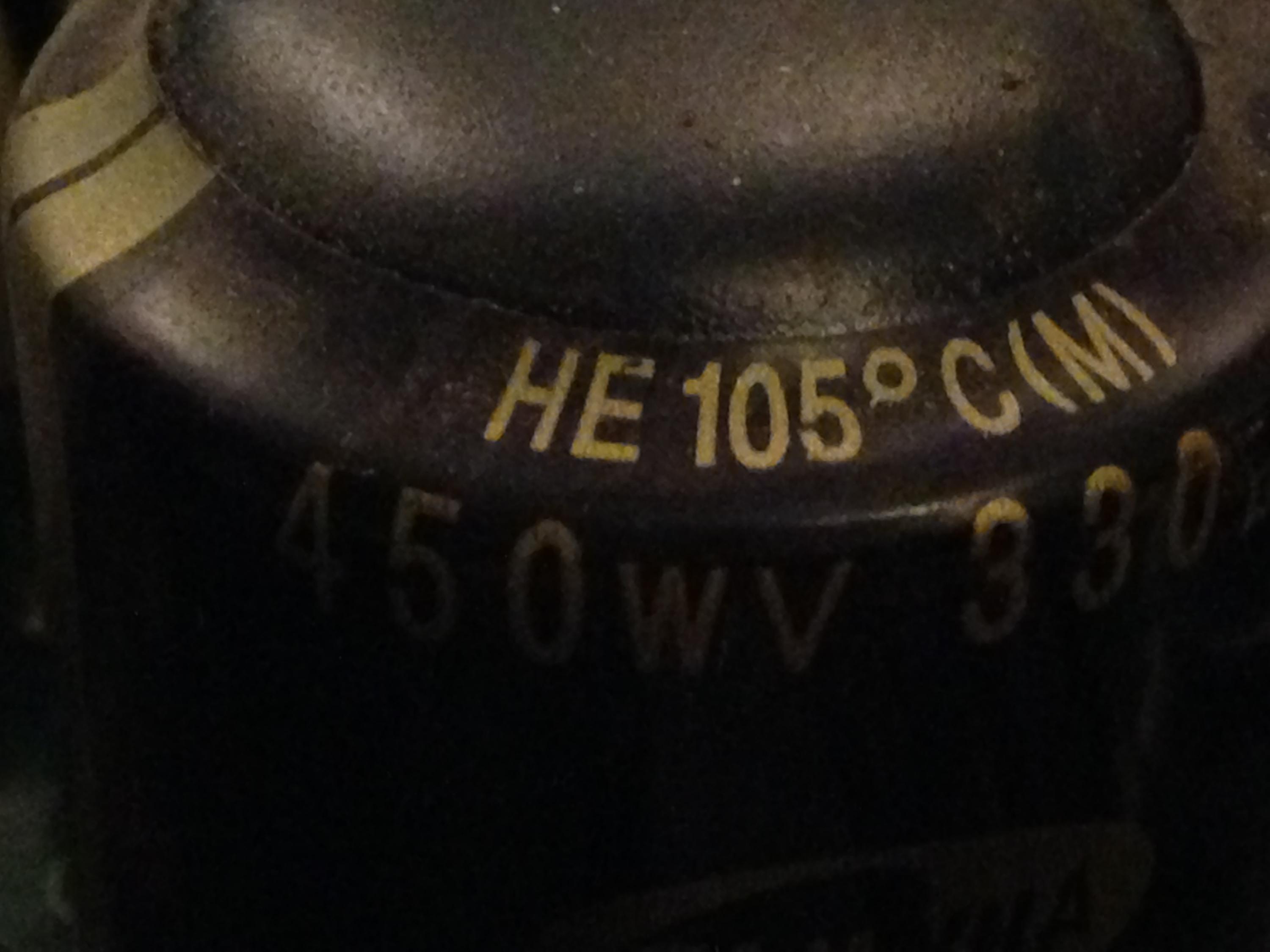

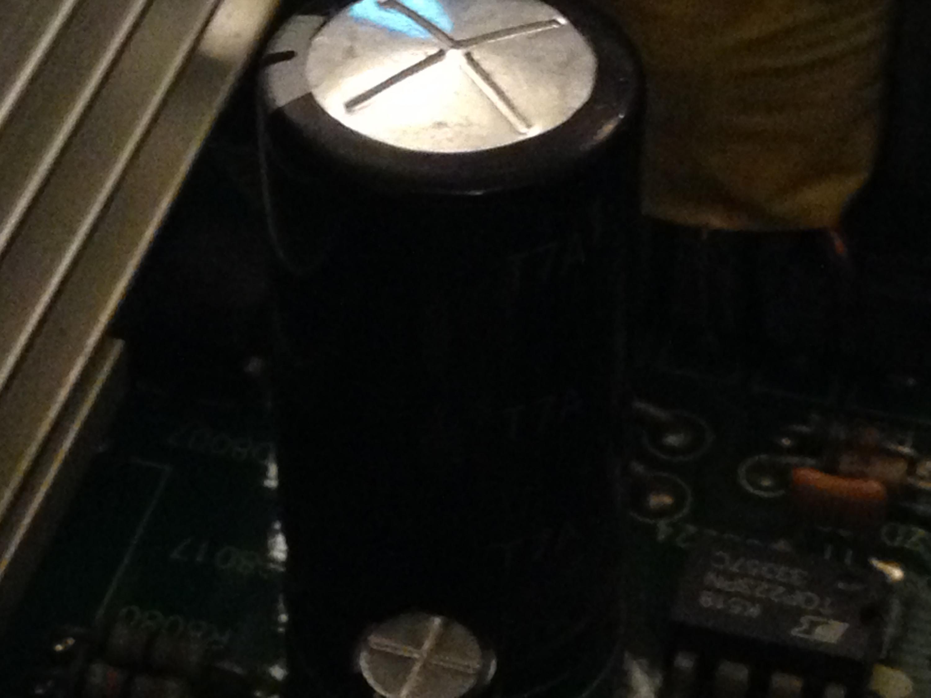

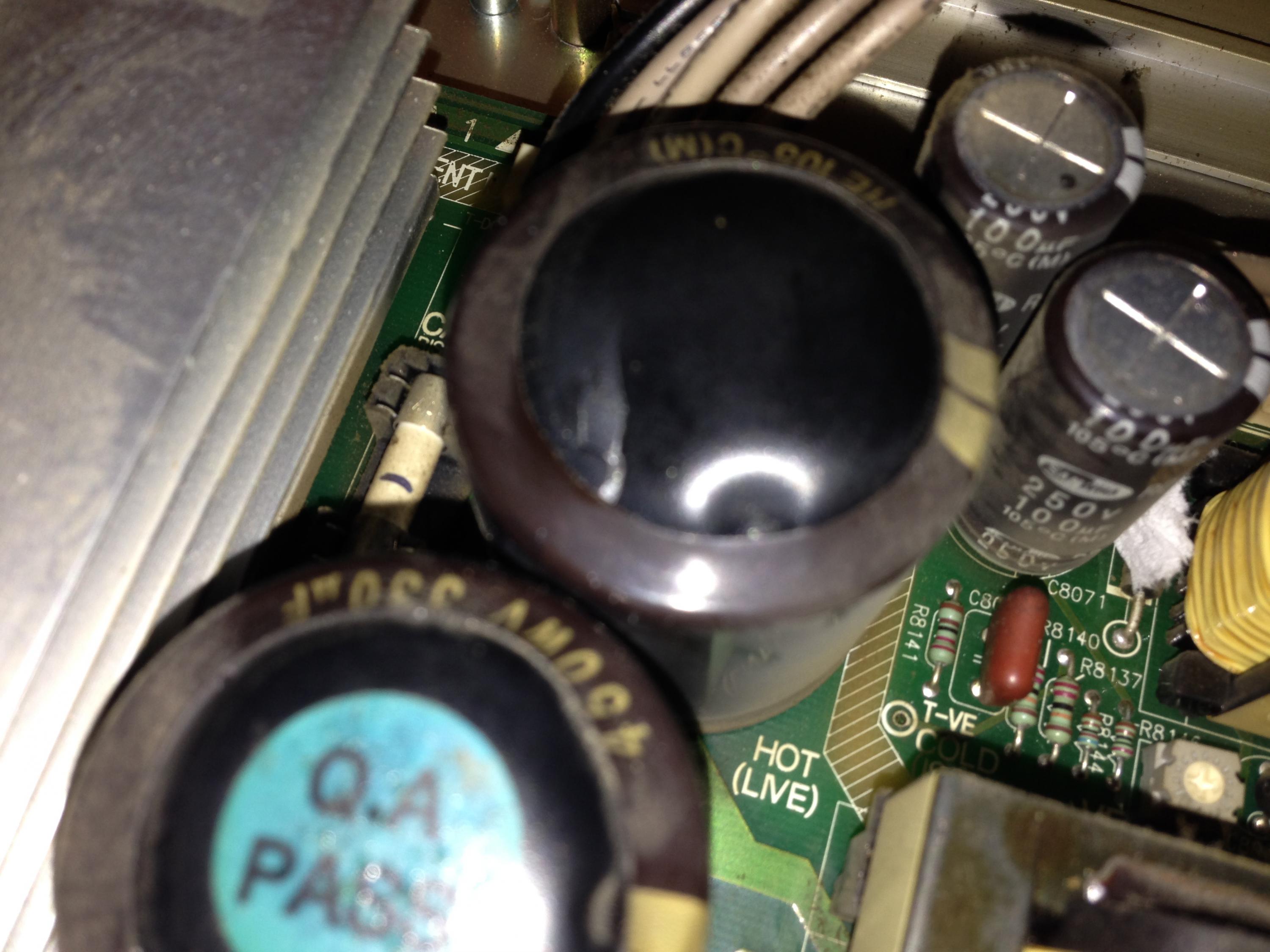

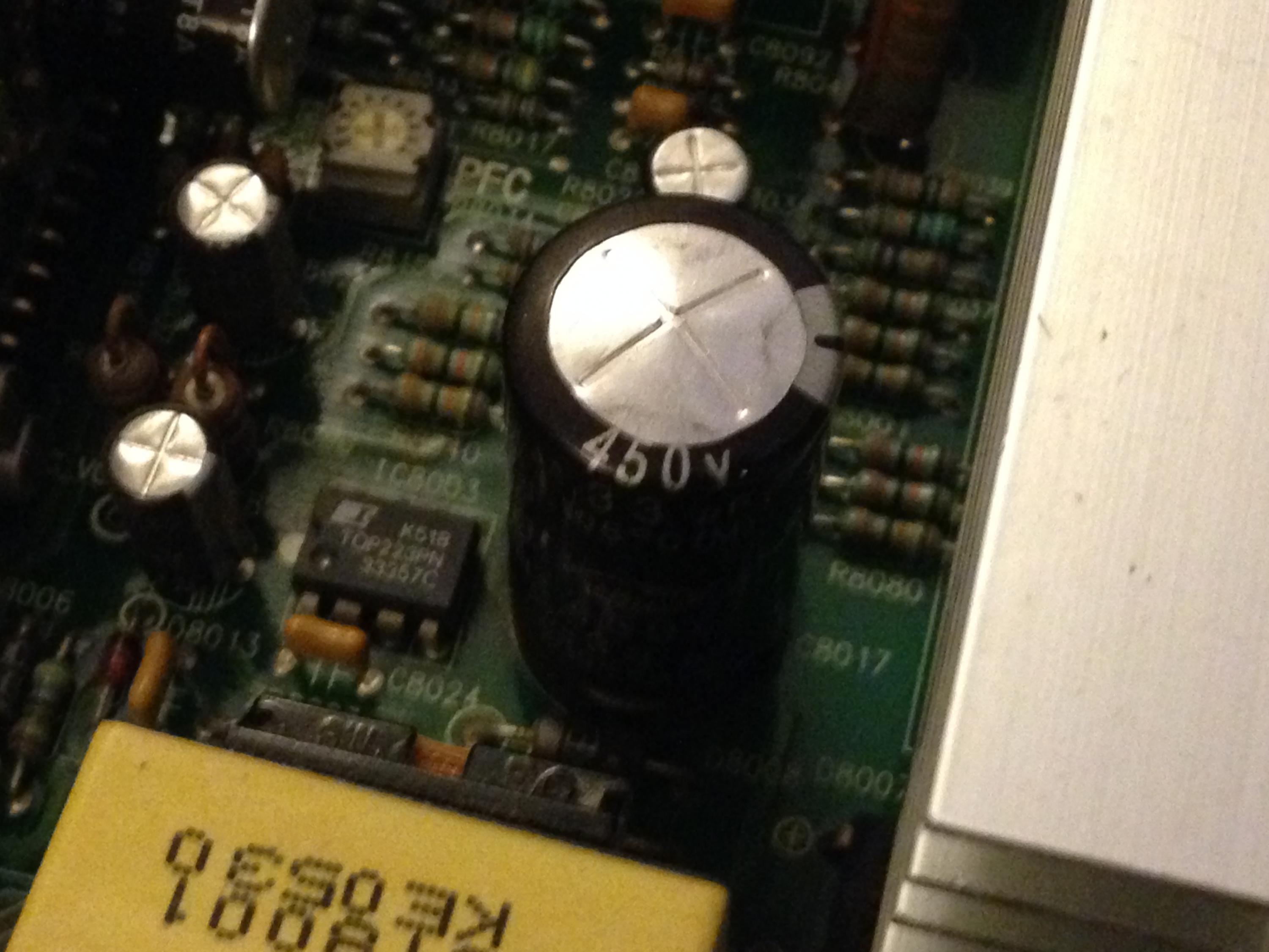

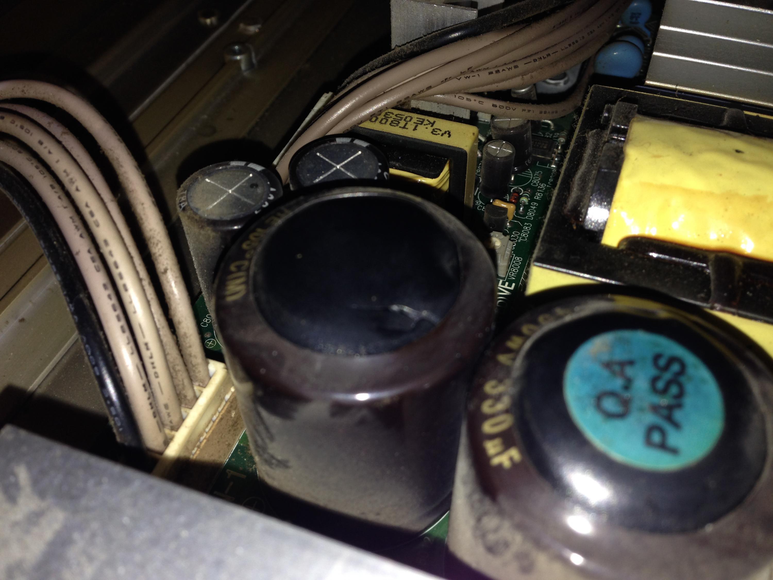

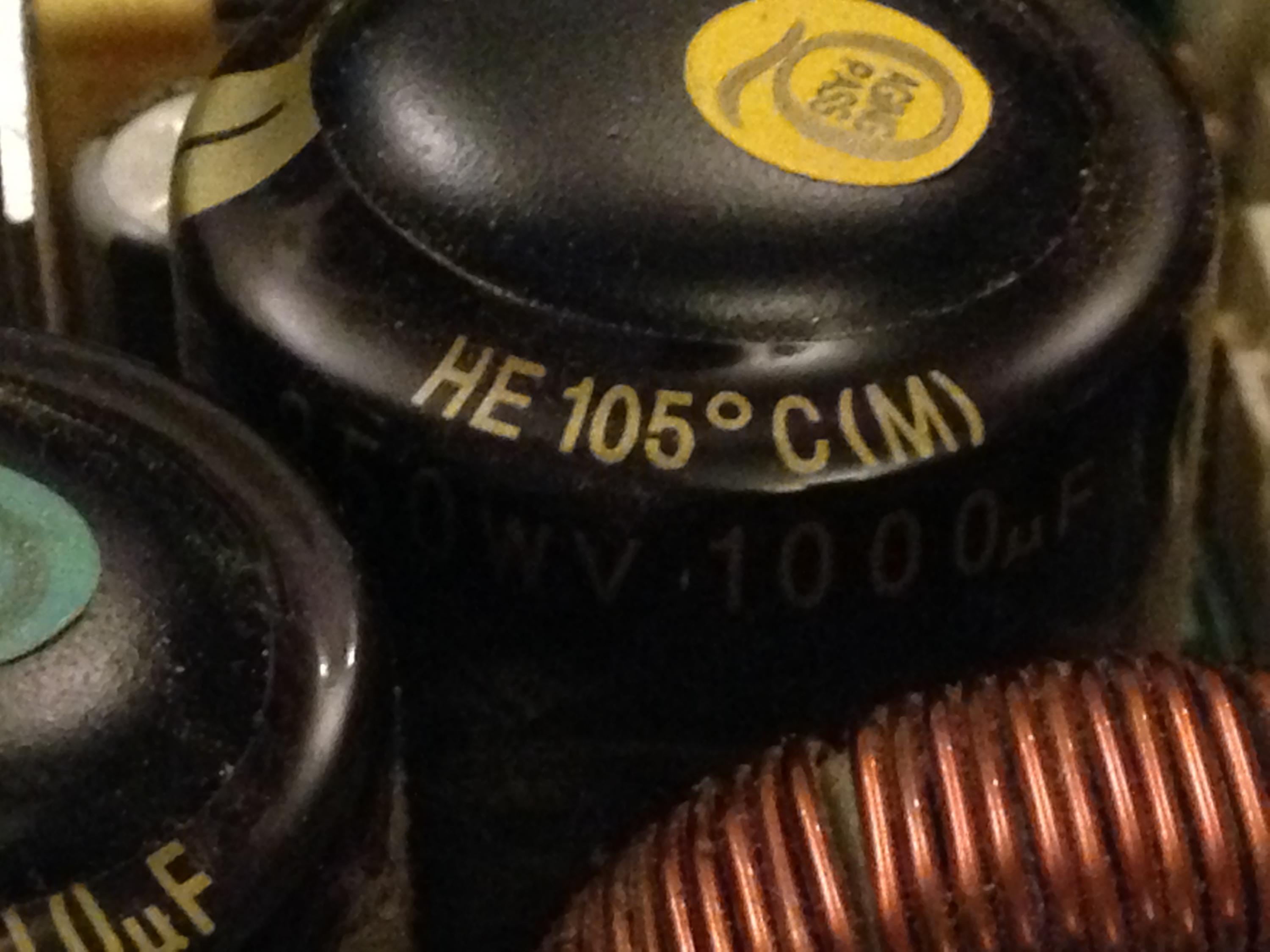

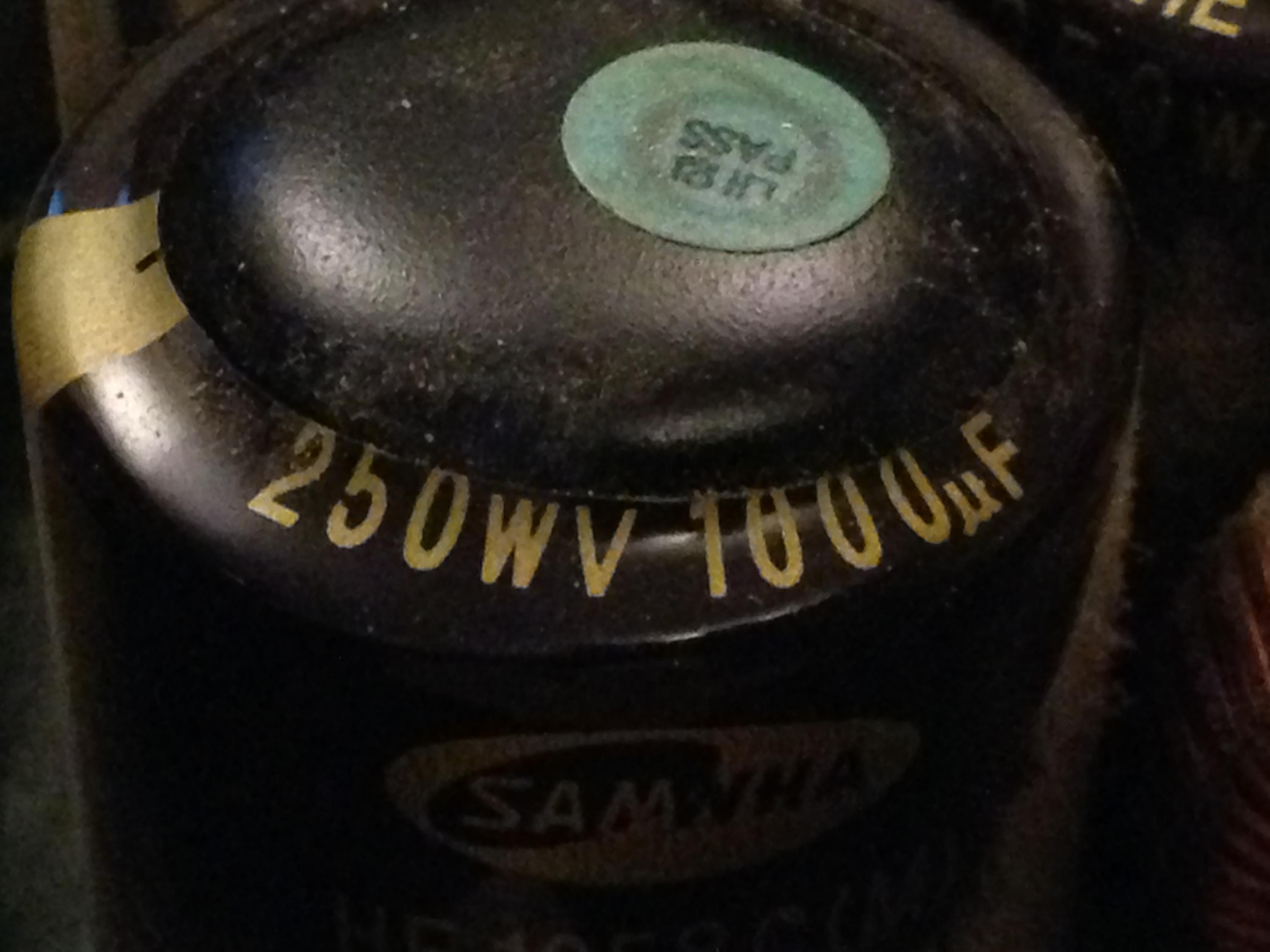

    I've now taken the back off and can see I have at least 1 capacitor that looks blown, could be 5 but the remaining 4 are so big I'm not sure what they are, they look like capacitors but bigger than anything I
    I've seen before.
    Attached are the pics (these are all on the board that's connected directly to the mains connection in).
    Can someone confirm whether these are all capacitors; if they are blown; and if I replace them I have a reasonable chance of the set working?
    Many thanks
    Fritz
    Re: Bush PDP42TV006 Problem No Picture
    The first 4 are OK if and only if you can press down the plastic disc completely flat.
    The 5th is definitely bad.
    Do you have a digital multimeter to make some tests?
    I think this TV is newer than you think. If it uses an LG Electronics PDP42V7#### panel it is a 2005~2007 production year TV.
      Ok three of the first 4 press down fine. The fourth made a cracking sound that was the plastic disk cracking at one edge. I've attached a photo below. Is this now U/S?
        You would need to remove that plastic disc to confirm, it is done carefully using a flat head screwdriver.
              Ok I popped the top off and it looks good, no bulging. I hope I don't have to get the cap back on though as I don't think that would be as simple.
              fritz
                The cap may stay off.

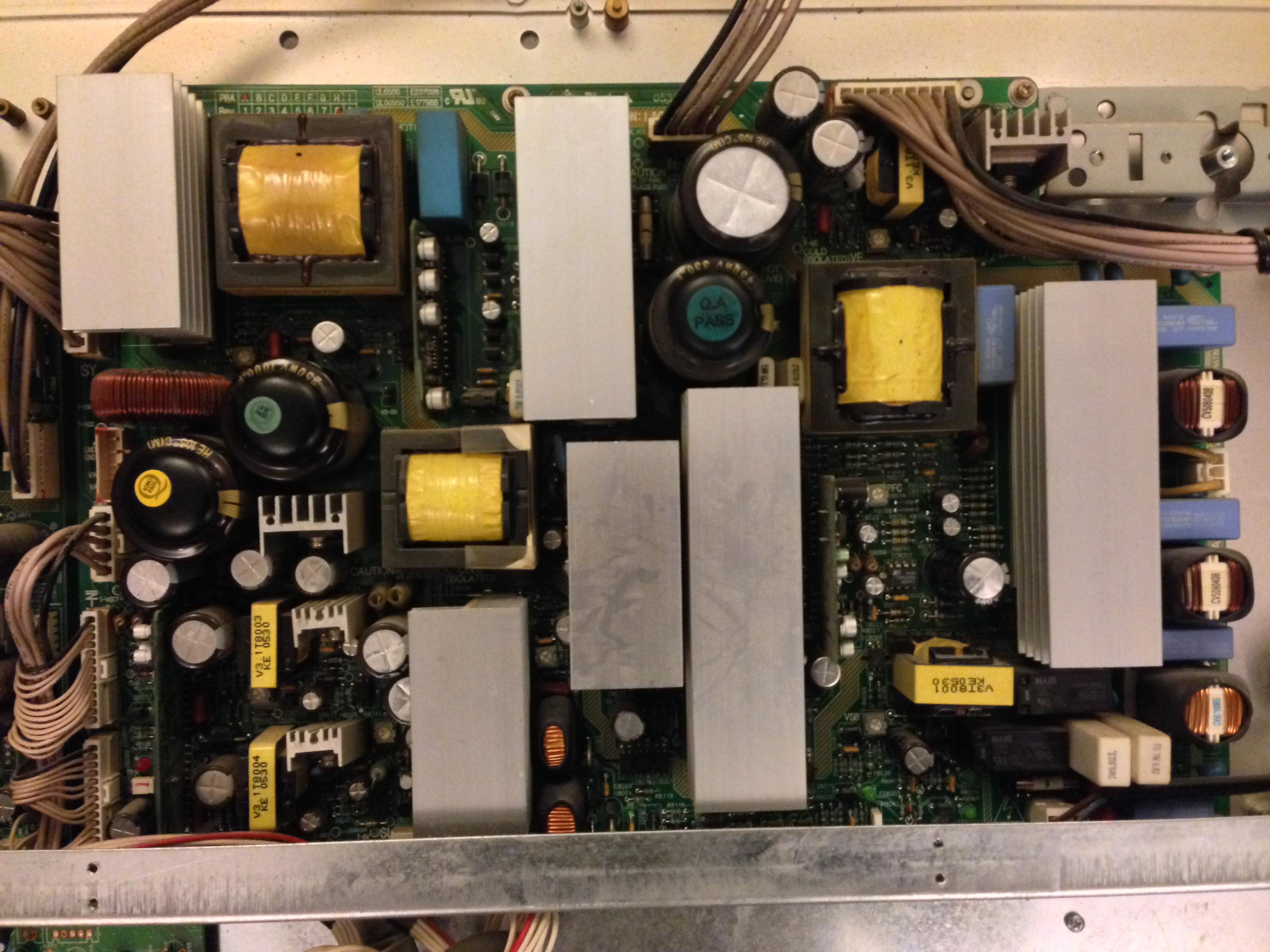

                            Take a picture of the whole power supply. I will highlight areas to test.

                              Picture of power supply unit attached (well the board that the power switch wire connects directly to).

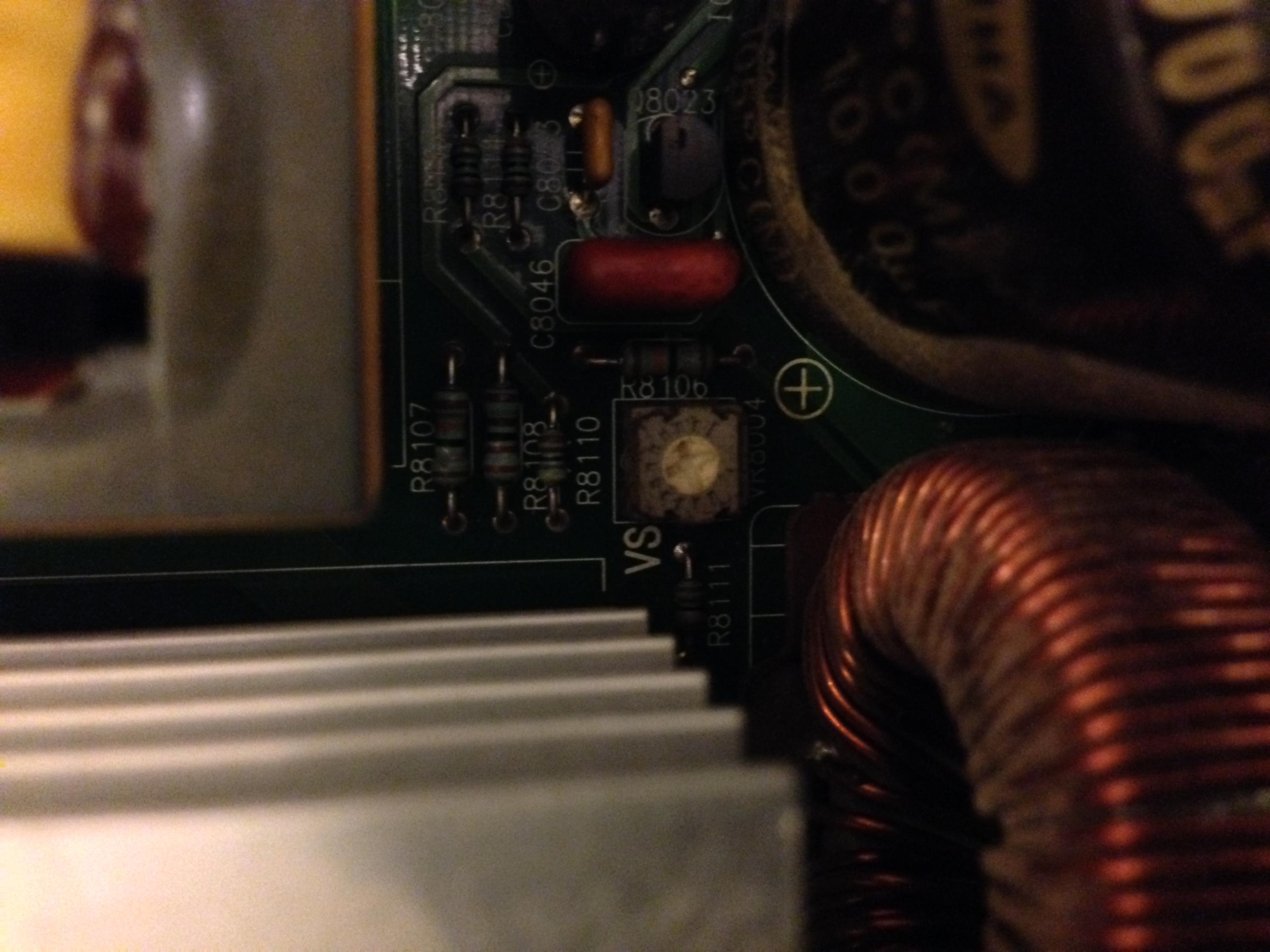

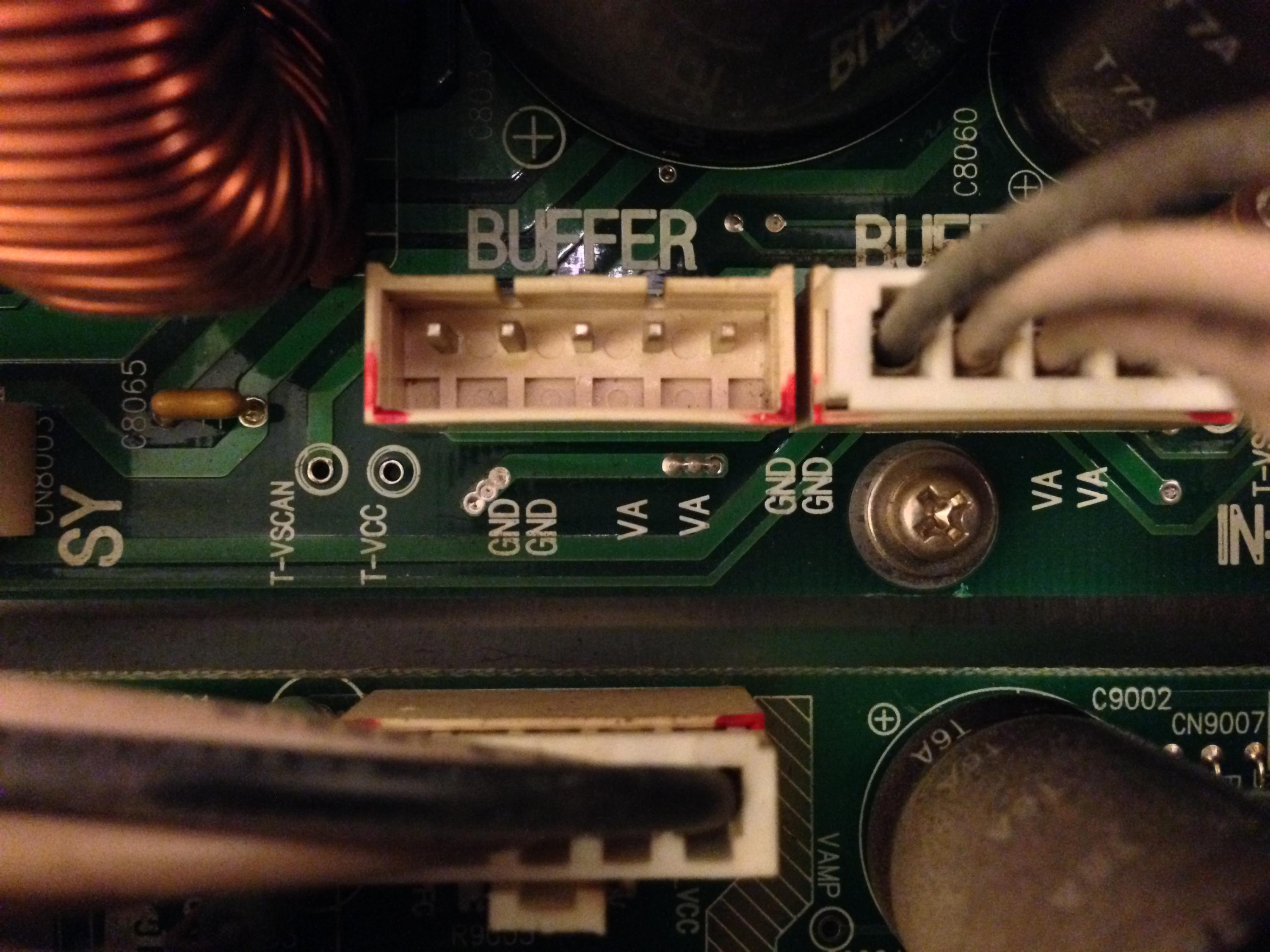

                                Along the top left of the power board there is a connector with pins marked Vs, Va, etc. Can you see these labels?
                                Does this TV use a Samsung or LG plasma display module?

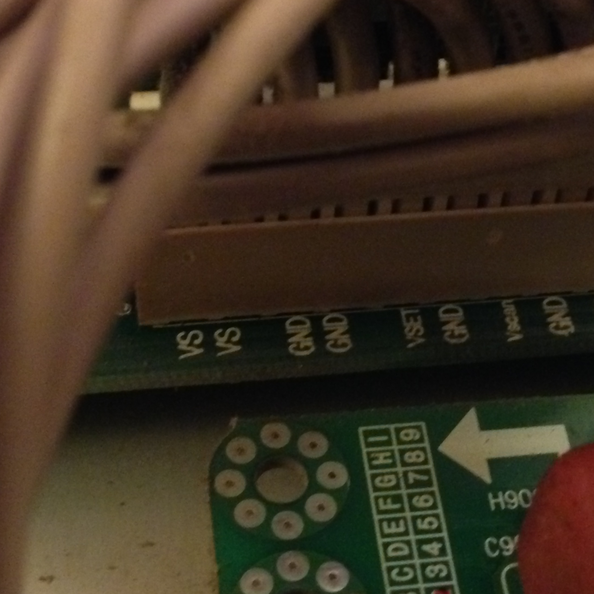

                                  Hi Tom

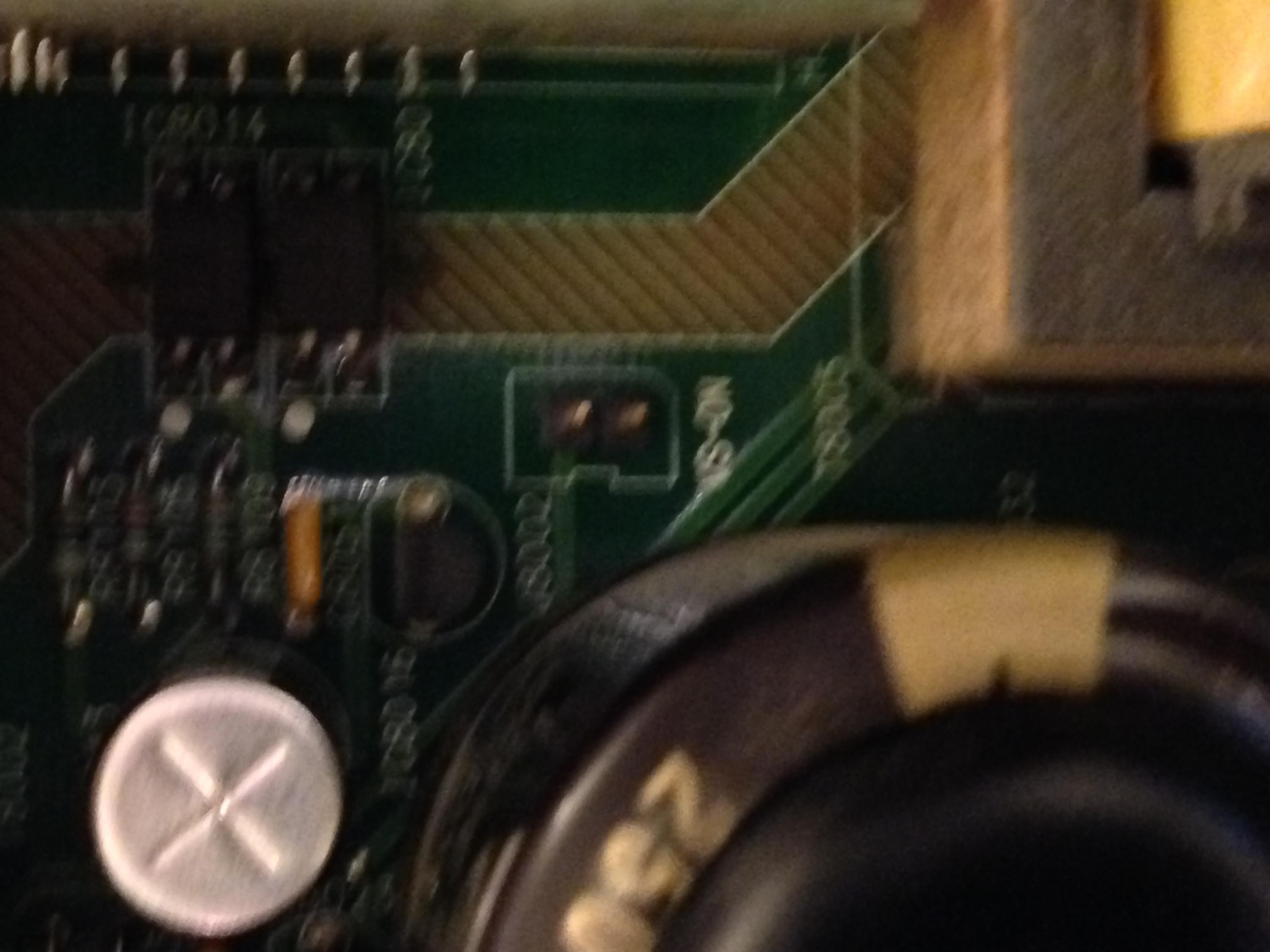

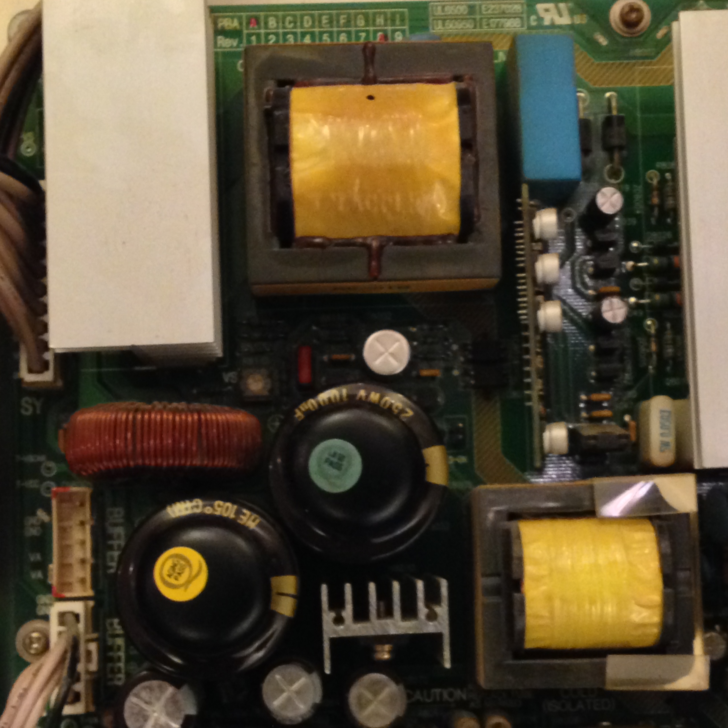

                                  I can see a few areas marked with Vs or similar but theonly connectors I can see are two. One is marked Va and also seems to be marked Buffer the other is a slightly larger connector and marked VS. I've attached photos of what I can see.
                                  The panel is made by Samsung model no. S42SD-YD05.
                                  Fritz
                                    OK, what do you see (measure) on the pin marked VS?
                                    To measure:
                                    - red probe on VS pin
                                    - black probe on the metal chassis... back frame of plasma screen works well
                                    - multimeter on volt DC
                                    - set turned on
                                    You should get around 170 to 200V. The exact rating will be printed on the plasma display panel.
                                      Sorry Tom
                                      Can you refer me to a one of the photos as I'm not sure what pin you mean and I don't really want to be poking about with a probe with the set powered up.
                                        This one
                                        https://www.badcaps.net/forum/attach...1&d=1384465969
                                        left: there will be a little exposed metal around where the wire meets the pin.
