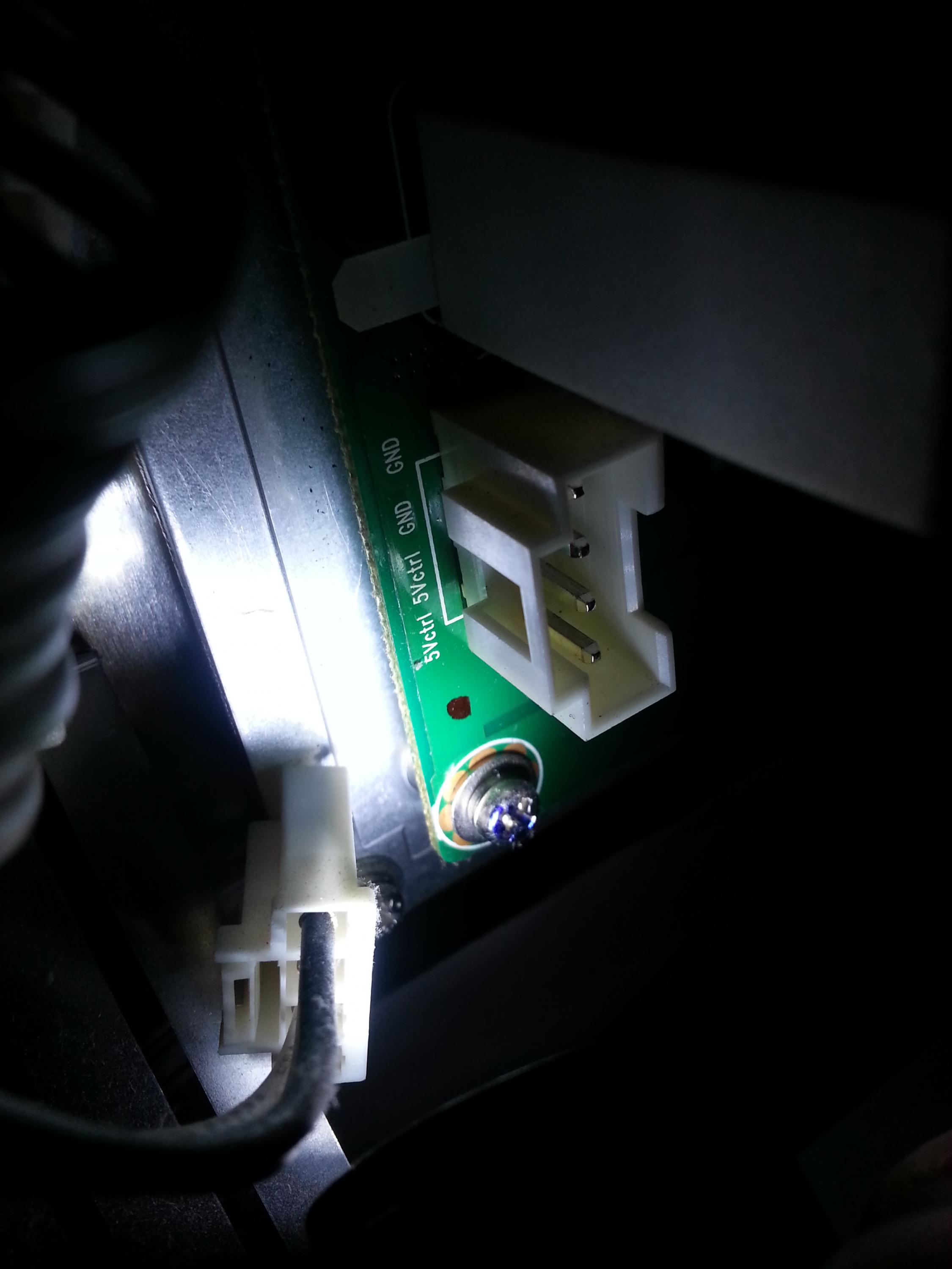

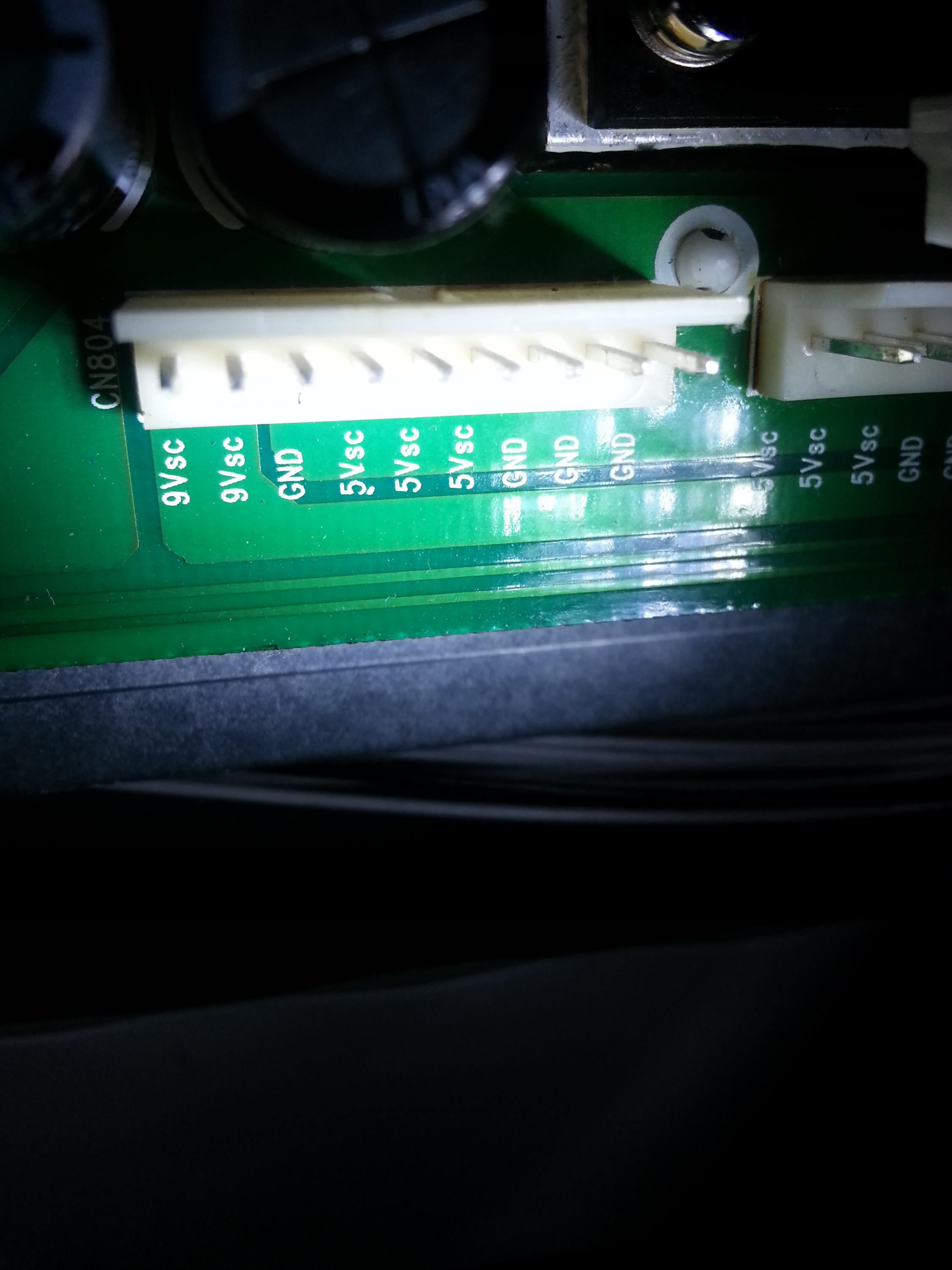

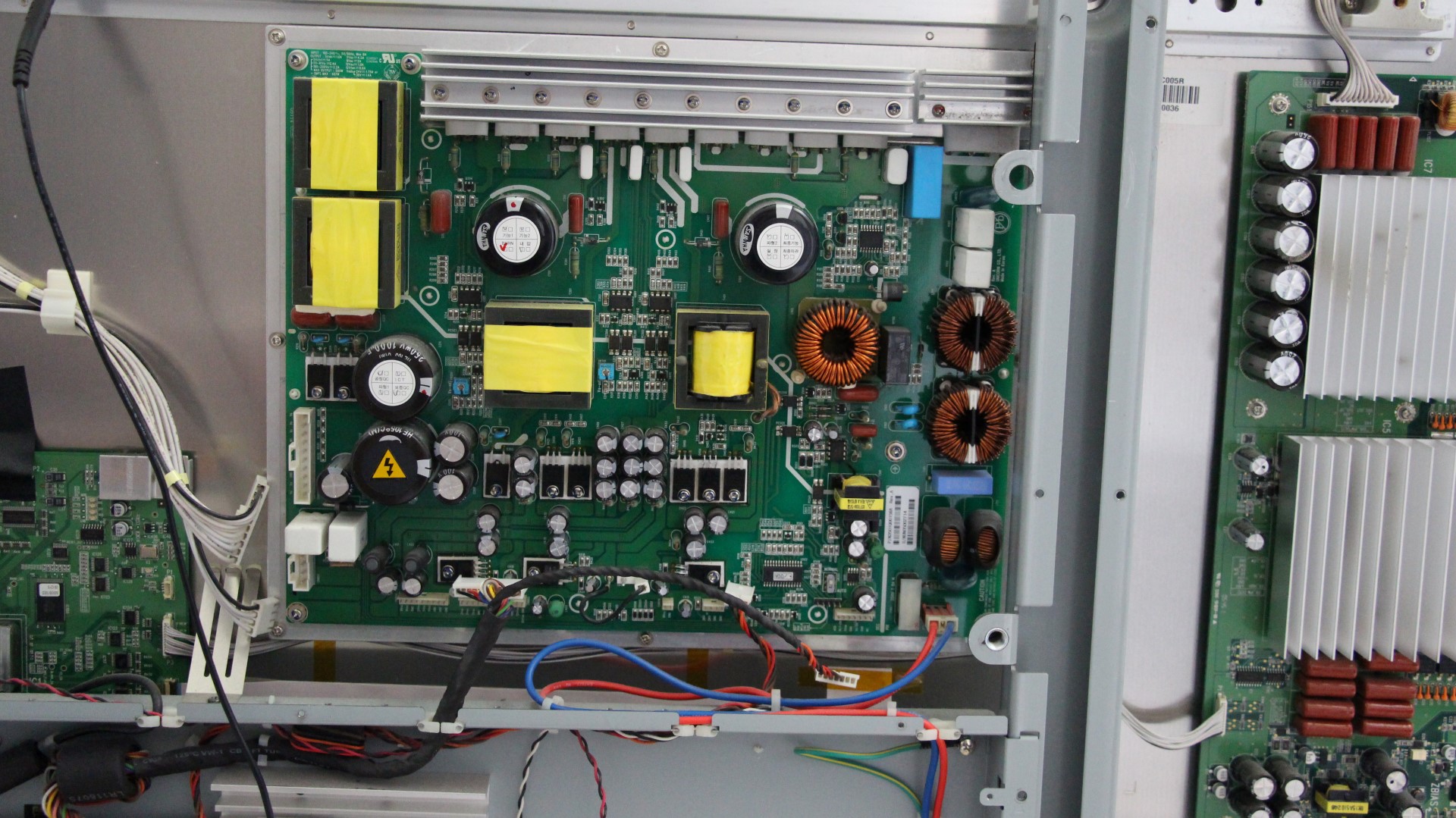

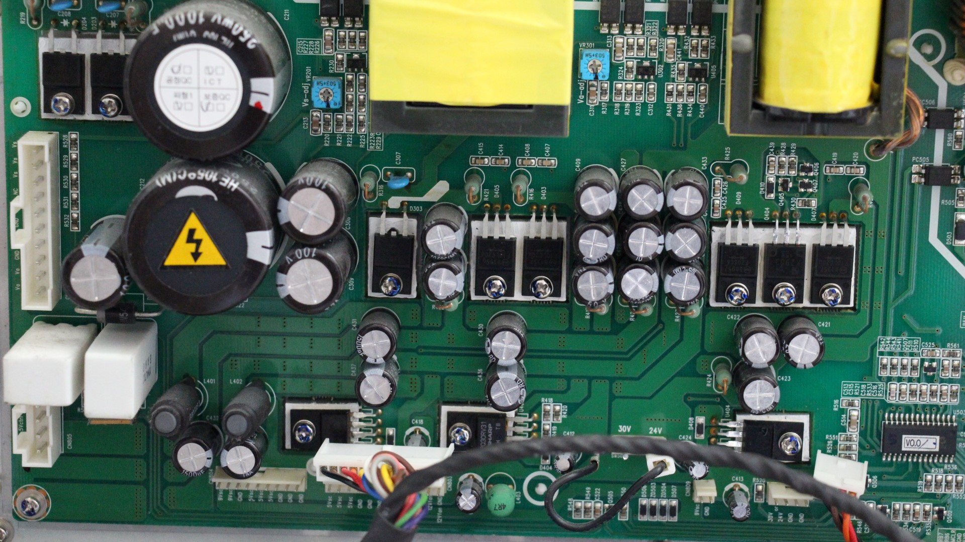

                    Time to dig up an old thread - new y-sus and buffer boards had this guy going really well, just light use in a spare room. Until now, it seems to have a power supply failure this time. When I power it on, it tries to cycle up and clicks a few times on and off, on and off, then finally gives up. Checking things out, it's blowing a fuse on the y-sus board. Further checking shows that some of the 5v (not 5vsb) is shorted to ground. I completely isolated the power supply, and the short is happening there.
                    So my question is - does this seem right? No other voltages exhibit this short, and not the 5vsb. I find it in two different places, see pics. One is labeled 5vsc and the other is 5vctrl. Could it be as simple as a power supply? Nothing obviously bad on the board, but if there's anything I can test on it then I'm game. And as always, I appreciate the assistance I always get here!

                      I should note that in the second picture, the 5vsc is actually on the connector you can barely see at the right. The connector completely in frame isn't actually used.

                        A quick update - all 5v, except for 5vsb, is shorted to ground. So is there any non-common point in the 5v rail that differentiates between standard 5v and the standby 5v?

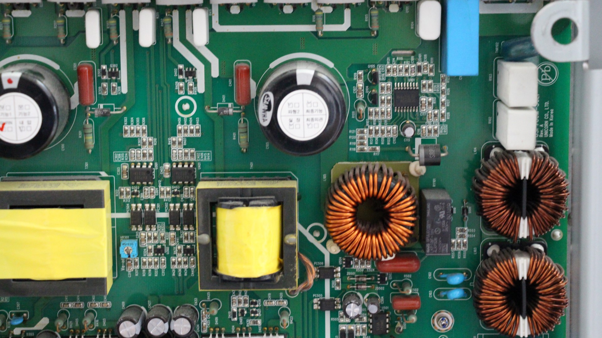

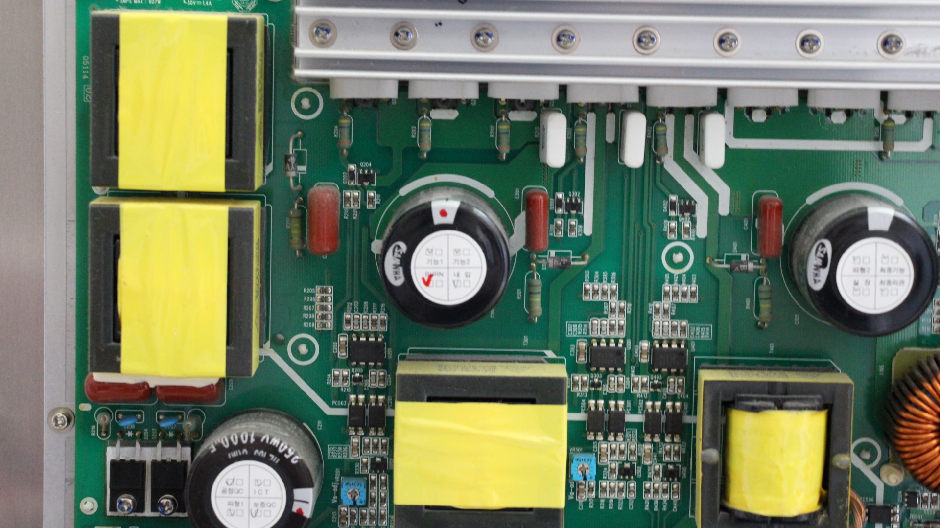

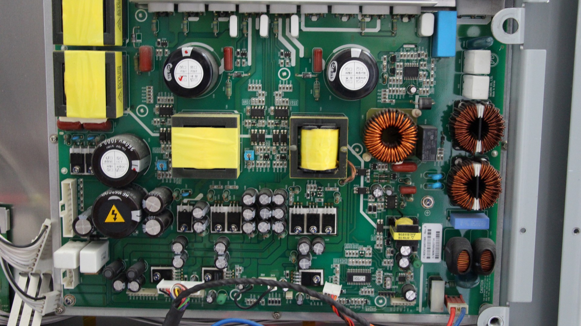

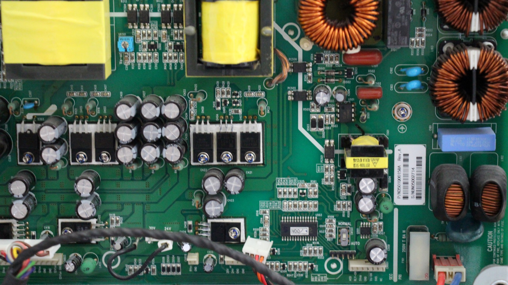

                          Re: p50hdtv10a flickering with sound with Y-sus ticking
                          Pictures of the power supply, in case it helps. Some overall, beginning at the upper left and going clockwise to the lower left.

                            I started tracing back the 5v line from one of the connectors. It's short all the way back to the smaller of the large transformers, T401 (center of the board). All pins on that side of the transformer have continuity, however it could be bleeding back from some other short (failed, cap, etc). Are there any obvious things to check in this circuit? As stated earlier, 5vsb is fine, but all other 5v is shorted to ground.
