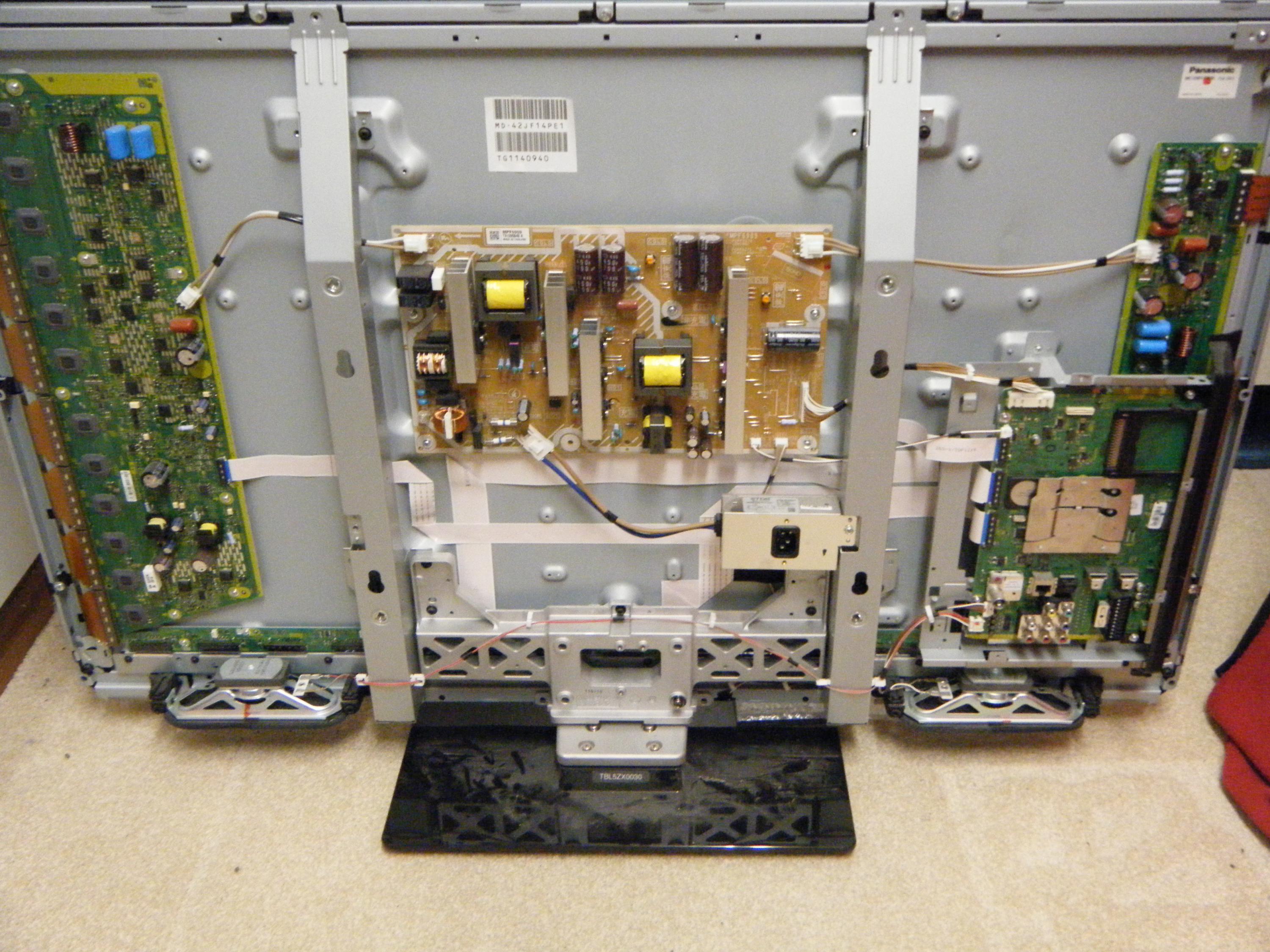

    Hi Guys,
    Just bought a Panasonic TX-P42U30B to be used in the bedroom from a guy for £40.00 as not working. Basically you power it up you hear a relay clicking a few times the green light flashes and then nothing. I was hoping bad caps but when I stripped it they all seem OK.
    So I started to check for voltages, I put one probe onto the chassis and checked for voltages coming from bottom right connector on PSU to main PCB and the top left and top right connectors on PSU going to the inverters? (I guess it cant have two inverter PCB's). All I was getting was MV.
    I have a digitial meter happy to recheck voltages etc.
    Help Andy

    It's most likely an A board fault.

      HI Tom, Which board is the A board please?
        Re: Panasonic TX-P42U30B green light flashes no picture
        The one with the video inputs on it.

          OK, Is there a way to prove it? would it be wise to remove connectors etc and check voltages?
          Andy
            Unplug SC power: should go to 6/7 blinks.
            Reconnect SC, Unplug SS: should go to 8 blinks.
            That eliminates the sustain boards, but doesn't totally rule out another board causing issues. If no error codes fire up it's most likely an A board fault.

              Hi Tom, Which PCB is SC and SS ?
              Andy
                SC = SN on this, left of screen connected to panel ribbons.
                SS = right of screen connected to panel ribbons.
                Do not unplug panel ribbons or white flex cable.

                        hi tom i have the same problem but green light stays on unpluged sn 7 blinks but when i unpluged ss no change does this mean faulty ss board?
                          Probably SN, check for shorted IGBTs/FETs.

                            hi tom sorry when i unplug the ss when i say no change i meant the i get the green light just staying on no but not the 8 blink fault code.

                                sorted this one now faulty ss board had shorted IGBTs/FETs. sent off for repair refitted and bingo all up and working! thanks guys for your help
