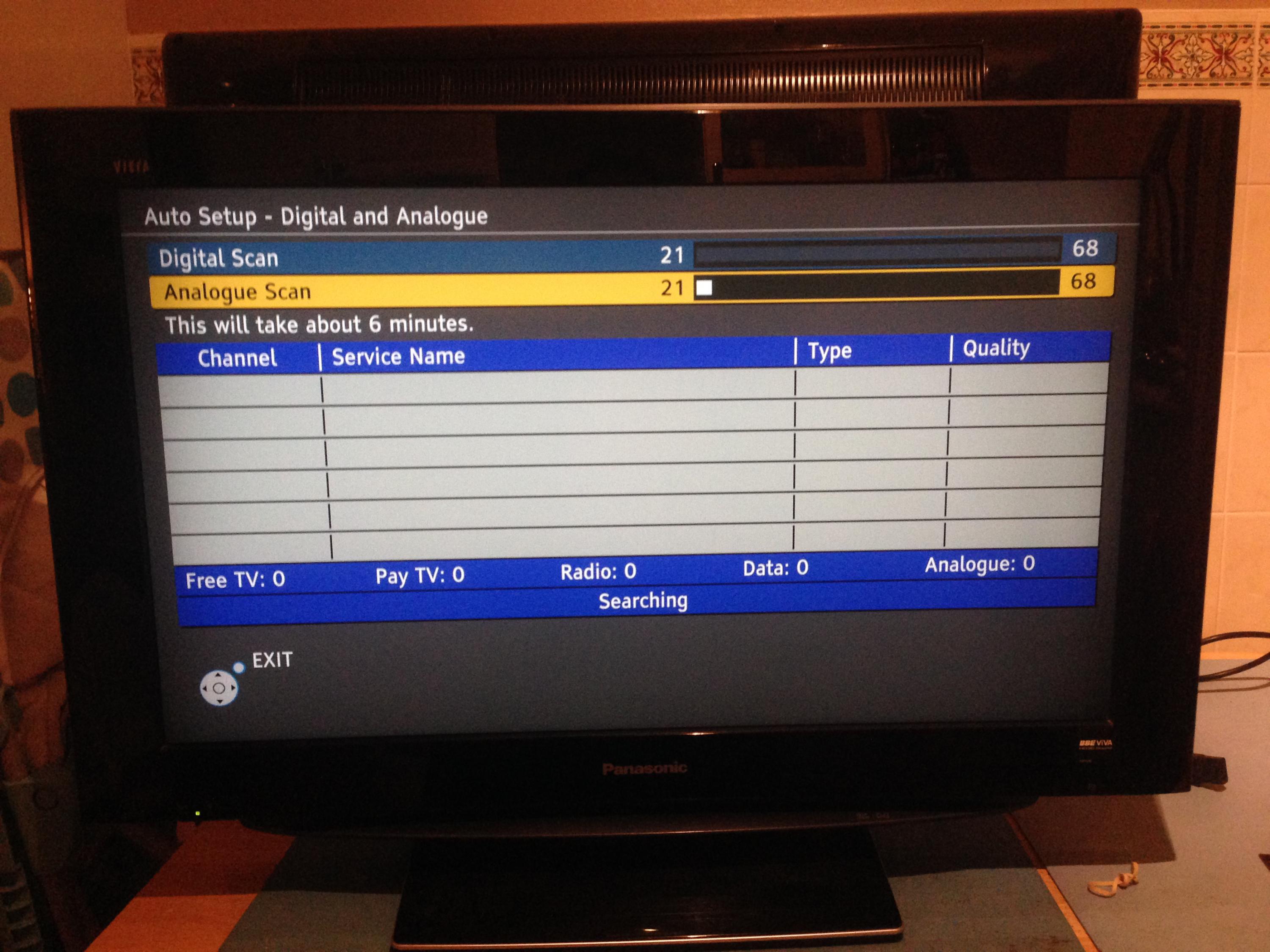

    Just picked this up, very local to me. Fault was originally described as no picture and I was about to diagnose a bad inverter until I saw this TV does have a backlight, it's just incredibly dark because it's an IPS panel (very high contrast ratio, but also lower brightness.) I might try increasing the current control on the inverter board to see if the brightness will go up a bit more.

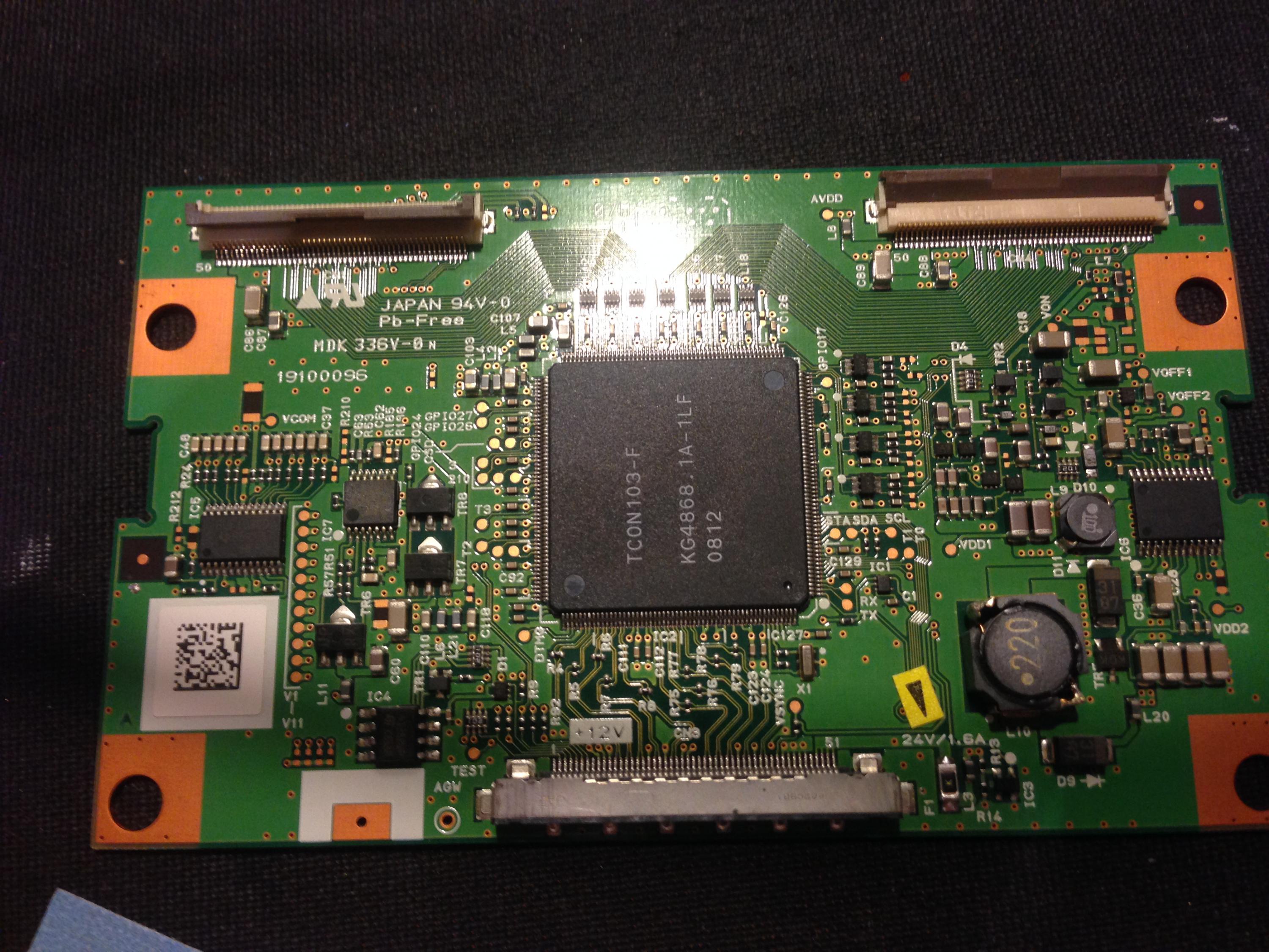

    Found the t-con fuse to be blown. Replace that and it worked.
    Wish I could make it more glamorous but hard to go wrong with a 32 inch Full HD Panasonic like this, they're very well built. 2008 series. Picture is no where near as good as my PZ80 plasma though! Panel is a Panasonic too; IPS Alpha tech.

    I've got a the exact same model of TV as this and it has the exact same problem. Can you tell me where the T-Con fuse you talk about is located ?
    Many thanks
    Mark
      Re: Panasonic TX-32LZD80 backlight no picture (fixed)
      It's right near the LVDS connector, little black thing. No photos of it, sorry. But it is obvious.

                      Hi guys where did you purchase the replacement fuse as I have the same set with same problem.
                      Thanks in advance.
                      @safesurfer65 if you still need a pic I can upload one for you.
                        CPC stock them. Is there a rating, e.g. 1.3A 32V(T) printed next to the fuse? Or alternatively, a letter on the fuse?
                          Yes Tom, it's 24v / 1.6A. PN or txt on the comp body is I62 NCC hard to make our as it's so small , 1206 package I think.

                            I think I ended up using a 1.5A fuse
                            http://cpc.farnell.com/multicomp/mc1...-5a/dp/FF02271
                            Min order with CPC is £5 now so you may have to add some solder wick or other things to the order.

                                [UPDATE FIXED]
                                Well fuses arrived replaced and all working perfect.
                                T-CON - 19100096 MDK 336V-0
