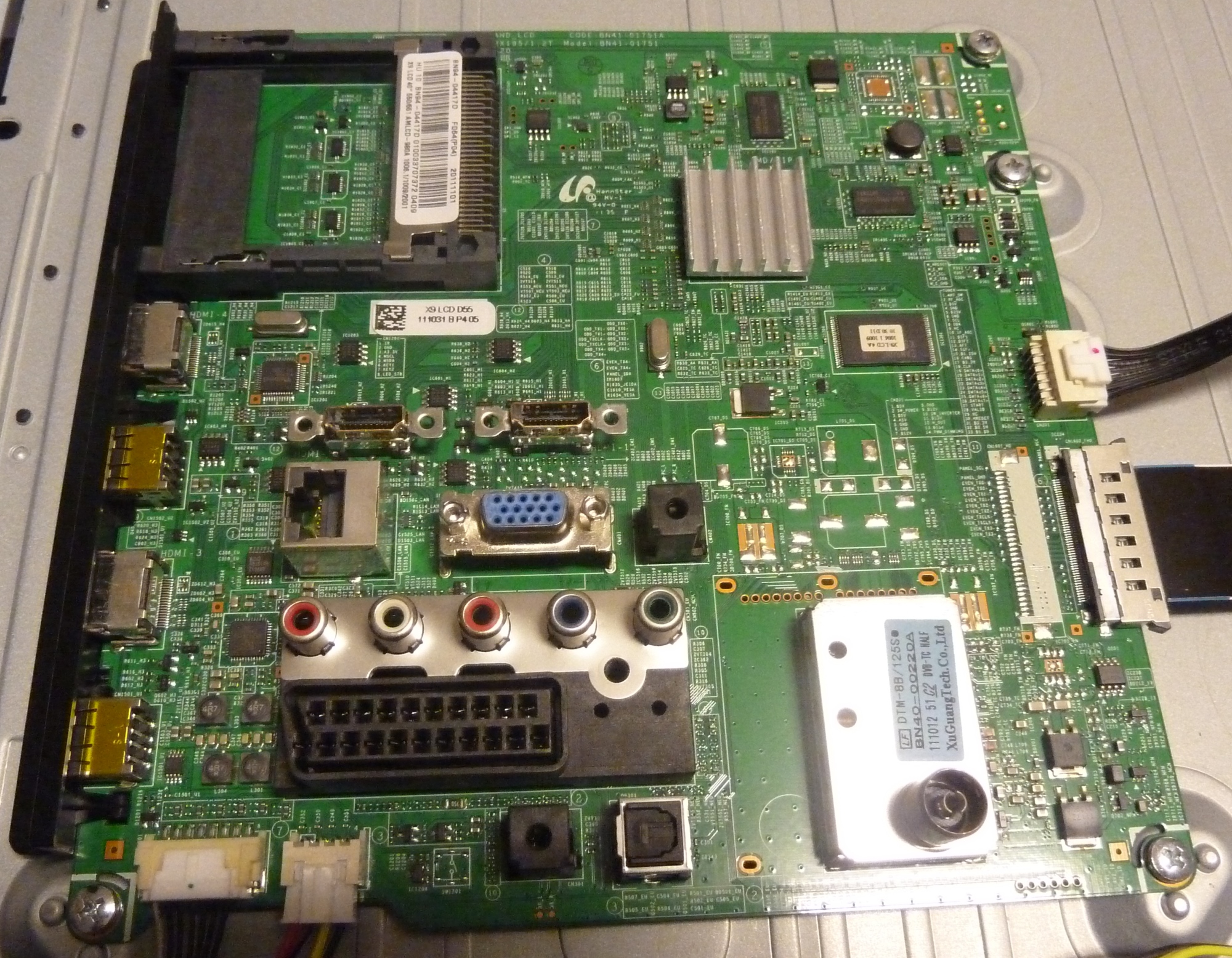

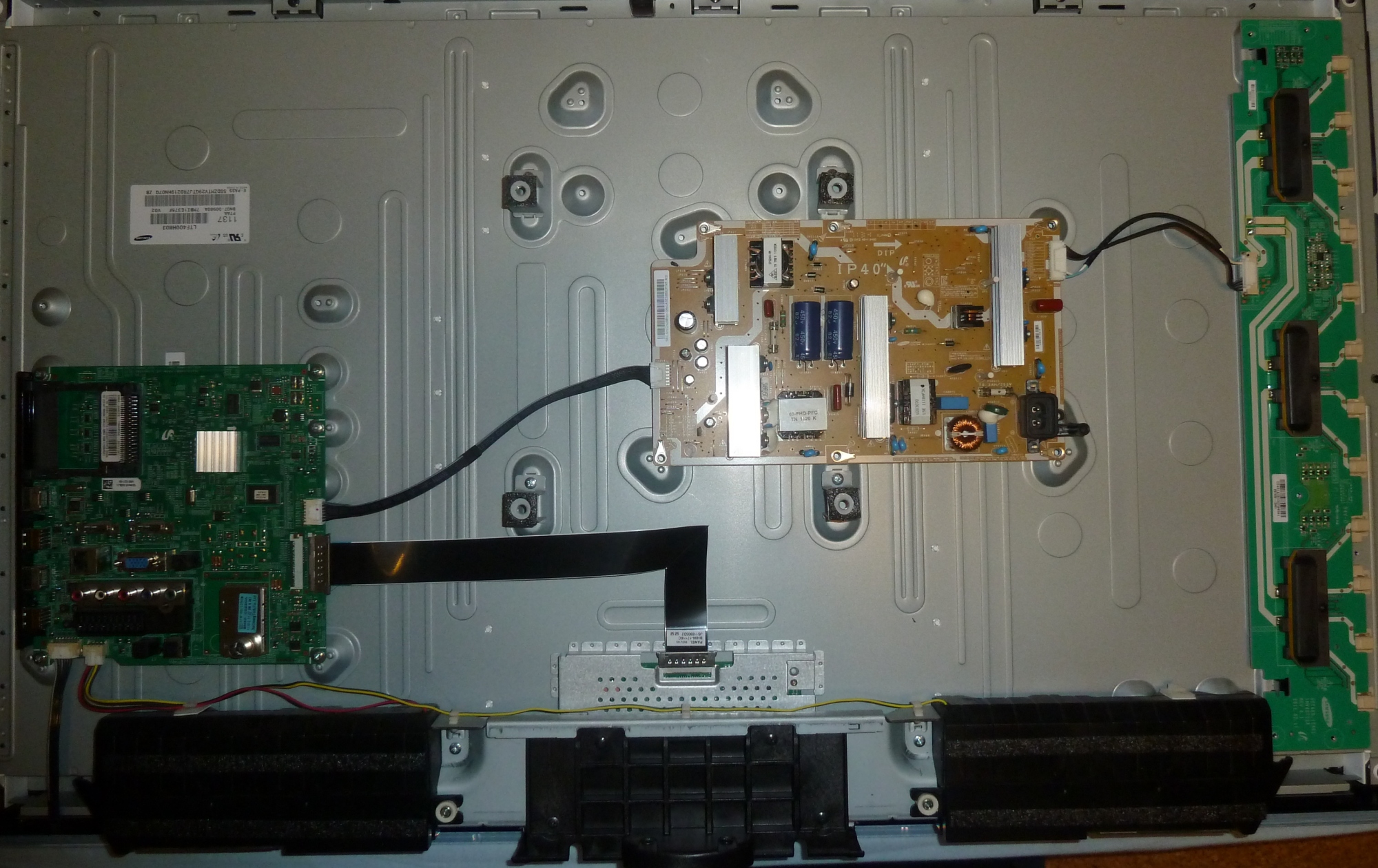

    TV starts up, shows picture (checked with flashlight) and plays sound but the backlight doesn't come on. Very seldom the backlight flickers for a few seconds (usually a few minutes after being powered on).
    Part # (Haven't found any matching datasheets so far.)
    PSU: BN44-00440A
    MainBoard: BN41-01751

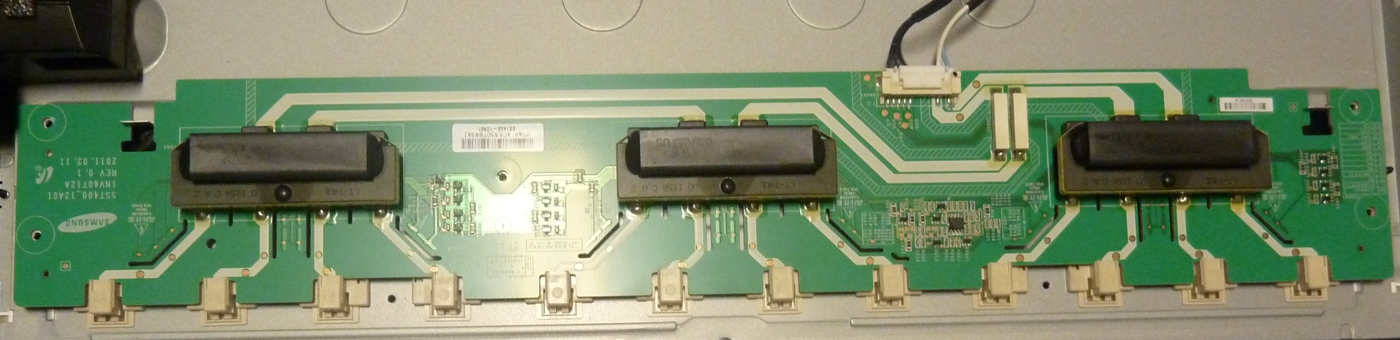

    Inverter: SST400_12A01 INV40T12A

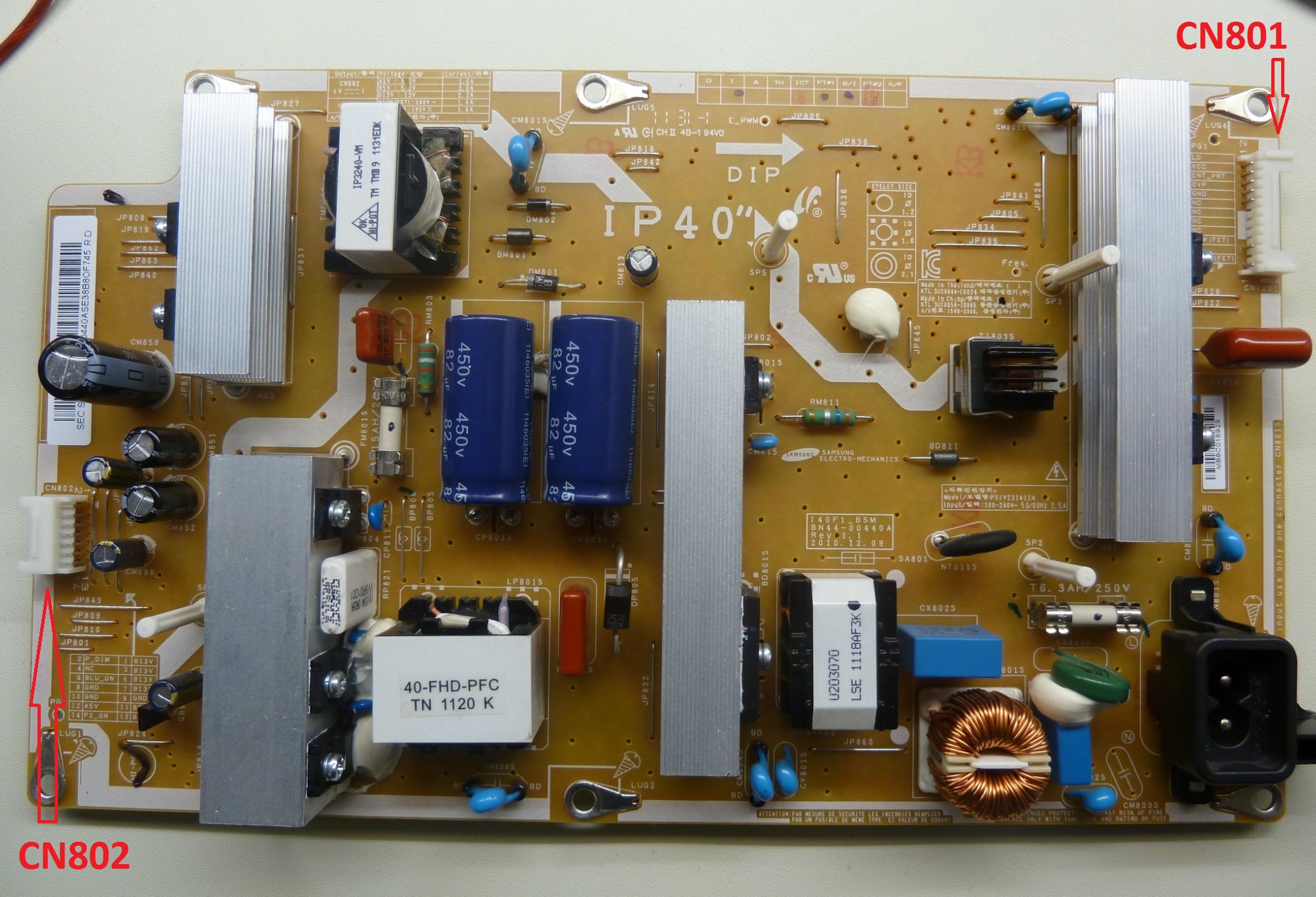

    3) Measured voltages. The 13V lane seems a bit low but should be OK I think? High Voltage towards the inverter is missing.
    Main Caps: 390V
    CN801 (towards inverter - see attachment - not listed Pins are NC)
    Pin# Label: measured voltage (target voltage)
    1 High(FET): 0V (280VAC)
    3 Low(FET): 0V (190V ACDC?)
    8 GND: 0V (0V)
    9 OVP: 0V (?V) (Seems to be a backlight-confirm Signal.)
    10 CNT_PRT: 11.79V (?V)
    11 VCC: 12.38V (13V)
    12 LD: 11.04V (?V)
    CN802 (towards main/interface -board)
    1, 3, 5, 7 B13V: 12.38V (13V)
    2 P_DIM: 1.43V
    6 BLU_ON: 5.07V
    8, 9, 10 GND: 0V (0V)
    11, 13 B5V: 5.2V (5.3V)
    12 A5V: 5.2V (5.3V)

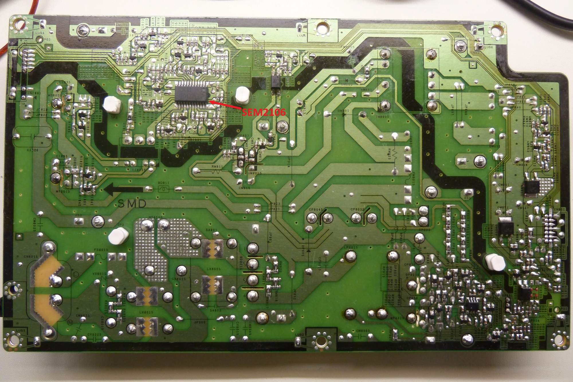

    4) Checked the two MOSFETS (MI801S, MI802S) that drive the Inverter. Both are OK!
    Realised there is no voltage at the gate pin of the MOSFETS.
    5) Traced it back to UI801 - marking is SEM2106 1132 - found a datasheet (attached).
    6) Measured voltages on SEM2106.
    Pin1,24 VREF,P_DIM: 0.7V
    Pin14 VCC: 12.36V
    Pin16 Enable: 4.91V
    Pin 12,13 N1,N2: 0V (These are connected to a tiny transformer that drives the two aforementioned MOSFETS)
    Everything seems to point towards the SEM2106 being damaged but would that result in a sporadically flickering backlight?

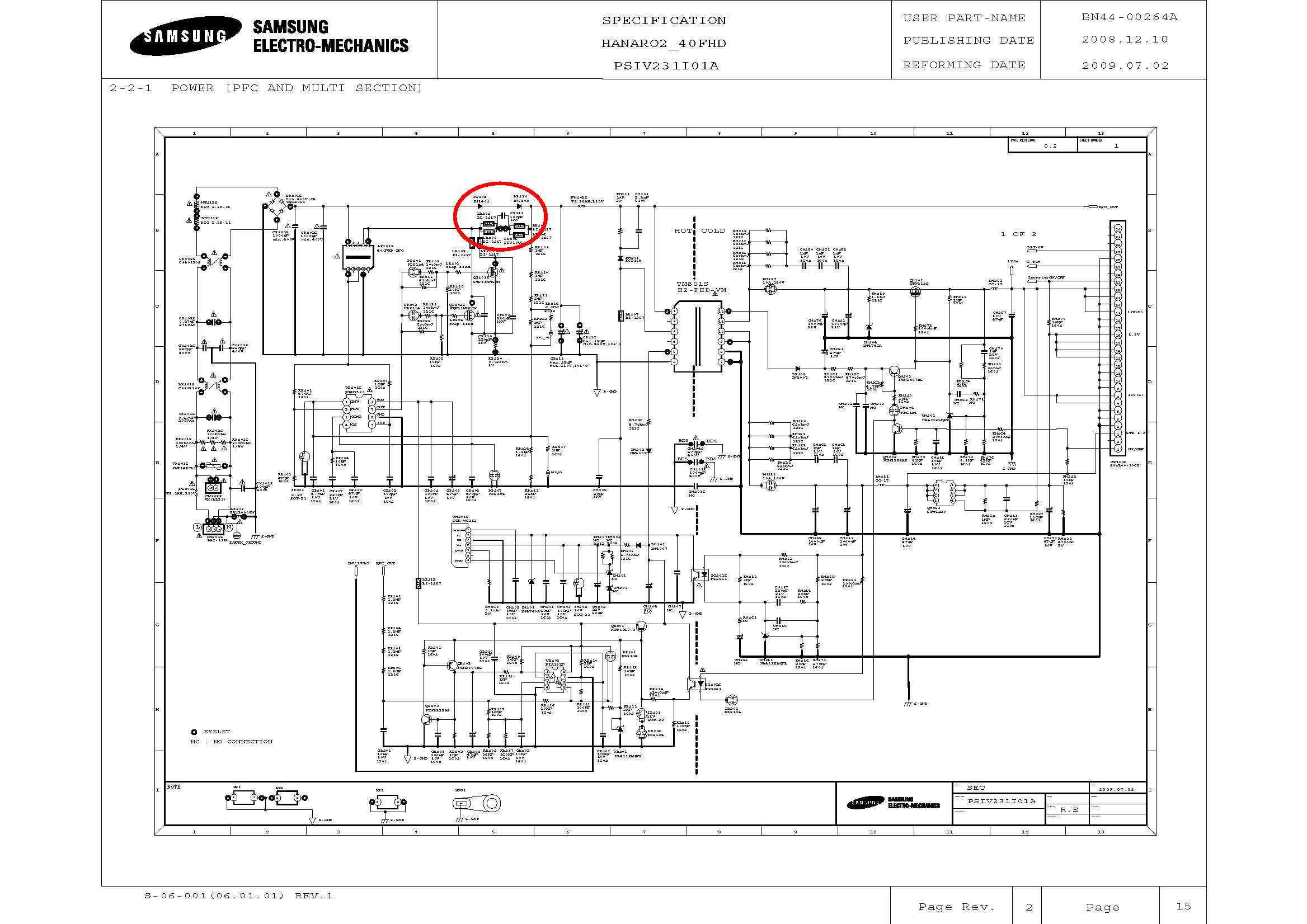

    Did you solve your problem? I have the same issue, but in my power board (same as yours) I found capacitor CP811 completly fried.
    do you happen to know the specs for that capacitor?
      Re: Samsung LE40D550K1W no backlight
      The snubber cap (in parallel with the Diode DP804) CP811 for the PFC Diode DP804 is 100pf 1KV ceramic cap.
      See similar cap CP811 used in the similar circuit.
      • luisparada
        • Nov 2013
        • 2
        • Mexico
        Thank you a lot for your help! I made a quick call to my local store, would a 100pf/500 V work?
          No, do not go lower than 1000V rating
            Hi luisparada, sorry for the late reply...
            I just took a look at CP811 and on my board the value is 220pF ±10%/1kV, if I decoded the markings correctly. The complete marking is "LB 221K 1KV".
                Problem solved.
                Since replacing UI801 didn't fix my problem I started checking the diodes and z-diodes around it.
                Sure enough one of the zeners was broken. ZDI805 a 6.8V zener had a breakdown voltage of ~4.5V.
                Replaced it and now everything works.
