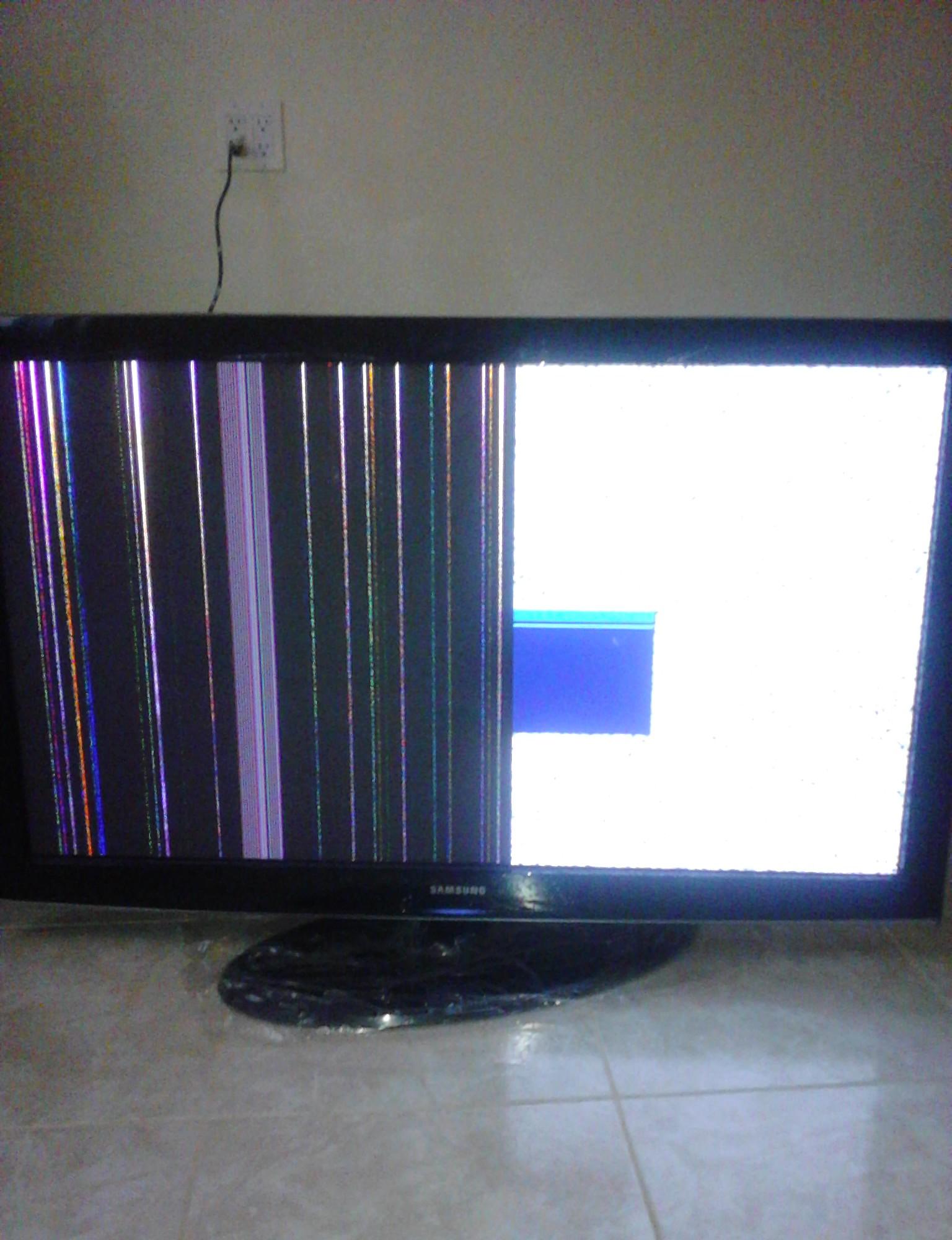

    Samsung Plasma PN50A450P
    Does this look like a bad panel too?
    Re: Samsung Plasma PN50A450P
    Very, very dead panel. The only way that could happen is if the user unplugged the Va panel power and plugged in while the set was running, perhaps in an attempt to diagnose fault.
