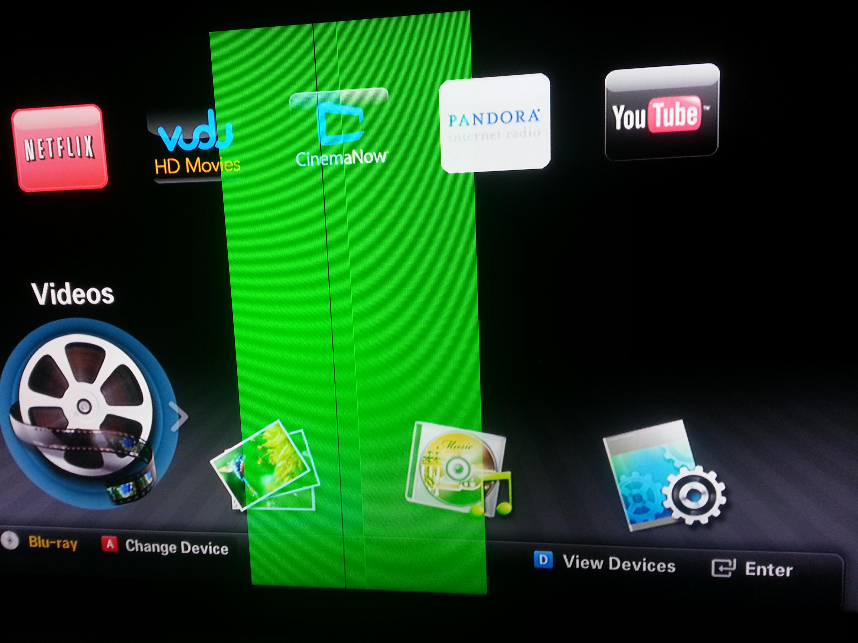

    Samsung LN52A580P6F
    I'm attempting to repair this problem. Trying to figure out where to start. Anyone see this specific issue before? Green vetrical lines near the center of the screen. Tab bonds? T-con board? Panel? Thanks.

    Re: Samsung LN52A580P6F
    Bad panel
      You could try reseating the ribbon cables to the panel from the tcon and also reseat the lvds cable.
