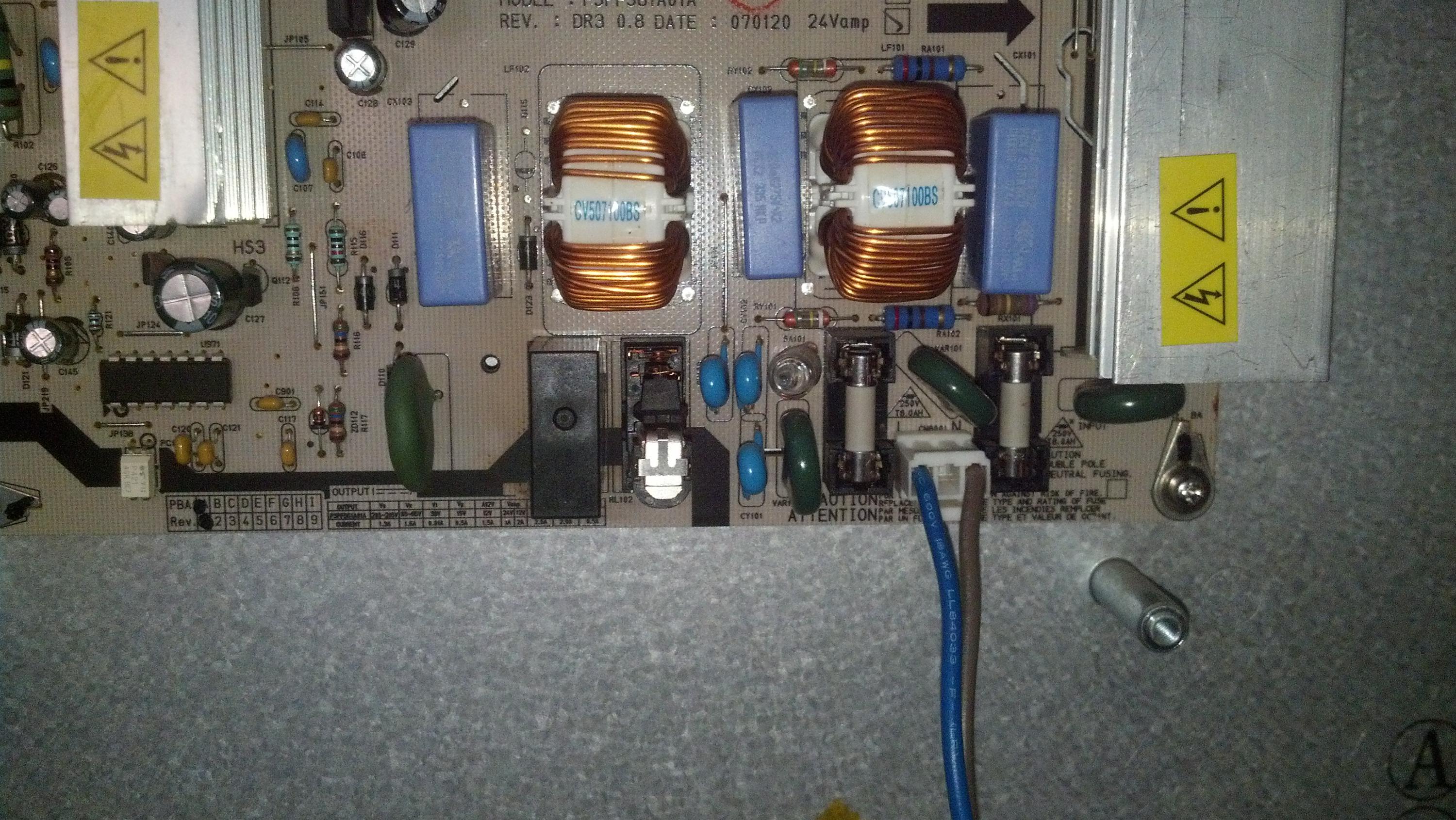

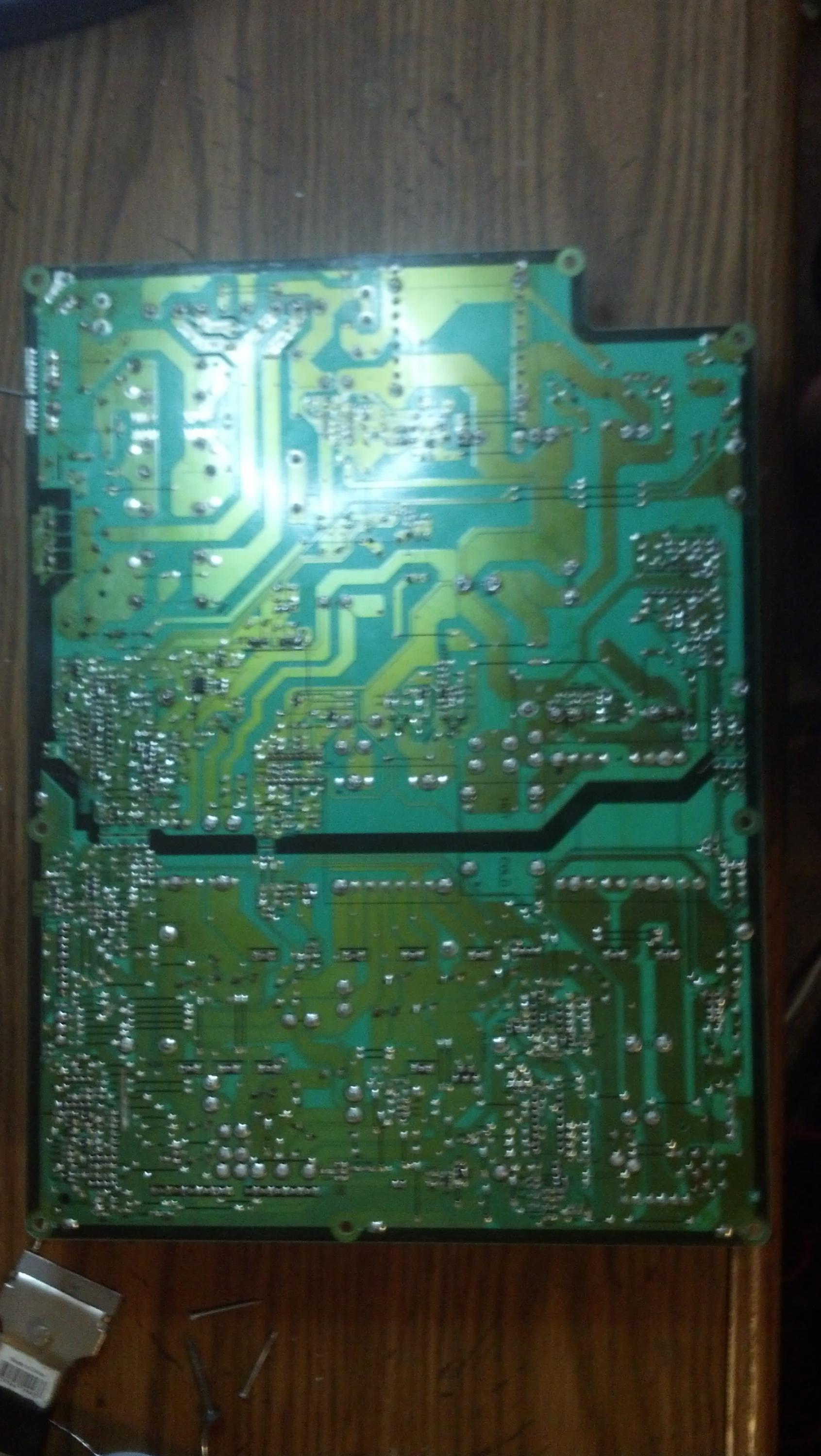

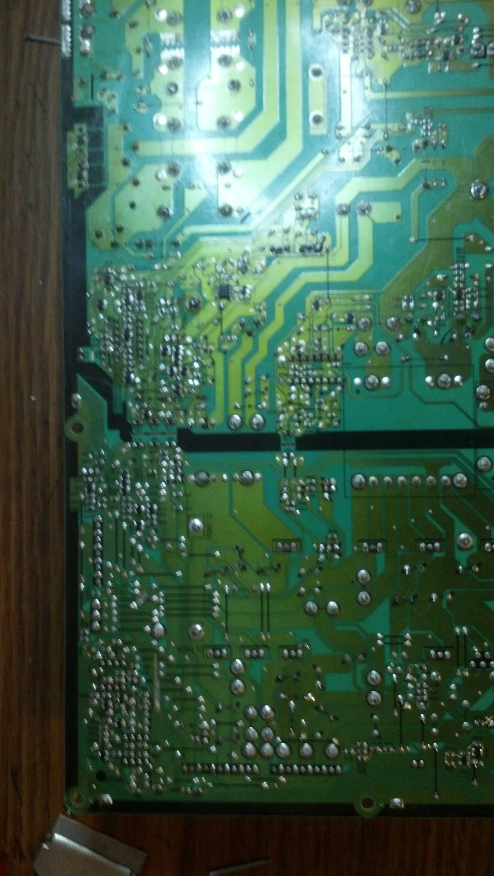

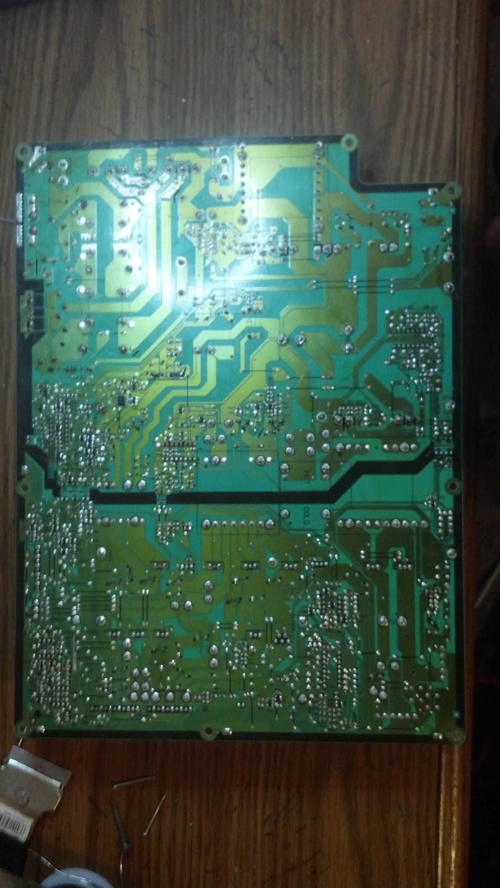

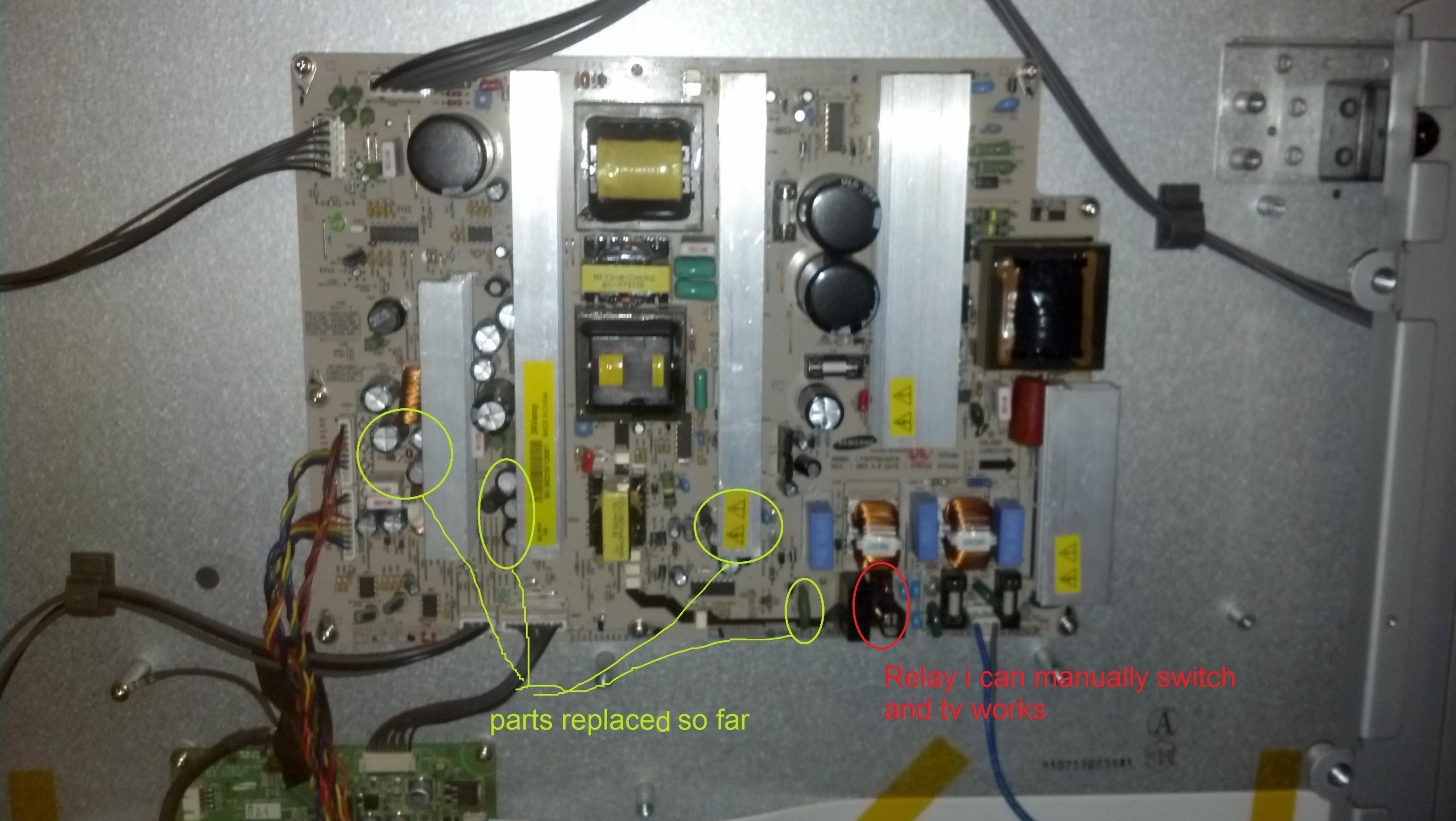

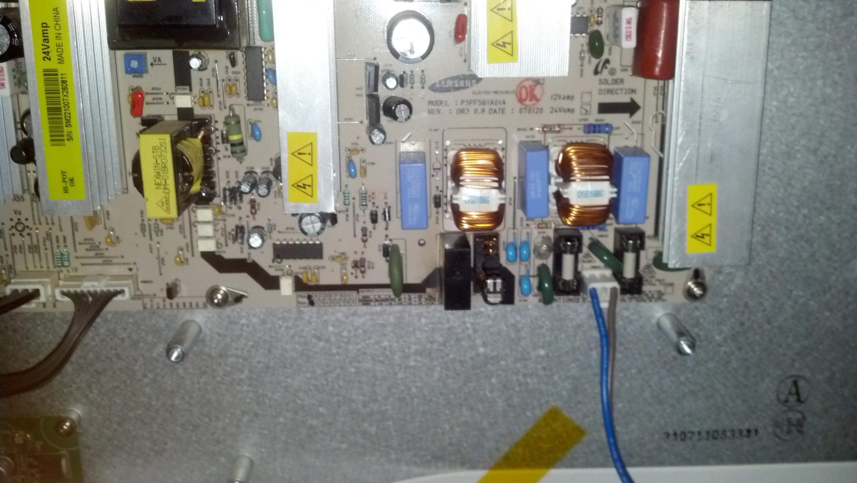

    me vs plasma well plasma is winning ok I have a vp50 hdtv20a.... What ive replaced Several caps, sck 206, 1 fet all circled in pic below ok issue now relay not engaging (now I know I shouldn't have but when I manually engage relay tv works but if I do not manually engage tv does not turn on and green light blinks once for VA UVP still very new at this so any guidance would be greatly appreciated..
