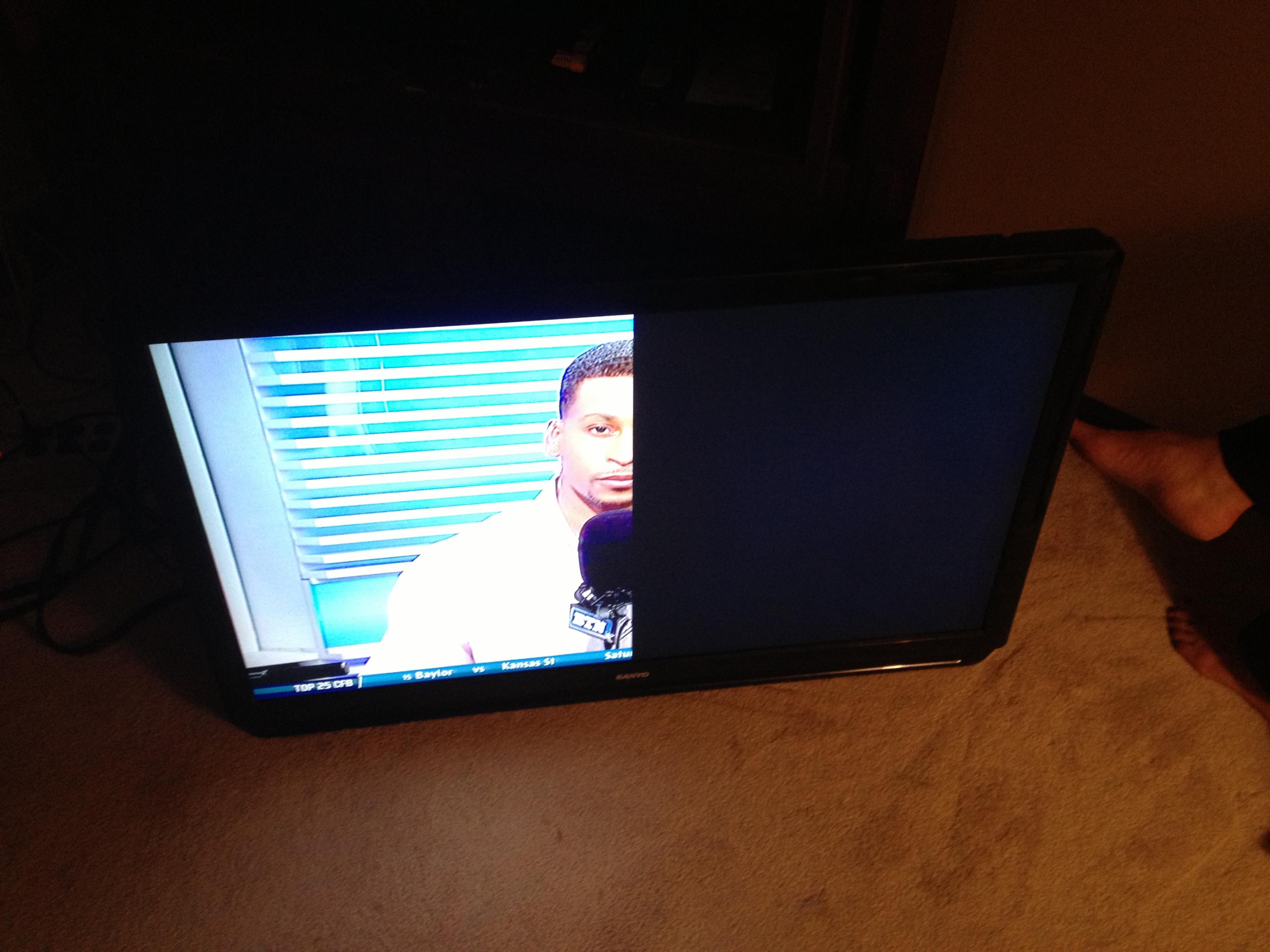

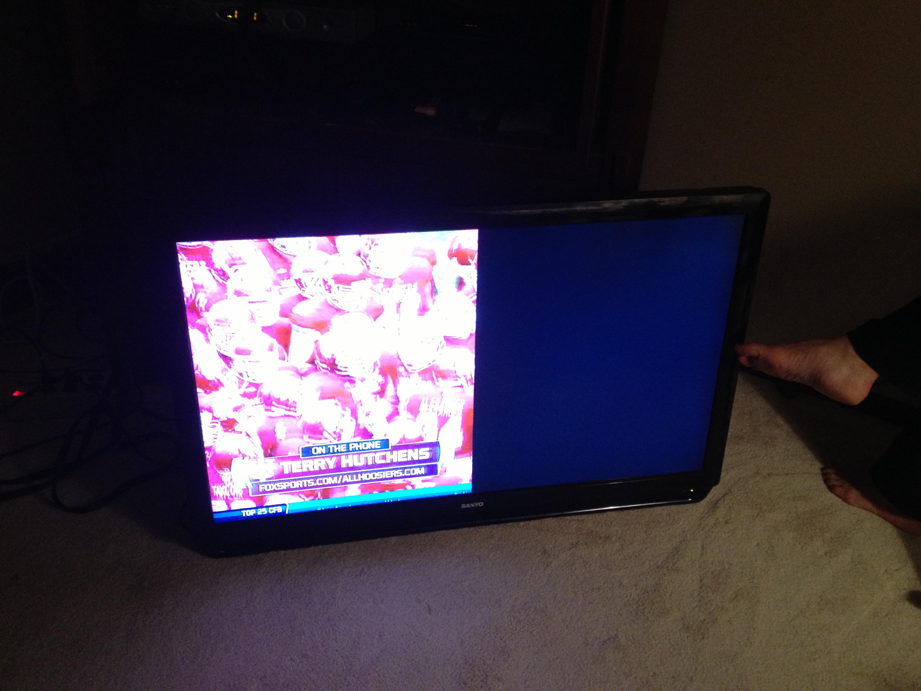

    So now I am tackling my first LCD. I have raster (grey background) on 100% of screen with no signal applied. When I add a video signal, I only get half screen. I see on the other posts here that this model has t-con issues. Any other suggestions what to try first? Thanks for any input, I am in uncharted waters for me. Up until now I have been a plasma geek!

      Well I cannot guarantee that this is a tab bond issue. At least yet. Thus could be a tcon board fault but really the only way ro tell is a tcon board replacement. Looks as if no voltage is getting to right panel board. Check upper panel address board for bad solder connections. This board is only accessable if you pull off the frame of the panel unfortunately.

                This fault is almost always tab bonds, I bet this TV uses AUO 42" panel, which has common fault with left or right tab bond. Just press on the bond with the frame off & picture should sort itself out. See video for similar fault/diagnosis/repair:
                https://www.youtube.com/watch?v=purk_SyiT44
                I have done LG 42" 42LH3000 with tab bond issue on left half of panel.

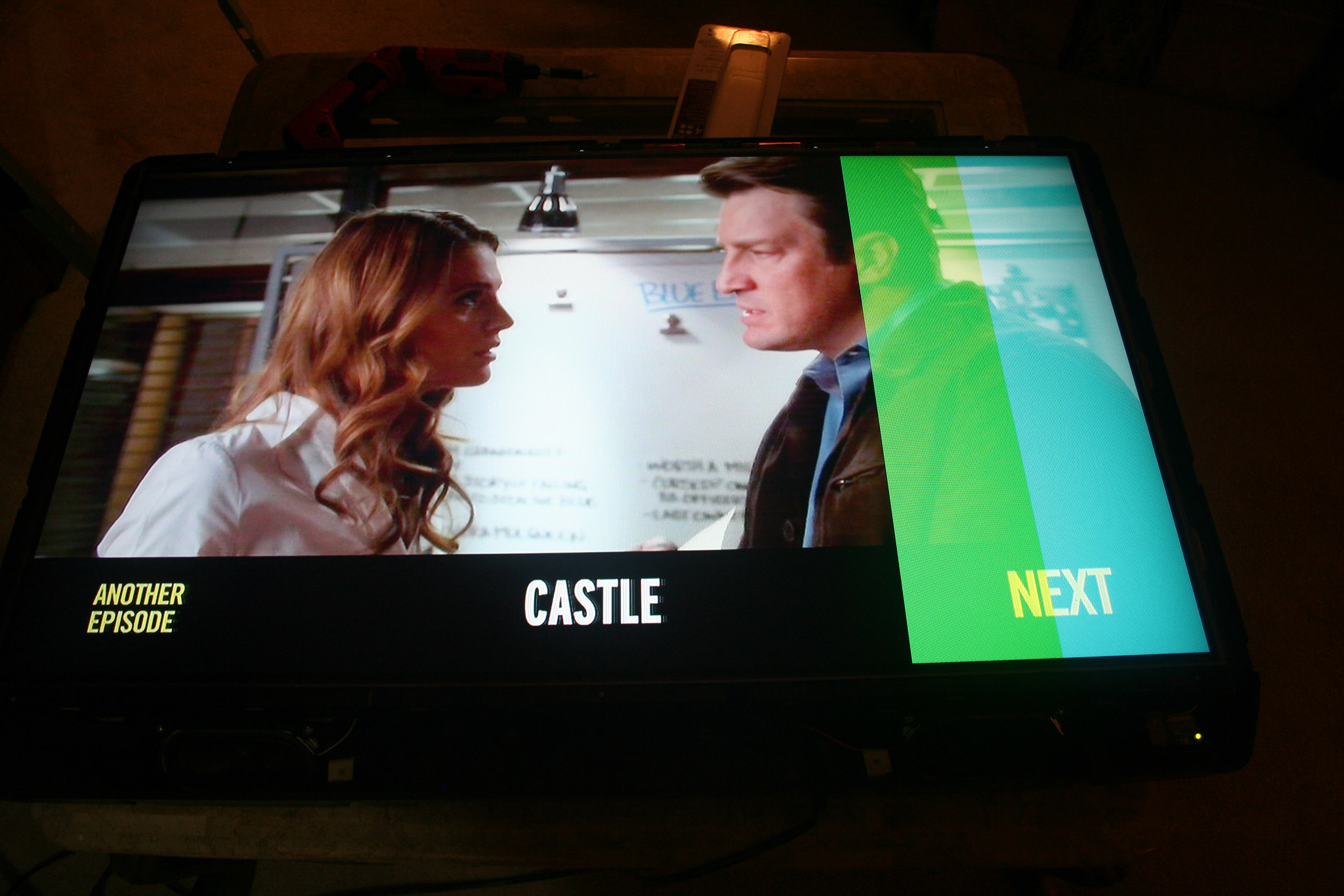

                      Finally got time to prop this set face up with the bezel pulled off. I left all but 4 screws holding the back to the bezel and flipped it on it's back. I pulled these 4 screws from below and then lifted the black bezel right off. I next had to pull the 12 screws that hold the metal LCD frame. And started to pull it off, but forgot about the tape that holds the tcon cover to the metal frame. After I pulled the tape off, the metal frame lifted strait up. I fired the set up and same as before, right side was black. I started pushing the ribbon tabs the way the video in tom66's post #8 explains. Bingo! the right half jumped around for a minute and then stayed lit!! Only issue is that the extreme right side has two large green and blue vertical bars running down the screen. Could this be a bad tcon board?? Your thoughts???
                        Re: Sanyo DP42849 LCD Half Screen 50 Cent..!
                        That could be a bad LCD panel, you just need to try pressing on all the tabs to see if it resolves itself. Not t-con issue.
