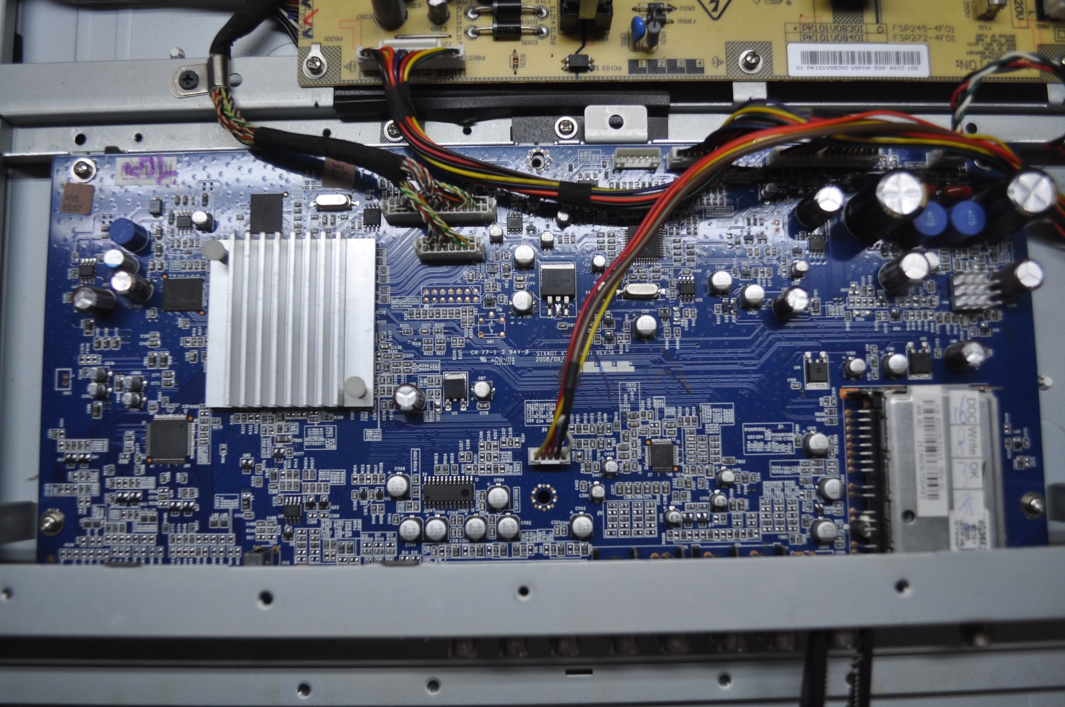

    I have a Toshiba 40rv525u that recently stopped working. The power LED will begin blinking immediately after the TV is plugged in. I don't believe it's blinking any kind of diagnostic code, as there is no pattern, it just blinks every couple seconds repeatedly. I have tried replacing the power board and the main board, but this did not solve my problem. I believe the problem is keeping the TV from it's normal start-up process, as there is absolutely no light from the panel or sound.

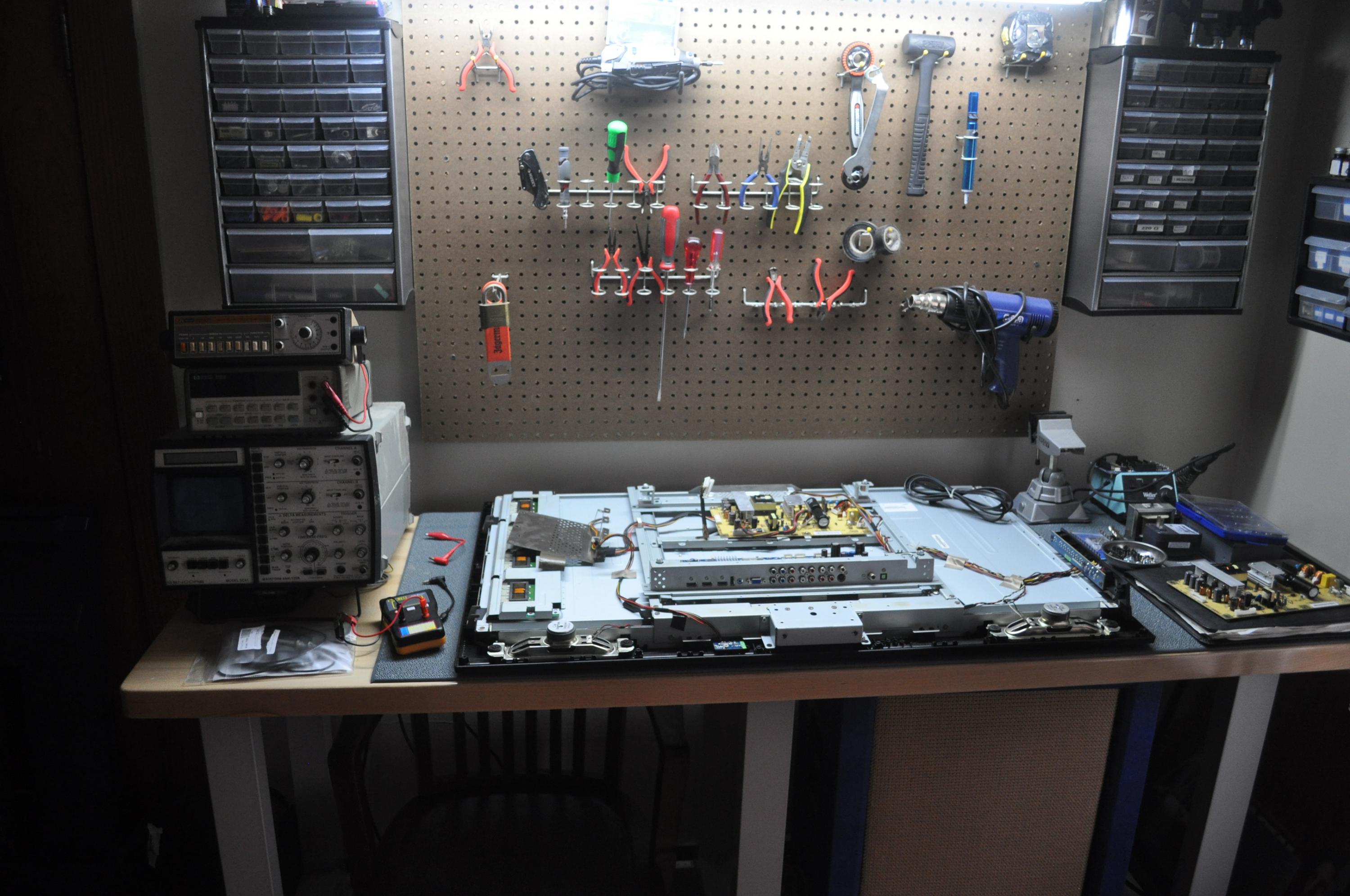

    I have attached a picture of my workbench with the TV open. I have a benchtop digital multimeter, oscilloscope, function generator, and an ESR meter. Believe it or not, even with all this equipment I have a limited electronics knowledge. So I have come here for assistance with diagnosing this TV. I will be quick to reply, and follow all directions and recommendations.

    Most Toshiba TV will have blinking LED during start up, it is doing self test mode, it can last as long as 30 seconds, then after 30 seconds if the TV will not start up then you will have to count the blinks to figure out the code.

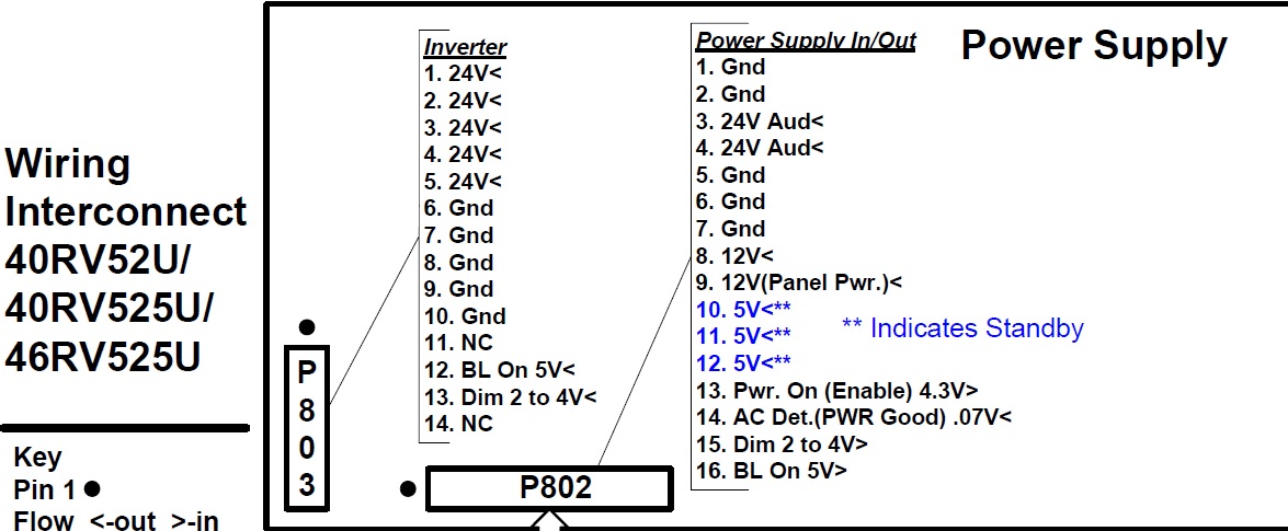

          Yes, I can check voltages. Please let me know if my answers are deficient or if I skipped any of the important voltages. I truly appreciate the attention on this. I attached a diagram of my power supply connectors to be sure we're on the same page.
          P803 pins 1-5 are all 24v, drop to 7v over about 1 second, then back up to 24v repeatedly
          P802 pins 8 and 9 are ~11v, drop to ~2v over about 1 second, then back up to ~11v
          P802 pins 10 and 11 fluctuate between 1v-5v.
          P802 pin 12 jumps between 50mv to 2v.

                    "P802 pin 12 jumps between 50mv to 2v." Pin 10~12 of P802 is the STBY 5V, it should be steady 5VDC.
                    So disconnect P802 to check and see if the 5V will be steady.

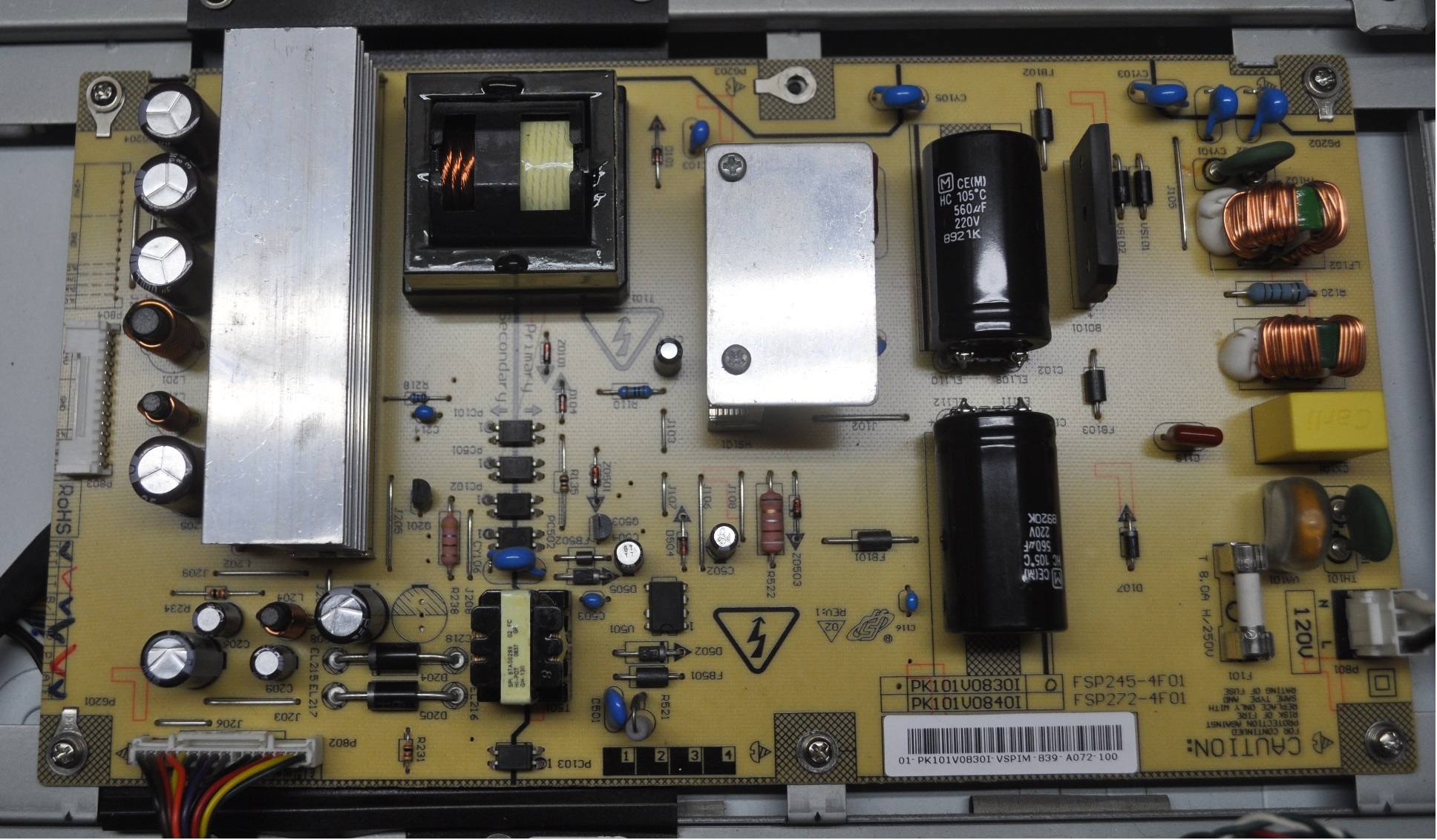

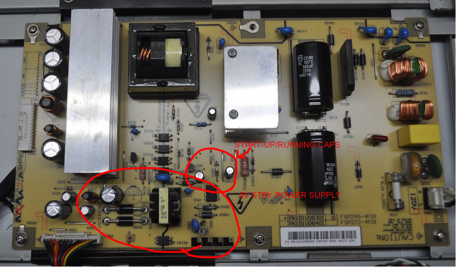

                                  By the way, are you able to count the blinking pattern? If it is the power supply problem, you can try changing those two caps.

                                    I purchased a 5ohm 10watt resistor today and tested pins 10-12 and (if I took the reading correctly) read a steady 5v. As far as the blinking pattern, I have not been able to recognize a pattern whatsoever. It blinks at a constant rate. I tried waiting 30 seconds, but nothing changes.
                                      Re: Toshiba 40rv525u power led flashing / will not come on
                                      So the power supply can handle 1A with no problem, that means the main board is drawing so much in standby mode that causes the 5V to be going up and down. Without the diagram it will be difficult to troubleshoot.

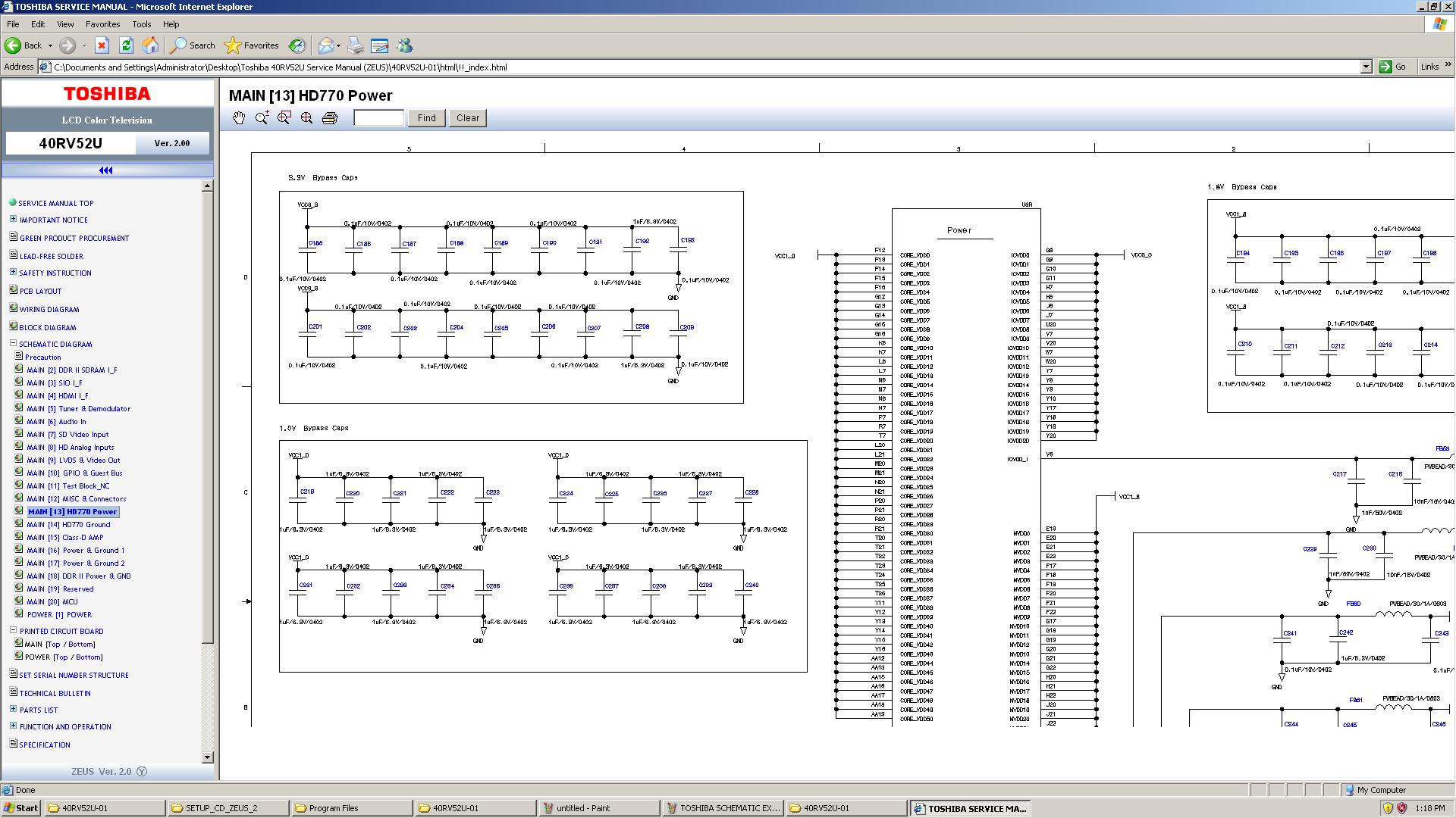

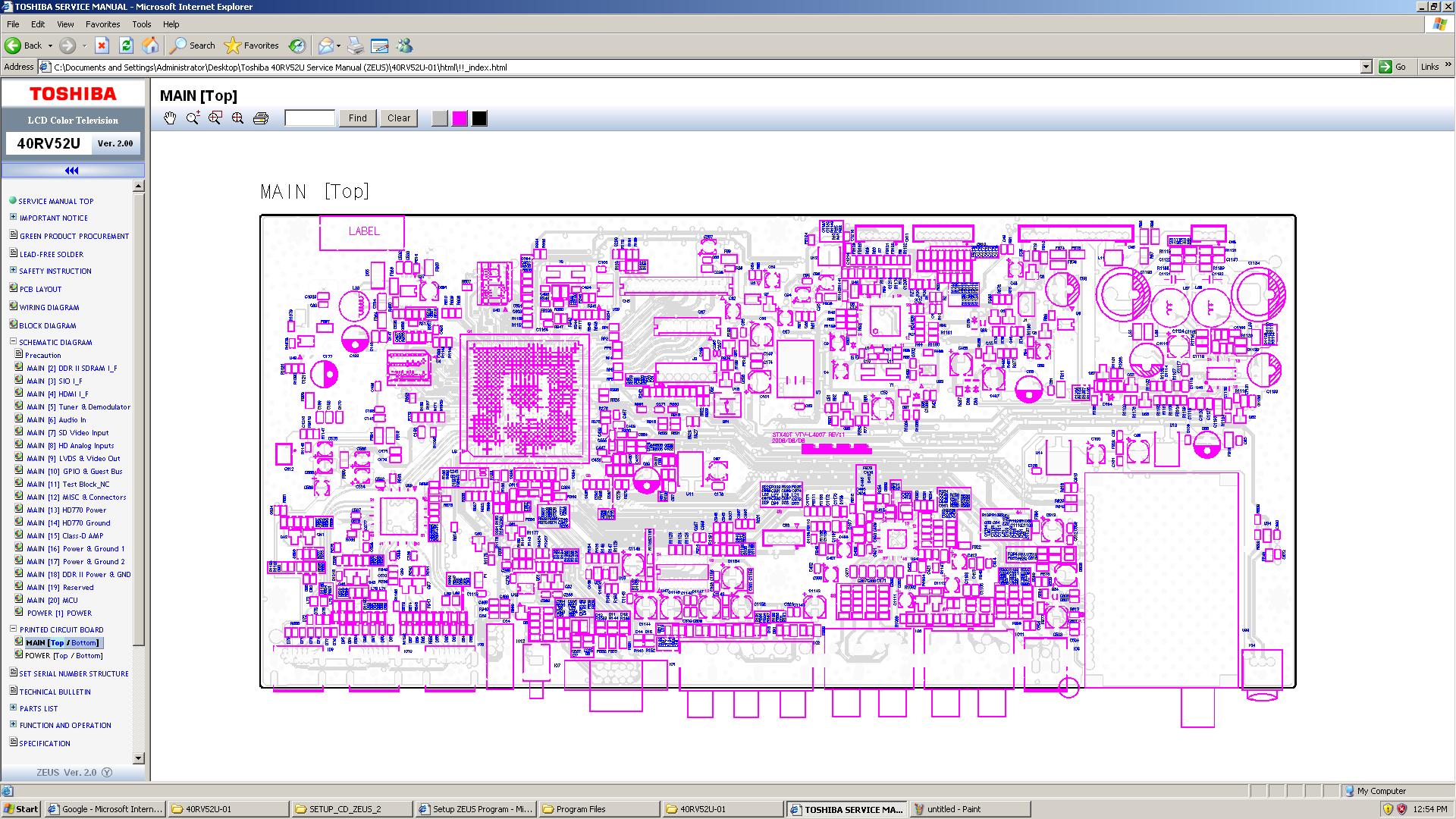

                                        I've tried for months to open this schematic, and I finally succeeded today!
                                        I've attached an image that shows you what the schematic looks like in the Toshiba ZEUS program. To open it I had to install a VMware virtual machine with Windows XP, IE6, ZEUS 2.0, and DWF Viewer 6.0 w/ zeus patch. IE took some tweaking as well. If you're willing to do all this I'll be more than happy to get you all the software you need, but if you'd rather direct me I can take screenshots of specific areas of the schematic. If that won't work well enough, I can go through the process of screenshotting about 1/6 of each image at a time and piecing together the individual images for the entire schematic (about 20 images total). The problem is the schematics are .DWF files, and there's so much information I can't just zoom out and take a screenshot or the values become distorted. Let me know what you need, I will provide it! Thanks again for the effort.
