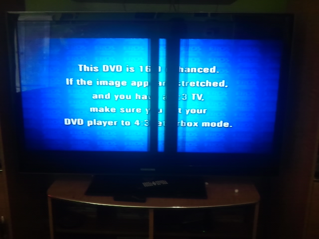

    LCD lines verticle 3- 2 inch black one has lines of color 1/4 inch wide
    is it the same repair as horiz. lines the t-con board

    Are the bars separate? Any chance of a picture?

      the bars are separate each about 2 inch a third with
      rows of pix wide multi color , pic fine outside of lines

        Could you supply us a picture of the fault?
        Did all the bars appear at once, or one after another?

          i dont know its the way i got it it will be there with any input
          ill check with the man it cam from thanks

            A picture would REALLY help us say if it's an unrepairable panel fault or not.

              i finally got a pic there are very small lines muti color on right of
              black bar the came on sudenly and did not get worse.
                Re: samsung LN55C63OK1F
                Looks like the LCD panel has gone, sorry.

                  its not going to be worth repairing? its less than 4 years old..

                    this is a very unfortunate thing that seems to happen to sub LCD panels early in life I have a 52 inch Samsung that has a similar problem except I have one solid Reds bar of multi colored lights it turns out that it has a bad tab
