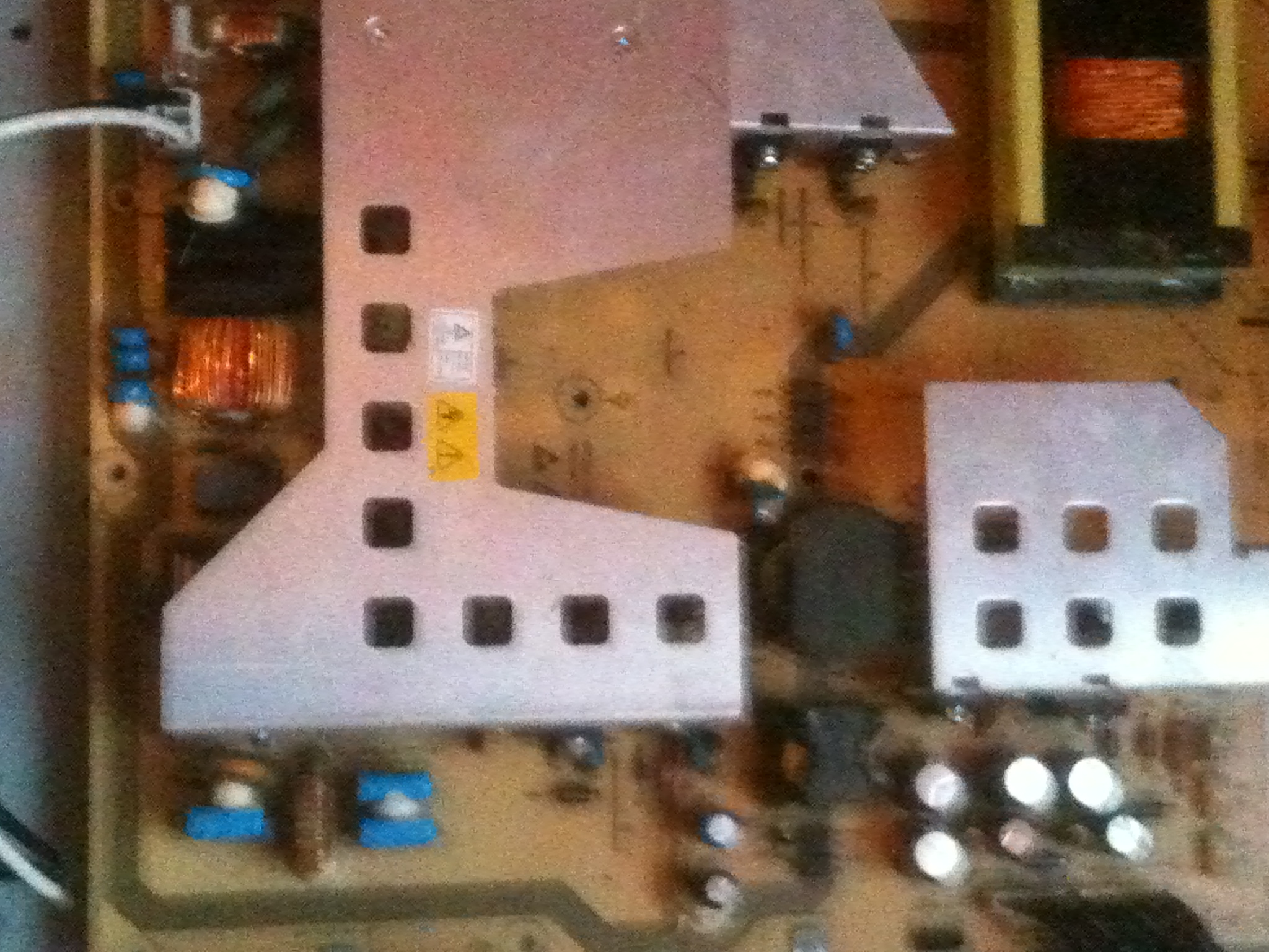

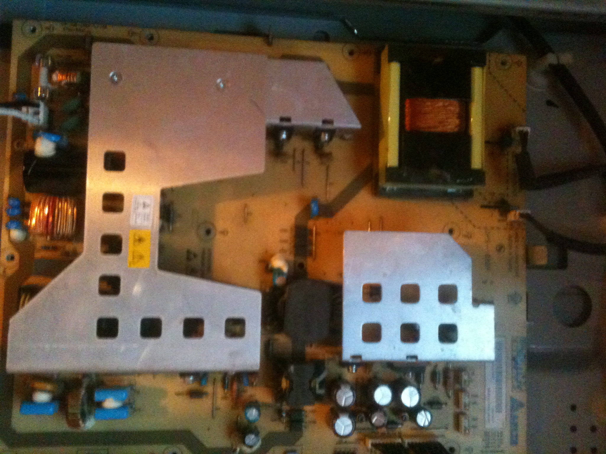

    Hi all hope someone can give me some advice.Tv wont come on from stand-by.Blue light goes off then red light will have 1 long flash follow by 2 quick flashes and then keeps repeating sequance.
    Read alot on here about bad capacitoirs and resisters.Are these on the psu board or on the av board.Also seen someone mention about a resistor 3318??
    Could do with some help with the best solution,have found an psu board and an av board for £30 each for this model.
    Would it be best to change the board and which one or to try and change the capacitors or resistor.
    Looking forward to some advice.

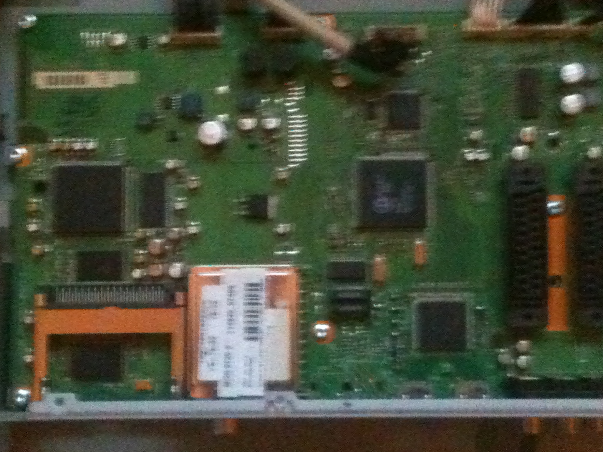

        Can you provide some pictures of the set's boards and also of the model number tag which should have the chassis number e.g. Q533.7LA (near 37PFL5522D/xx)

          Re: philips 37pfl5522d lcd tv.flashing red light
          pics as requested not very good quality though.cant find chassis no. Were would it be???Hope this helps tom. Thks.Neal
            Chassis number usually on same sticker as "37PFL5522D".
            I cannot see anything in those pictures, as I do not have this TV in front of me, I am therefore working blind.
              Do you need pics in a different format??PSu board is made by delta DPS-168bp.Cant seem to find a replacement board.would a psu board made by philps work as i can find one on e-bay ok?? p.s caps on board look ok and are not bulging.
