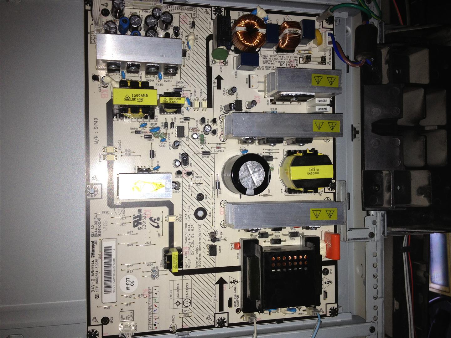

    Hello there.....
    When turning on TV you hear the relay click,then the red led flashes 4 times,then it repeats itself in that cycle forever(click/4 flashes,click...etc...)

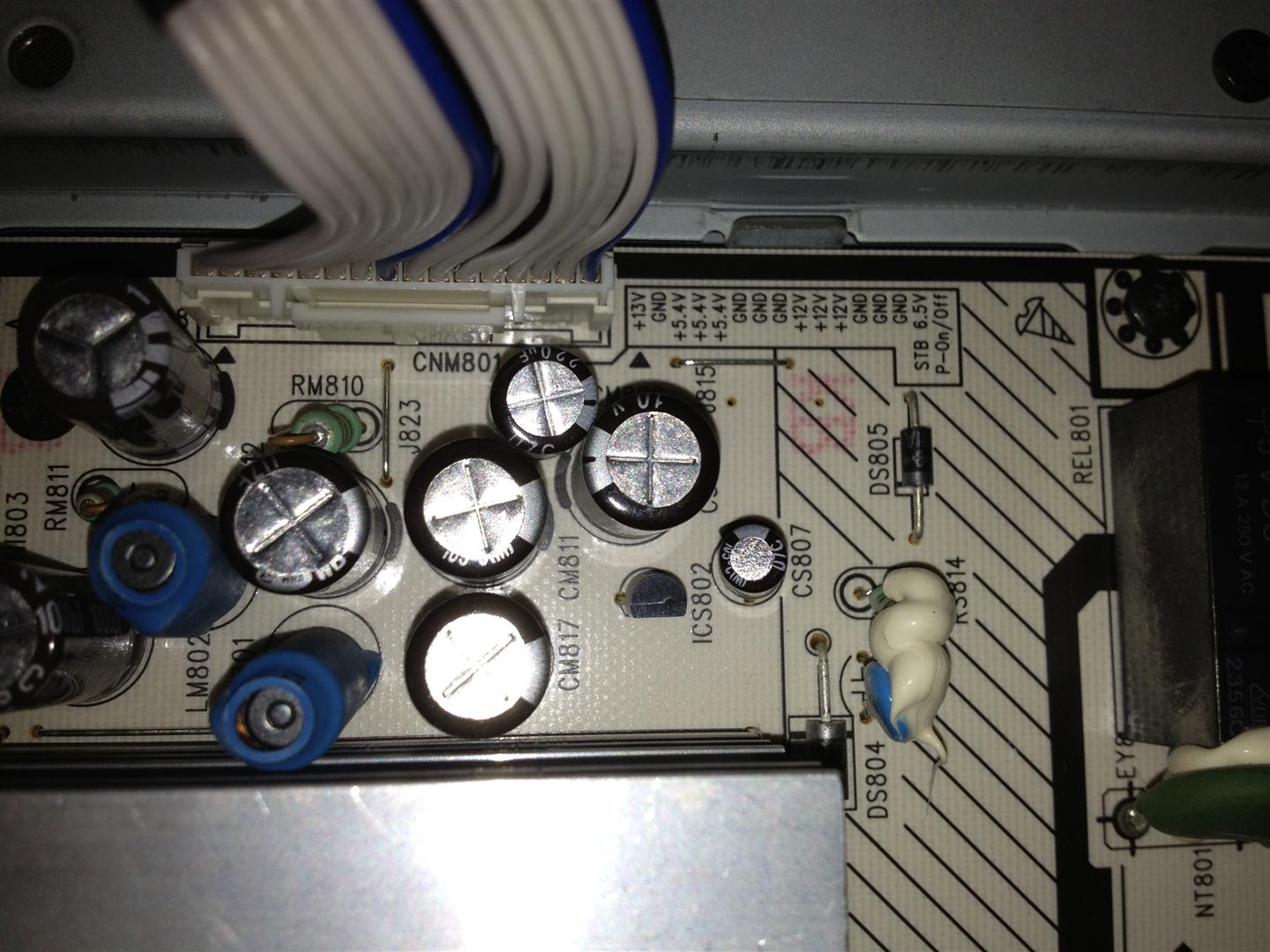

    The owner had replaced two caps on the PSU and problem persisted...
    I checked all voltages on CNM801 and they are correct....
    I was looking for a quick test from samsung but couldn't find it
    On another samsung if you unplug CNM801 and power up the TV the backlight comes on,I did this on this TV but nothing happened..
    After long reading I learned that most cases it's caps on PSU but in the odd case it's the main board...how can I test to be sure what board to replace/repair??

    Check esr on those caps in your 3rd pic, just because they were replaced doesnt mean the new ones are up to snuff. What brand and series are the replacements?

        The caps are made by CKEM 25v 1000uf B105c.How can I check the esr on them??

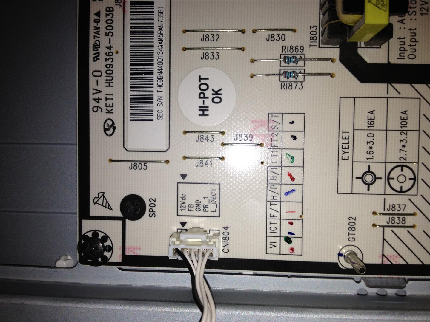

                  On cni801(see pic) I get:
                  12Vdc= 12.04 volts
                  FB = 0.00 volts
                  GND = 0.00 volts (duh)
                  PR-1 = 0.00 volts
                  L-DECT=11.94 volts

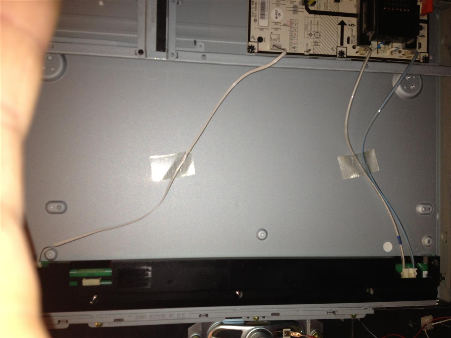

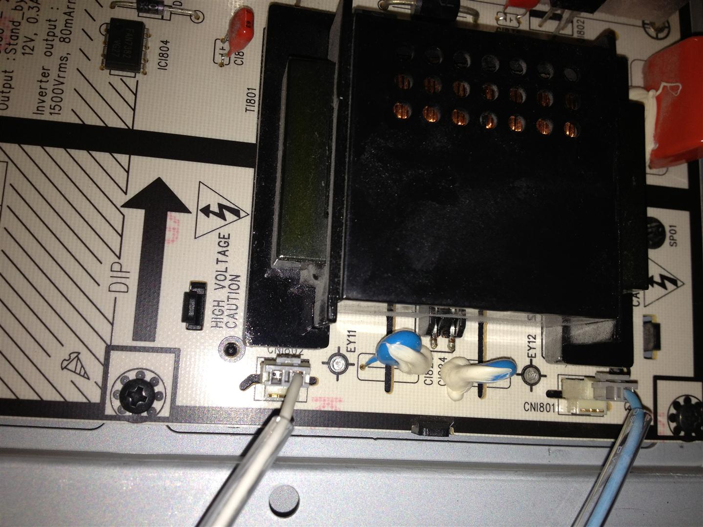

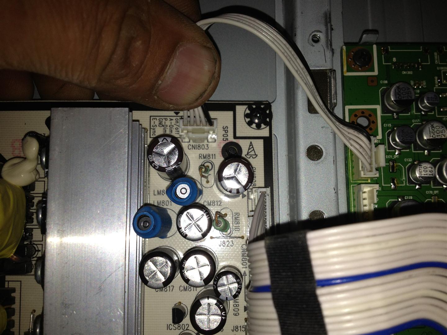

                  Now,before I hook up my meter to cni802 and cni801(see pic) I like to ask how much voltage I can expect between the 2,also is that AC or DC??
                  The powersupply does not cycle through it's on/off cycle with ps on jumped(assuming its the main board doing the cycling) but I'm not getting a backlight on.
                  Is cni803 (see pic) responsible for turning on the backlight?? cni803 goes to the mainboard...

                    Forgot to mention,cni801,cni802 and cni803 all go to a what looks like a buffer board? on the left side of the screen..(see pic)
                    Proud owner of dozens of broken TV's and many,many,many boards.
                    Our website and passion:http://hollenhundshepherds.com/
                      Re: samsung LN-S4041D
                      Those are the lamp inverter connectors.
                      The voltages look good.
                          Can you check the voltage on the black wire on cni803, I believe that is where the bl on should be coming from the main board. Dont try to test 802 or 803 as they will have thousands of volts when they are on
                            had a suspicion that 802 and 803 would blow my 1000volt meter to pieces,so happy i didnt measure that lol
                            I get no voltage on that black wire while the main board does it's cycling...
                            Can I jumper that with the same 1k jumper to the standby 6 volts???
                              So,with my 1k jumper to P-on and a jumper to the black wire on cni803(mainboard disconnected) I get the back light on and all voltages are there from the PSU.
                              Guess that makes it official,PSU is functioning as it should.

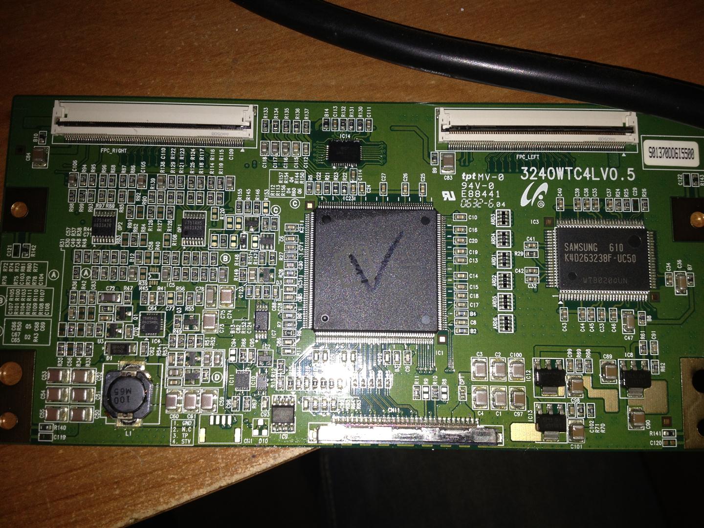

                              I then re connected the mainboard but unplugged the T-con board,result=same 4 blinks and on/off attempts.
                              So,in my humble opinion it's a toss between mainboard and T-con board..
                              I removed the T-con board and like a good boy I was going to see if the fuse on the T-con was ok.(learned that from BUDM in my other thread) but again,I can't find a fuse on the T-con(my better halve has been telling me I'm blind for a long time already,lol).
                              Is there a fuse on every T-con or this one doesn't have one?
                                Next to right of the connector, CP1 (Circuit Protection 1), with 'T' printed on top.
                                  Funny,was just looking at that thing thinking"I wonder if...."
                                  Anyway's,that fuse checks out good...
                                  I'm leaning strongly to the verdict that the mainboard kicked the bucket.
                                  Re-installed the T-con,unplugged speakers and push buttons etc and it's still doing the 4 flash etc..
                                  Is there anything I can test/reset on the mainboard?? Or accept the fact it's dead and get a different one??
