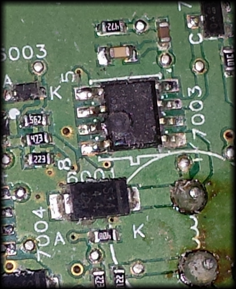

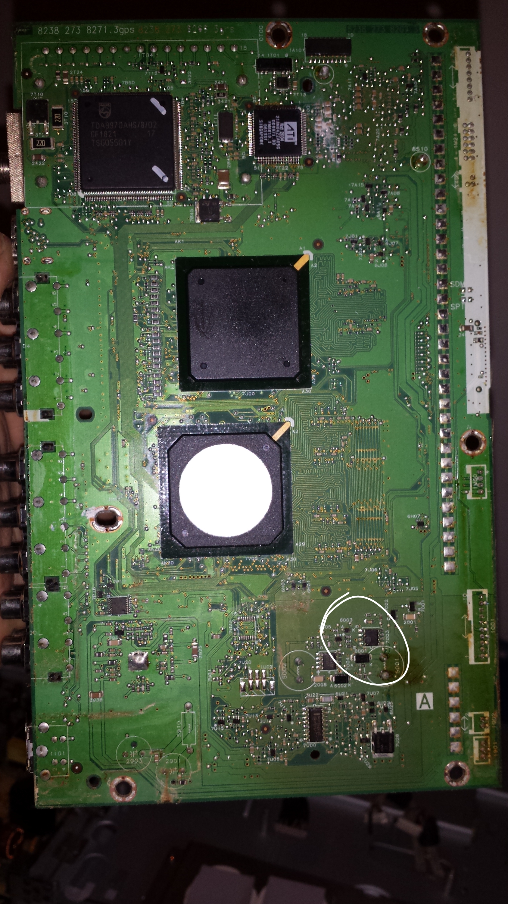

    Magnavox 32mf231d/37 bad chip found but cant identify because numbers are burned.
    I got this TV a few days ago and nothing would happen when you turned it on. I opened it up and found 3 bad caps on the power board. I replaced them with the appropriate Panasonic FMs. Now the TV will power on and I can go through the menu options, screen is OK but inputs don't work. The input buttons also don't seem to do what they are supposed to either. I took the main board out and inspected it and found a chip that has a small crater burned into it. Actually it was bubbled up but I scraped the top of with my fingernail. I'm pretty sure this chip is the problem but I can't read the numbers on it.

    Re: Magnavox 32mf231d/37 bad chip found but cant identify because numbers are burned.
    It's L5973D. You can get it from Digi-Key. There is a pad under the chip too. You need to heat the entire chip up to get that pad to free up. I didn't and I pulled the pad off of the board and ruined it. I then had to buy another board.
        Well, my new chip came today. I removed the old one with my rework station. I soldered the new one in and then heated it with the rework station's heat wand to solder the ground pad under it. Everything went smooth and looked good until I plugged it in. The new chip burned exactly where the old one did. I'll have to find a data sheet to figure out which pin it was that burned. If you were holding the chip so you could read the numbers, it would be the 2nd pin from the left. I guess that would be 2 or 7.
        Edit: OK, I found the data sheet. Its pin 7 (ground). In my experience with electrical wiring, I've often found that the ground wire, rather than hot wire, will burn out when a load draws too much current. So maybe the chip is drawing too much power. Perhaps something is shorted to ground? Anyone else experience this?
          Check diodes in the area or off the pins to the ic. One could be shorted both directions. Perhaps a diose coming off pin 1.
            Since the new chip is burned out, I suggest removing it and with your meter, check each pad to see if it's shorted to ground. Obviously, pad 7 will show a short.

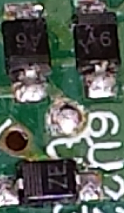

                  I've attached a pic of what might be SMD diodes. If they are then I might be better off parting out the boards that I know are good. Reason I say that is because I tested every one on the board, both sides, and at least 15 gave me readings in both directions. This TV sat on a desk in a finished basement for several years after it quit working. I already replaced 4 bad caps on the power board. Voltages are about 18v except for one 6v terminal. I'm thinking the humidity might have caused a lot of problems. That being said, there are no physical signs of corrosion and I did get this TV to power on after refurbishing the power supply. I just couldn't get past the menu. Now I can't even get that. If the components in the pic are diodes, how would I determine what to replace them with? Whether or not I continue working on this would depend on what they cost. So far I have about $30 invested.
                    In most cases readings in both directions are normal add they have a resistor in parallel. The diodes you will be looking for are a dead short both directions.
                      So those were diodes then? I tested all with multimeter set to diode and then again with meter set to continuity. Didn't find any that were shorted like that.
