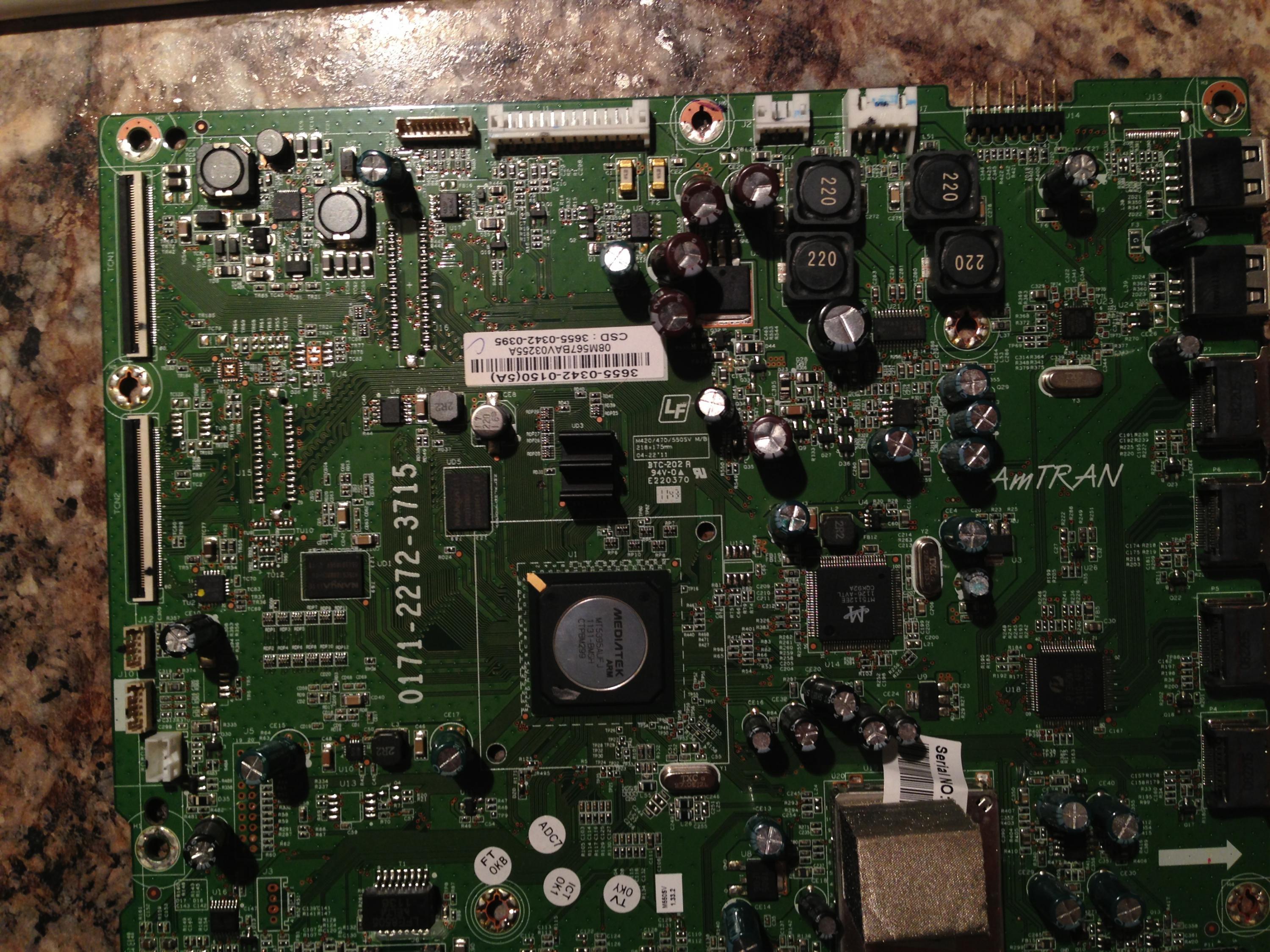

    M550SV Vizio main board repair
    I have a m550sv Vizio that is completely dead. No indicator led. Power supply tests good. Very confident main board has issues. Ldo regulators seem ok. No response to any buttons. Power supply is activated when TV is plugged in.
    Ie , ps on = high and v out is good.
    Anyone have experience or suggestions on this main board?
    Crystal Oscillators are operational, however tcon PSU section is not powered on due to MOSFET being switched off.
    Anyone have any suggestions?

    These boards -- usually corrupt firmware flash chip. The chip is sometimes available for around $20 on the 'net.

        You need to search the board model number in Google along with EEPROM and hope you get a result.
        The model number is on the white sticker with the barcode (assuming you have the same board as the OP).

          ive been having a good look for the eeprom/spi flash for this set but can find anyone selling it so may have to look for a working mainboard for your set if available im not sure if you can then copy the contents of a working mainboard eeprom/flash ic over to your non working set as not sure what ic programmer is needed as i think this is a smart tv and may have some copyright on the ic etc from what i have read on various threads.
