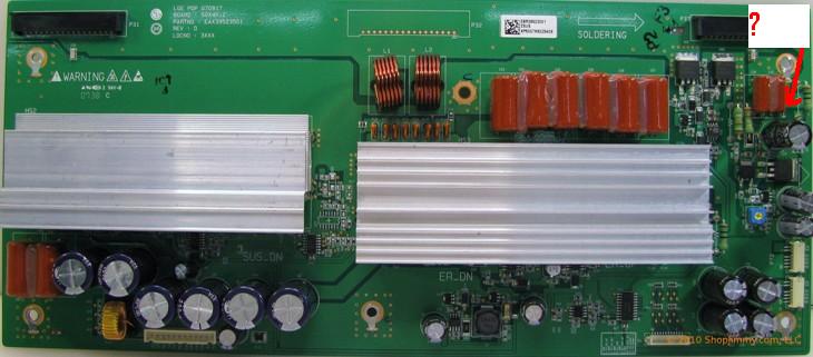

                PSU: Measure VS and VA at connector.

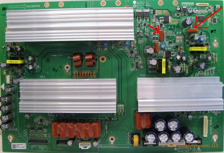

                Y-Sus: (1) VSC: Place negative probe on one lead of C14 capacitor (orange cap near bottom of board) and the positive probe on the opposite lead of C14. (2) -Vy: Place positive probe on lead of R85 resistor and negative probe on chassis ground.
                Z-Sus: Place positive probe on Q53's transistor's gate (the tab) and negative probe on chassis ground.

                    I was able to find the C14 capacitor it was a 250w, it was towards the top middle, I didn't see anything with an orange cap but a few resistor looking things. I checked the two test spots and it was .000, What am I checking there? might be wrong there. The orange capped resistor was named VY, dead as a door nail.
                    As for R85 Y-sus board i had a reading of .000, checked the other side incase i wasn't on the lead in side, it was 58 volts.
                    Couldn't find a Q53 resistor on the Z-sus.

                          Ok, it's as I suspected: You have a different panel version from the one I'd referenced: 50X4 vs your 50X4P.
                          I found the Y-Sus test points for VSC and -Vy (see attachment), but I can't find any images online that are clear enough to see the VZB, aka Zbias, test point on the Z-Sus. I marked a notation on the board I thought could be pointing to the VZB test point. Please verify what I've marked to make sure they are correct.

                                  What is the test point for the Vzb? Is it a cap, resistor, or a transistor?
                                  -Vy and VSC voltages seem low. What does the panel label say the spec is for each?

                                        Edit: Can you also post clear pics of the test points on the Y-Sus and Z-Sus?
