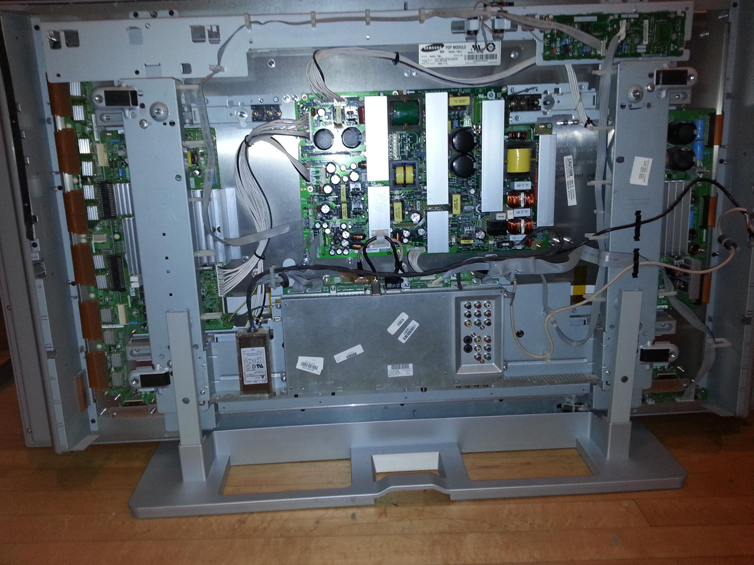

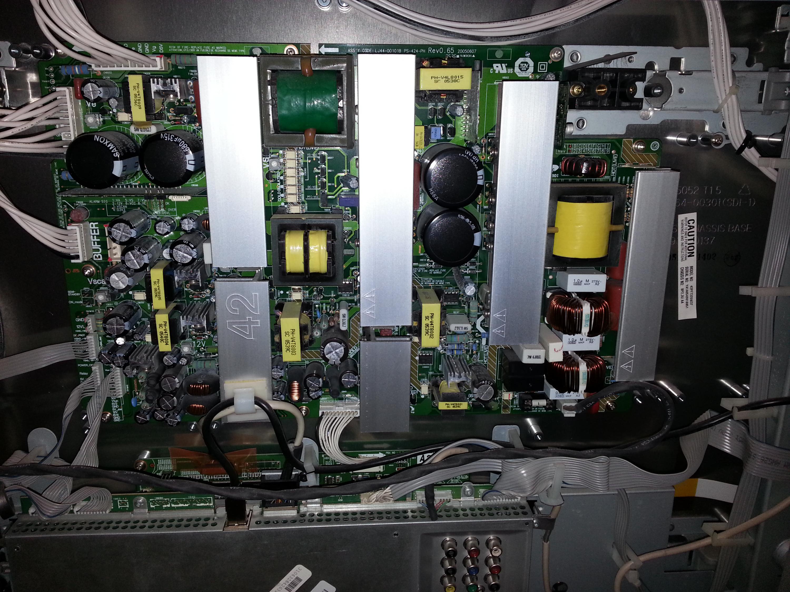

    so i remove the rear cover and i was like "wtf!" after i seen how big the psu is and all the wiring. it was like capacitor city in there. i thought to myself what did i get myself into this should be fun.

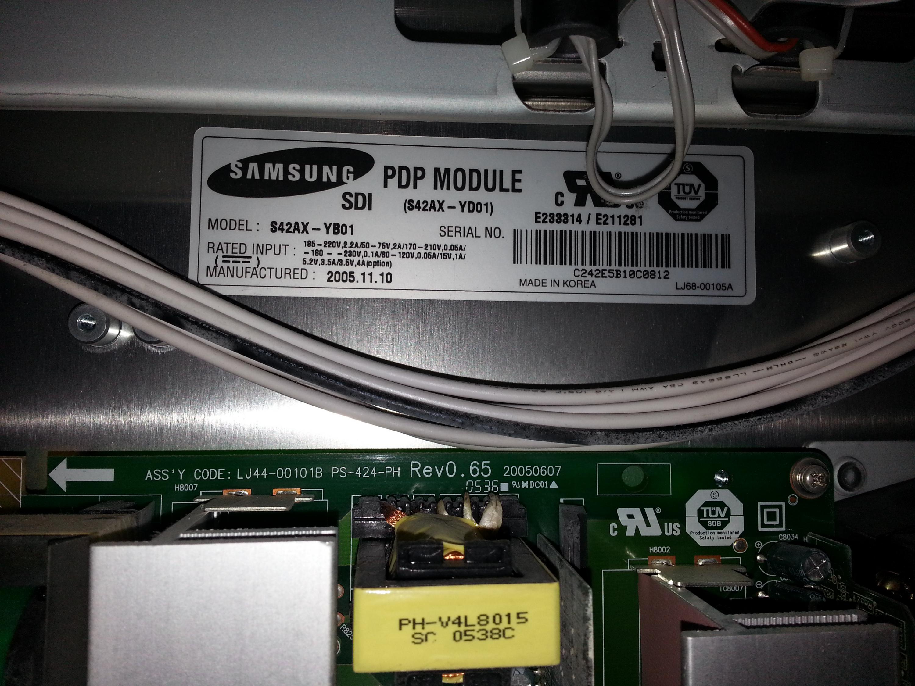

    i noticed this is a Samsung tv since every board and the panel has a Samsung label on it

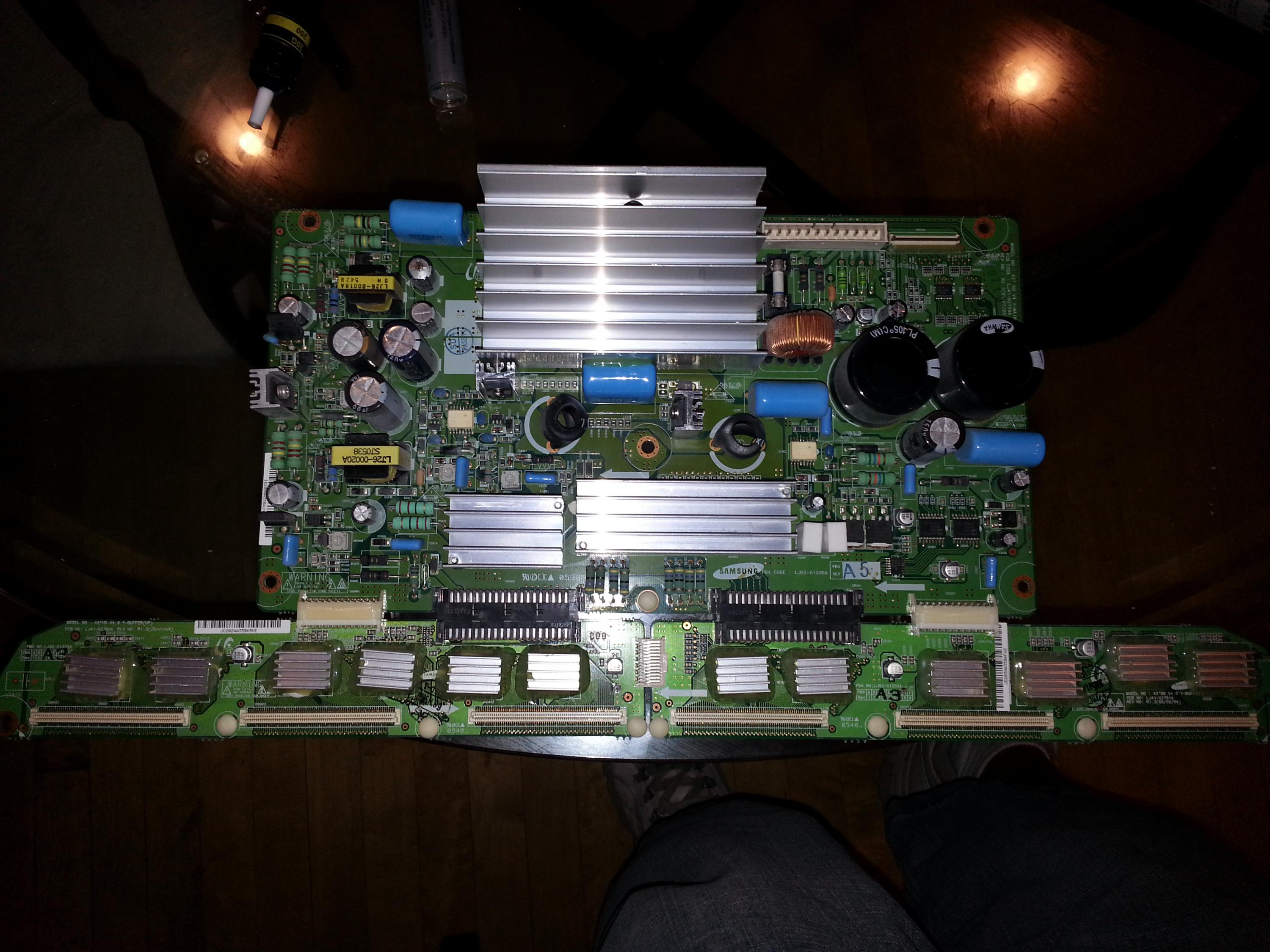

    anyways so first thing i look for any bulging/leaking caps

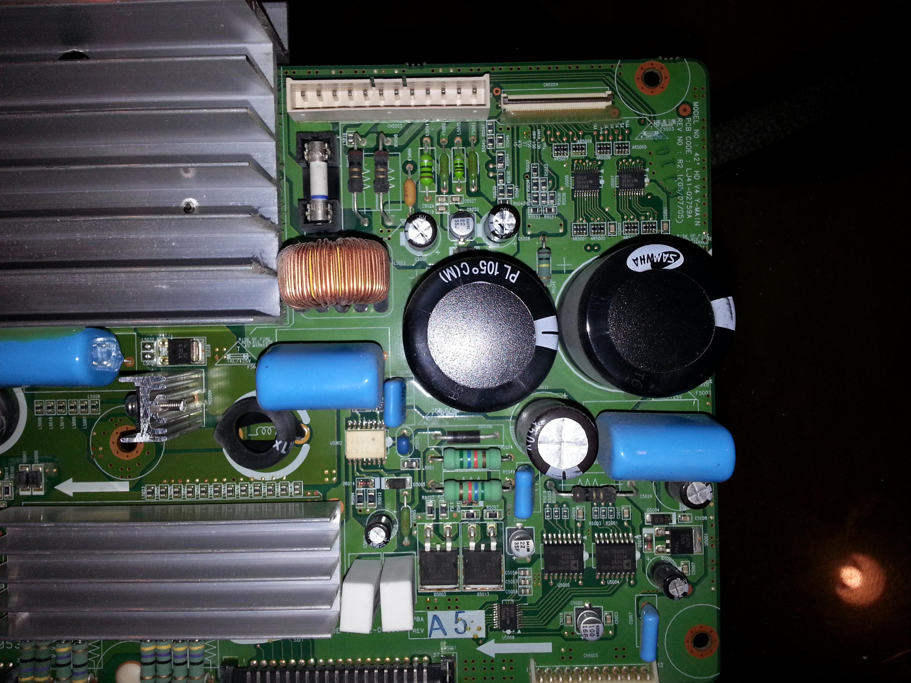

    after 20 minutes of searching i finally found 1 blown cap on the ymain board
    i was like cool this should fix the problem but of course it did not.
    i replaced the cap reinstalled the ymain and still no video
    tv still has same issue

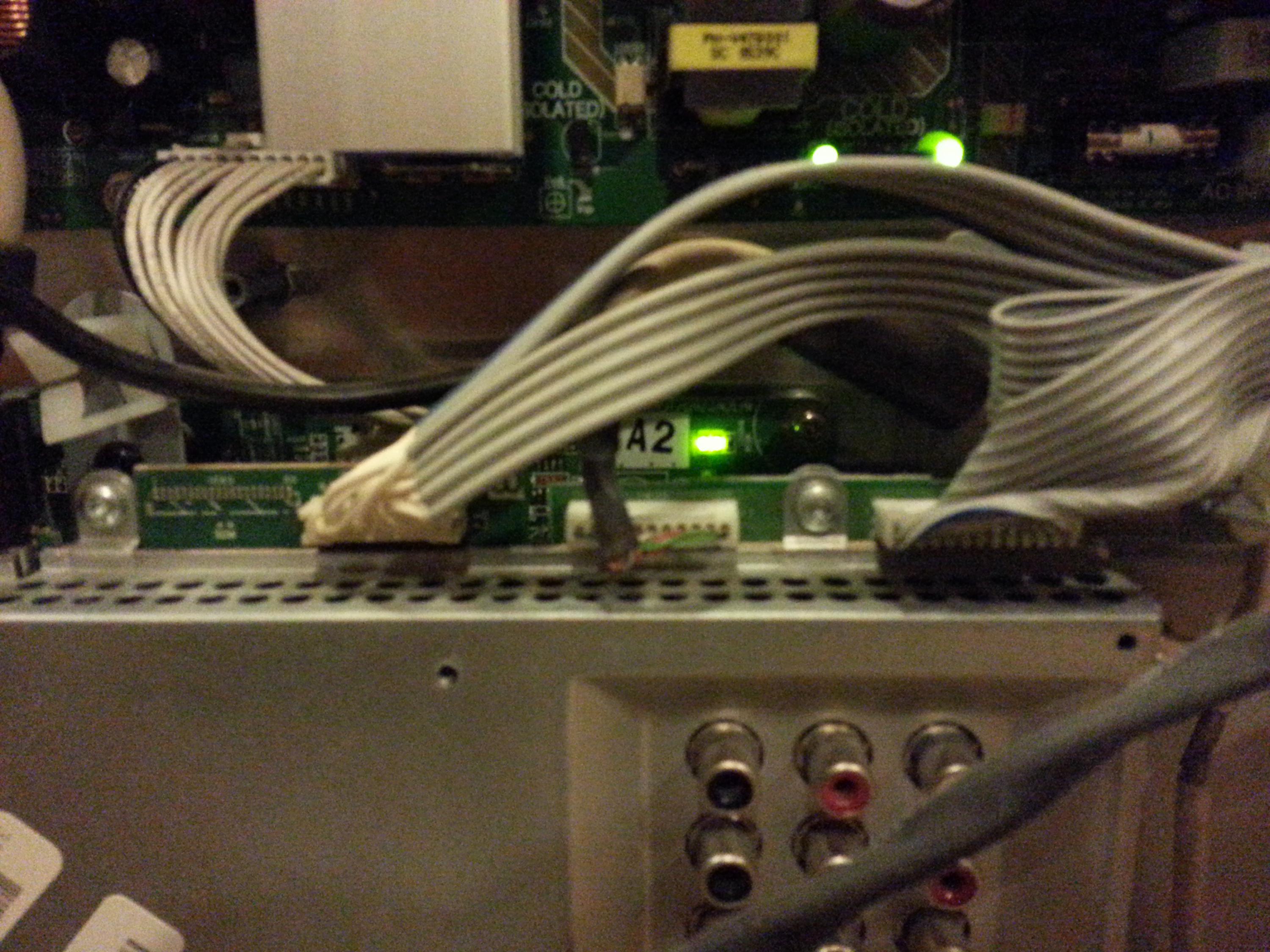

    green led in front comes on
    green leds on logic borad come on then off
    another green led on a tiny board blinks 3 times

    checked all 5 fuses on psu then found 4 more (another wtf moment)
    wasnt able to check all fuses on psu because the other 4 are surface mount and i need to take the board out
    so now i moved on to check voltages
    but before i check i decided to unplug the connector to the ymain since that is where i found the blown cap
    after i unplugged ymain i plugged power back on and now the psu stays on
    you can hear the transformer on leds stay on
    so im guessing all the fuses are good on psu?
    i am guessing there might be a defective component on the ymain or y buffer boards?

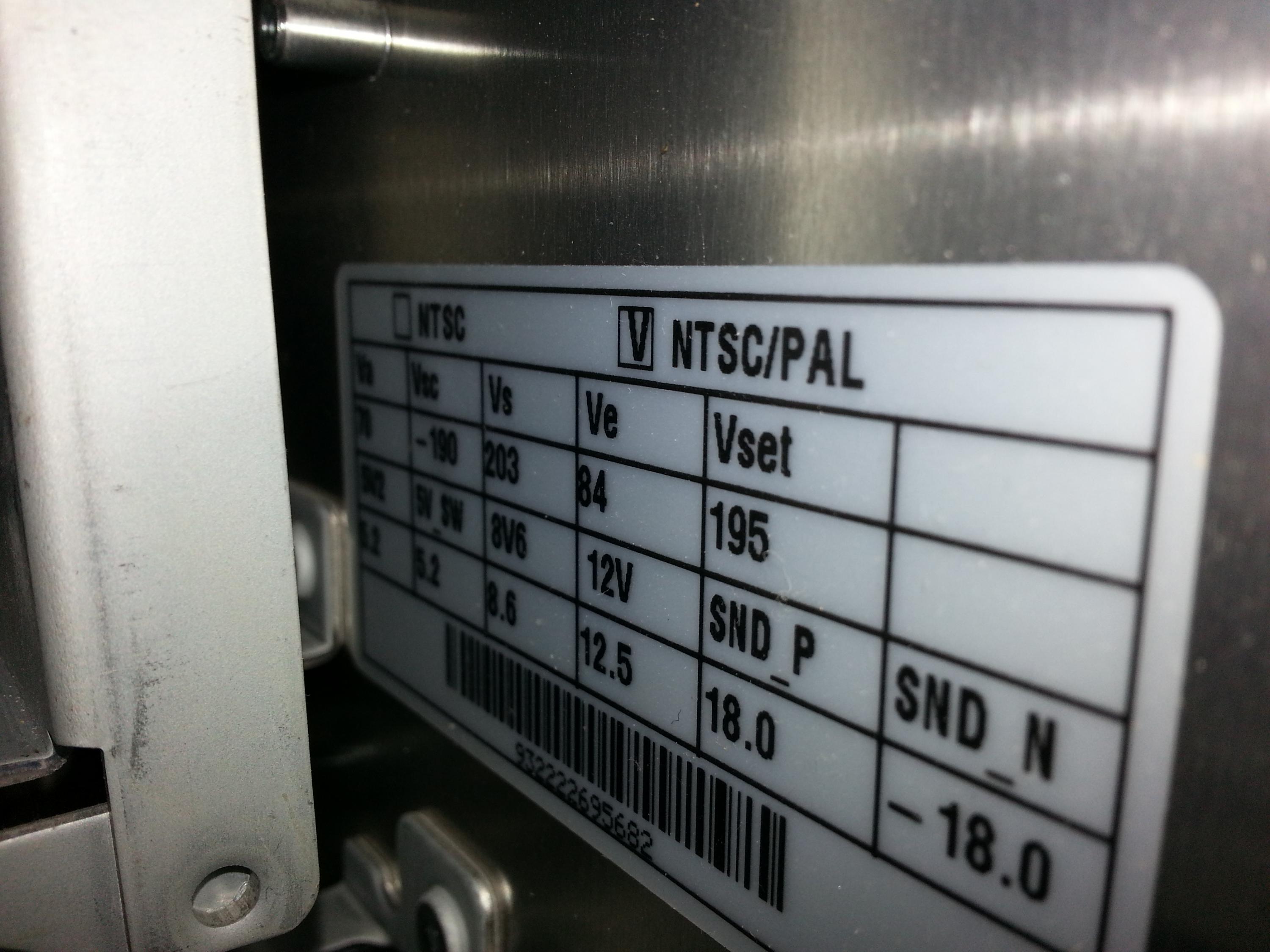

    here are the voltages after i disconnected the ymain
    Va:70.3
    Vsc: -190.1
    Vs: 203
    Ve: 84.1
    Vset: 194.7
    D5V: 5.2
    Vg: 15.06
    +12v: 12.19
    Vtun: 87.3 and drops
    5V2: 5.19
    5v_Sw: 5.16
    8v6: 8.72

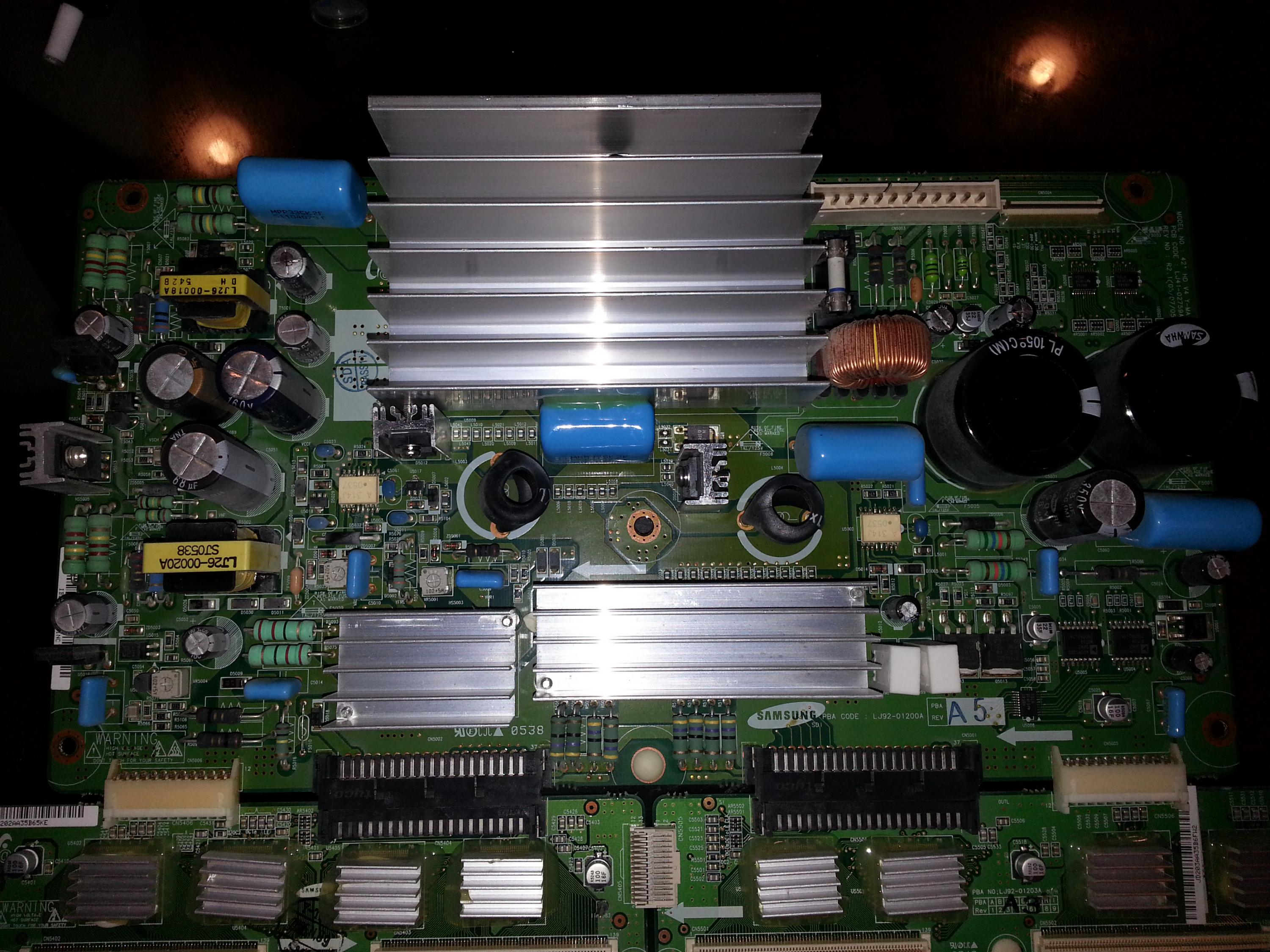

    i guess i have to check the mosfets on the yamin

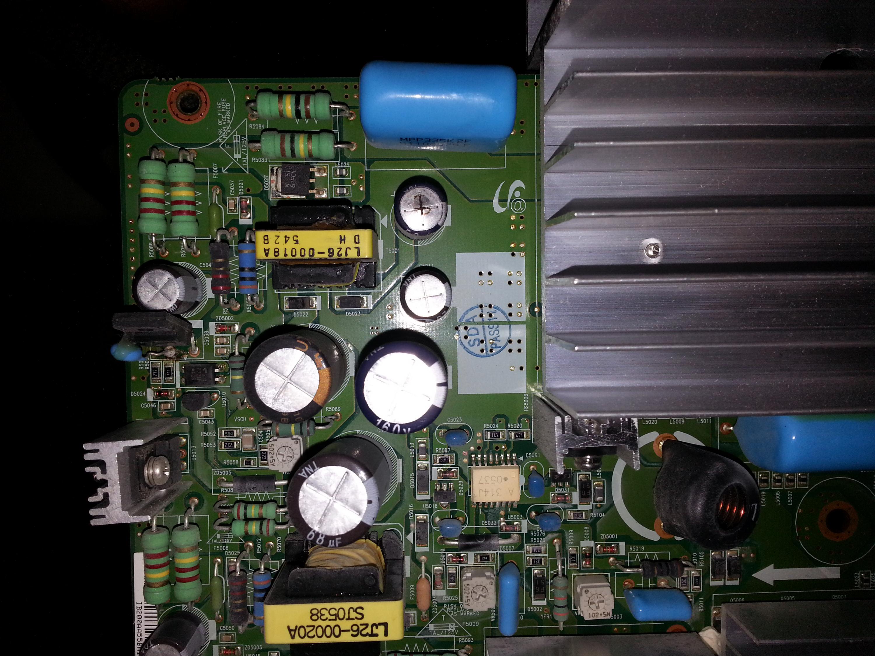

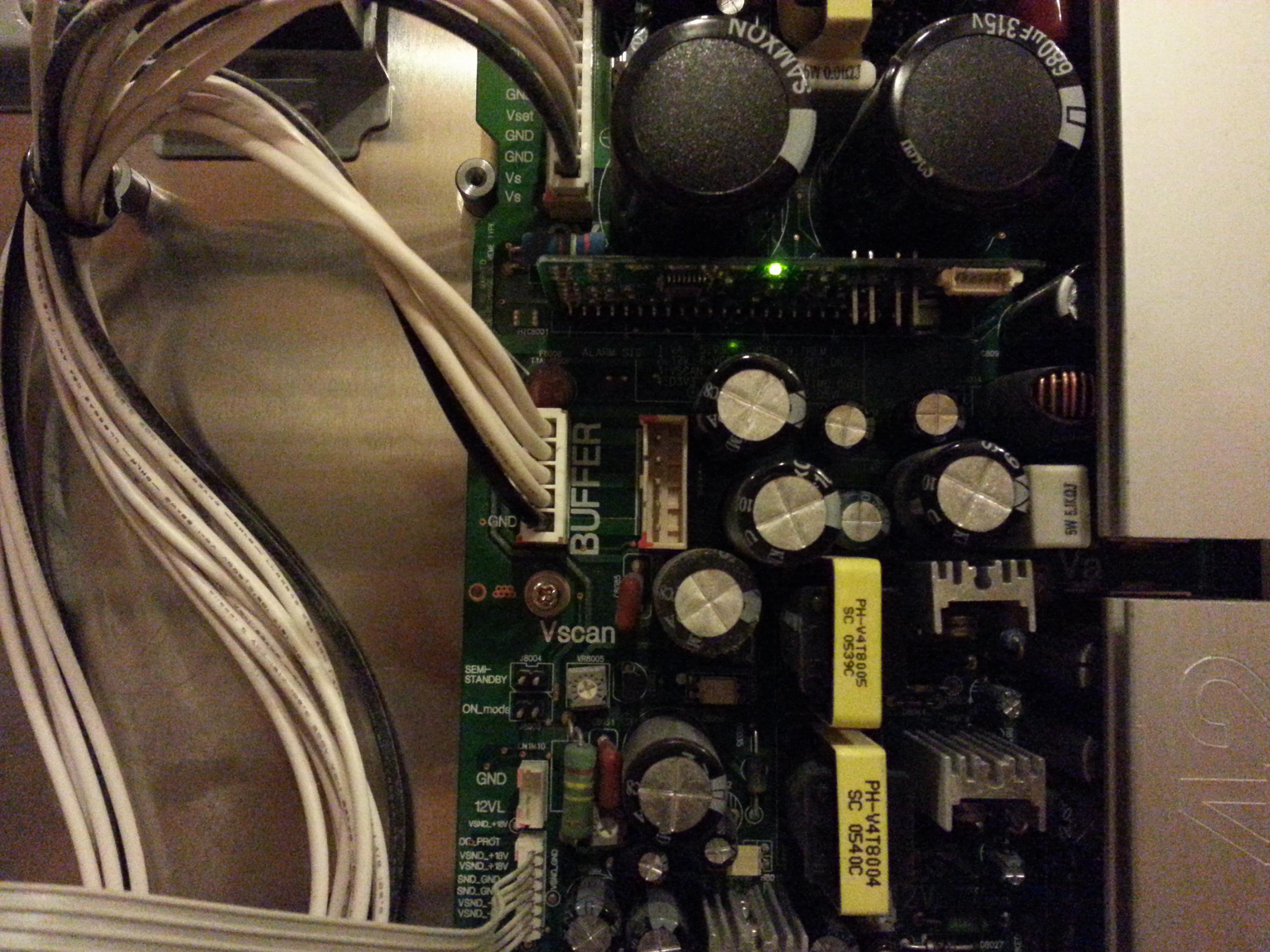

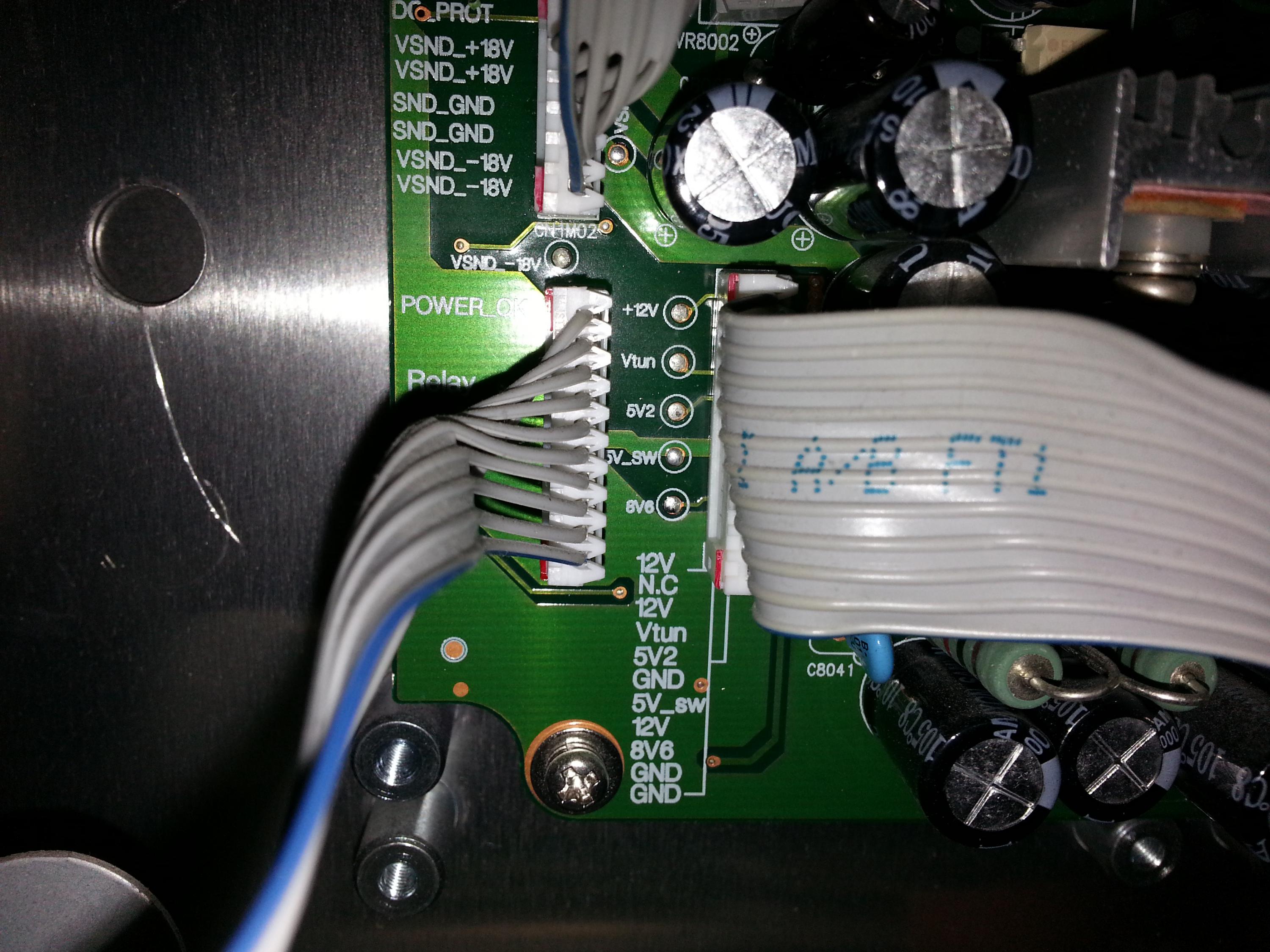

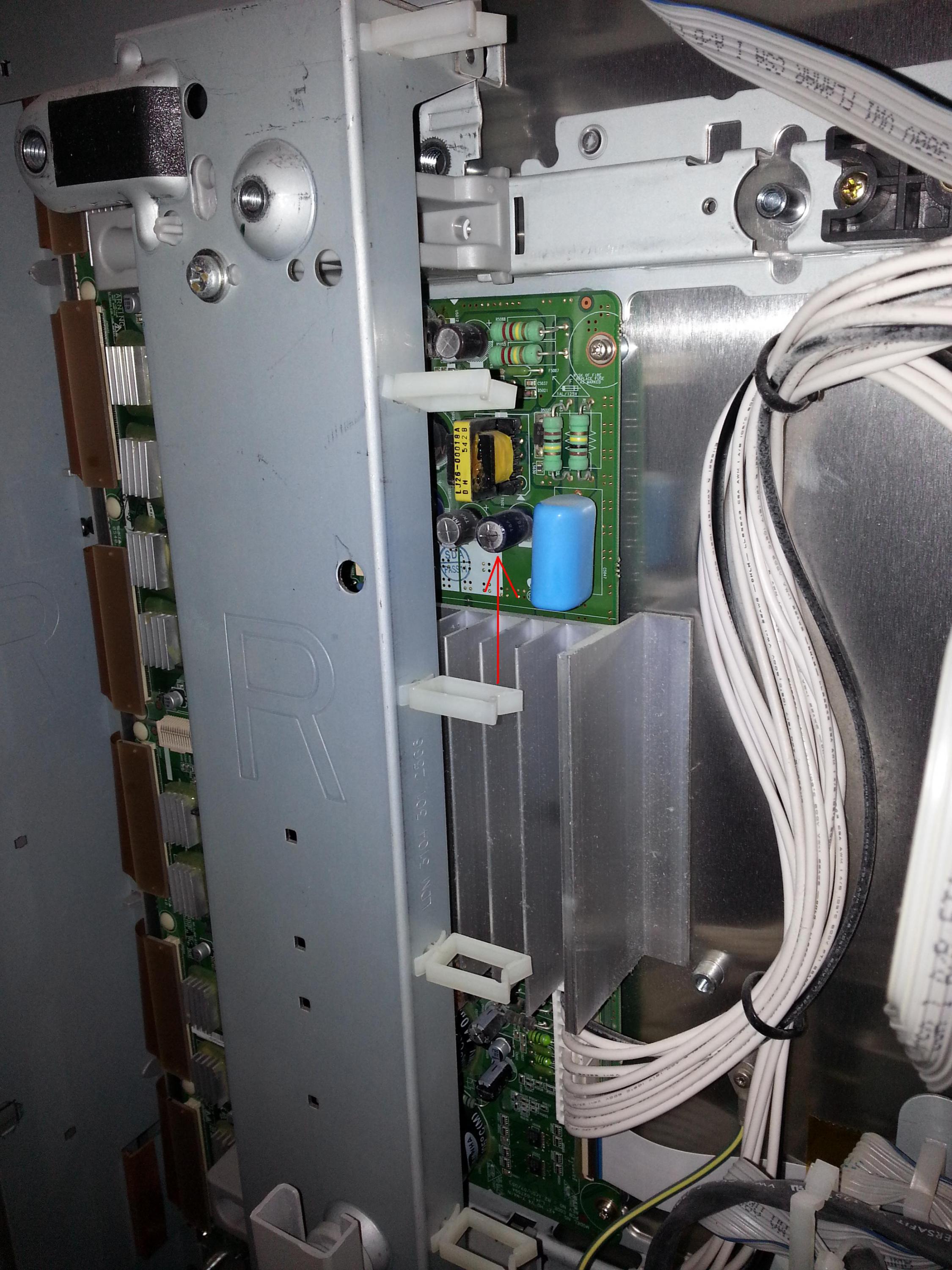

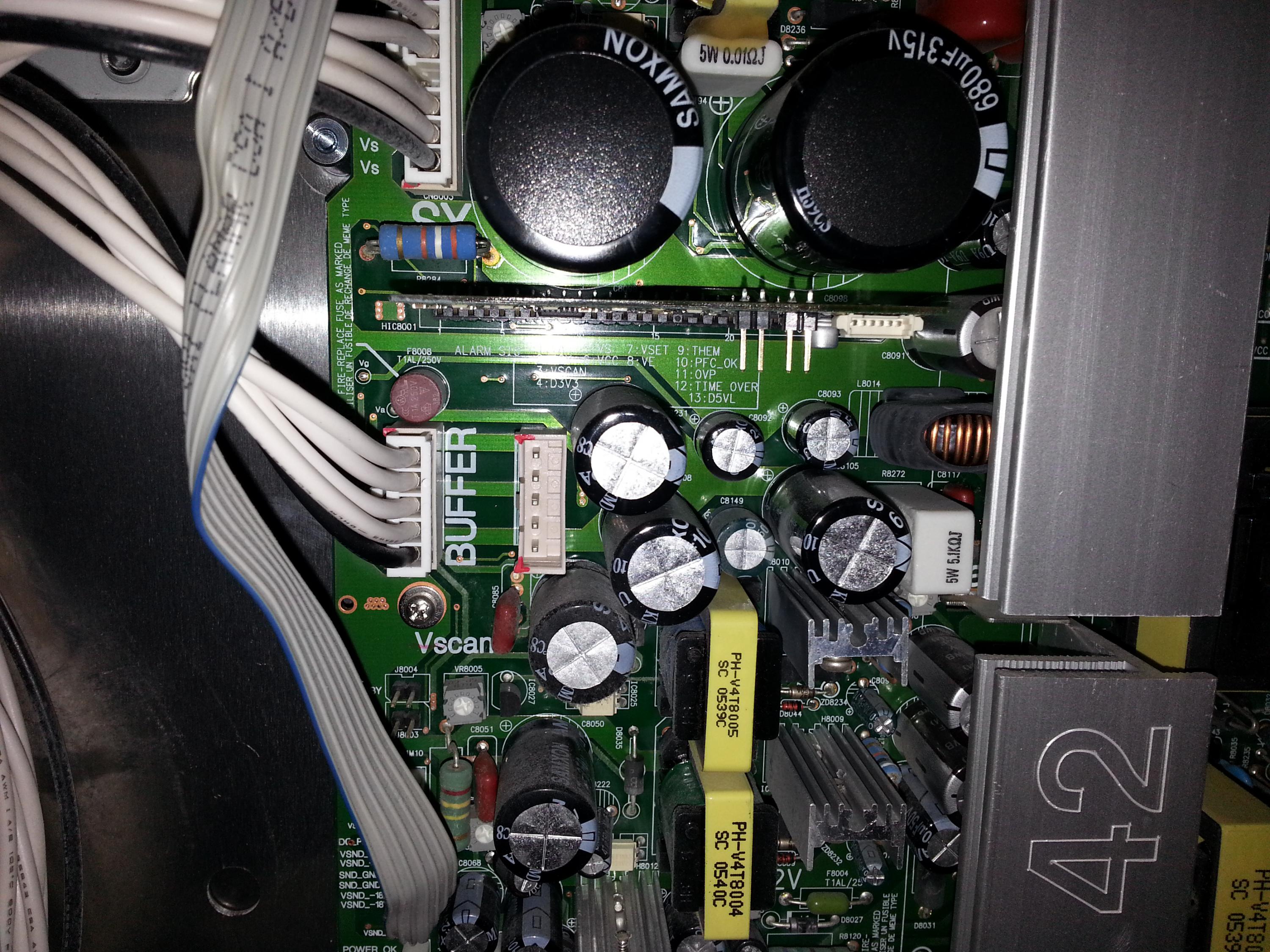

    here are pics of the test points and ymain board

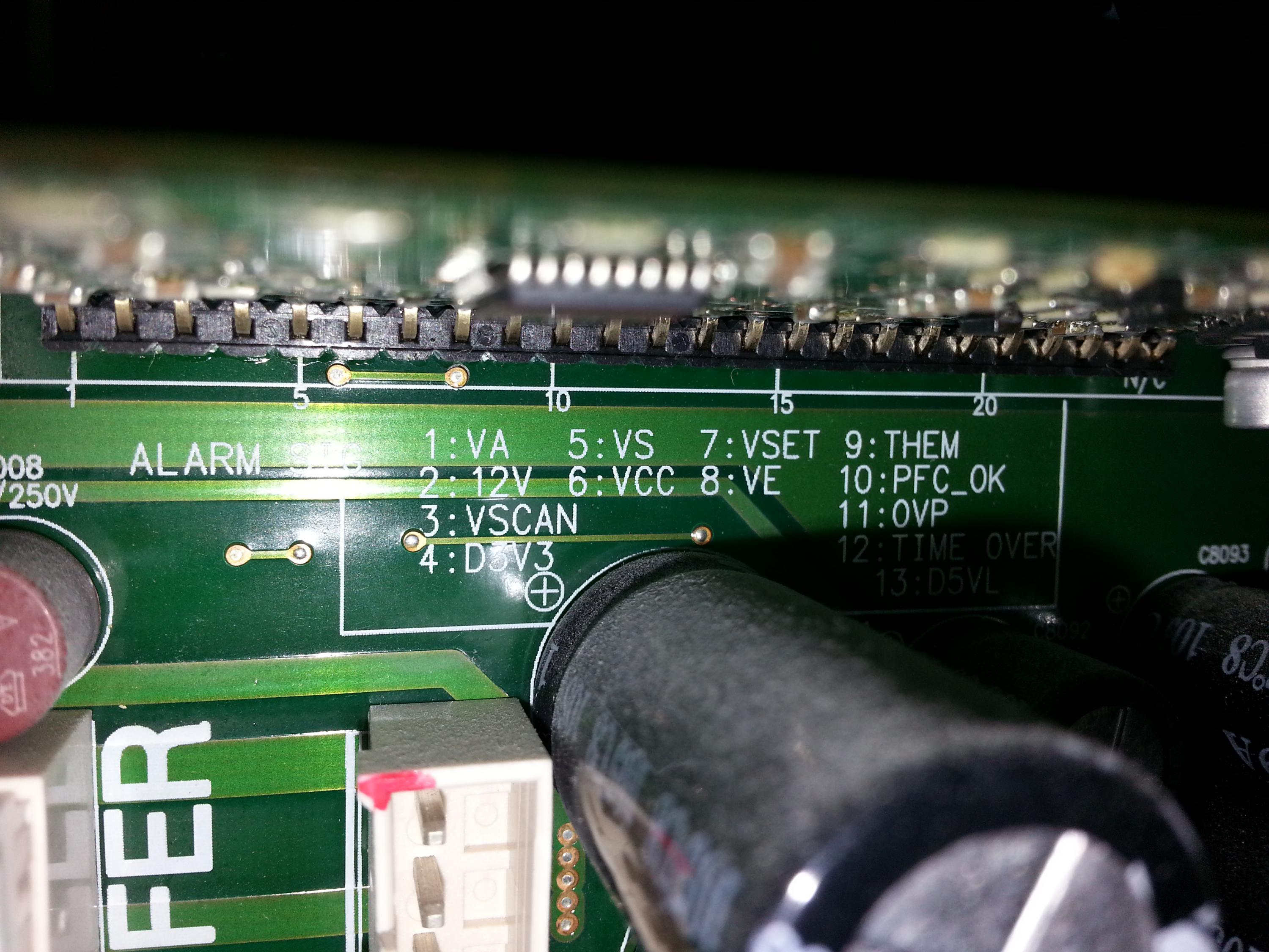

    i also came across this chart on the psu
    it is marked "alarm sig"

      should i replace all the caps on the ymain and psu?
      this is a pretty old model from 2005
        Re: Philips 42PF7320A/37 powers on but no video/picture
        I'd replace that cap on the Y-main. The Y-main rarely fails on these, it's usually the buffer, so try without that. However, the bad cap may have caused Y-main fault.

          if i disconnect the buffer connector from the psu do you think the panel will turn on?
          or should i separate the buffer board from ymain then power it on?
            I wouldn't expect any light from the TV with the buffer removed.
            Unless it has two buffers in which case one or the other may be removed.

              it does have 2 buffers
              should i only remove one and power it on to see what happens?
                Yeah, try that.
                The buffer must be completely removed from the set and disconnected from the other buffer.
