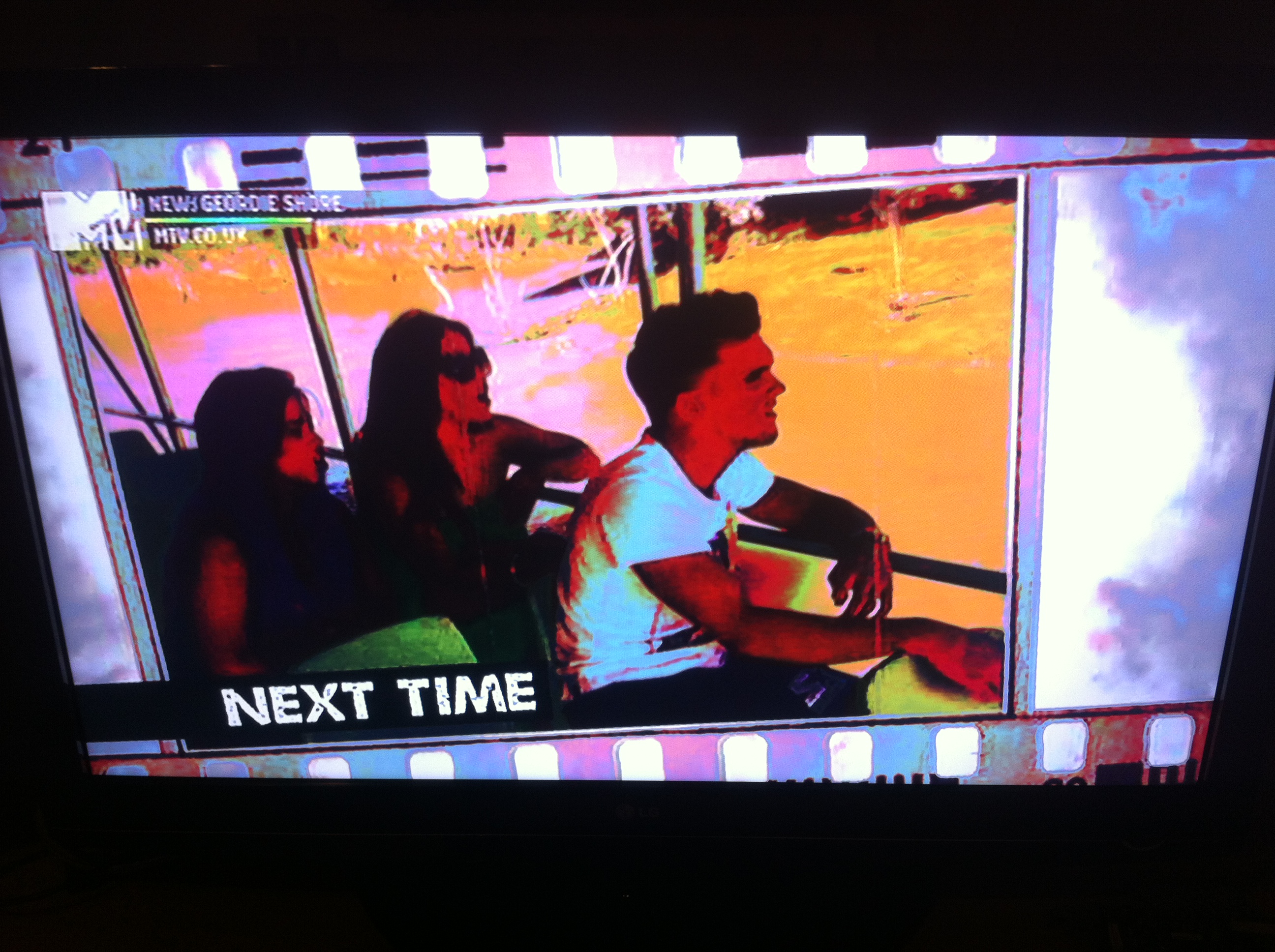

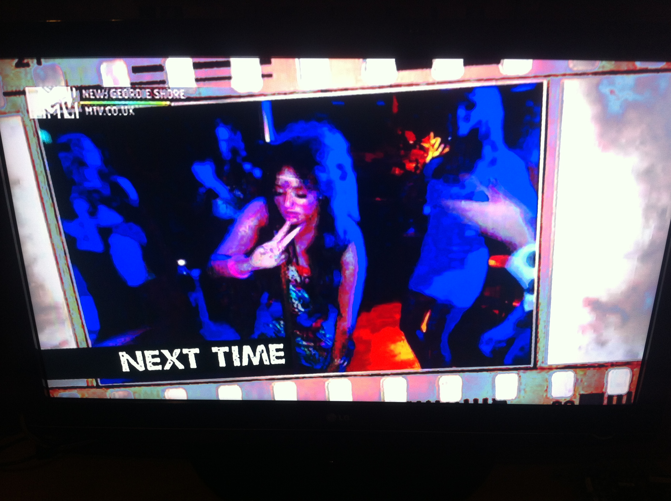

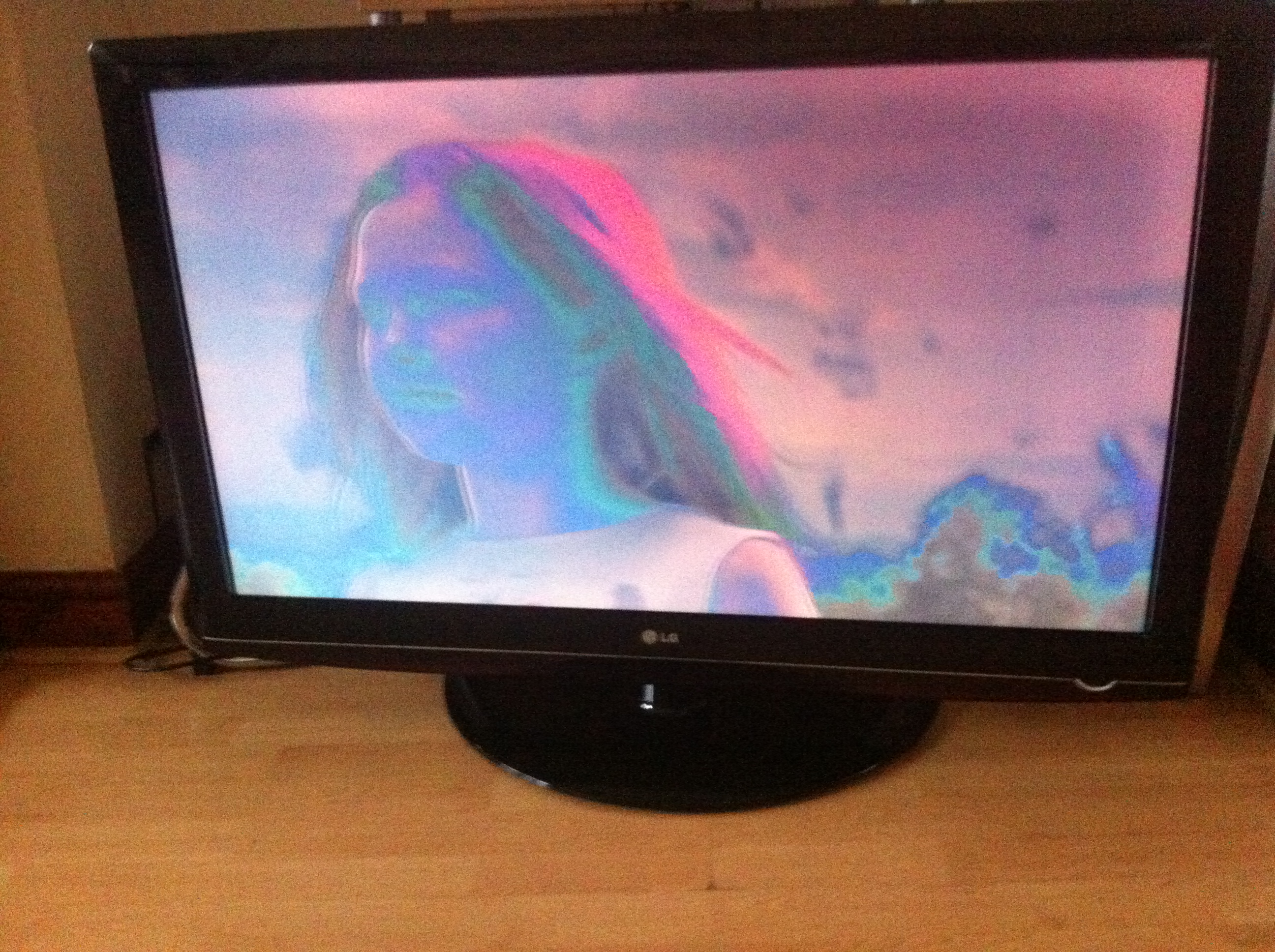

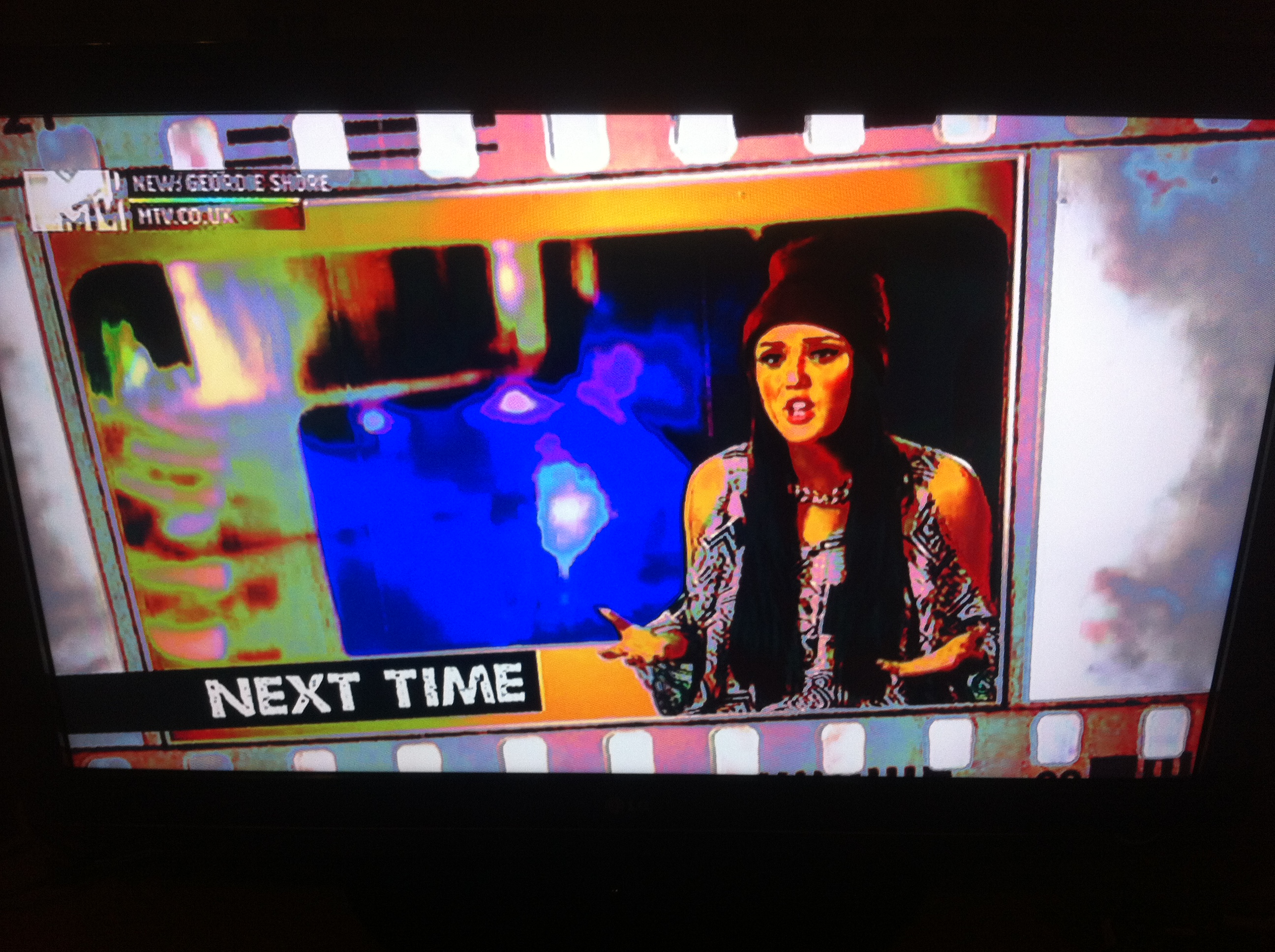

    hi guys
    can anyone help me please i have attached photos of my problem
    any ideas
    thankyou
    Re: Lg 42lg5010
    I am not the expert but it looks like a failed tcon, more specifically the ic controlling gamma on the tcon appears to have failed. Im sure Budm will pipe in here soon.

          Looks like bad AS15G/F IC on t-con.
            Re: Lg 42lg5010
            thankyou
            ill order a new tcon and try it
              Re: Lg 42lg5010
              If you're competent in soldering a 48 pin IC, then you can just replace the AS15 chip which usually fixes this.
