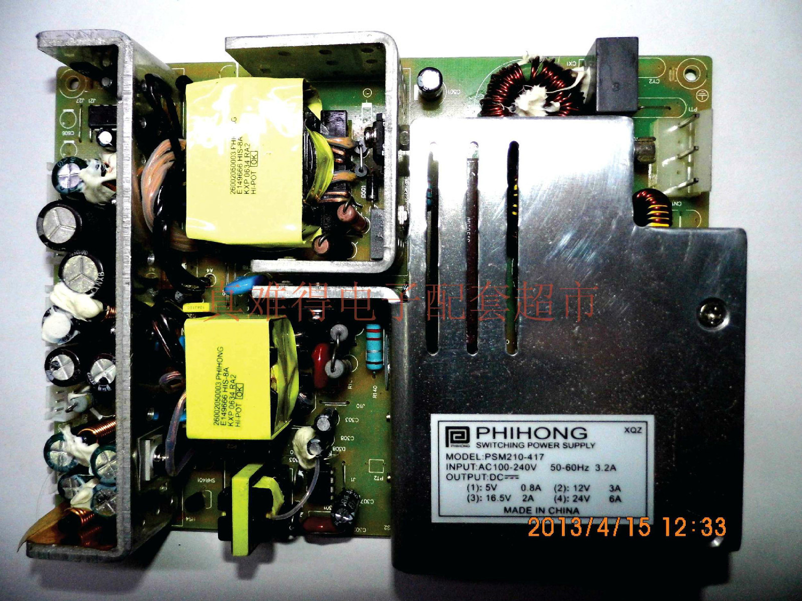

    hi just picked one of these up from my local freecycle site the problem is the psu has had a major short on and blown some surface mount ics and some surface mount resistors and others surface mount capacitors so a lot of parts to replace as main fuse also shattered so probably bridge rectifier as well so i really need another psu the part number on it are
    PHIHONG
    MODEL PSM210-417A-R
    OUTPUT VOLTAGES ARE
    5.VOLT 0.8 AMP
    12V. VOLT 3 AMP
    16.5 VOLT 2 AMP (SEEMS ODD AS WHEN I FOLLOW THE WIRE BACK TO THE MAIN BOARD ITS GOT 12.VOLT STAMPED ON THE CONNECTOR (DOES VADJ)
    24 VOLT 6 AMP
    i have found one in china thats about £40.00 just wondered if any one had a link to the universal lcd psus i may then be able to modify to fit.

            I don't know, only solution may be to repair it. No schematic as far as I can tell. If you can find the part # of the burnt IC, then it is probably that + PFC FET + 450V capacitor. (Bad 450V capacitor will cause PFC FET and IC to burn.)

                just removed the cover the fuse is gone ic 101 is blown any idea what a 7503 surface mount is looks like a large resistor got 2 by the blown ic cant get a reading at all.
                edit!!!! you was spot on tom was the large 450v cap reads 00000 on my cap meter no uf reading at all and yes did test a good cap to make sure meter was ok.
                tom can you tell me how to test and what meter settings to test this ic P1014AP06 standby ic? just want to check if possible its ok before i order the blown ic and capacitor.

                  Can you provide a picture of the bottom of the board?
                  Standby IC -- check between Vcc and GND of IC, look at datasheet for pin diagram.

                    will get a picture soon as i can measured from vcc and gnd of ic no reading tried 200 ohm 2k and 200k does this seem ok?
                    looks like q102 20N60C3 maybe faulty short circuit on 2 legs leads tested both ways

                          Also check DRAIN to GND, and DRAIN to VCC on it.

                            on ohms reading tom no reading at all on both your tests so this should be ok?
                            what do you think of these readings? looks like q102 20N60C3 maybe faulty short circuit on 2 legs leads tested both ways pins 2/3 and the 3/2 on diode test it has a insulation washer on the heatsink on this ic. data sheet in post 10 cheers tom. the last thing i am not sure is what a 7503 is its like a small rectangular resistor 2 of them by the ic thats blown cant seem to get a reading from them.

                                  It seems unlikely that a 32" LCD TV would use a 45A IGBT. That is something you would put in an industrial motor drive or 1000W+ power supply. Are you sure about the part #?

                                        more than likely yes this out of circuit is short on diode test pins 2 and 3 both directions is this good or bad?
