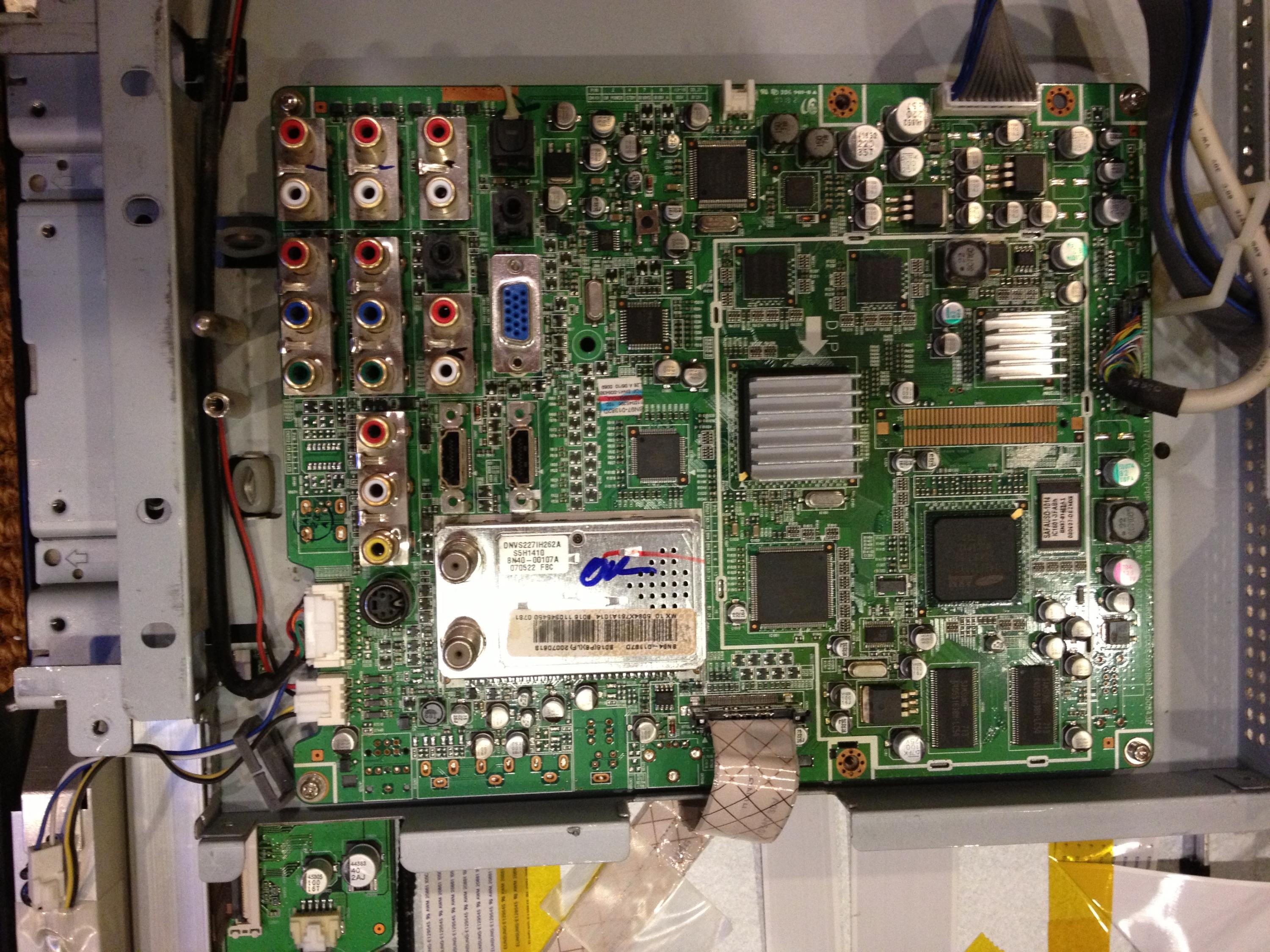

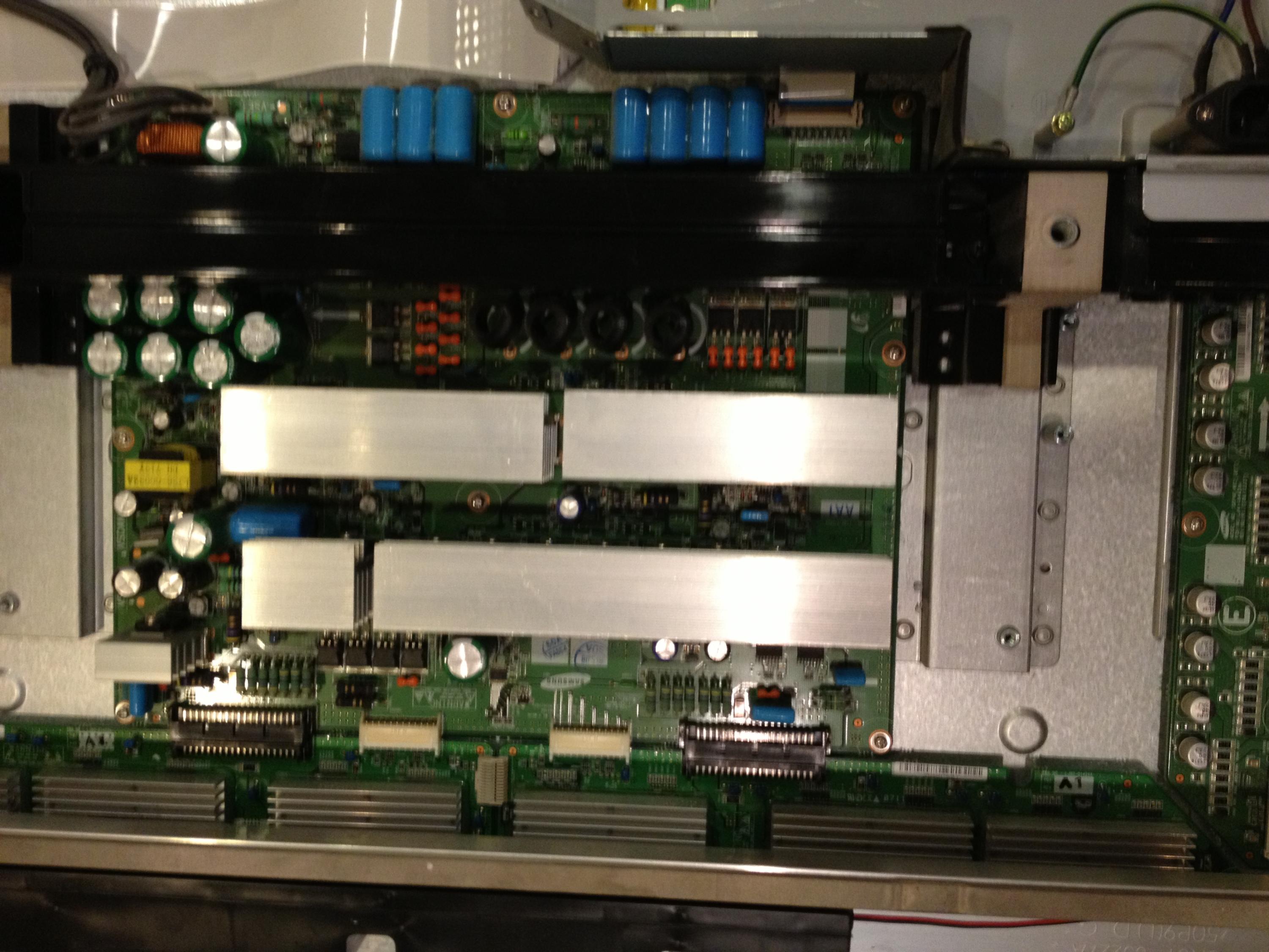

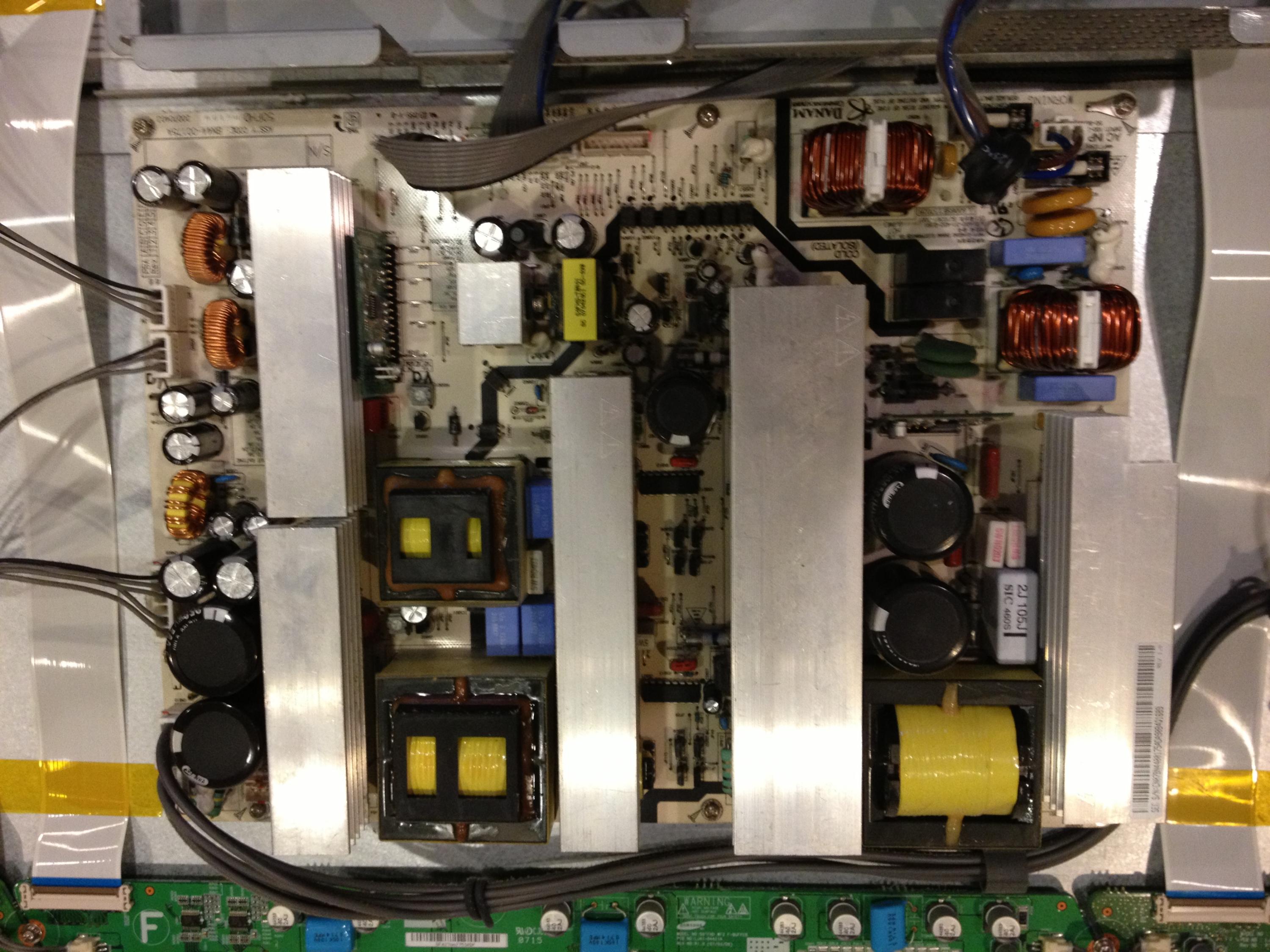

          Re: Samsung FP-T5084 Won't turn on
          Here are a few pics.
          • aschubox
            • Aug 2013
            • 7
            • usa
            It is very similar to the pics in the other post. It appears a heat sink is different. I couldn't make out the bulged caps.
            As I said there is only one cap with a bump and a very minor bump at that. Perhaps changing out that one cap may be a first step.
            I hope the pics I attached help a little.
            thanks again
              It's a little hard to tell because of the flash, but I don't see any bulging caps. That doesn't mean you don't have bad caps, though. However, Samsung TVs typically show visible signs of failure.
                Well I have ordered a replacement cap set for the power supply board. We will see if that takes care of it.
                Any other troubleshooting ideas would be a big help and may save a little time.
                  There may also be a mosfet update for that power supply.
                  Replacing all caps is a good start.
                    I replaced what I could for the capacitors, the kit of capacitors was a bit misleading and didn't have them all but covered the few I thought may be bad.
                    The new capacitors are a bit smaller but have the same ratings on the outside... a newer smaller type?
                    They all went in quite well and was able to get a good solder joint. Upon repowering the same problem remained... the red light was on steady.
                    At this point it seems to point towards replacing the remaining caps... even the tiny ones?
                    Thoughts?
                    Cadiman can you give a bit more info on the mosfet update?
                    Oh and upon powering with the back cover off there is a high pitched hum coming from somewhere on the power board. I couldn't pin point exactly where on the board.
                    THanks
