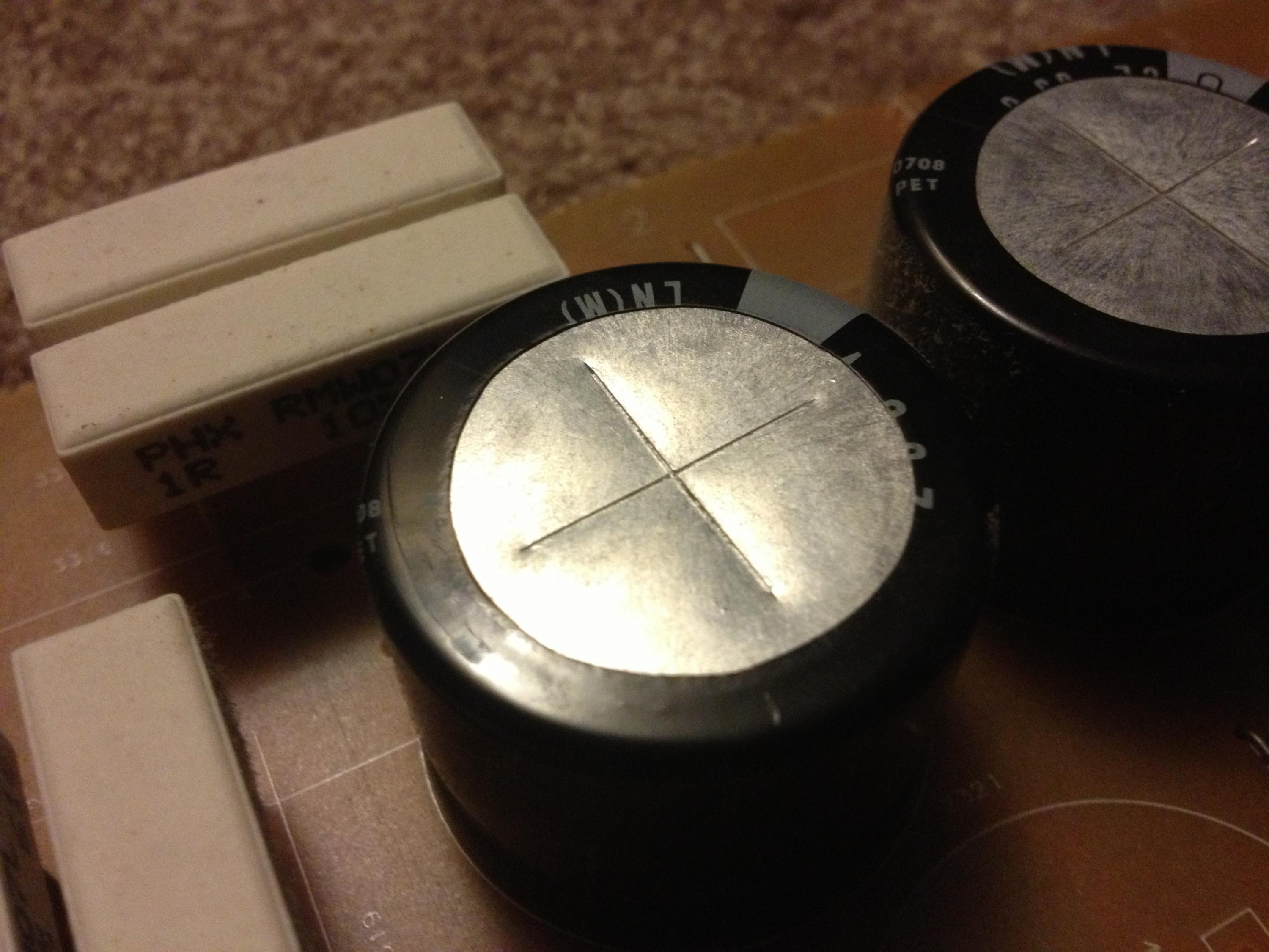

    So I got one of these tv's and I plug it in and the blue power light turns on and nothing else happens. I take the back panel off and no caps are immediately not icily bad. And some lights turn on on the main board. Well after like 15 min the screen turns on and works fine. Now it has 4 big 250v 850uf caps and the spaces around the x is slightly buldged but its hard to tell if it actually is or not but they are not completely flat. How can I test the caps to see if they are bad.

    One simple trick you can try is to use a hairdryer to heat up parts of the board(s) to see if you can get the TV to turn on faster. This could help identify your problem component. An ESR/capacitance meter is the ideal tool to test caps.
    Edit: In those 15 mins when you have no pic, do you have sound or a backlight?

        I took one of the caps out already. It's hard to see the slight buldge or what I think is a buldge.

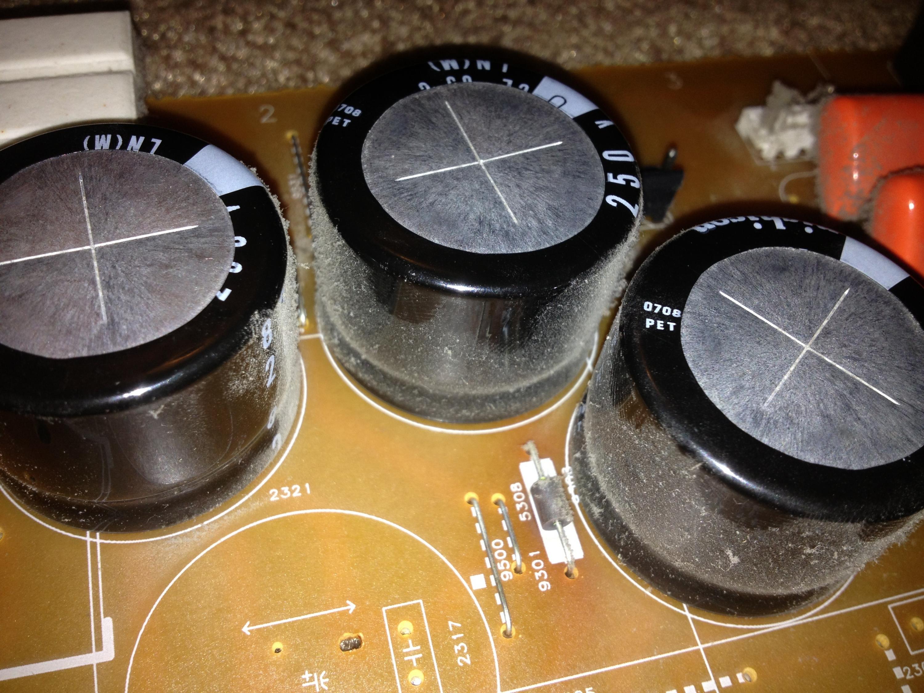

          Couple more.

              So the caps arnt bad. I'm thinking now inverters or main. Something has to warm up to turn backlight and all on.

                Yeah, visually speaking, those caps look fine to me. Did you try the hairdryer trick? Pics of the rest of the board layout would be helpful. Also, voltage output measurements from the PSU when the TV's "warming up" might be good.

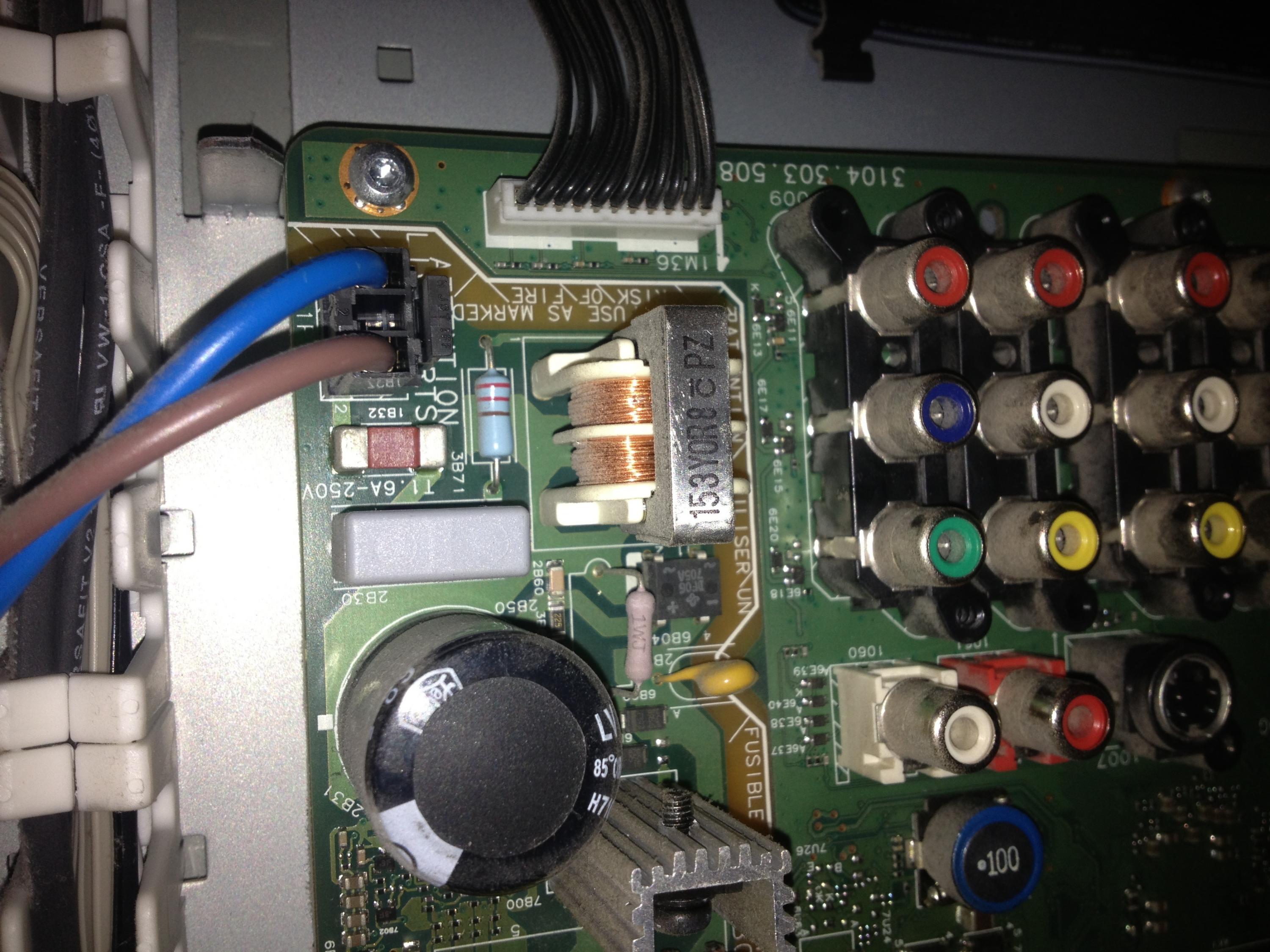

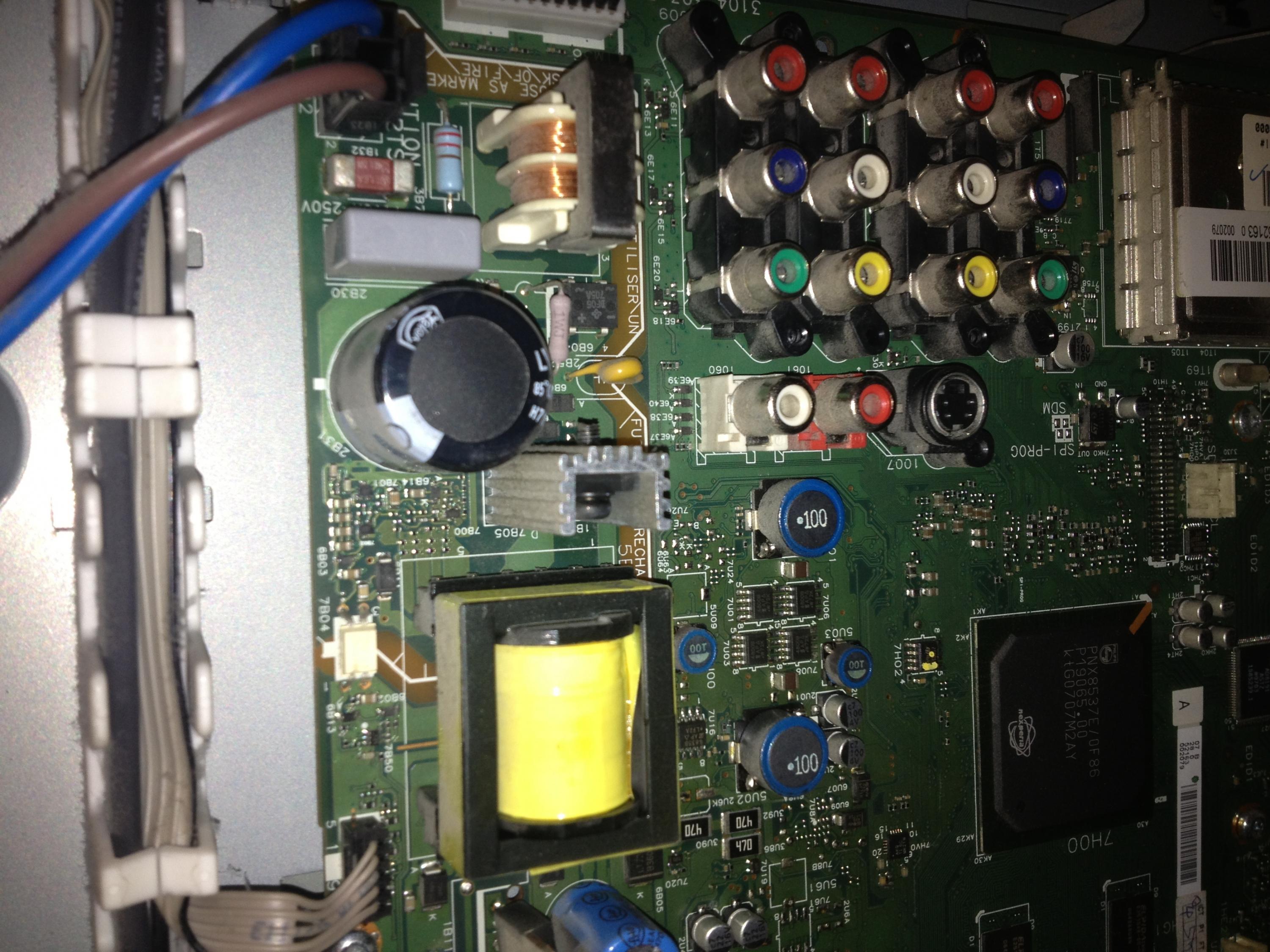

                    Ok so I put the cap I took out to get tested back in and plugged everything back up and the tv when I plugged it in the blue light turned on right away. I pressed the power button and the tv turned on. But then I turned the tv off with the power button and the tv turned off. The little led lights on the main board were still lite for about 30 seconds then turned off I think that's normal. But then the tv was making a high pitched squeal or whine while the whole tv was off. And I put my ear next to it and I think it's coming from the capasitor or the coil next to it. Here is a pict of what I'm talking about. Also I plugged the ambient lights in and they didn't work at all. Can anyone tell me where to go with the whine thing cause I feel like the tv is gonna stop working again a little while down the road and I don't want to sell it without knowing its not gonna have a problem when the person takes it home right away.

                      Actually I take that back it sounds like its coming from the yellow taped coil.
