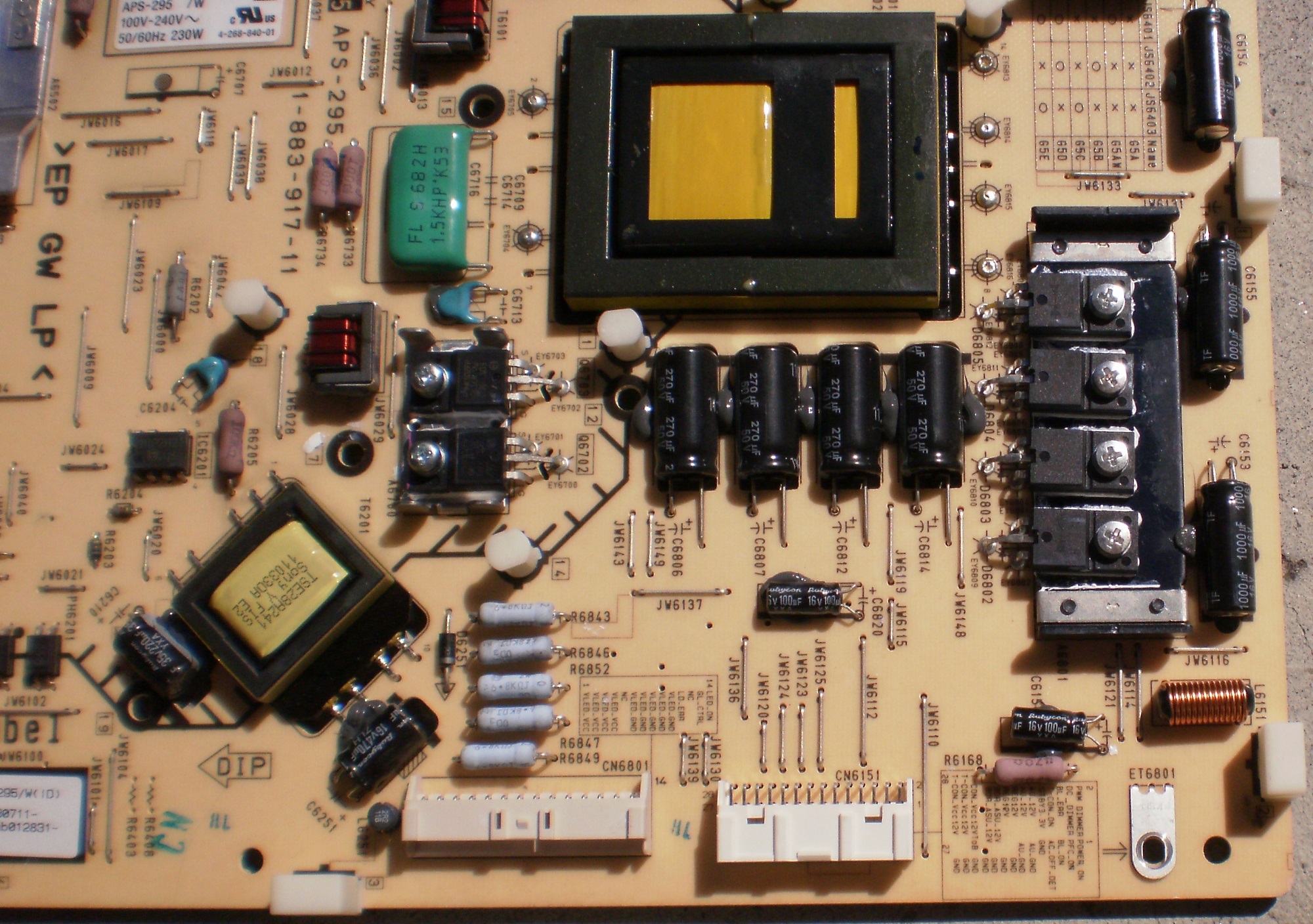

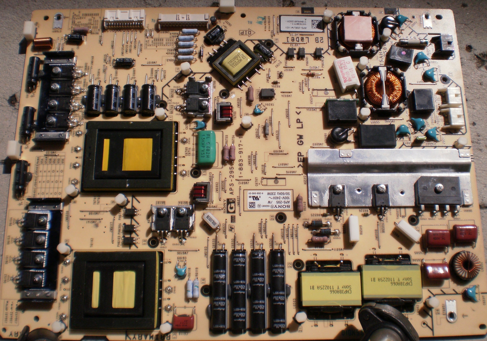

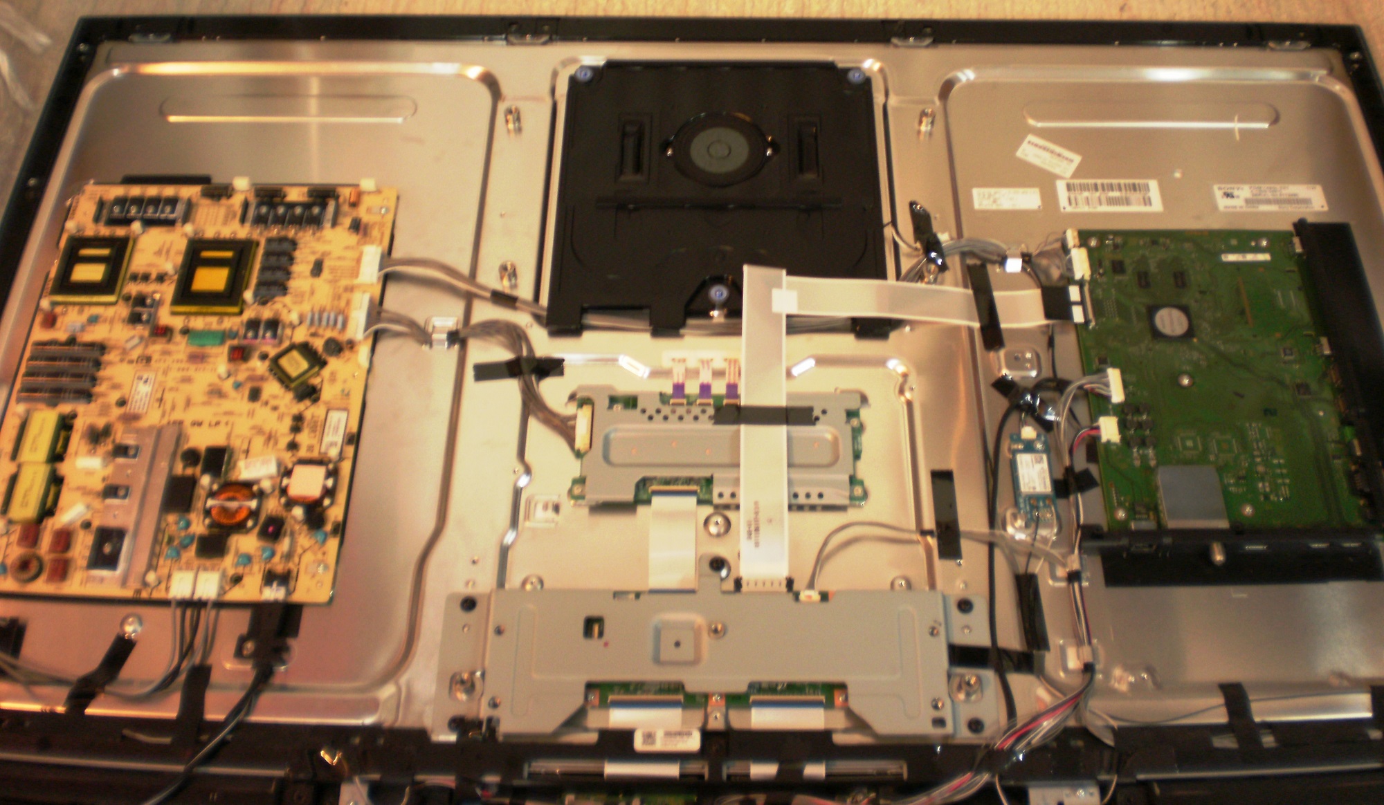

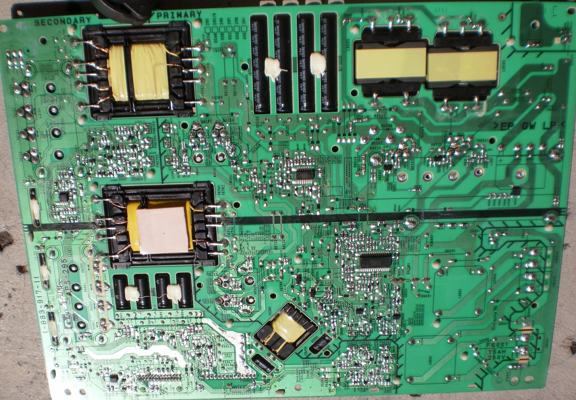

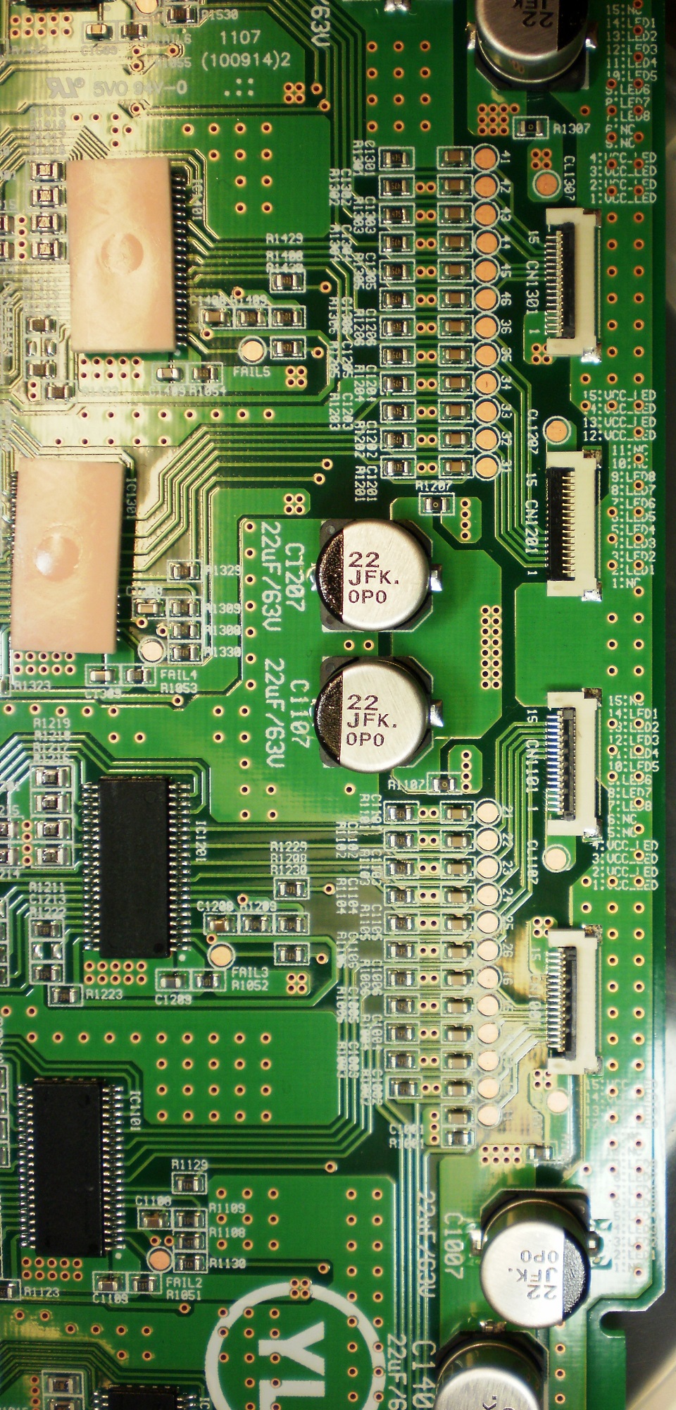

                    I had a little time and took some pictures.
                    Not sure where to start.

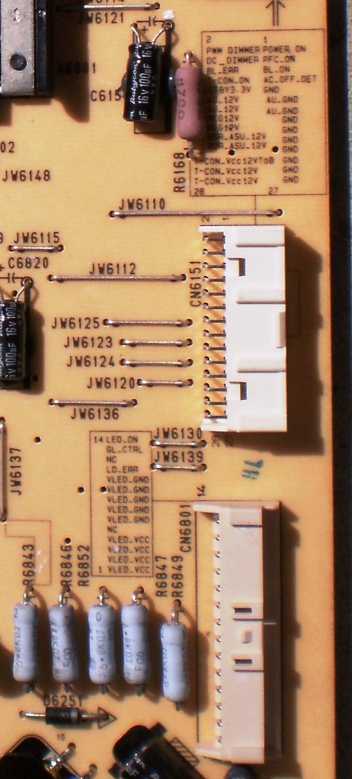

                    BL_ERR is 1.68V in standby, when I turn it on, it drops to 0.235V(don't remember the right number right now, I don't have my notes with me) and when the error kicks in, then goes back to 1.68V.
                    There are to many xxxx_On inputs and I don't know how to hard start the power supply.
                    It even had PFC_On.
                    Any input would be appreciated.

                        What do you get at LD ERROR?
                        Follow-up: After looking at the bottom side of the board, all the LED_vcc are tied together, same for the LED_Ground, so the Vcc_LED voltage from this board must be fed to the other LED driver board some where, the board in the middle?. The output voltage is not very high either since those 4 filter caps are rated only at 50VDC.

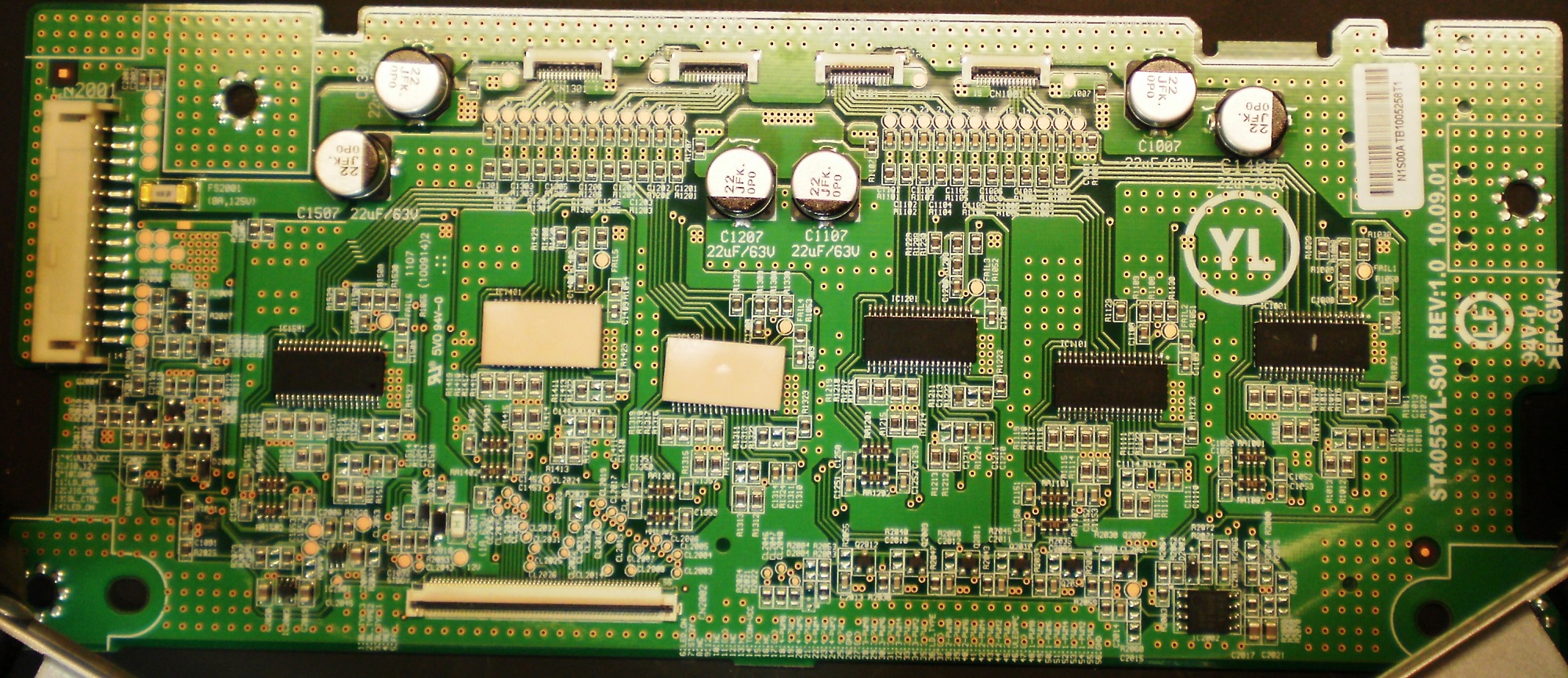

                          I will do those measurements soon, but the LED driver board is the one in the middle. There are four ribbon cables coming out at the top of the board and they are going through some cut outs in the metal cover to the LEDs.

                              I have measured the LD_Error, it's 0.66V before start up. When starts up, it drops to 0.04V and when the LEDs turn on, it goes back to 0.66V and when it shots down, it goes toward 0V.
                              The VLED_Vcc is 27V, when LEDs turn on.

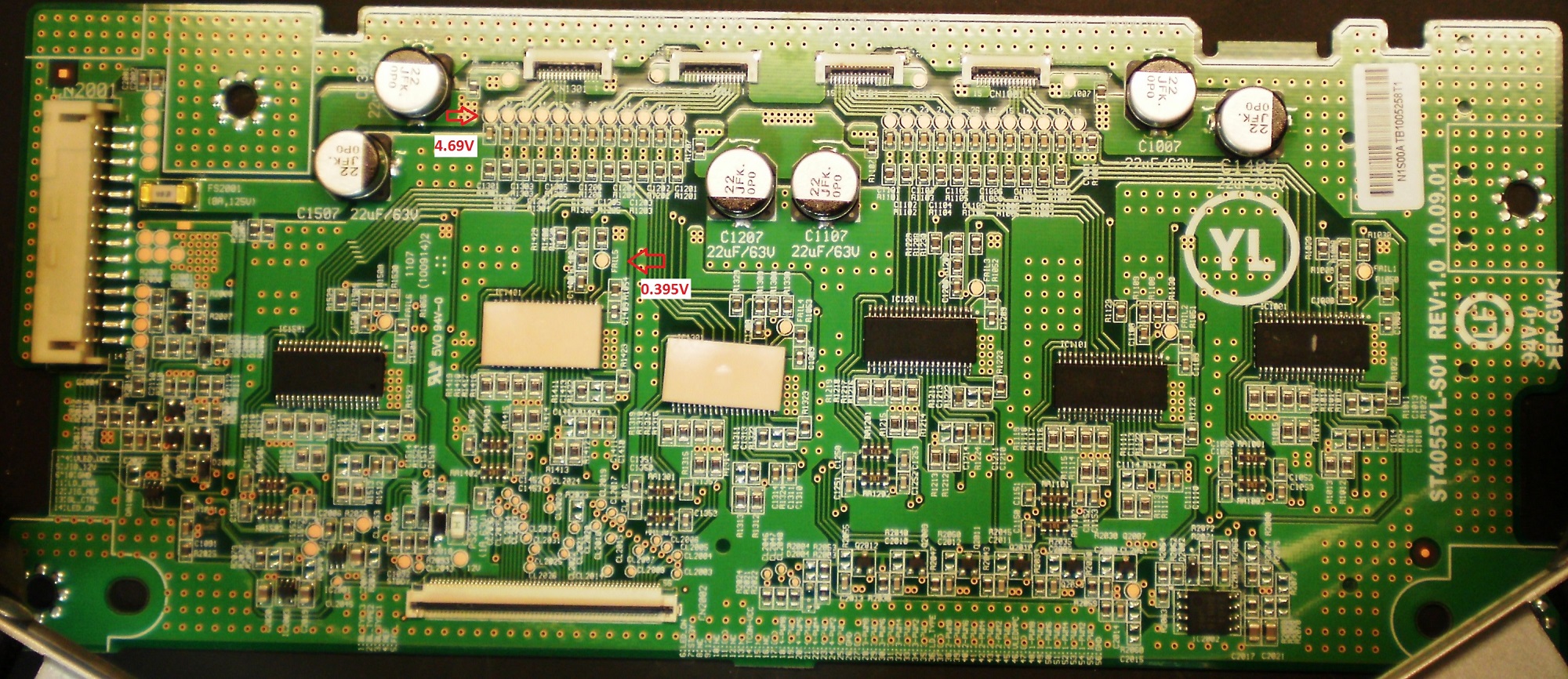

                              • tibimakai
                                • Jan 2012
                                • 3680
                                Re: Sony KDL-46NX720 possible purchase
                                I have took some pictures with the LED driver board and there are some test points on this board.
                                Before the output connectors there are a bunch of test points and they are all 4.69V when the LEDs are on.
                                Next to each output connector there is a single test point, which I guess is the LEDs supply voltage. They are all 27.05V.
                                There are 6 test points above the 6 ICs, called FAIL 1-6.
                                FAIL 1,2,3,4 and 6 show 2.825V before the LEDs turn on and after they turn on it drops to .589V.
                                There is a difference at FAIL 5, where the 2.825V is the same, but after that it dropes to .395V only. I guess, this should indicate something is bad, no?

                                      I have it. It shows LCD panel or LD board(LED Driver). LD board schematic is not included for this model, only the 40" one is included, which it looks different.
                                      Both documents are over 17 MB, so I can't upload them here.
                                      • tibimakai
                                        • Jan 2012
                                        • 3680
                                        I guess I will have to get the part number from those six ICs from the LD board.
                                        They are not given in the SM.
