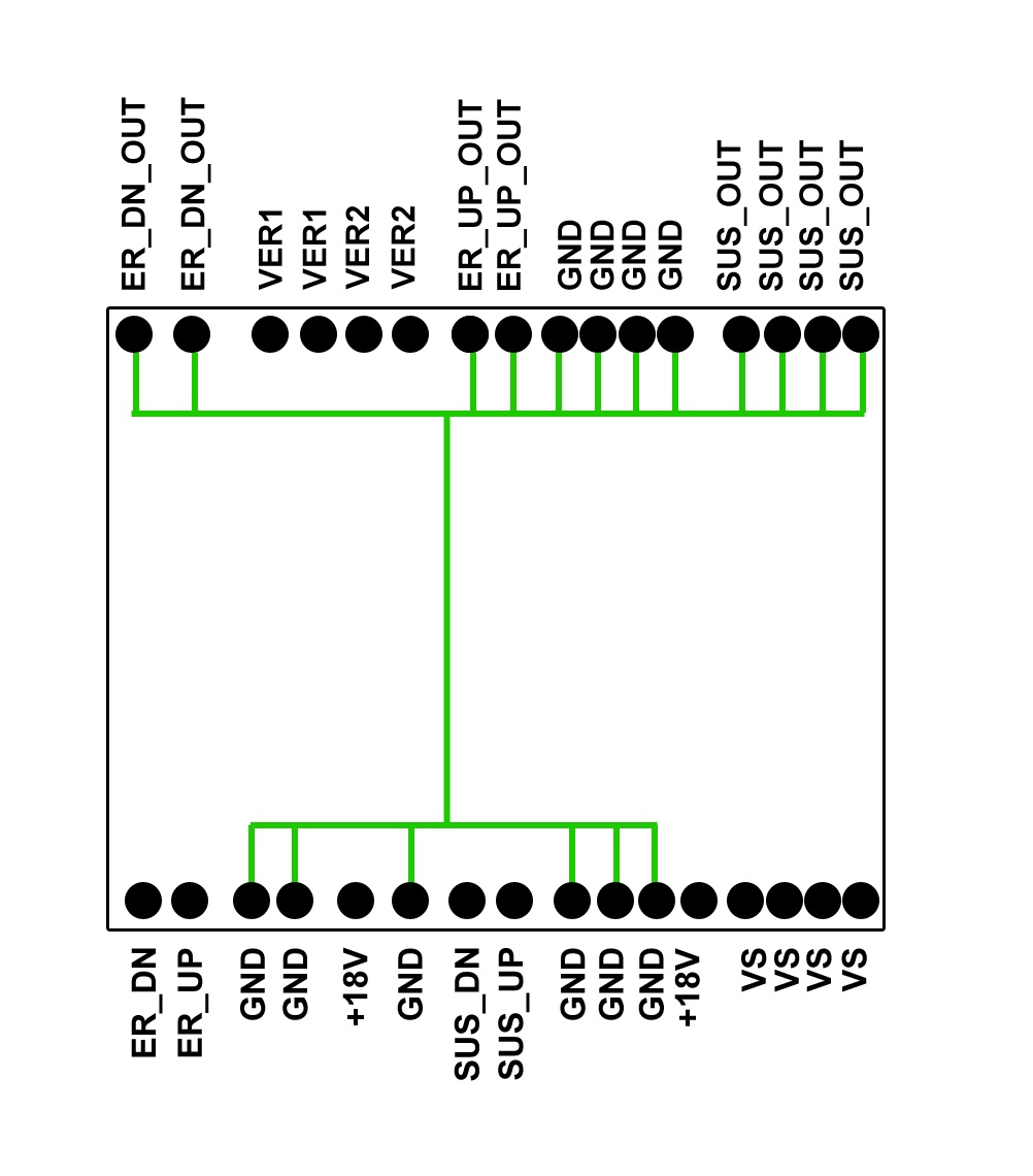

    I'm working on a 42pc3dv - no picture has sound. Bad fuse on ysus board( short to ground). I did the test on the ipm that I found online and it tested as bad. I have a few questions hopefully someone can help me out with.
    After removing the ipm, I tested at the rings on the board where the ipm sits, a lot of the rings have continuity to ground( I attached an image). Is this right?
    There's a resistor on the board R36, one of the leads has continuity to ground, does this sound right?

    I can't answer definitively, but I suspect your resistor and IPM circuit board readings are fine. The cap doesn't appear to be blown. Someone here may have a junk board with the connector you need. I checked myself, and I couldn't find one.
