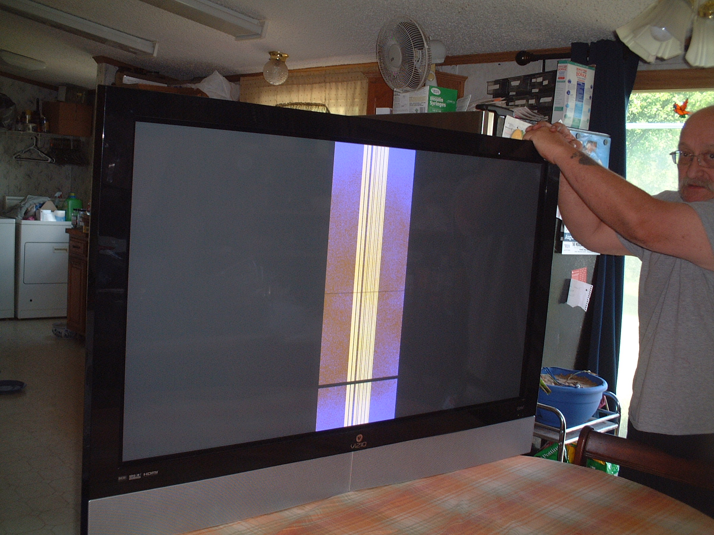

    i have replaced both buffer boards.still have snowy picture and no sound .logic board has 5 ligts on it and only the single light and the top and bottom lights in the row of 4. any idea
    Re: p50hdtv10a Plasma snow and lines no sound
    Can you show us a picture of the fault?
    The logic board LEDs are correct. They indicate temperature of plasma panel in binary. All lit is bad, otherwise they are OK.

      i had to find my camera. when i turned tv on the problem changed. i have a vertical line 6 to 8 inches wide. also 10 blinks on power light when shut down. thanks
        Y sustain board. That bluish stripe with the white stripes in it is your no signal box.
          my mistake cable from new board not plugged in all the way. now i have great picture but no input . i tried pushing button on the side but nothing happens . also the menu button does not work. i dont have remote

                              something new finally stood tv up and i have 2 line horizontaly on screen one tin line right in middle of screen and 1 quarter inch line 4 inches from bottom both lines are black
                                Could be one or more of the ribbon cables not seated well into one of the buffer boards. I had to try a few times on the last one I did. You should be able to guess which ribbon it is based on the location of the line(s).
                                  cleaned all ribons on buffer boards works perfect also for some reason the buttons on side work too go figure thanks for all the help
