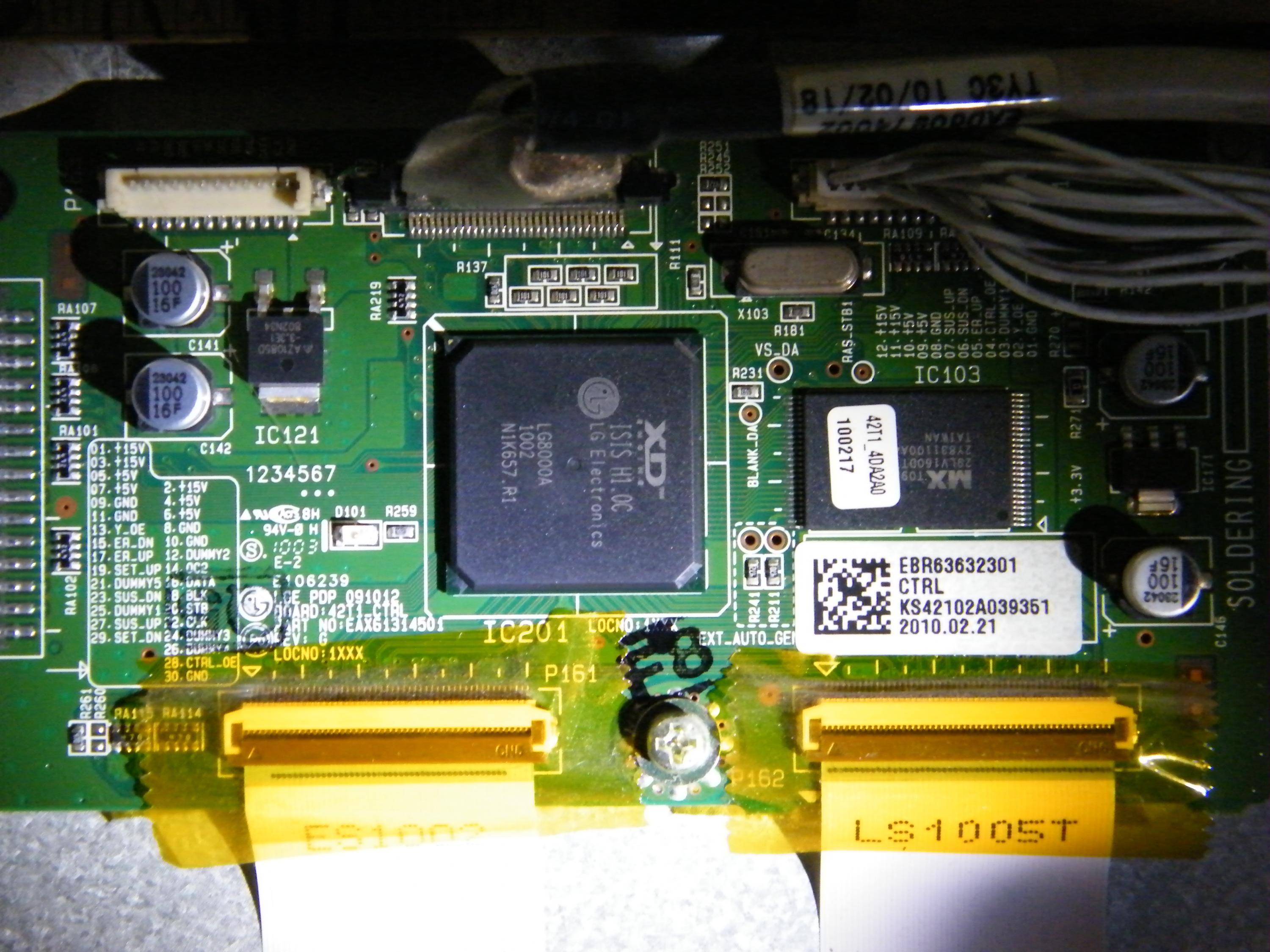

    If you take some pictures of the internal circuit boards in this TV, there is a way for you to run a self test to confirm if the main board is at fault.
      Re: LG 42" Plasma 42PJ560R - no picture

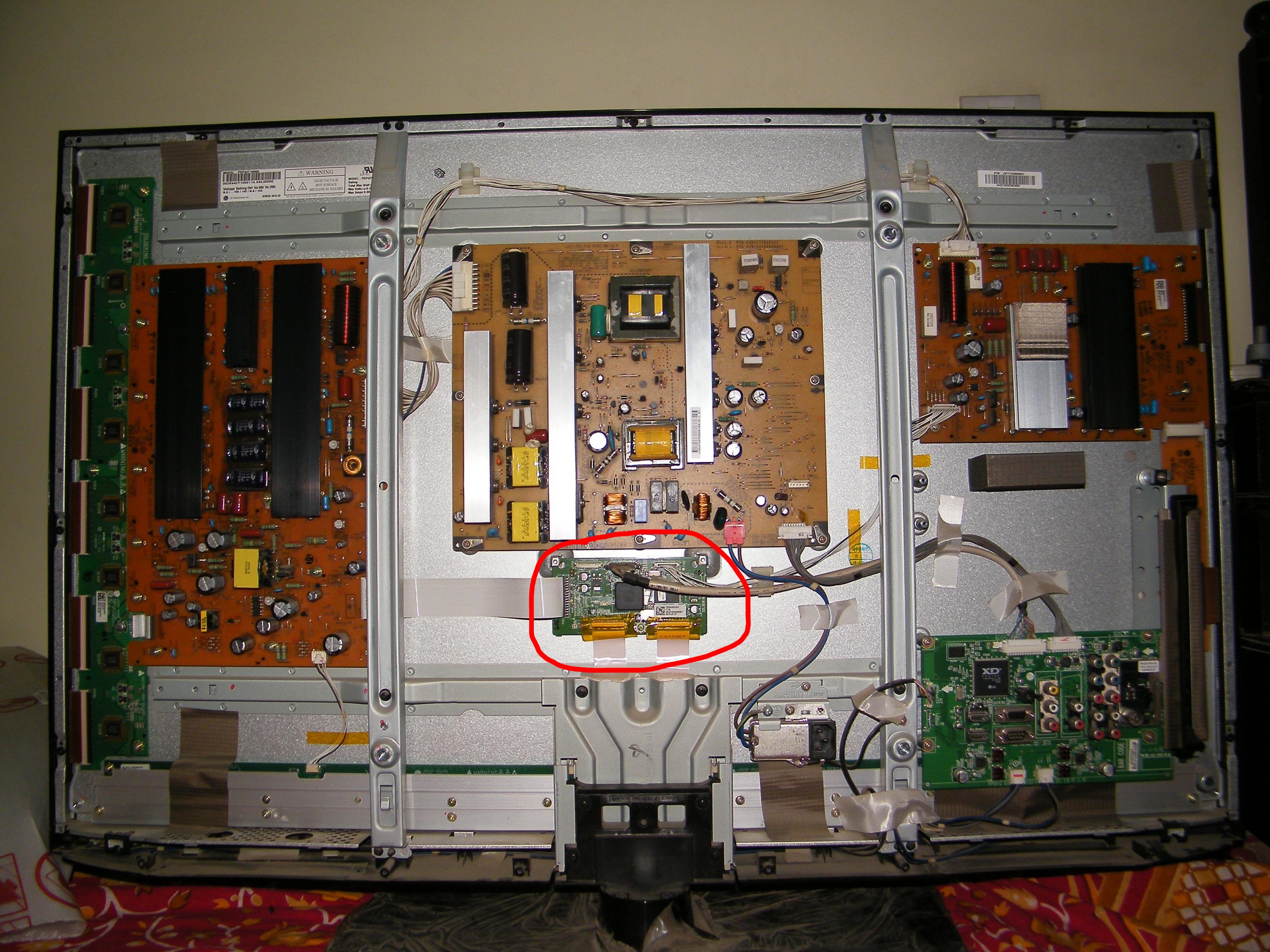

        Need a close up of this board. You will need a small piece of bare wire to use as a test jumper.
          Is this ok??

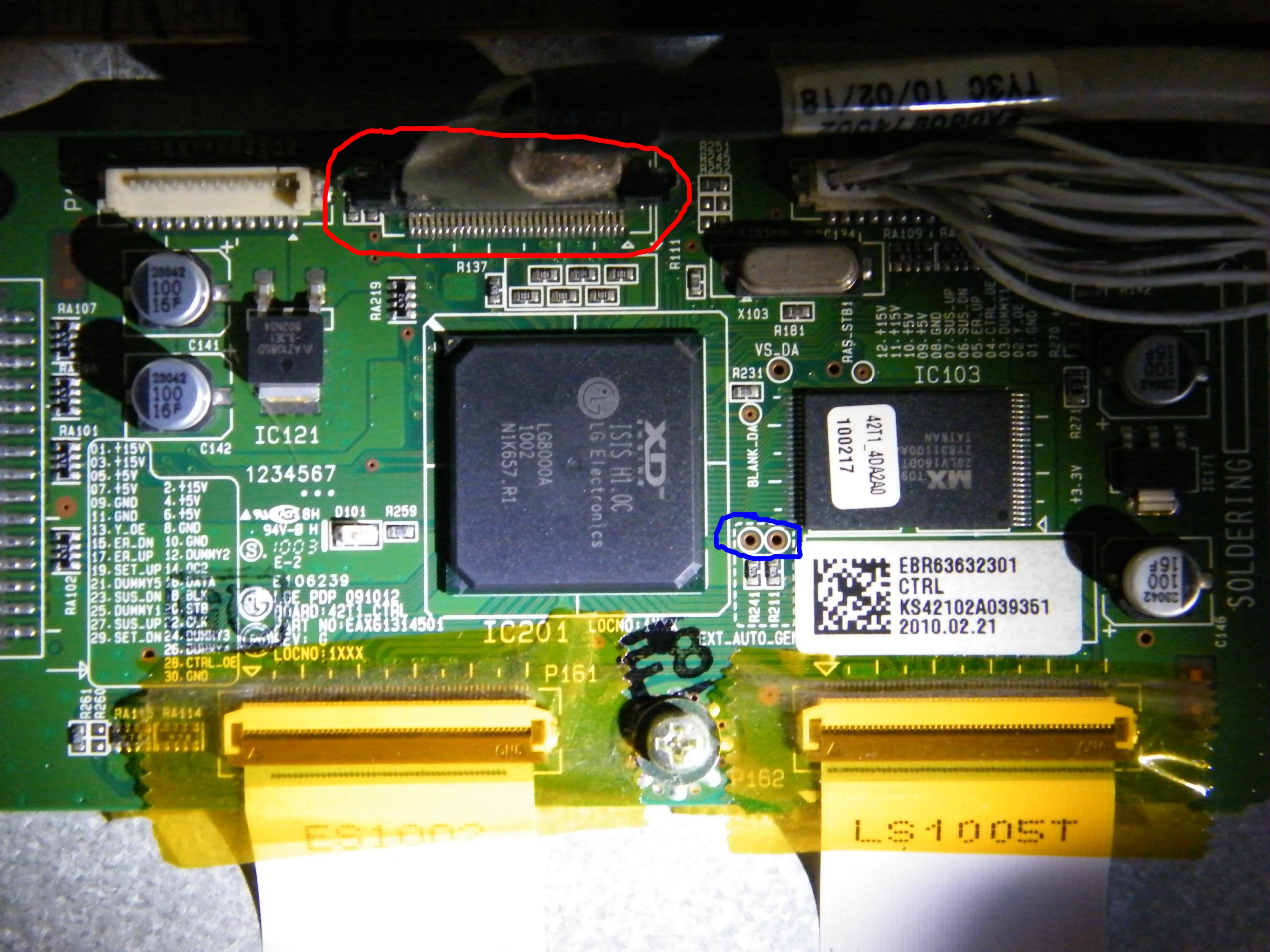

            Perfect.
            Power to the TV must be OFF (power cord disconnected.)
            Unplug the connector highlighted in red. You will probably have to press the two sides to release it.
            Then place a wire jumper across the two holes highlighted in blue.
            Plug the TV in again and turn it on. Test patterns should appear, like below:
            http://www.youtube.com/watch?v=xgrvR...9BzGSA&index=1
            If you see these patterns, then the main board is at fault. (The board you are testing is the control board. The red cable connects to the main board.)

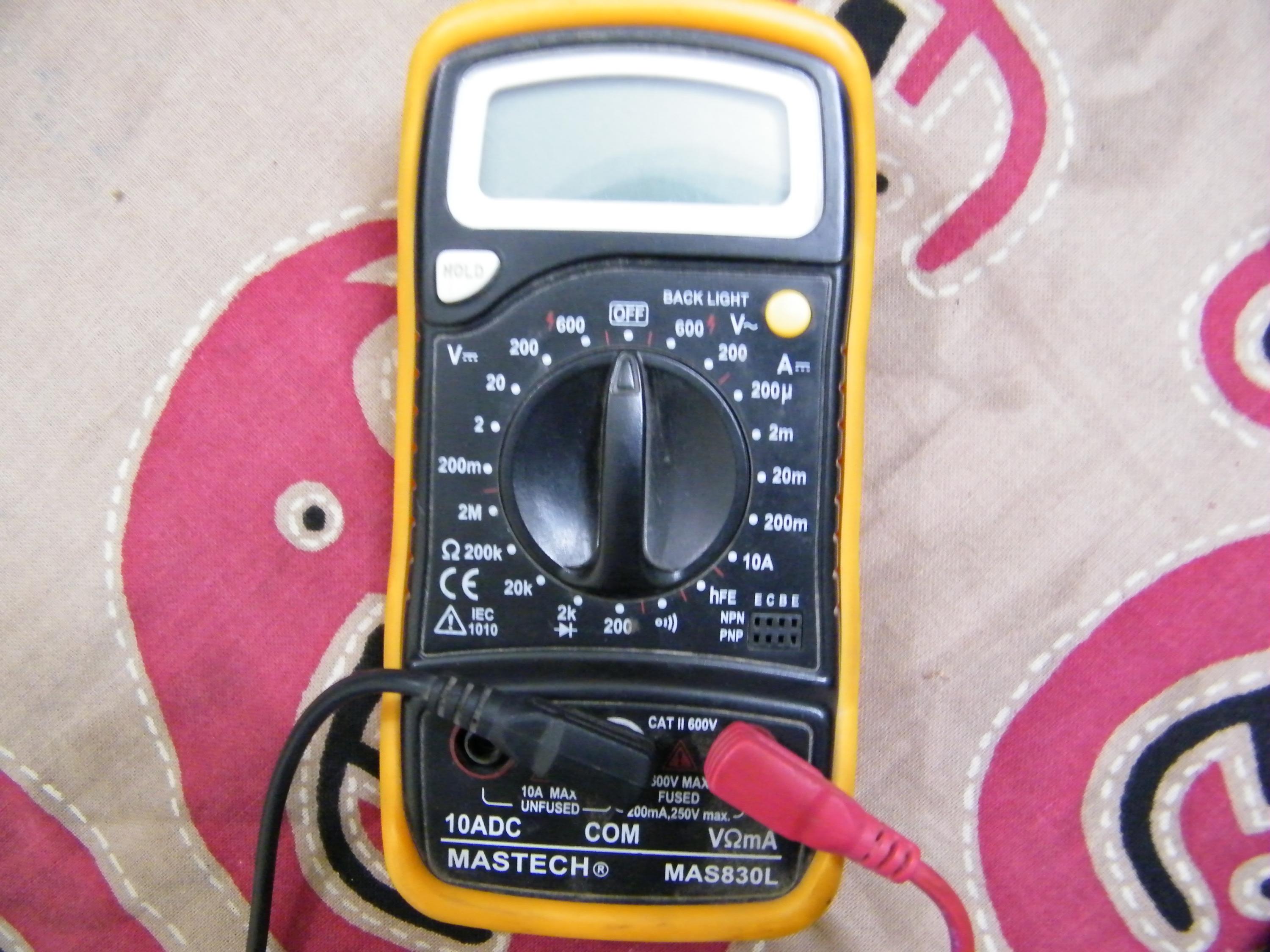

                OK, do you have a digital multimeter?
                  Yes, I have this one.
                    OK, that's perfect. Set it one click left of the "off" position (600V DC).

                        Can you show me how you configured the test pattern jumper?

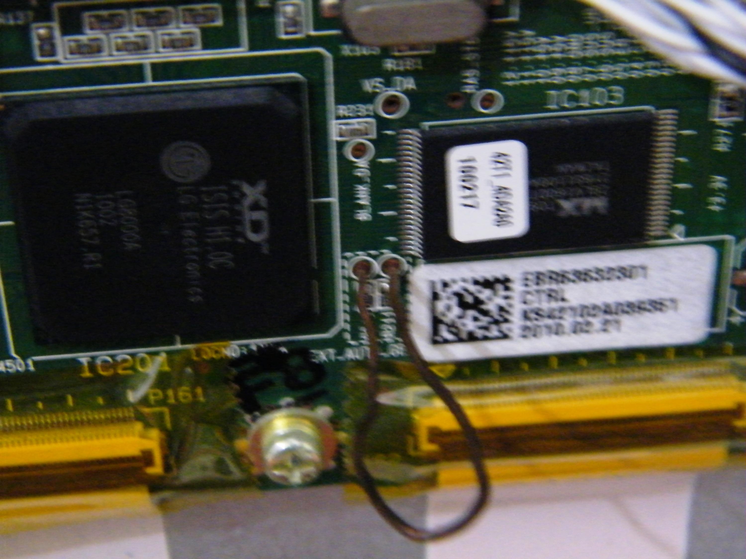

                          No, the screen is not emitting any glow when seen in the dark. I used a copper wire as a jumper. Please see picture.

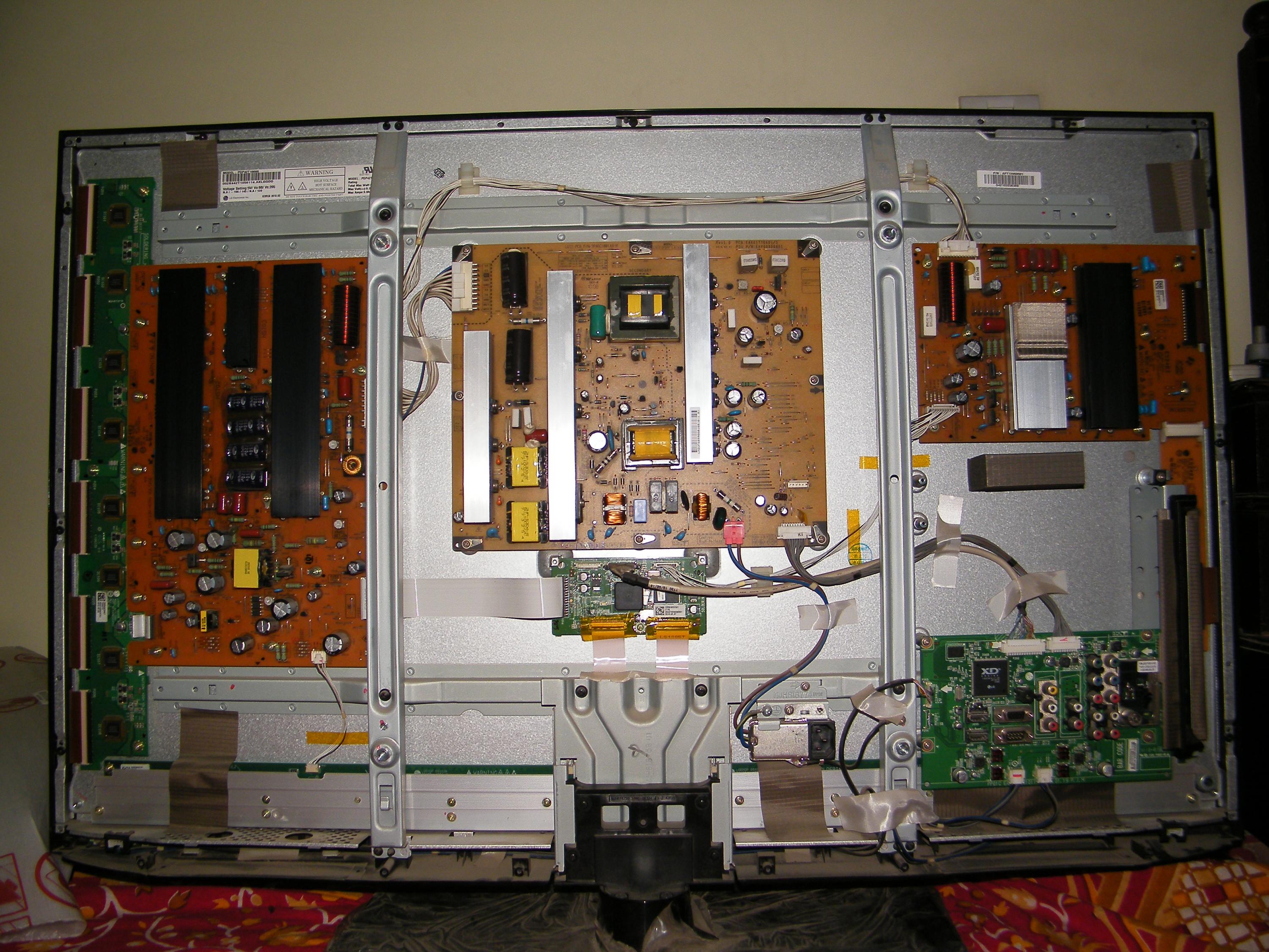

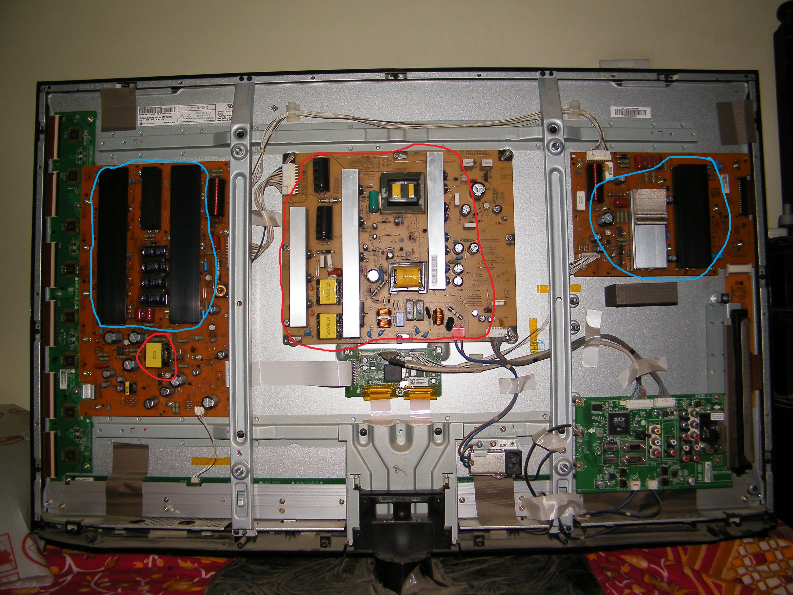

                                I left the set switched on for some time and I noticed that some parts were warm (marked in red) and the other were cold (marked in blue). Only the yellow transformer on the YSUS board was warm (it is getting some current) and all the heat-sinks were cold - does that mean something is wrong in that area of the board ???? Please advise.
                                  If the panel isn't lighting up, it doesn't draw power. This usually means things on the sustain boards won't warm up. The transformer powers some other stuff on the sustain board which does draw power, so it does warm up. You could try using a hair dryer, or freeze spray, to warm up and cool down parts, to see if you can get the TV to work again temporarily.
