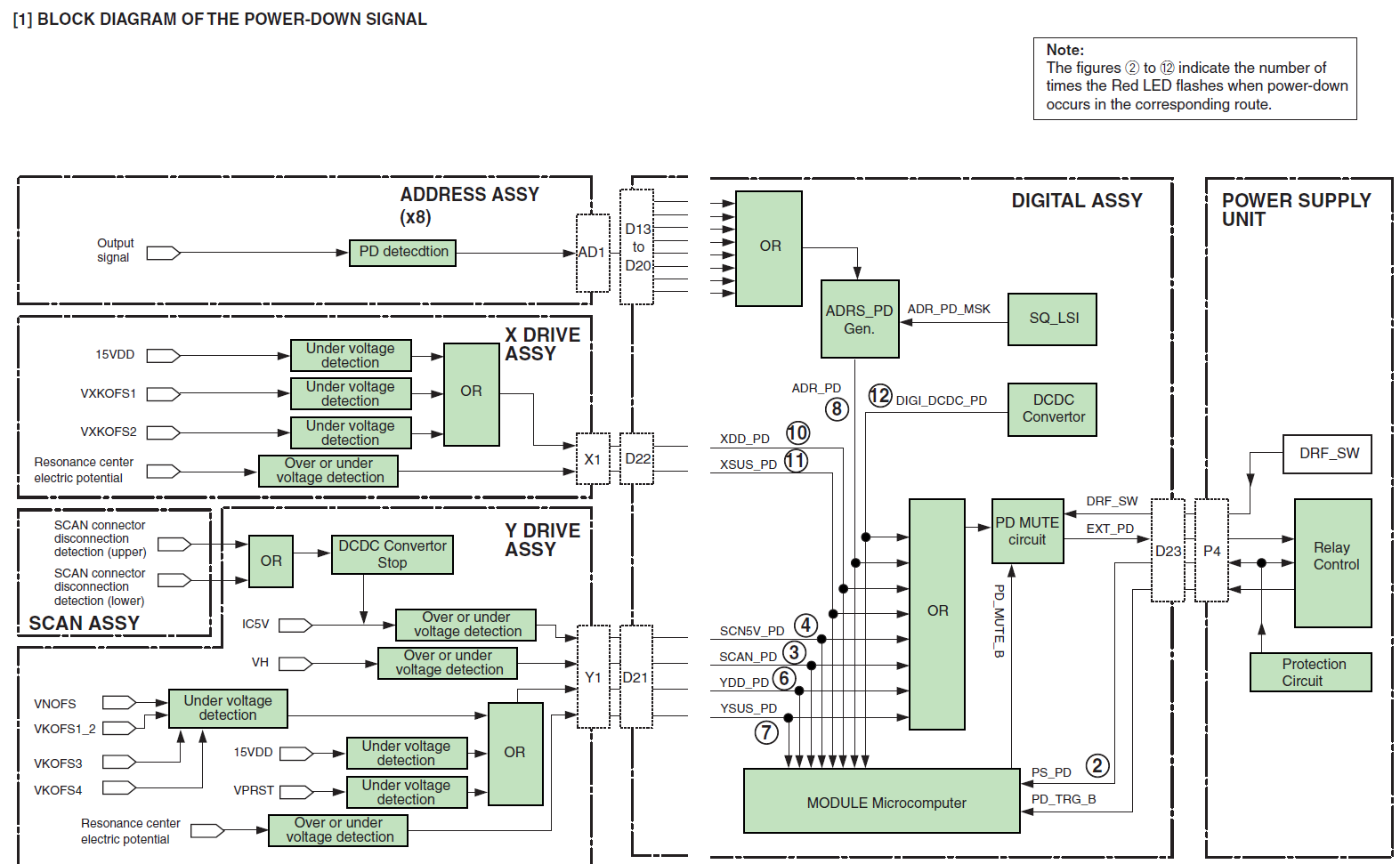

    I've unplugged and reseated all the connectors mentioned, but the unit still does the same thing. How would I go about diagnosing VADR if it only clicks on for a moment?

            I dont understand where the set detects voltage - should I look specifically at the PSU or would it sense for VADR all the way out at the address buffers?
              Re: Pioneer PDP-5020FD plasma STBY light 8 flash

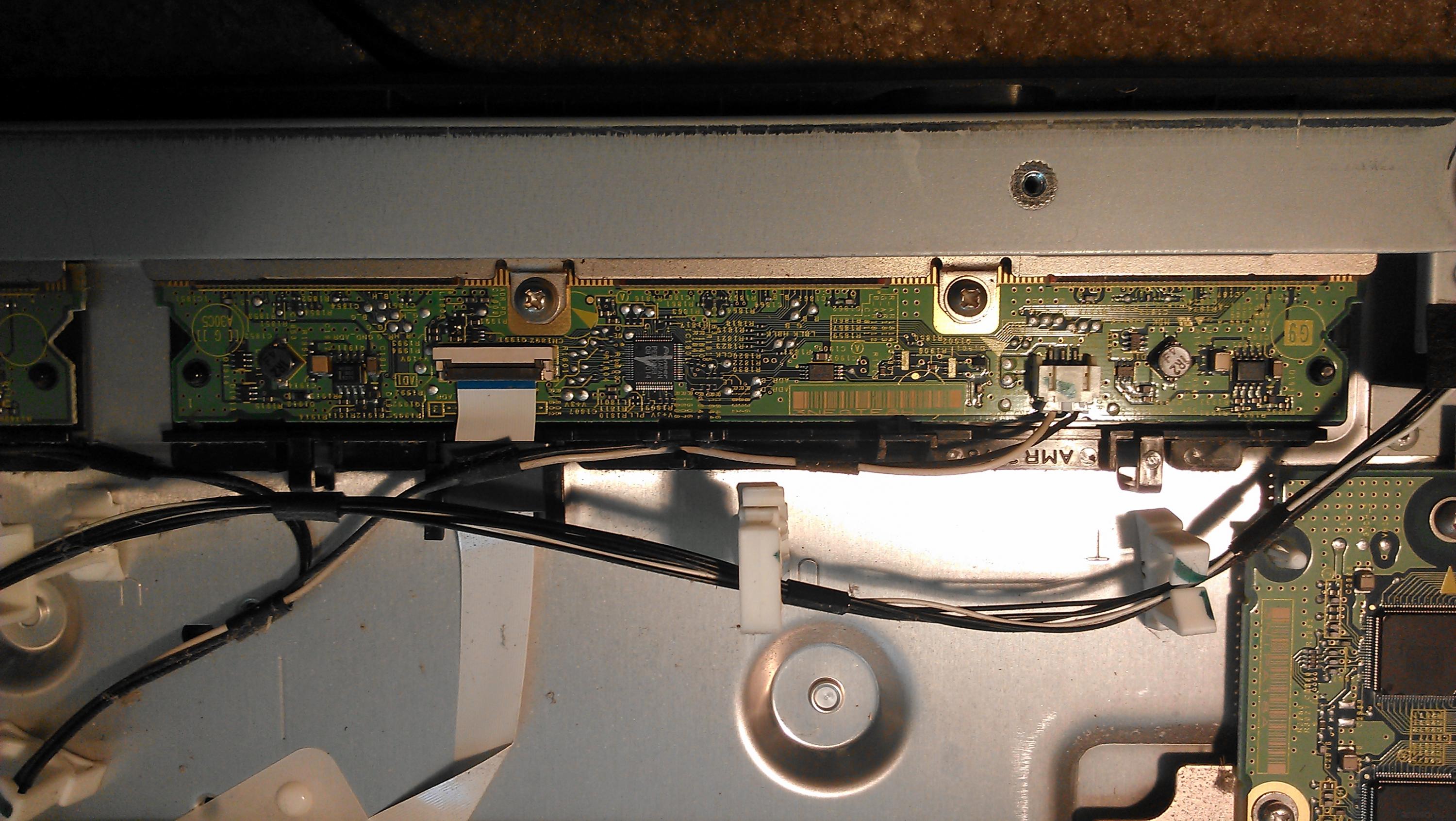

              There are 8 wire pairs that go to the address buffers - I'm getting 75V on all the buffers themselves
                The 75V is probably sensed on the power supply. Look for a signal like VADR_ERR or similar. Does the SM mention any error signal going to the main or digital boards?
                  I'm having a hard time making sense, but it appears that "PD Detection" is done at the buffer level. On the image I posted, an error code "8" is detected along the corresponding route.
                    So where is connector AD1 on each ADR buffer?
                      AD1 on each address buffer is a ribbon cable with about 10 conductors. Each go from the address buffer to the "digital" board where the error light is.
