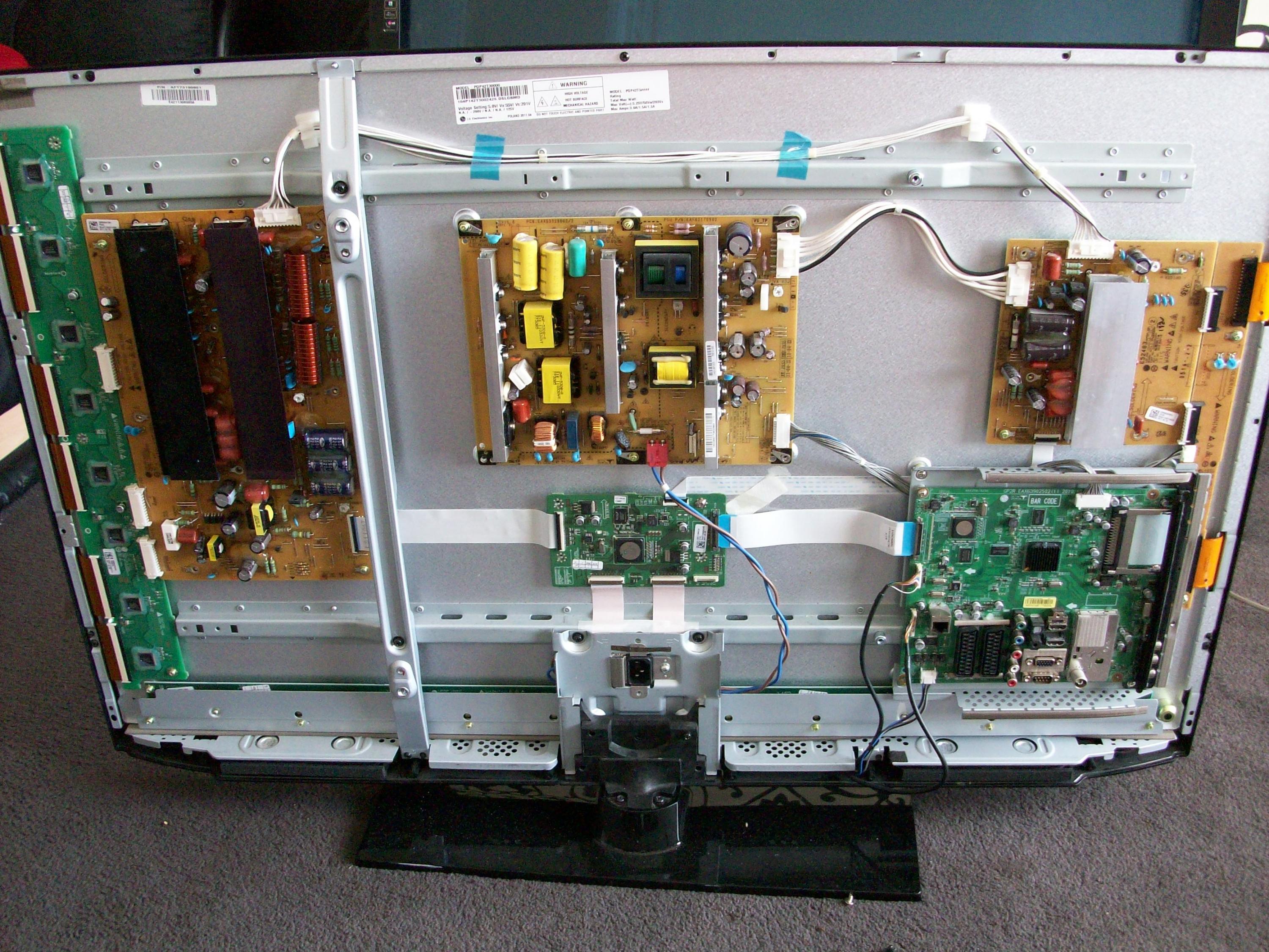

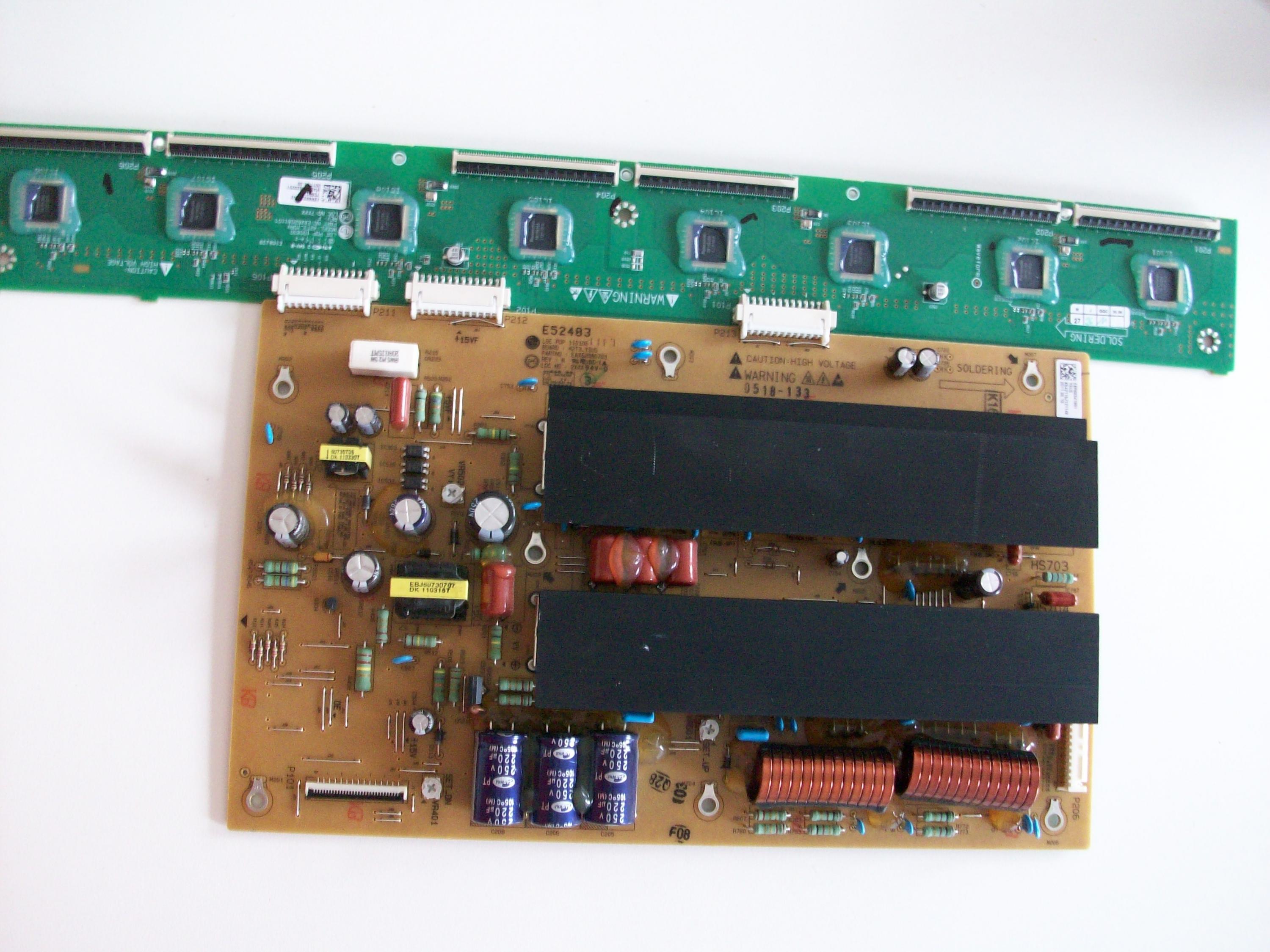

    Hi have a lg 42pw450t , was not coming on ,, changed the ysus board and it came on with a loud buzzing noise, and it was getting hot on the side of the ysus, so thought i,d do a factory reset, after i did that the tv did not come on again ,, accept when i unplug the ysus board , can some tell what causing this and how to fix it

    Hopefully, you don't have a bad panel, but it could just be a bad Y-buffer. Do you have pics of the circuit board layout?

      yes after i replaced the y sus tv worked worked normal ,, (2) after a reset it resets nothing was tuned in ,,so didnt hear anything ,,
      but i,ve sent you 2 pics ,,

                  no tom is isnt cracked , as i changed the ysus it came on for 10 to 15 mins with a perfect picture , but it was buzzing towards the ysus and it was getting hot where the ysus board was , so did a reset , then wouldn,t come on ,,,,

                    I would suggest your Y-sus was OK but some panel voltages were wrong causing excessive Y-sus heat, or there is a panel fault like a shorted electrode..
