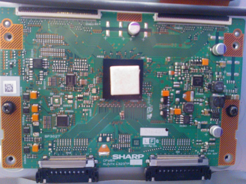

    Philips 42PFL7404 white screen
    Philips LCD model 42PFL7404 with just a white screen. Audio works.
    PSU voltages ok. T-CON fuse ok. What next?
    Re: Philips 42PFL7404 white screen
    What DC voltage do you get at the T-CON fuse? Pictures of the T-CON board?
    • PowerAmpFreak
      • 982
      • Sweden
      Hello budm, the T-CON recieve 11,85V measured on the fuse.
      Picture will come.
      • PowerAmpFreak
        • 982
        • Sweden
        Picture of the T-con attached
          At both ends of fuse?
          • PowerAmpFreak
            • 982
            • Sweden
            Oh yes!
              Look to be a few voltage regulators on there, tested those? Test the voltage across the few silver-purple radial capacitors too.
