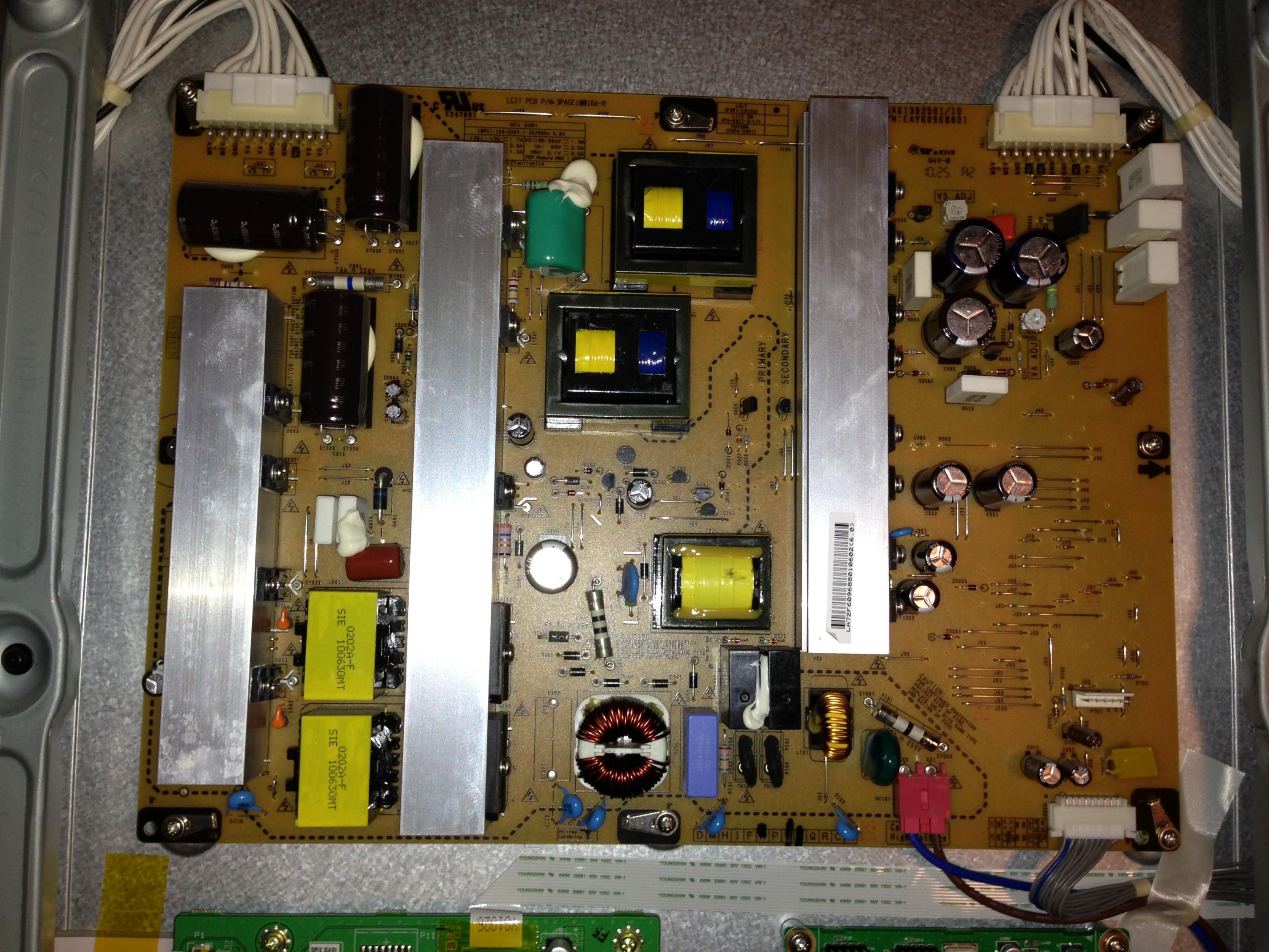

                Sorry for hijacking this thread but i have the same TV, LG 50PX950 and similar problem - when i turn it on, it clicks once and the TV screen changes shade from dark black to somewhat grey-er color which indicates something is working, but never shows any picture/menus, etc.
                I did some research and bought the repair kit from Bafury, referenced in the other thread cited here. I started working on the power supply and per the kit's instructions, replaced the 3 resistors, and it is still not working. I disconnected one end of the diode and measured it and it checks out ok, the fuses are also ok. So now i wonder if the voltage regulator works... How can i check/measure it to see if it works? I measured the voltages in the bottom right connector and the 17v/5v/stand by check out fine. The AC detect measures ~3.2v - is this how much it is supposed to be? IS there anything else i need to check?

                    Ok now, on the PSU outputs, the VA is 60v and the VS is 201v.
                    on the Z - VZB1 is 2.79v and vzb2 is zero.
                    on the Y - i have 3 Vy pins, all show 18.47v, i could not see a VSC, where should that be?
                    thanks

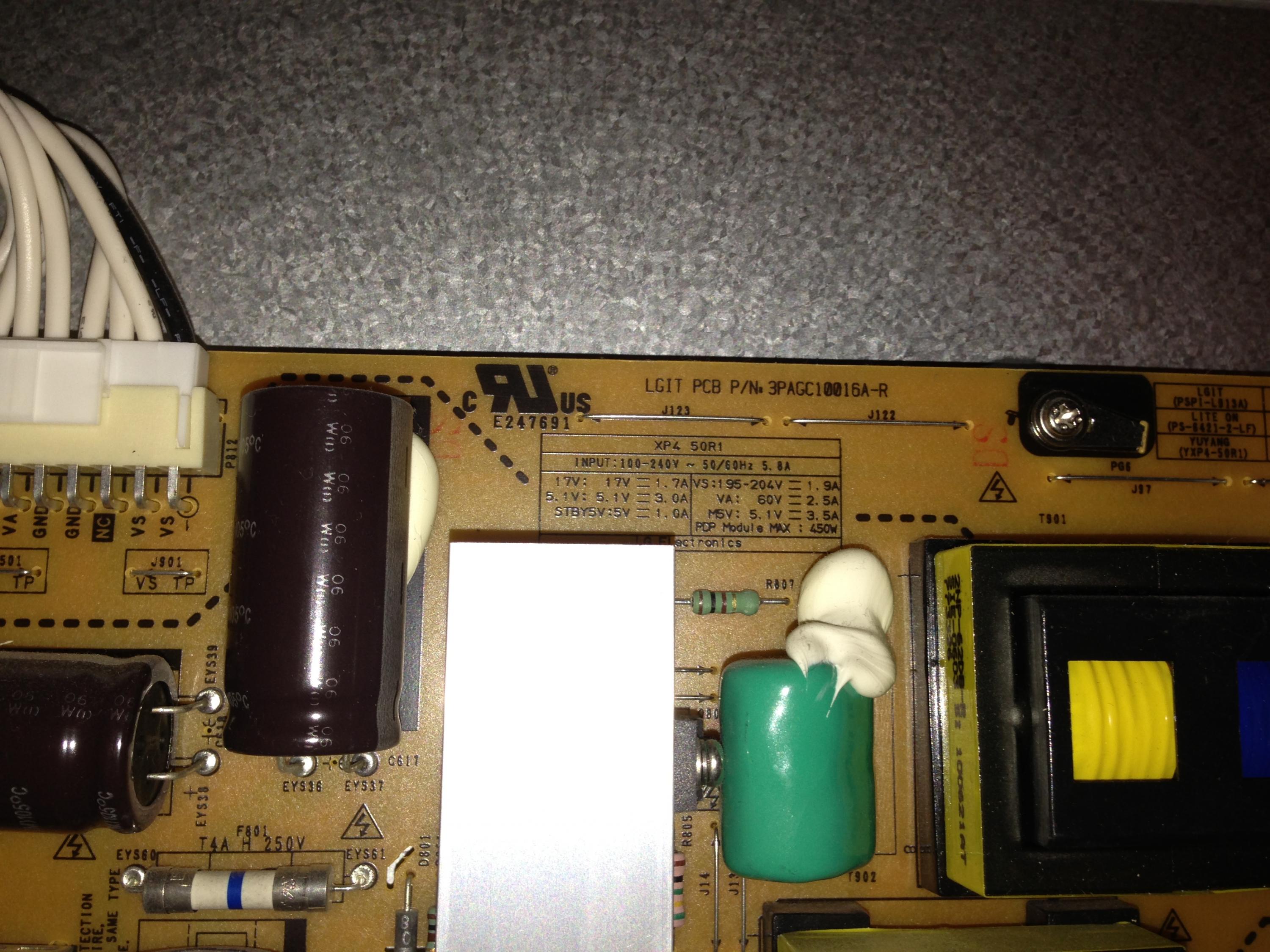

                        no, i measured the vy on the pins of the ribon connector at right side of the Y board - is that not the appropriate place? These pins are pretty small and it is a bit hard but i tried it several times and the measurements were consistent.

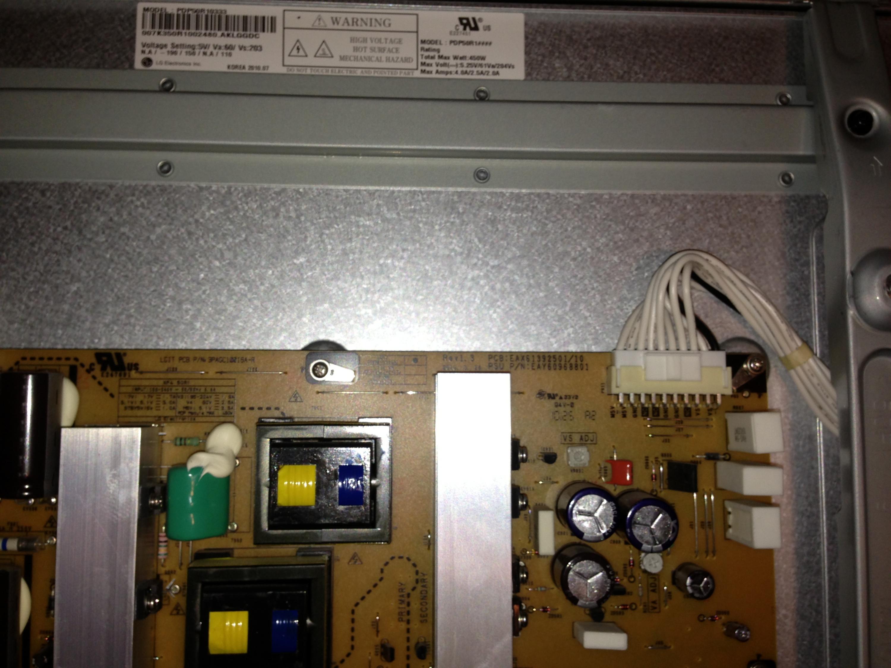

                            I am not at home, but based on the the attached pic it is PDP50R10333 (it is a little ineligible, but seems that is the number).
                            Based on the second pic, it seems the voltages check out, other than Vy which is not listed...
                              Re: LG 50PX950 Clicks, Turns off instantly
                              Great, see this guide for info
                              (Search for 50R1)
