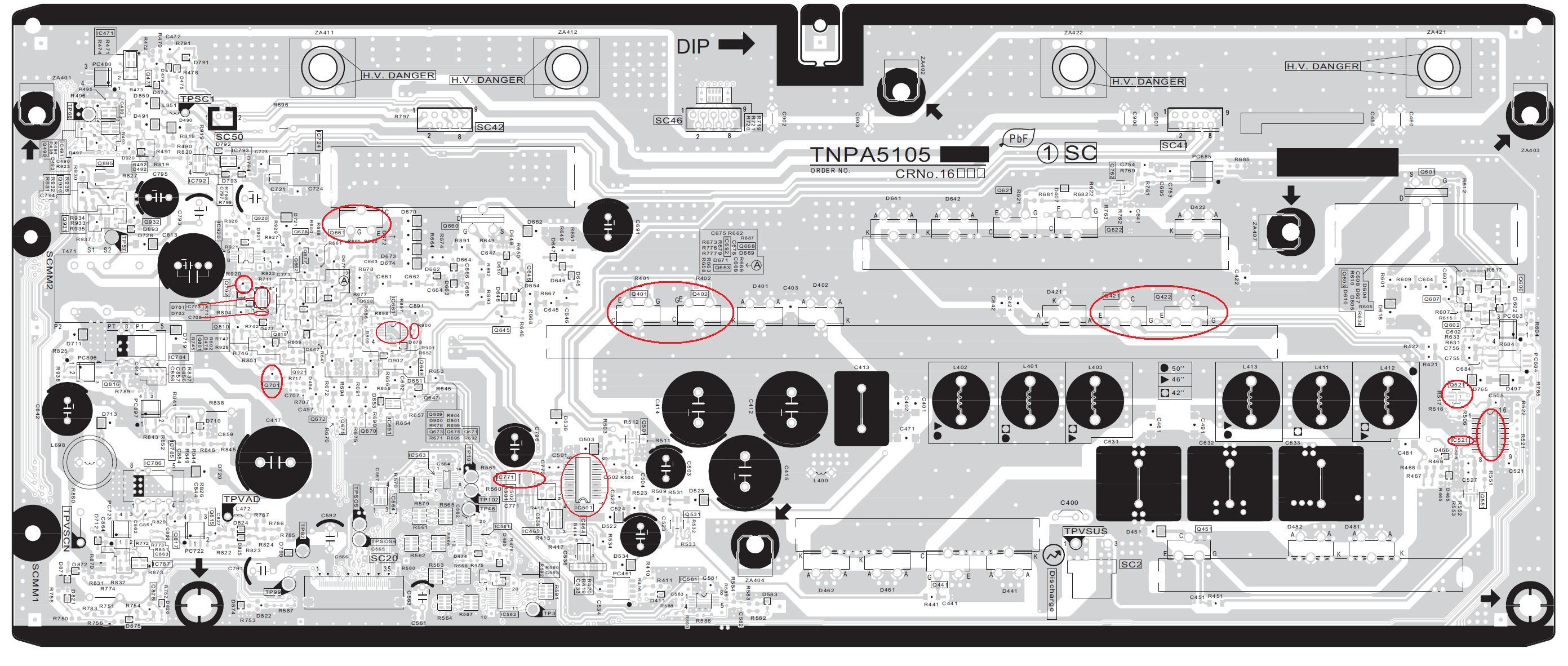

    I need a few pointers here, I have TC-p50s2 panasonic with the 10 blinks shutdown code that I think I have isolated to the SC board as high current problem but not sure.
    I measured sub 1.2v, sub 1.8v, sub 5v before shutdown OK
    Found SOS4 line to be odd, it went to 3v just before shutdown.
    Read I should check Vsus and Vda and found Vsus to be no more than .7v before shut down.
    Disconnected SC and it went to 202v before shutdown but still 10 blinks.
    Disconnected SC and S20 and it went to 6 blinks and took longer to shutdown, Vsus stayed at 202v before shutdown.
    Reconnected all leads but put ammeter on Vsus going to SC, read low for a second or two then jumped to 1.7 Amps and shutdown.
    Pulled sc41, sc42, and sc46 from SU and SD boards and jumpered SC50 and got the same results as above.
    I have 368 ohms from pin 1 of SC2 on SC board to ground.
    I also checked all the electrolytic caps in circuit with my cap. meter and they seem OK
    I don't mind doing board level surgery but I'm hoping someone here has a few pointers.
    Thanks Bob

    The SC definitely is bad. 368 ohms at SC2 is as good as a short.
    When you disconnected the SC with 202V Vsus but still 10 blinks was that with SC2 disconnected but the SC20 (ribbon)still connected?
    The P5V and P15V lines on the SC could also be shorted.
    Either way it's the SC. The cct is very close to the TNPA5081 I've fixed, the S2 uses the same SD/SU boards except yours has no heatsinks I believe.
    I would also check out the SU/SD boards as well in case they have an issue also

        Following tw2005's advice I checked the P5V and P15V lines. P5V no shorts. P15V was .9 ohms to gnd.
        I found Q521, IC521 bad (pretty sure, by resistance tests while in circuit)
        Then found Q421 and Q422 shorted, so now I'm thinking what caused all this?
        The VFG and VOL lines both blew their output transistors, by looking at the block diagram I don't see how they are connected to the SU, SD boards but then I'm not done investigating this yet.
        Still ramping up to test the SU, SD boards and thinking that the maybe I should look at the power circuits on SC (16V_F and Vad+5V and what else?)
        What about the A board, should I look there too?
        Bob

                Thanks for the list.
                I checked the other suggested devices
                Q16661 shorted
                IC16771 shorted
                IC16724 ok
                Did some poking around and not necessarily done
                Q16701 or something near it shorted
                IC16773 or something near it shorted
                Still need to pull these items to see what exactly is wrong but it is leaving me wondering if I'm chasing a catastrophic and/or display failure here.
                I really haven't analyzed what all these failures might be connected to and being there is no info about the SD, SU cards in the service manual it is hard to determine how they interact or even how to test them.
                Any know a test for these boards? sd/su that is

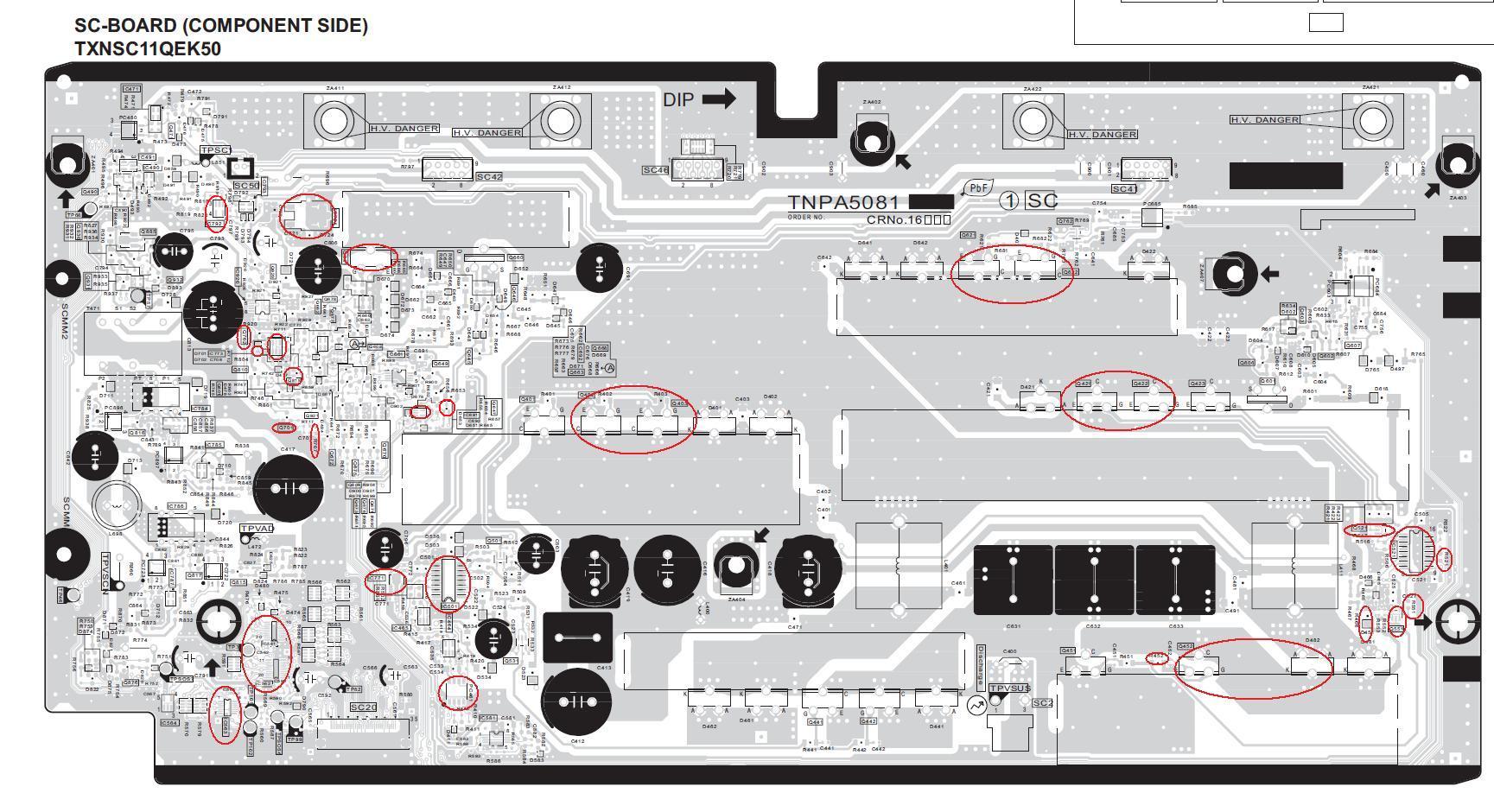

                  Well my only suggestion is you have a good slow read through my entire post. Since I've repaired three of these there's enough info to give you a good idea including resistance checks on those buffer boards.
                  But my parts list is something I'd pay close attention too as a good guide to the majority of parts that can fail. My last board blew out to about 32 parts in total but mainly because I missed some items and because the short had gone at the vsus the shutdown cct did not turn it off until it applied power and further damaged the board which complicated the whole process.
                  It took me a lot of time to work it out and unless you get it right the first time it quickly becomes a more expensive exercise than a replacement board.

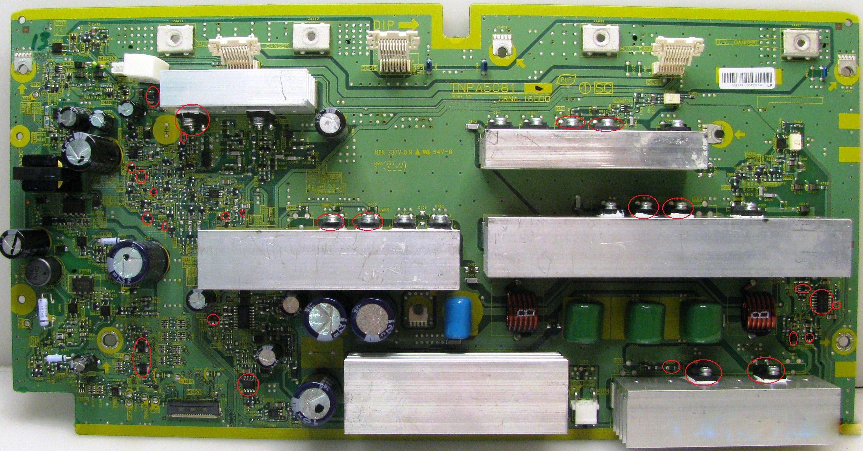

                  IC16771 & IC 16773 will both show shorted because the 5V reg feeds that Inverter IC. You need to make sure that entire inverter cct and the 5v reg are 100% to stop Q16661 from shorting again & again if you miss anything will also blow other things if powered up with anything missed and for me created a real challenge.
                  Q16701,16702, 16818, IC16771,16773, R16707, & D16702 all need to be checked or replaced and this should stop Q16661 blowing.
                  All 3 boards IC16773 had failed shorted. With those 2 regulators, I got tricked up on one board for IC16724, input resistance was correct at 2.6k in cct, did not check output which I found much later also was 2.6K, should be much higher so essentially I had 15V coming out instead of 5V.
                  That 5V is fed to the buffer boards. On the 2 SC with bad IC16724, the buffers were also bad and the 5V lines on them were shorted too.
                  The other trap with my last board was IC16771, input and output resistance looked ok in cct. However, after blowing Q16661 several times and having replaced everything else and still having Q16661 blow I got suspicious of that reg and decided to pull it out. Input was fine, output open, so no 5V to the inverter and bang Q16661 blows.
                  You'll read all about it in my post.
                  Post 22, 29, are 2 successful repairs. 82 on is my long battle and the long list of parts was a result of the stuff ups.
                  The first 2 were relatively quick, easy and cheap
                  Post 58 for buffers, if the results don't match exactly, swap the probes around it does affect the measurement.
                  If you download a manual for any of these and check out the schematic of a TNPA5081 in comparison to yours which may help you correlate my info to your board.

                  Also have a good look all around the area of IC16521, there for shorted diodes, blown or out of tolerance resistors, Q16451,R16451, Q16551,D16451,D16482.
                  Looking at your growing list I'm also expecting maybe Q16621. what transistor have they used there? With mine they have a pair of 30F125 IGBTs, looks like they've gone with only 1 IGBT there with yours otherwise the surrounding components look the same.

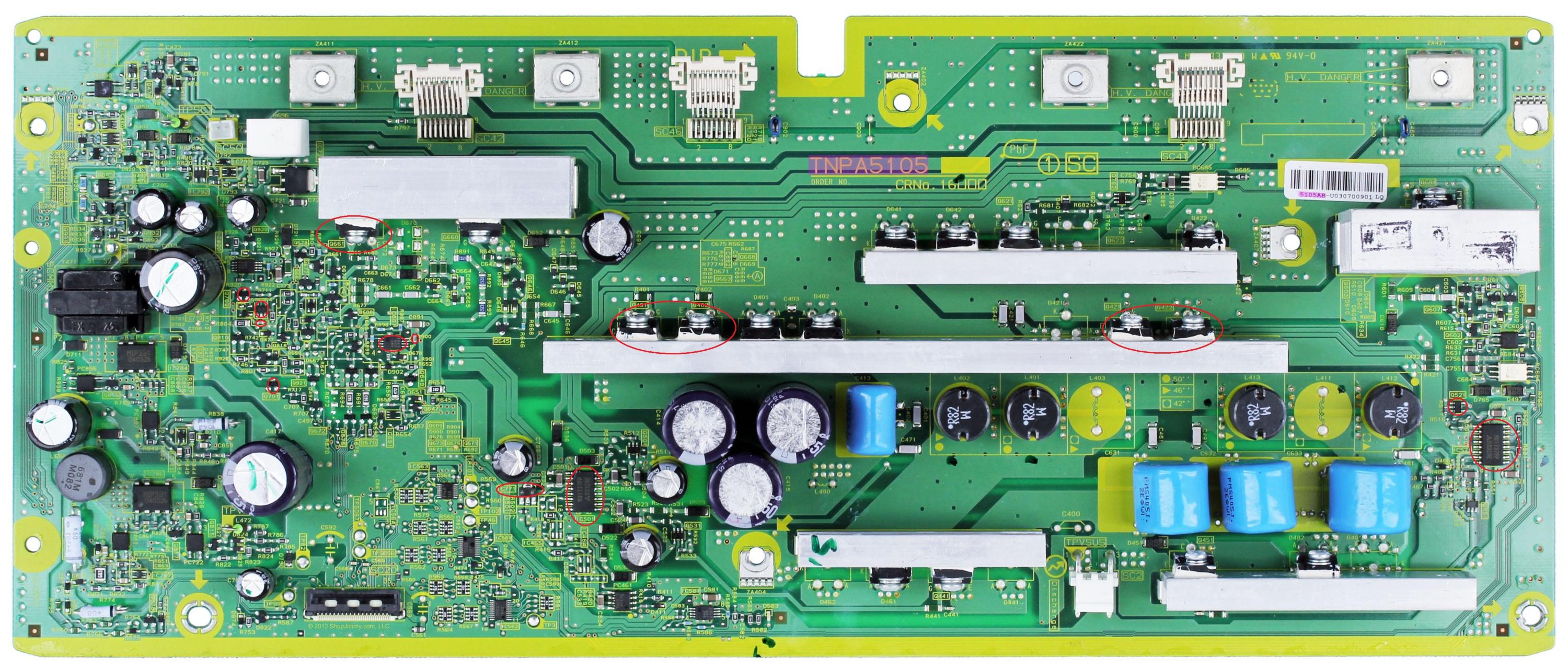

                    I have read most of your repair thread now and see the sd/su tests so when I dig back into this tomorrow I'll have a bunch of things to check.
                    Thanks for your input, it helps me move forward and hopefully save some steps +

                        To recap
                        Q16401 shorted
                        Q16402 shorted
                        Q16421 shorted
                        Q16422 shorted
                        Q16521 not sure if it was shorted but will replace anyhow
                        IC16521 again not sure if it was shorted but will replace anyhow
                        Q16661 shorted
                        IC16771 shorted
                        Q16701 shorted
                        IC16773 shorted
                        IC16501 not sure if it was shorted but will replace anyhow
                        Q16702 shorted
                        IC16661 removing this cleared a ~500ohm path 16V_F to VAD
                        C16708 lost during testing, gawd these things are small and hard to hold!
                        R16900 tested 3.9k in circuit supposed to be 10k
                        I test a number of capacitors that had 200 to 500 mF in circuit and were correct out of circuit. I started not pulling these caps if they weren't shorted, I didn't find a single shorted cap.
                        I ohms, diode or capacitance tested every device that was connected to the bad parts and found nothing else.
                        I used TW2005's SU and SD readings for his cards (different from mine some) and found enough differences to make me consider getting new/used ones (they are pretty cheap).

                            Re: TC-P50S2 10 blink SC troubleshooting,TNPA5105 repair
                            Q16401 DG3D5020CSLW TRANSISTOR 1 DG502LW shorted
                            Q16402 DG3D5020CSLW TRANSISTOR 1 DG502LW shorted
                            Q16421 B1JAEP000014 TRANSISTOR 1 RJP43F4A shorted
                            Q16422 B1JAEP000014 TRANSISTOR 1 RJP43F4A shorted
                            Q16521 B1HFPFA00001 TRANSISTOR CPH5524-TL-E not sure if it was shorted but will replace anyhow ((Pins 2-3 & 1-5 , 2-3Mohms from memory(I'm not shouting))
                            IC16521 C0ZBZ0001708 IC M81737FP again not sure if it was shorted but will replace anyhow (Good idea, did you check the Vcc-gnd resistance, how did P15V resistance right after this was removed? If still funny,NAND GATE cct, IC16691,Q16647 last board both those were failed)
                            Q16661 B1JAER000010 TRANSISTOR 1 RJP63F3A shorted(every board this was failed)
                            IC16771 C0CBADC00072 IC 1 78L05L, TA78L05F shorted(shorted out of cct too? 1 of 3 boards this was bad)
                            Q16701 B1ADCN000007 TRANSISTOR 1 MMBTA92 shorted
                            Q16702 B1ABCF000231 TRANSISTOR 1 2PD601ART,215, 2SD0601A0L shorted(every board this was failed)
                            IC16773 C0JBAB000715 IC 1 Toshiba TC7SH14F shorted(every board this was failed)
                            C16708 F1H1H104A970 C 0.1UF, K, 50V, lost during testing, gawd these things are small and hard to hold!
                            IC16501 C0ZBZ0001708 IC M81737FP not sure if it was shorted but will replace anyhow
                            IC16661 C0BBBA000024 NJM2903V(TE1) , removing this cleared a ~500ohm path 16V_F to VAD (very surprised to see this on the list, no problems on mine but did remove and compare to a known good one, wish I had not with the soldering)
                            R16900 D0GB103JA057 M 10K OHM J 1/10W , tested 3.9k in circuit supposed to be 10k(so out of cct it was? It all ties in cct ,part of which heads down to shorted Q701,702,IC773 so that may be the real issue?)
                            Green part numbers are also on that SS board I mentioned for scavanging.
                            M81737FP Qty 1
                            NJM2903 Qty 1
                            CPH5524 qty 5
                            F1H1H104A970 0.1UF, Qty 3
                            D0GB103JA057, M 10K OHM J 1/10W Qty 3
                            My very first repaired board, my post #22 is very close to the fault profile of your board.
