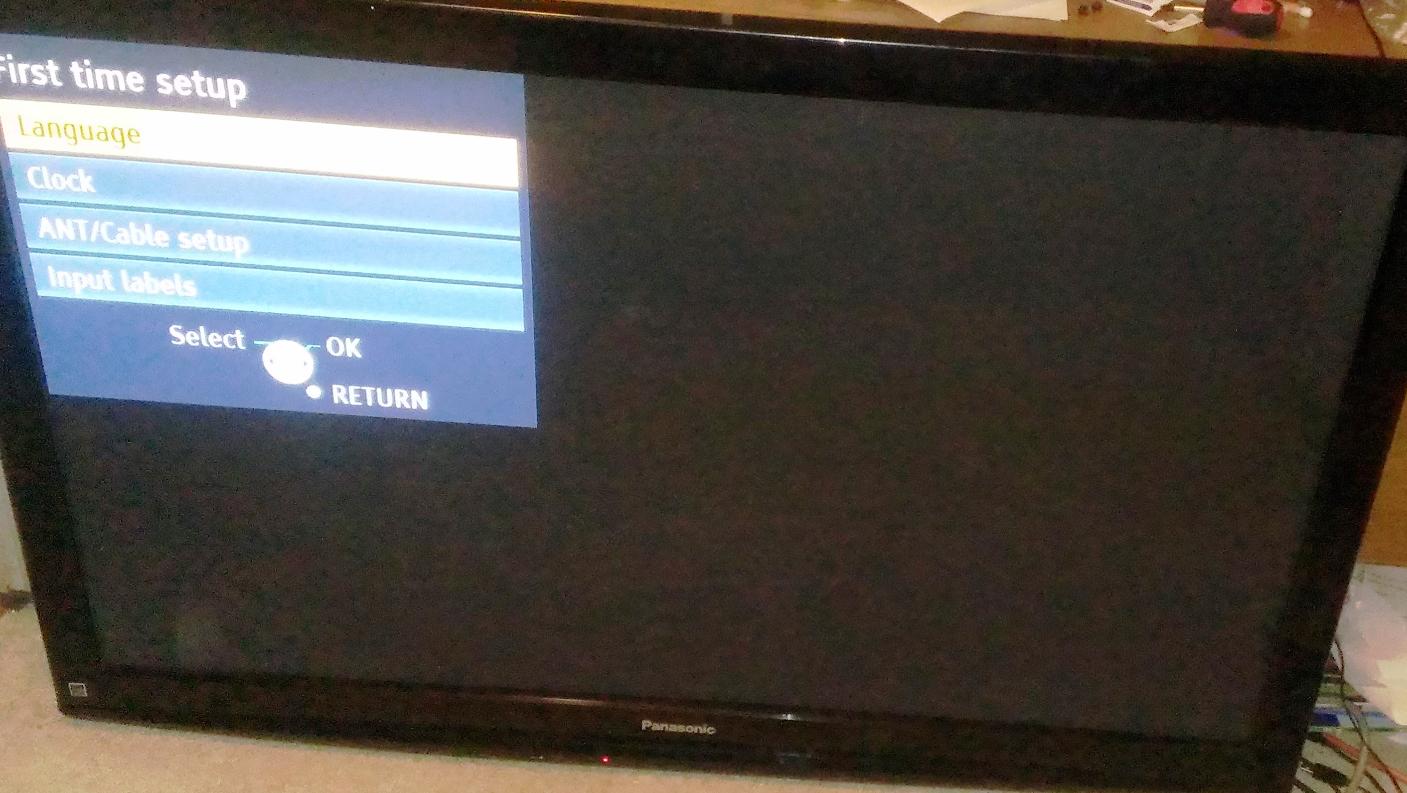

                Got the items today. Not too bad.. a few days for a few thousand miles.. About to install and will report back.
                • kyij
                  • Jul 2013
                  • 45
                  Re: Panasonic TC-50PS14 10 blinks
                  It powered ON!!!
                  With that quick of shipping, reward points, and usaully cheaper prices.. I will defineatyely bookmark the site.
                  Just now I have to get the back cover back on and make sure I have not cracked it in the whole process

                    Well That's good news and a very cheap repair for that board. If it turned on and has picture, then nothing is cracked.
                    Were your buffer boards ok in the end? O r did you just put all the received part in anyway?
                    A spare buffer set could be handy.
                    Hey post a pic of it running when it's all put back together.

                            A pic of the finished product.. I say, getting all of the ribbons in place might had been the hardest part of the job..

                                Looking great, yeah, it took me 3 goes to get mine right on my 50 FHD, now I have no trouble, practice i guess.

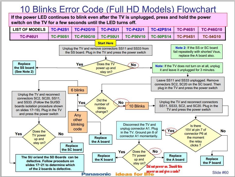

                                  I picked up a tc-50ps14 which has the 10 blinks issue. I followed the flow chart on the PDF, which ended with pulling the A1 and grounding the 8th pin. My interpretation is that the tv should have powered up briefly although the 10 blinks code may be displayed. The set did not power up at all with the A1 disconnected and pin 8 grounded. Does this indicate the A board is bad? I expected it to power up and give 10 blinks at least.

                                    Try this. disconnect Sc2,sc20,ss11,p35, 3 white ribbons at the A board A31,32,33 and try turning it on. if it still 10 blinks , I would say a-board.
                                    maybe you can check the sub voltages for shorts. weird things have happened like coins jammed in sd slots short the A-board out
                                    don't reconnect sc2,ss11 or p35 straight away . let it sit for several minutes or use a meter to check if they're still hot. risk of spiking panel or boards, panel driver ic damage would be terminal.

                                          After this I get 0 blinks, it has absolutely no power at all. I came to the same end when shorting out the ground pin 8 of connector A1 (Disconnected the lead from the a board and grounded the 8th pin on the cable). I checked with Moduslink and they do have the part @150 but they offer a return option with a %20 restocking fee. I'm only $42 invested right now and I'm open to trying parts. I don't want to inconvenience sellers with returns due to my poor isolation.
                                          The jpg is the flow chart I used for tc-50ps14.
