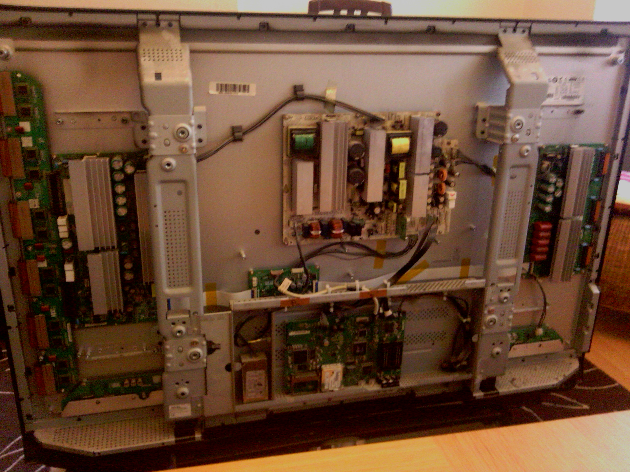

      Re: Philips 50pfp5532d - no picture but sound

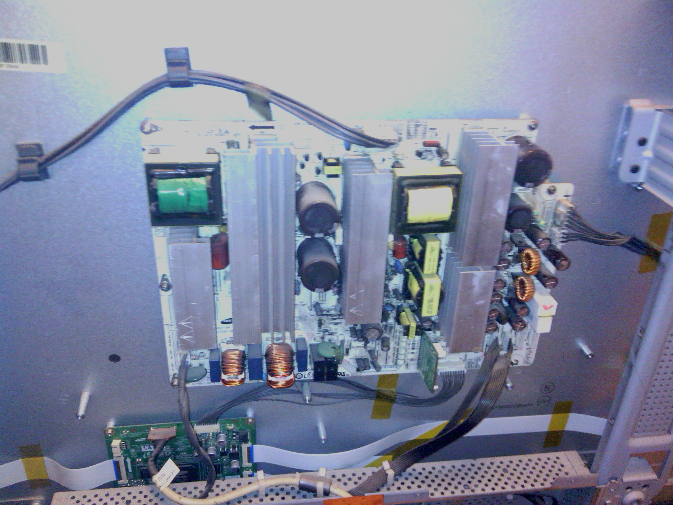

      I've taken a picture...this is what it looks like with the back off. Which component is which?
        Okay, I've checked fuses on the left and right boards, they seem to be okay.

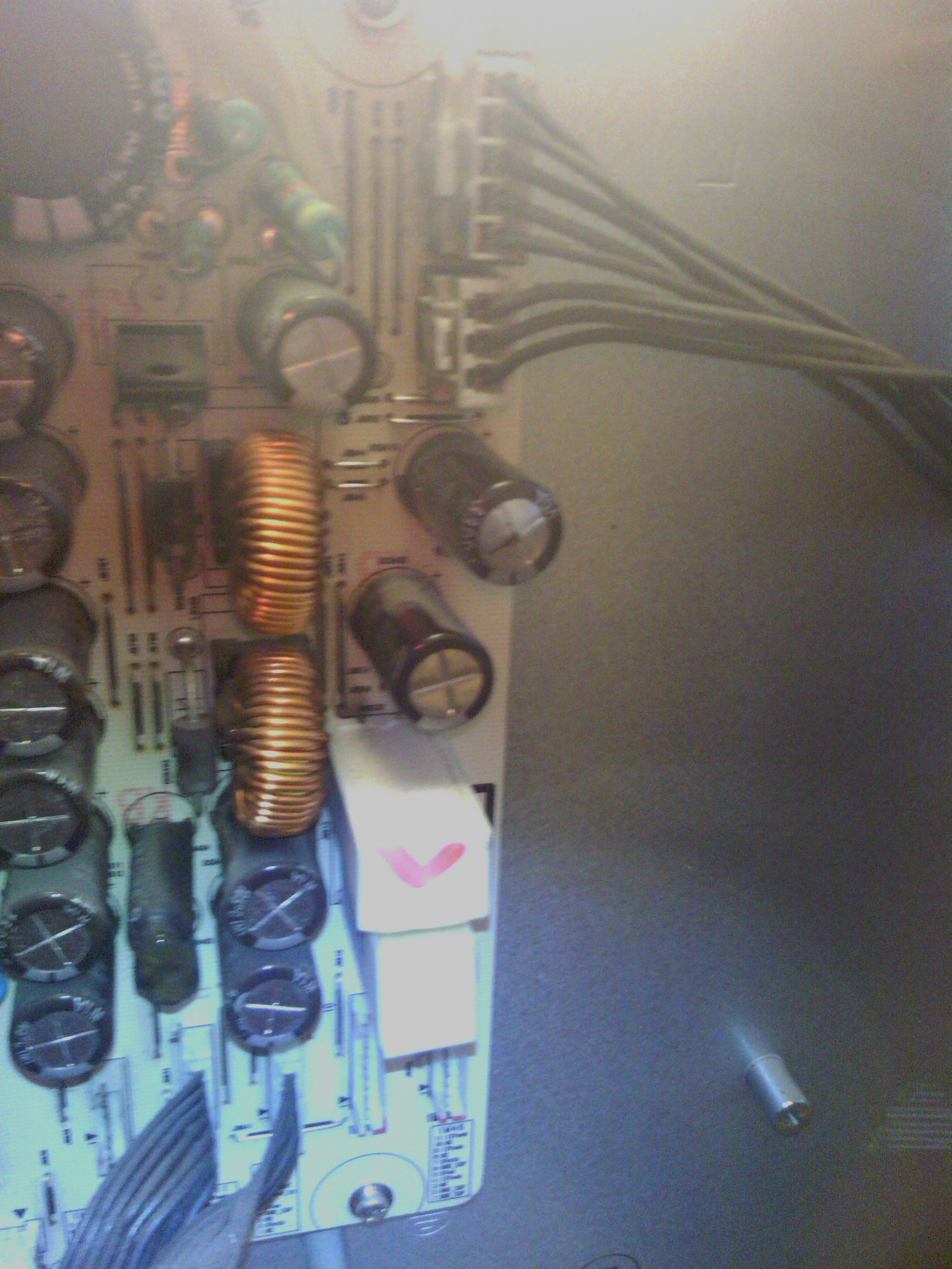

        The centre board, which looks like the PSU seems to have a blown capacitor. I've not had much experience identifying bad caps but this one seems pretty obvious...
        According to the specs it is a 10v 3300uF capacitor.
        Could a single capacitor be the cause of the loss of picture?

          Here's the capacitor in question, and a second picture zoomed out to give some perspective.
            Yes, that cap is blown. Is the cap next to it the same capacitance and voltage? If so, I'd change it at the same time. You may have other damage, so at least closely examine the board for burned components. A flashlight might be helpful.
            Edit: Once your PSU is functioning properly, and if you still have no picture, you can further isolate the issue to a possible sustain board problem.

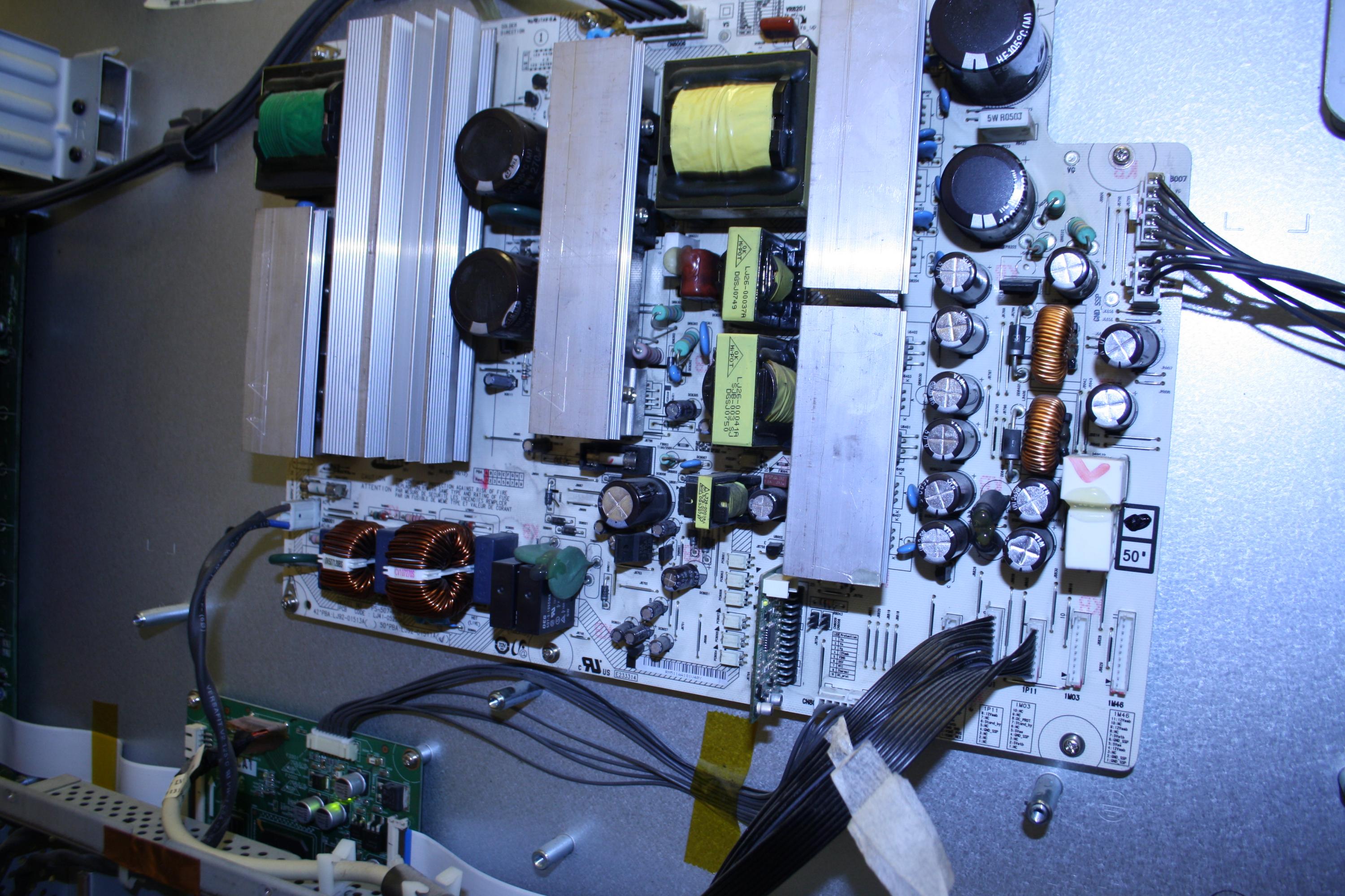

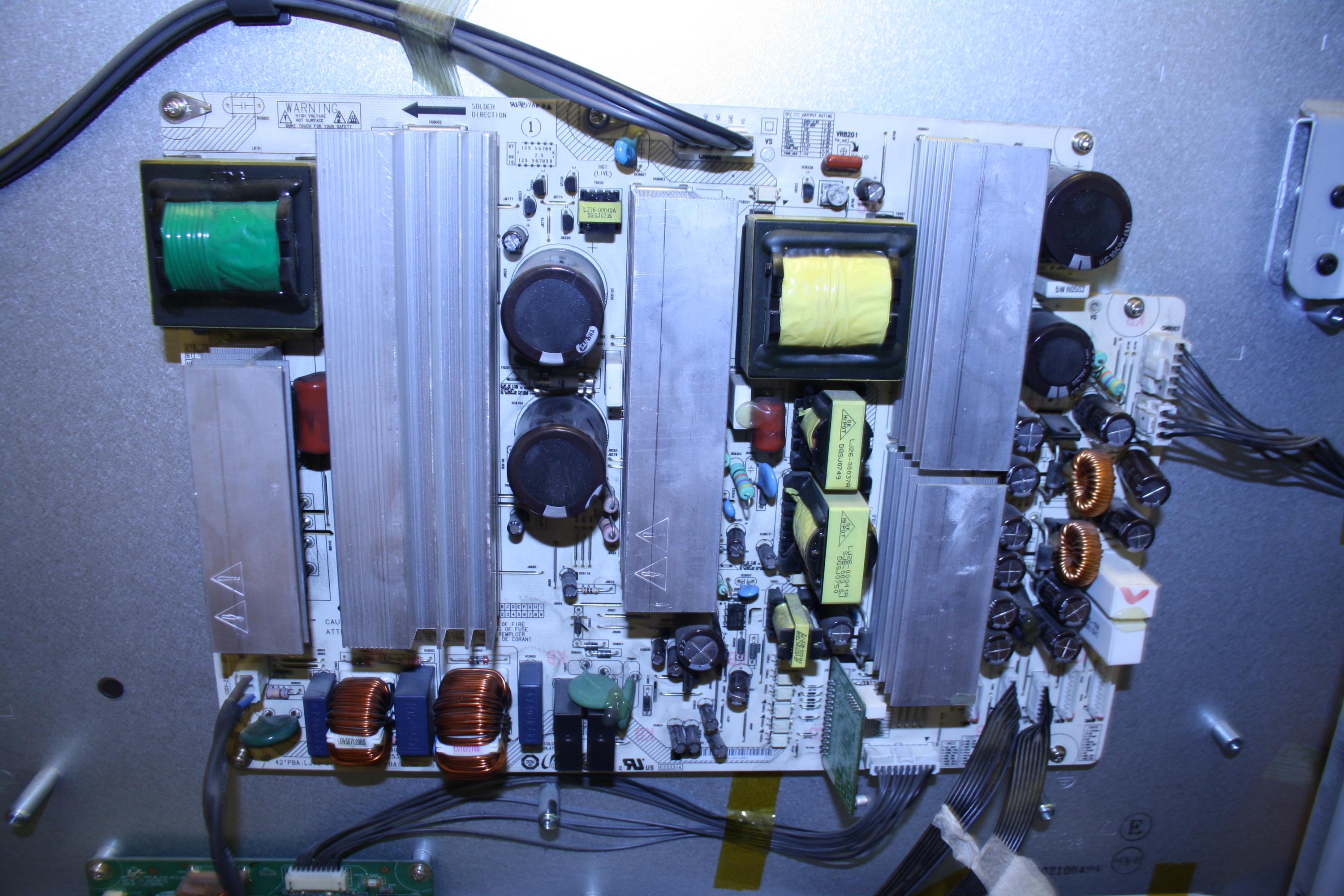

                              I had a good look at the board when I took it off and cleaned it. I couldn't see any signs of damage anywhere, although the coils looked very dusty...maybe there's a short in them?
                              The green LED is on the board bottom right of the PCB, just below the heat sink on the right. I used flash so you can't see it easily but it's just on, not flashing or anything.
                              I've taken pictures from a better quality camera. I can take pictures of specific if you want.
