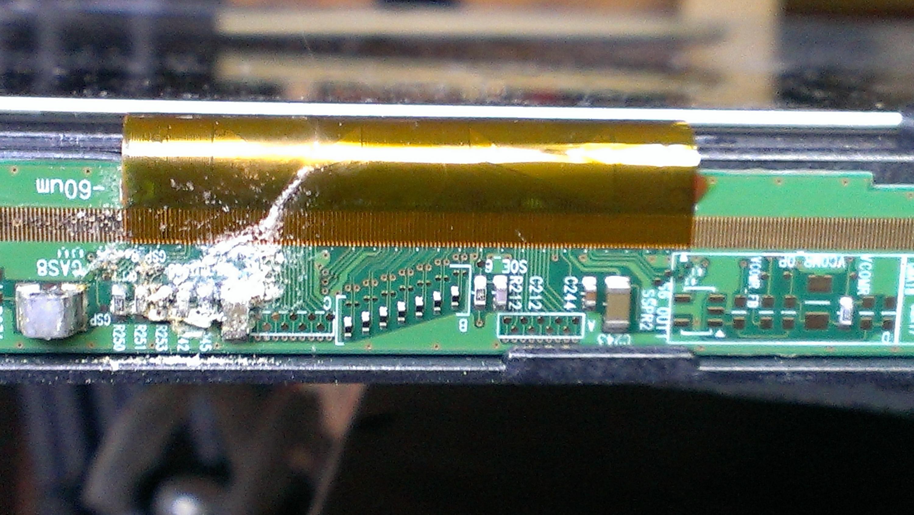

    Hey all, new to TV technical issues so I hope someone here can help narrow down the issue. A few nights ago my TV screen started going on the fritz. I have had the TV for about 2 years, has been pretty reliable so far. Its a Vizio , i know it's not the greatest brand in the world but I'm really happy with it so I am willing to invest a little bit of money if I need to. From the brief bit of research I did, I am suspecting a T-con board or ribbon issue. I have not opened the TV up to check the capacitors or anything yet, I will probably do that this weekend when i have more free time. Here is a link to the video that should help show the problem better than I could explain it. I appreciate any advice given, Thanks!

    Looks like a panel issue maybe bad tab bonds though I never seen one flicker like that.

        I haven't seen one flicker like that either but I'm going to agree with tab bonds as well due to the ghosting / distortion.

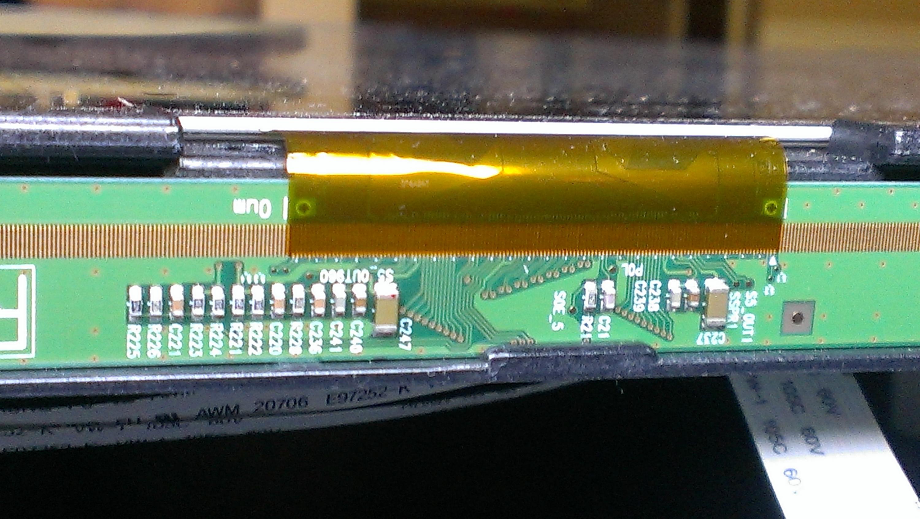

          Hey guys, got an update. Finally opened up the TV. I just now got down to the display panel and found what looks to be a fried set of transistors at the bottom left most side, the same side of the TV I am getting distortion. Here are a few pics to show the fried strip compared to a good strip. I am assuming at this point the TV is pretty much done at this point as I will most likely need a new display panel but I am hoping someone can give me some good news that won't cost too much. Thanks all.

            Someone spilt water on this TV, I doubt the damage will be fixable.
            You can try using isopropyl alcohol to clean it.

              Thank you so much, i will go get some of that alcohol and give it a shot.

                Tom66, thanks bro, you saved my TV. little bit of isopropyl alcohol did the trick when i thought all hope was lost, great advice my friend!

                  Well, I'm surprised. Enjoy your TV -- and keep water away from it! So many of these newer TVs killed by water damage due to tab bonds on the bottom of the LCD.
