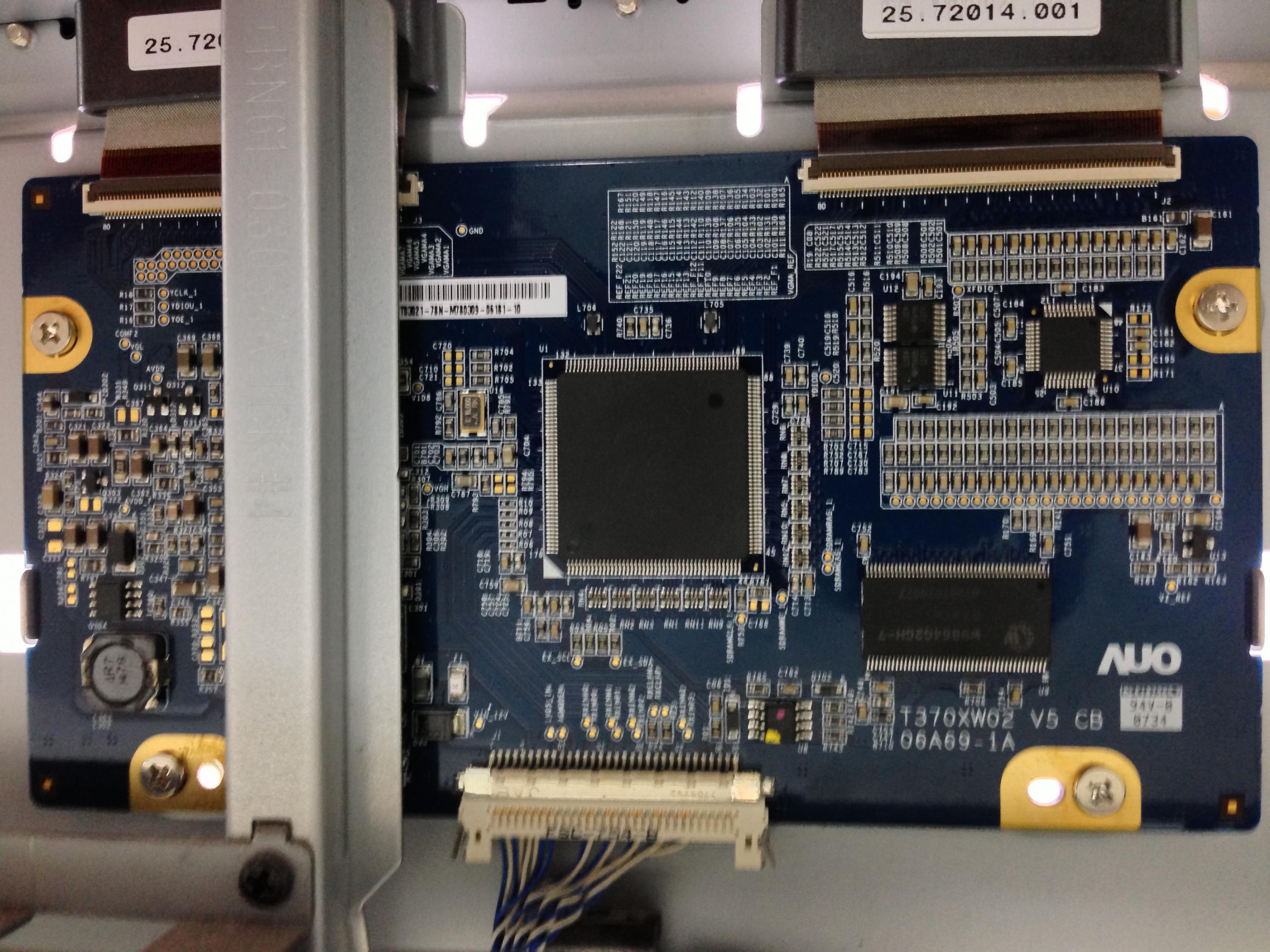

    Hi to all.
    pic ok but when calling menu or changing the pic the text stays for a few sec and then disapear.
    the t con boars is T37OXW02 C5.
    Can it be the as15f problem or its the panel.
    vgl -6v 3.3v 16v 1.8v 12v all voltage are ok.
    this tv was repair before 6 monthe by another tech and the custumer says that the same problem was before. .
    can see that one capi in the p.s was replace.
    need help willyam
    Re: samsung-la37r81b
    Check VGH. VGL seems low.
        They look OK.
        Can you post a picture of the T-con board?
                can a factory reset do something?
                  No. A factory reset probably won't help, but there's nothing stopping you trying. (In standby: Info Menu Mute Power then select "Reset" when TV powers on.)
                  Please post a picture of your T-con so AS15G can be tested.

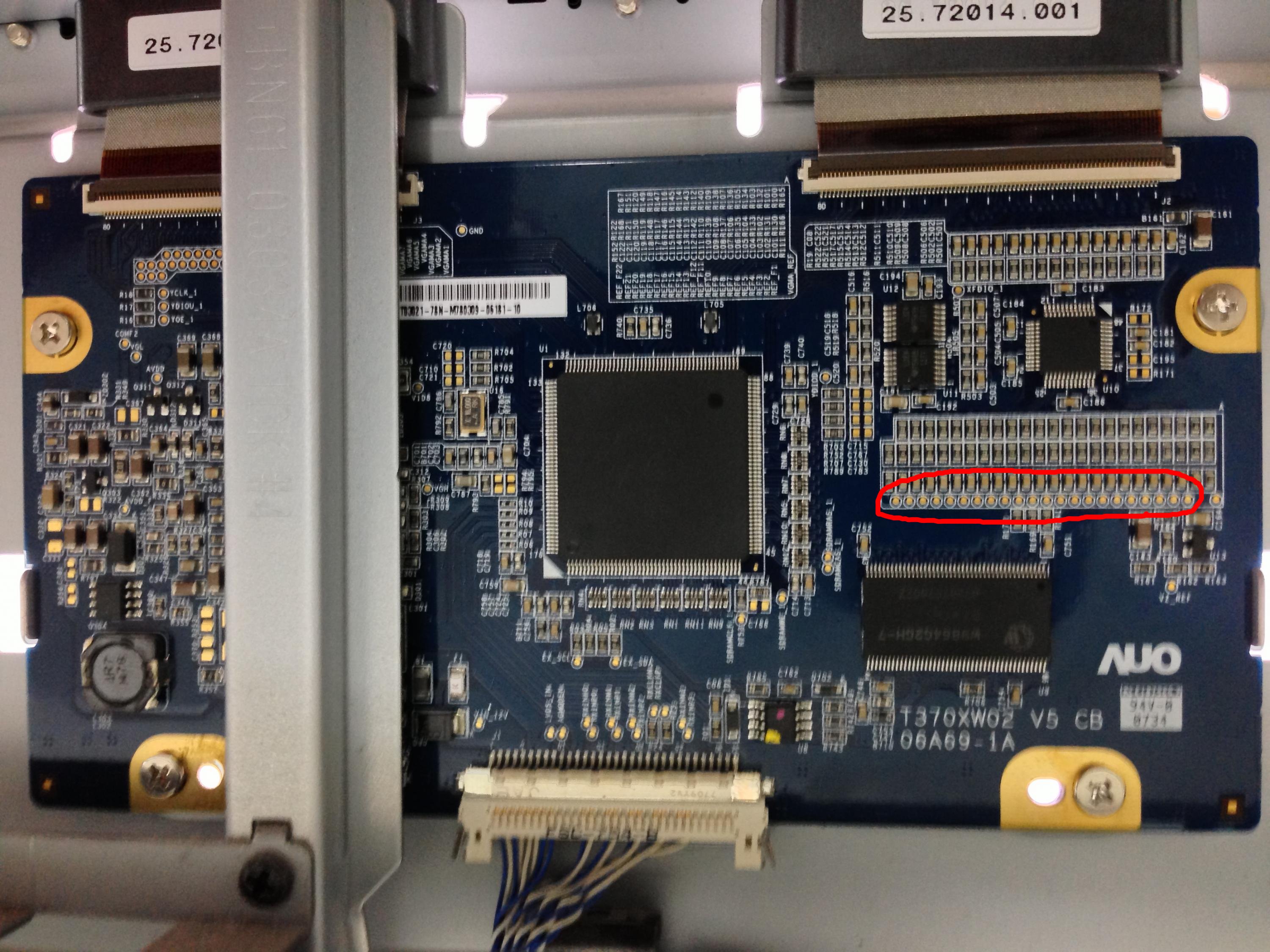

                    this is the tcon picture
                    • willyam1
                      • Feb 2012
                      • 112
                      • israel
                      factory reset no joy.
                        There are 22 gold pads here. They refer to VGMA1 thru VGMA22, from right to left. Check the voltage on each, with the red probe on the pad, and black probe on the chassis.
                          from right to left.
                          9.5v 8.54 8.26 8.10 7.9 7.8 7.6 7.57 6.94 6.8 7.3 7.5 9.6 9.8 10.11 10.3 10.9 11.87 13 15 15.5 15.5 sorry cancel it irs left to the right
                            right to the left.
                            15.5 15.5 15 13 11.87 10.9 10.3 10.11 9.8 9.6 7.5 7.3 6.8 6.94 7.57 7.6 7.8 7.9 8.00 8.26 8.54 9.5
                              The IC looks bad, I would consider replacing it.
                                DEAR TOME66
                                sorry for the late reply but which IC is look bad
                                  The AS15G.
                                    Tv is ok after replacing the ic as-15f
                                    thank tomm66
