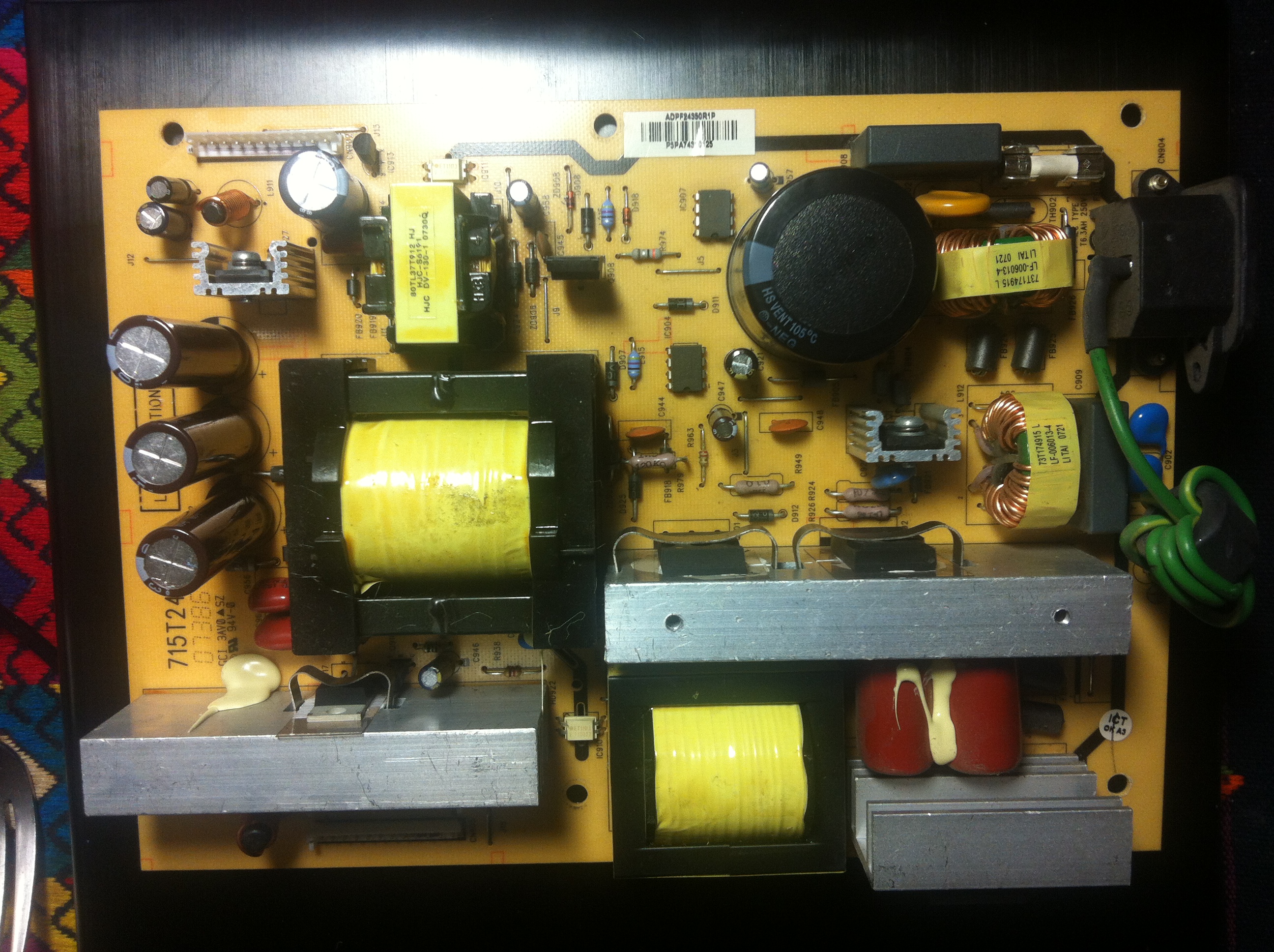

                  Sorry to resurrect an old thread, but my issue is on the same TV and I figured it better that all the info for future reference be in as few a places as possible.
                  I have the same TV, with power supply 715T2454-2 S/N 07386. It looks a bit different from the other ones I've seen pictured on various threads. For starters, the 3 tall caps at C952, C951, C953 were all PF nichicon caps, and the one at C955 was a VR series Nichicon. The soldering job looked sloppy so not sure if it was a repair job or a revision of sorts.
                  I had the chirping issue, and replaced the two zener diodes at ZD904 and ZD902 because they were burnt. I also replaced all the other caps (besides the 4 Nichicon and big 450V Capxon one) on the board with the same rating Panasonic or Nichicon ones.
                  The TV now works, but there is a very high pitched whine when it is plugged in, and slowly dissipates after it is unplugged.
                  I'd like to sell this TV, but don't want to sell something that might crap out. What else can I replace to make this thing bulletproof?

                      I have a a 37" lc370wx1 and when i got it i it would turn off and on i open up and found someone replaced the 2200uf 45v cap badly i resoldier it and it work for about 10 minutes then quit again the power light stayed green and ever 15 secods the inverter board would ight the screen flicker then shut off. i replaced all the caps on the board execept the 45v 2.2uf still the same thing so i replaced that cap with a 2.2uf 450 v cap and now it doesn't flicker but the inverter board still light up every 15 seconds and power light still solid green the board is like the first picture posted on page one.

                        I know this is a old thread but I have a 47mf437B/37 replace the four caps and still have chirping and no power. which diodes should i replace?

                          Re: Magnavox LCD 37mf437/37 chirping
                          See my post (#28) just a few above yours. I detail what I replaced to get it working pretty well. Still had a bit of a high pitched whine, but it got better with time.
