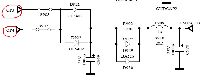

    Got this tv, the audio works fine for about 30minutes then cuts off, the psu
    17pw25-4
    the main
    17mb60-4.1
    What I have noticed is when the audio is working the backlights are very slightly flickering, when the audio packs up the B/L's stop flickering.
    I am getting confused with the 2 schematics for both the psu and main
    On the psu's connector block pin 26 says +24VAUD, is this for the audio? And should I check the components that drive this..I dont seem to be getting 24v when the audio is working or not
    On the Main Board Schematics it references 3.3v & 5v the 3.3v being HP-Detect...oh and the headphones dont work either when the sound goes.
    Could someone just have a quick look at the schematics and tell me if it is 24v that drives the audio, or any other pointers

      24AUD would be audio.

            There is no 24VAUD when the sound goes, Can you tell me what OP3, OP4 and what will S907 S908 relate too
            Sorry forgot to add when the sound is working it raises from 25-27.3v then dies
              Re: Toshiba 32BV701B loss of audio
              OP: transformer outputs (trace to other arrow with OP on it, will be near transformer... just a stupid way of drawing it because they fit everything onto one or two pages.)
              Sxxx: Jumper links in the board (kind of nice of them to do that as can be helpful in tracing the circuit out, but I wish they'd draw the diagrams better...!)
              I'd investigate L908, check it's not intermittent or cracked.

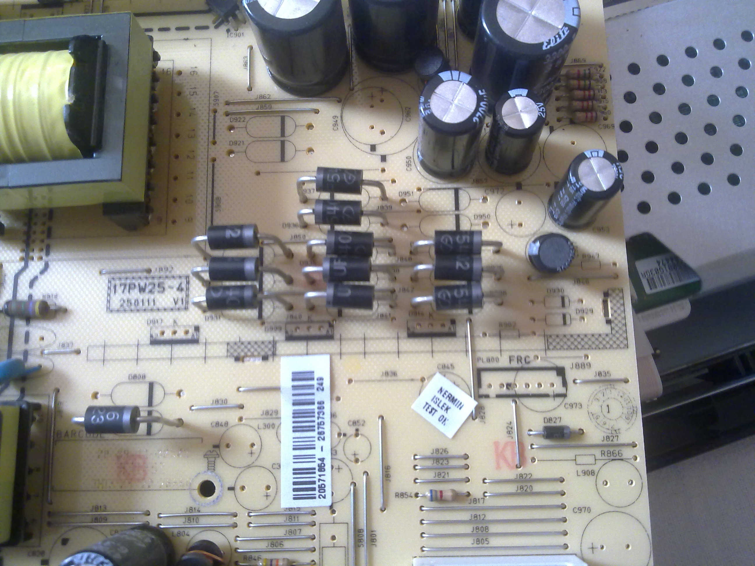

                Grrrr vestel, all the components on the schematic are not on the board
                ie
                D921, D922, D930, D929 C969, C970 are all labelled on the schematics around the 24VAUD but not there.
                The pw24 seems to be the worst for revisions and changes as I have about 3 faulty ones and they are all different

                  There is no L908 in the board either

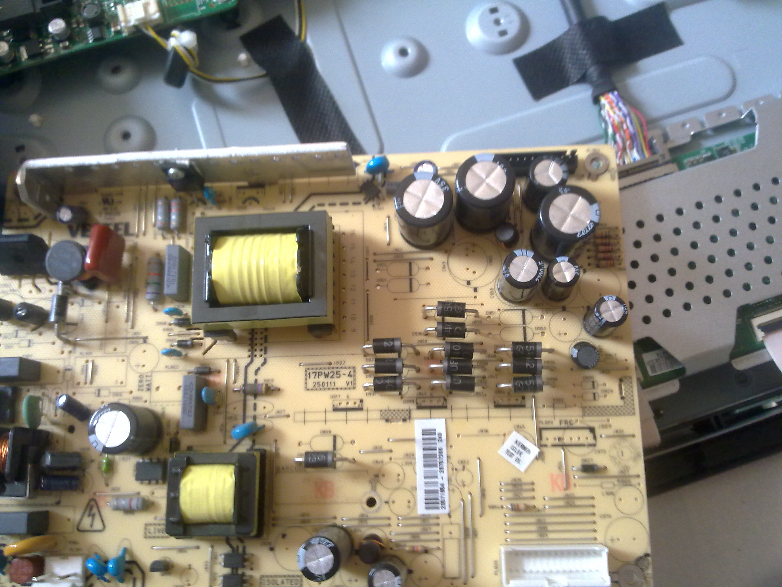

                    What suffix board do you have?
                    Pic of board area?
                    24AUD maybe connected to +24V?

                      I must of made a mistake with the sound working or not working there is no 24v at pin 26

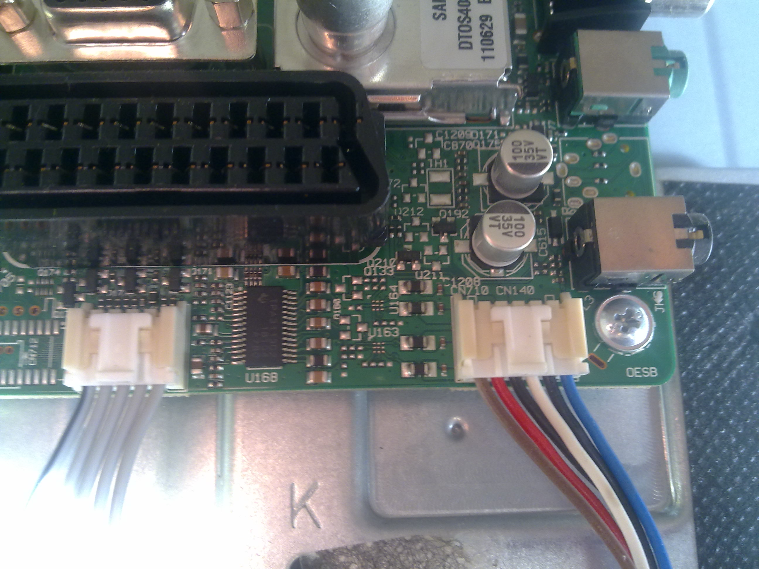

                        I looked at 17MB60 and the audio is powered by the 12V on this so check the 12V supply is good.

                            Pic of main b/d around amplifier chip then please (TPA3113)
                            • signup
                              • May 2013
                              • 189
                              Here you go
                                OK, locate pin #1 on the device. Directly below it is pin 2. Can you see if the pin has a trace coming off it? Try measuring the voltage on it while it is working and when it fails. I'm expecting around 5V in operation, and 0V when failed.

                                  I cannot get the tv to come on with sound at the minute, but off pin 2 is 0.03v
                                    OK with the set switched ON with no audio what do you get?
                                    • signup
                                      • May 2013
                                      • 189
                                      0.03v
                                        OK when it starts working measure it. If it is still 0.03V they do not use that pin. At that point you will need to get an oscilloscope to trace through the audio signals.
