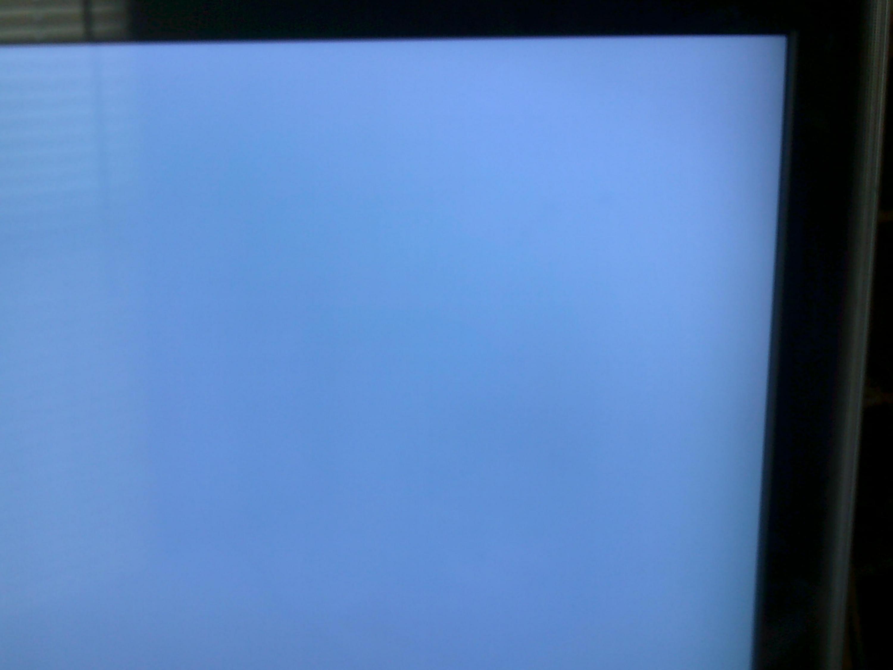

    This tv seems to have issues. This is the same tv I replaced the screen on, and had tab bond and ribbon cable issues.
    It was working fine for a few weeks, then one day it didn't have pic when turned on.
    Voltages seem good at all connections.
    It looks like pic below.

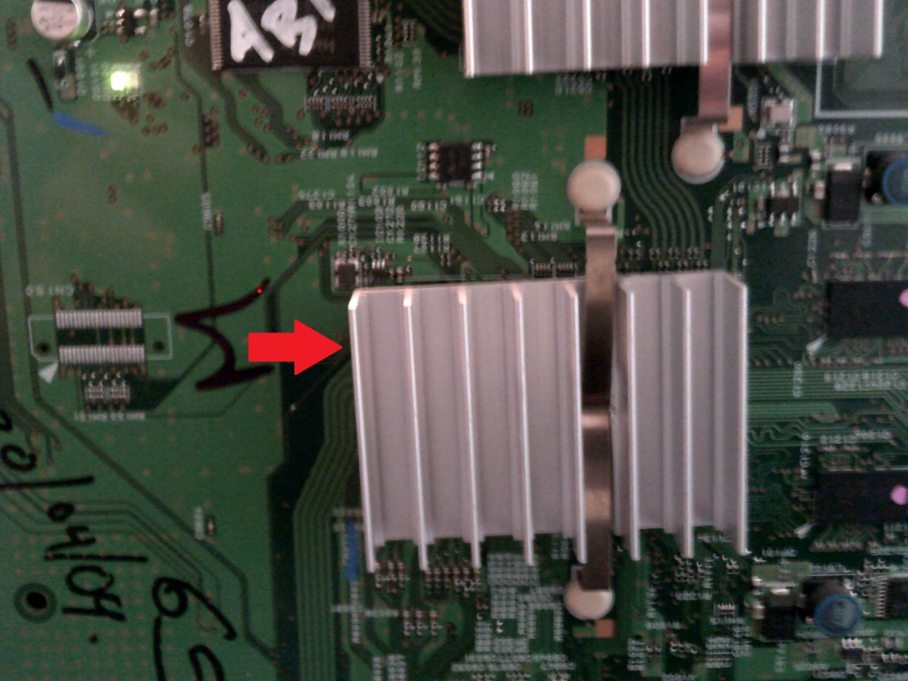

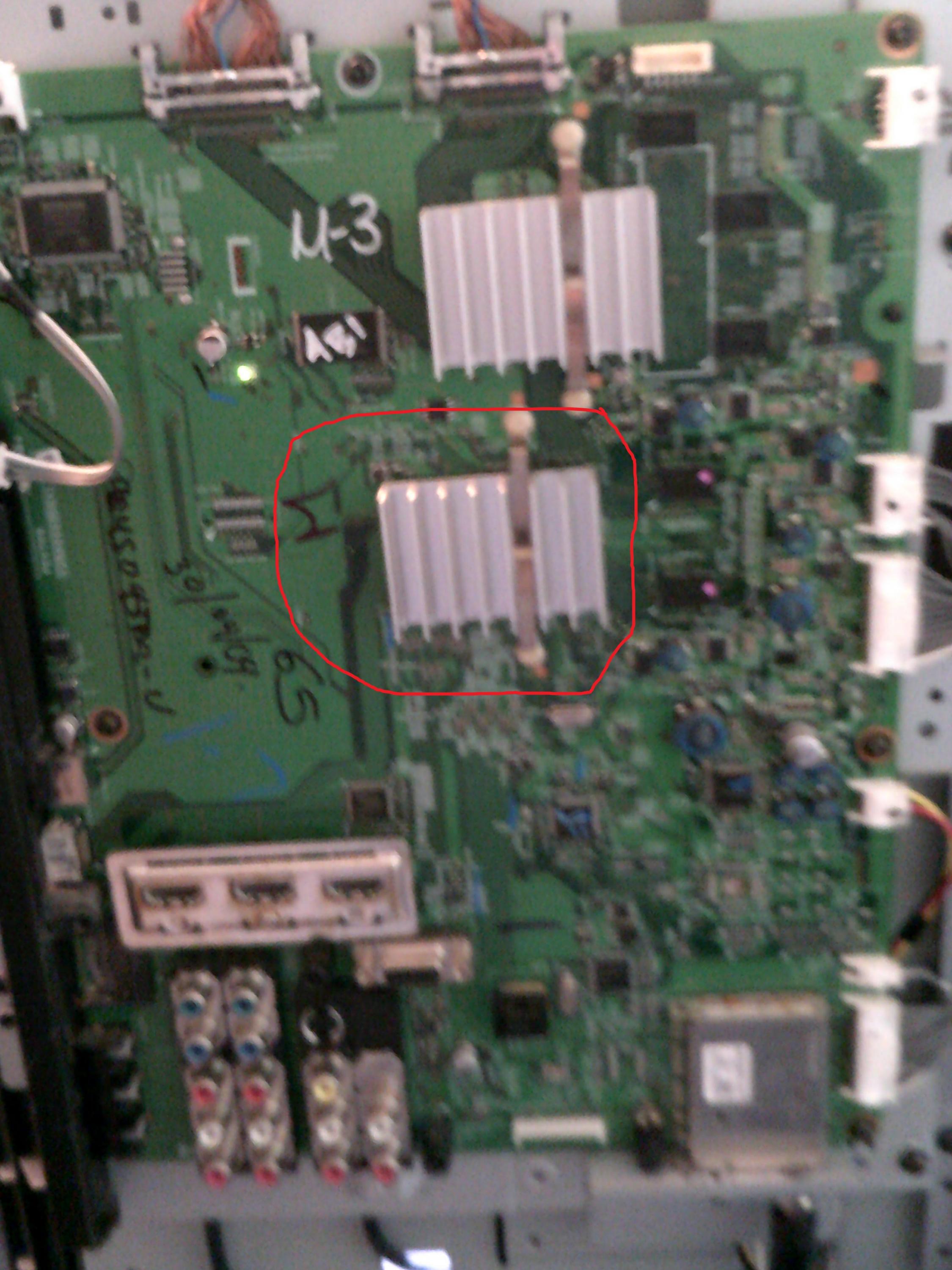

    I ran cold air along t-con and main board. when I hit the heat sink (marked on pics) with cold air the tv shutdown and restarted. Does this indicate a fault? It did not shutdown when I sprayed the other heat sink or any other part of main board or t-con.
    I also hear a slight buzz around t-con board and it is getting 12.03vdc.
    mainboard>75015873 http://www.shopjimmy.com/toshiba-750...main-board.htm
    substitute> 75015471
    substitute> 75015470

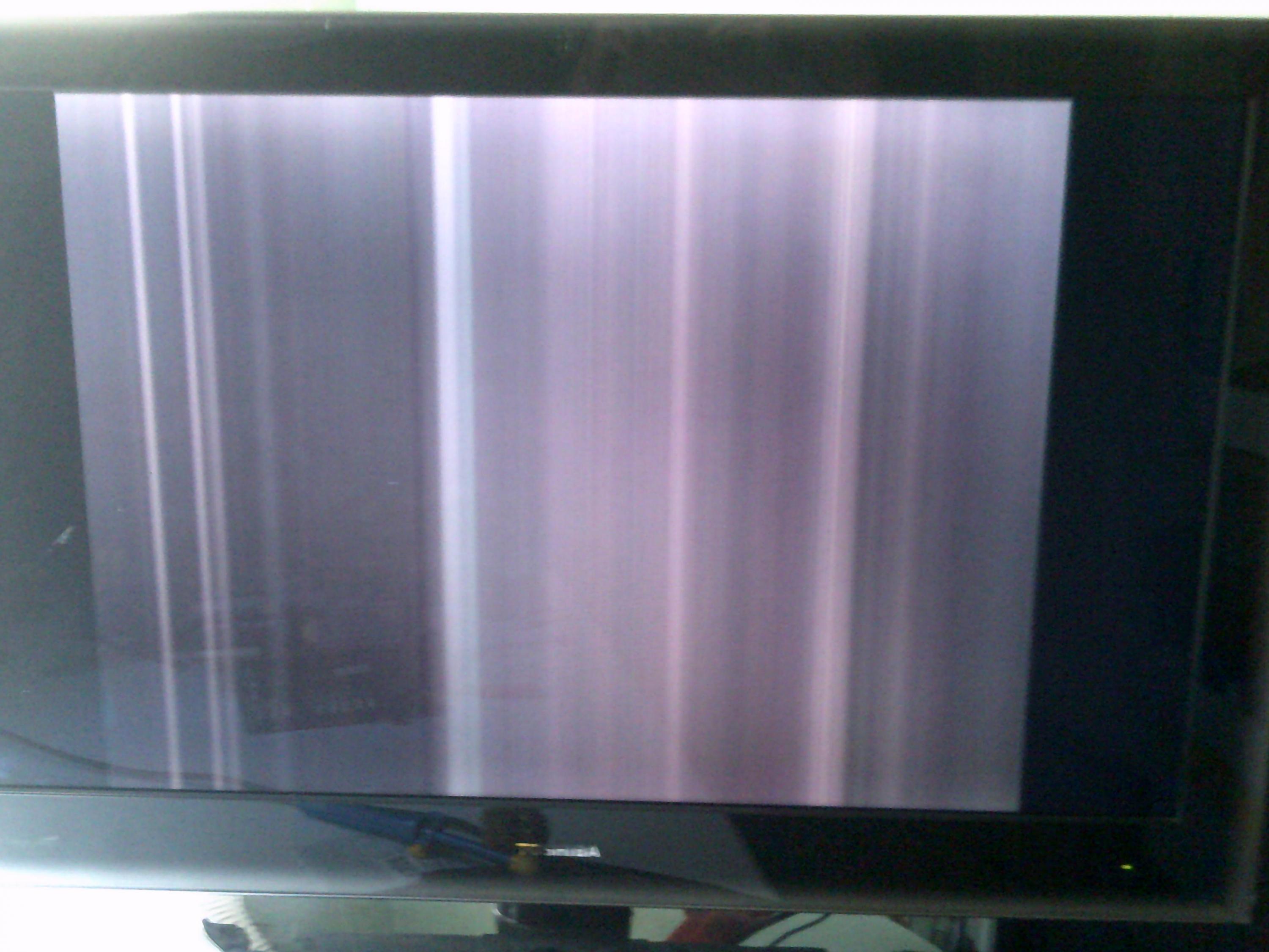

    After playing with inputs some more the tv has sound and vertical lines that move left and right. Iam thinking t-con but not sure.

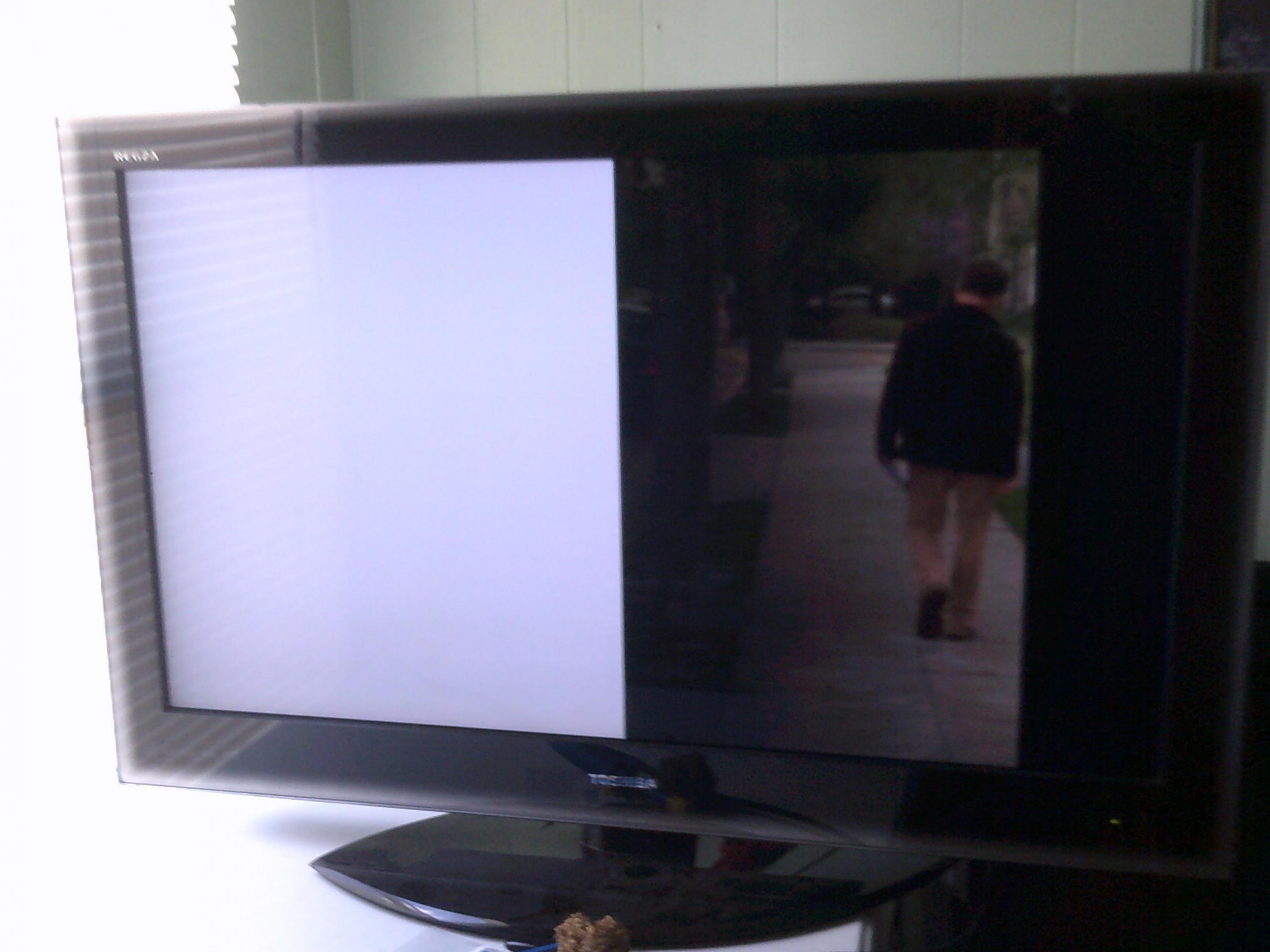

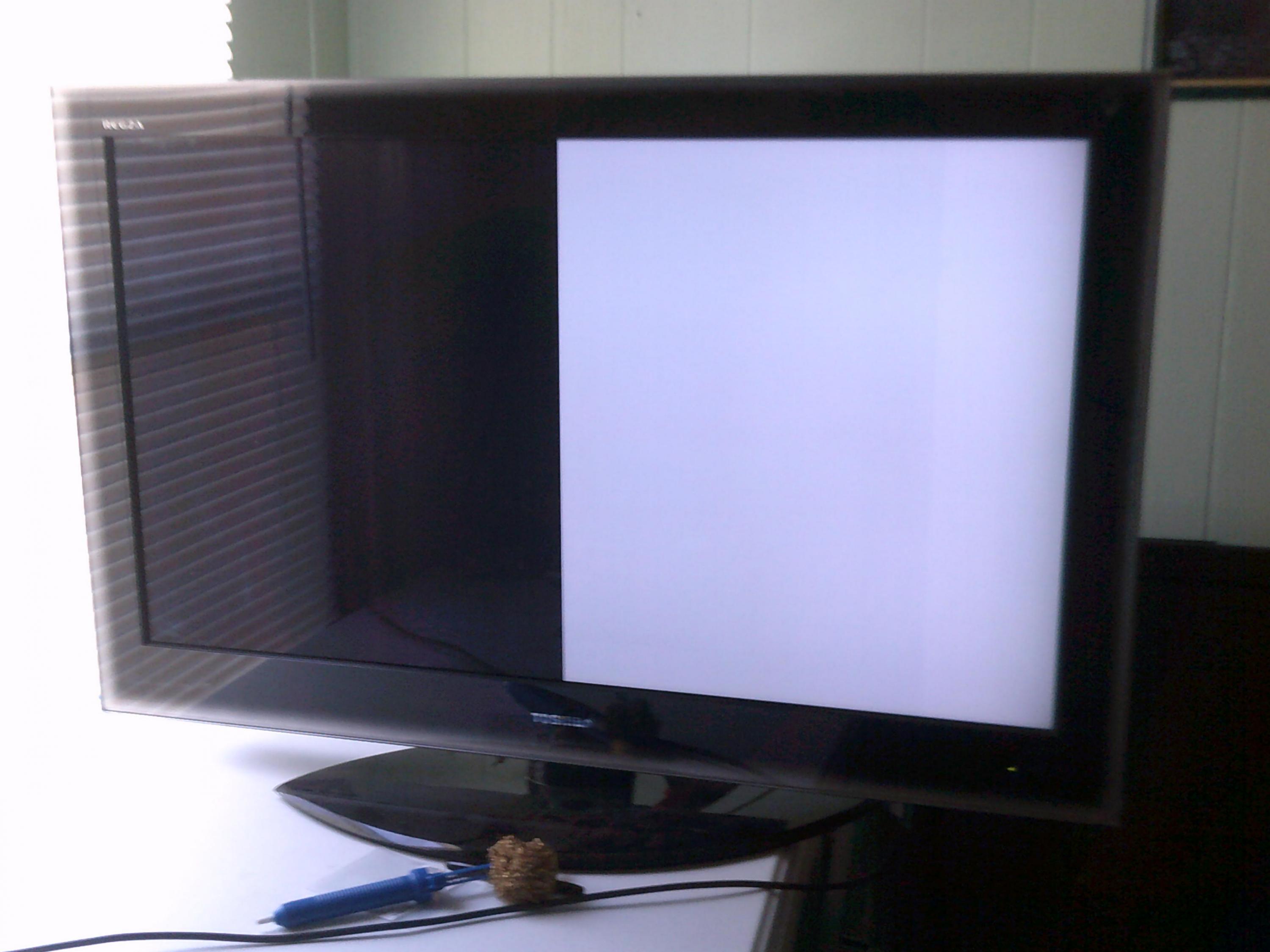

    Edit: disconnected ribbon cables from t-con to buffer boards one at a time. pic came back when disconnecting right buffer(see last 2 pics).
    99% sure it is t-con but I suppose it could be the buffer board also.

      It wasn't t-con....
      I replaced t-con and had no picture instead of the moving lines.
      All I seem to get now is what you see in post 2. Panel probly went out. not sure if ill try a main board.
