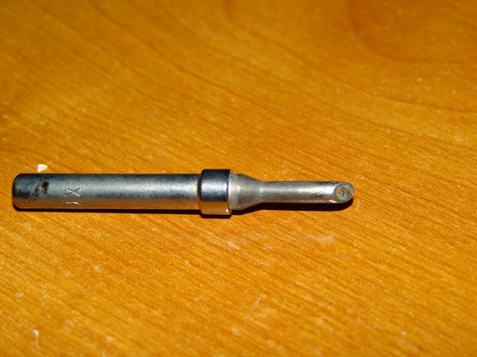

    I've included a pic of the tip I use for my Xytronic iron. It has a well on the end to hold a small amount of solder. A chisel tip should work fine, also. I sometimes intentionally bridge the first three pins of a side then I use that bridged solder to drag along pins on that side so that I can control how much solder is applied; you don't want too much solder or you'll create a mess. When you drag solder, you drag lightly along the "ankles" of the pins, not the feet. Also, liquid flux is your friend. You don't want to work dry. The one thing I like about the well tip is that you can suck up bridges into the well.

      I couldn't order the solder tips in time, so I hacked the old cheapo iron with a solid tip. Using 150 grit sandpaper, the tip was grounded down to a bevel style and used a small drill bit to scratch some form of a "well" in the middle. Although it didn't resemble any sort of a well, the scratches were enough to hold a small amount of solder. It worked. Also, a great deal of practice using different combinations of a heat gun, paste, and solder in trying to get a consistent result so only one attempt was made on the final "chip". I mean, like all of Friday night, and a good part of Saturday, before finding the right method I felt confident in. Perhaps this way others may find it useful instead of going out and buying an expensive hot-air station or waiting for the right tip to arrive. So far, one outside pin was off track, and I was able to get it right. The right soldering tip is the way to go. Of course a hot air station would be nice, but the cost wasn't justified in replacing one or two chips. Now to replacing the FET's, fuse and the caps. But that will have to wait for until tomorrow.

        Nice work. I have a hot air station, but I prefer to drag solder with an iron instead of using the station.
