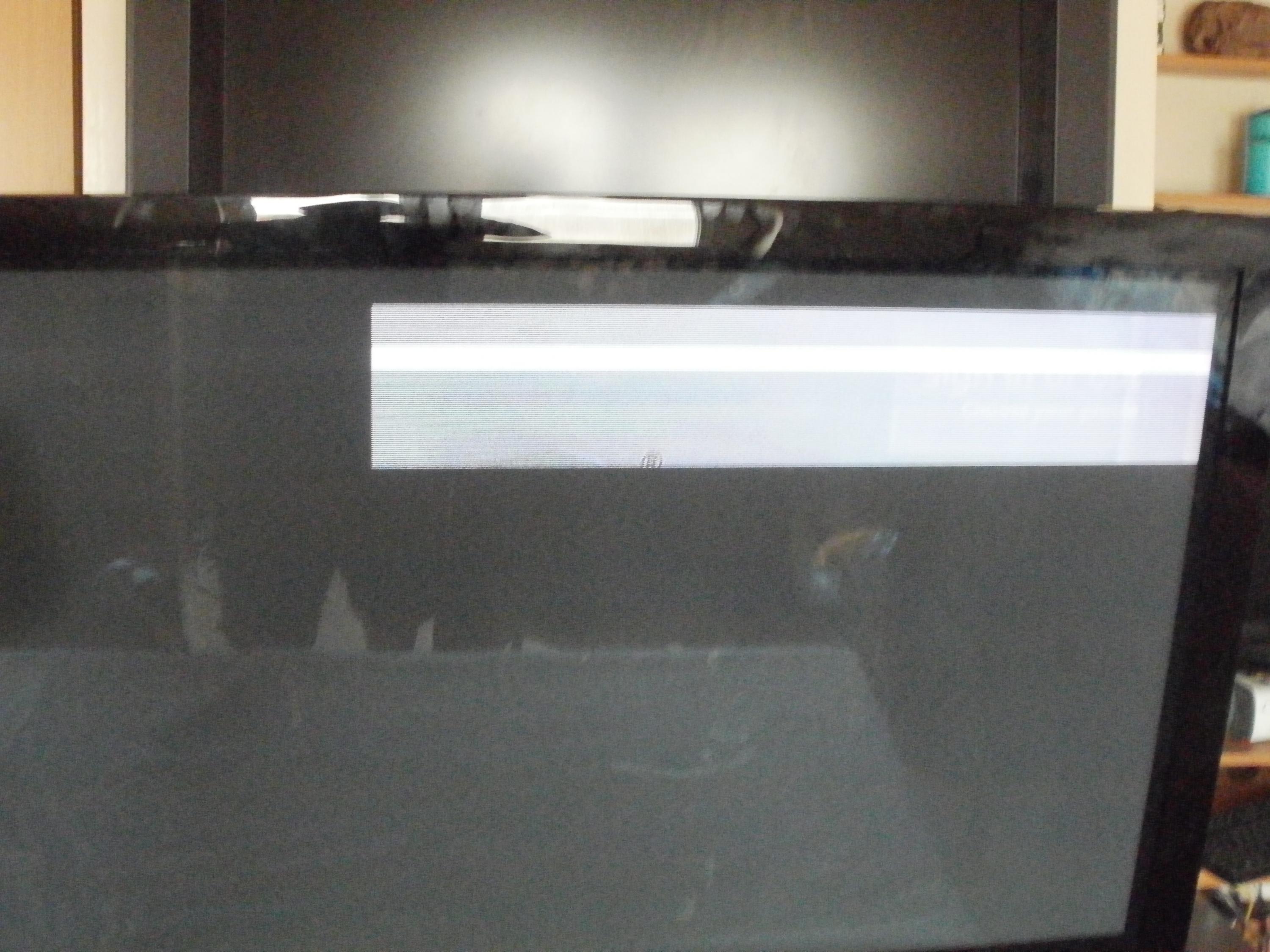

    Hi there
    can someone please advise me of what to look for with regard to this lg plasma tv.there is sound when i plug my xbox into it using the hdmi port just no picture at all.
    ill just let you know what simple tests ive tried so far (im not an electronics expert)
    1.. i have replaced the ysus board
    2.. i left the set switched on for 20 mins. then unplugged. then felt the heatsinks on the y and zsus boards(with the power off and unplugged) all were still cold.
    3.. only two of the heatsinks on the power supply board were warm the others were cold.
    4..looked at the screen in complete darkness there is no glow to the screen
    5. the power light is on front of tv is green .
    6. there is also a click from a relay on the powerboard,when pressing power button on from standby.
    i hope its not the panel thats gone.
    thanks for your time.

    Your panel is most likely ok.
    - Have you checked the voltage output from the power supply to the Y-Sus and Z-Sus?
    - Are there any blown fuses on the Y-Sus or Z-Sus?
    - Was your replacement Y-Sus new or used?
    Pics of your chassis would be helpful.
    Edit: This thread may also be useful: https://www.badcaps.net/forum/showthread.php?t=18892

      Re: LG50pg3000 no picture just sound
      thanks for your response
      i have
      checked the voltages vs=191v,,,va==64v on ysus board
      all fuses checked ok
      i have disconnected top buffer still no picture
      diosconnected bottom buffer and get sort of a picture in the top half of screen,but has lines in it.
        Bottom buffer possibly at fault then.

            ok heres the update.
            its not good,i bought all 3 boards ysus board, top and bottom buffers,switched on and got a full screen of picture but had lines through it.i then swiched off and unplugged as i was going to reseat the ribbon cables,switched on again and no picture at all.
            think im just about giving up on this.
            thanks shaun.

              - Did you do anything to the TV (ie. adjust ribbon cables or detach and reattach connectors) between the time that you turned it off then turned it back on and got no picture?
              - Were the lines you saw horizontal or vertical?
              - Do you still have sound?
              - Did you try removing either of the buffers?
              - Did you recheck your voltages, including Y-Sus generated voltages?

                hi there
                all i did was to disconnect and reconnect the ribbon cables that go to the buffers,this was after power was switched off.
                the lines were very thin horizontal black lines.
                i still have sound.
                i tried removing one buffer then the other,but get a blank screen.
                the voltages on the ysus board are vs-191volts and va-65volts.
                thanks again
                shaun.

                  What are your Vscan and -Vy voltages on the Y-Sus? Any blown fuses?

                          hi again guys,
                          i checked the voltages they are as follows.with the buffers attached the voltage goes up to around 50v then drops off to the following.
                          vscan=0v
                          vy=0v
                          but if i unplug both buffer boards the voltages are as follows.
                          vscan=135v
                          vy=195v
                          im only guessing but does it look like its fried the two new bufferboards.
                          thanks for your patience.
                          shaun.
                              It looks like your buffers are bad as your voltages drop when they are connected.
                              Buffers removed from cracked screen TVs often are bad.
                              http://www.youtube.com/watch?v=51SZsfH60EY

                                thanks tom i tested the buffers as the video shows ,sure enough both are showing bad,the only thing i dont understand is why i got a full picture on screen when i first used them.
                                ps when i installed the replacement buffers i also installed a replacement ysus board at the same time but all three parts were used and not new.
                                  just a thought, but a bad y sus could have burned out the y buffers. Did you get all 3 from the same seller? I assume you got them on ebay.
                                  so possibly the buffers were good until they got hooked up then a bad y sus fried them.
                                  just shooting in the dark here, but I have had this happen to me.

                                        It sounds like your Y-Sus is fine.
                                        Did you try re-installing your original top buffer and disconnecting one of the bad bottom buffers? It's a little risky, since you could fry your old top buffer, but it might give you a better idea as to the health of your replacement Y-Sus. I always have my hand on the power cord when I'm testing plasma picture issues, just in case I notice something "funky", so I can pull power right away and possibly avoid damage.
