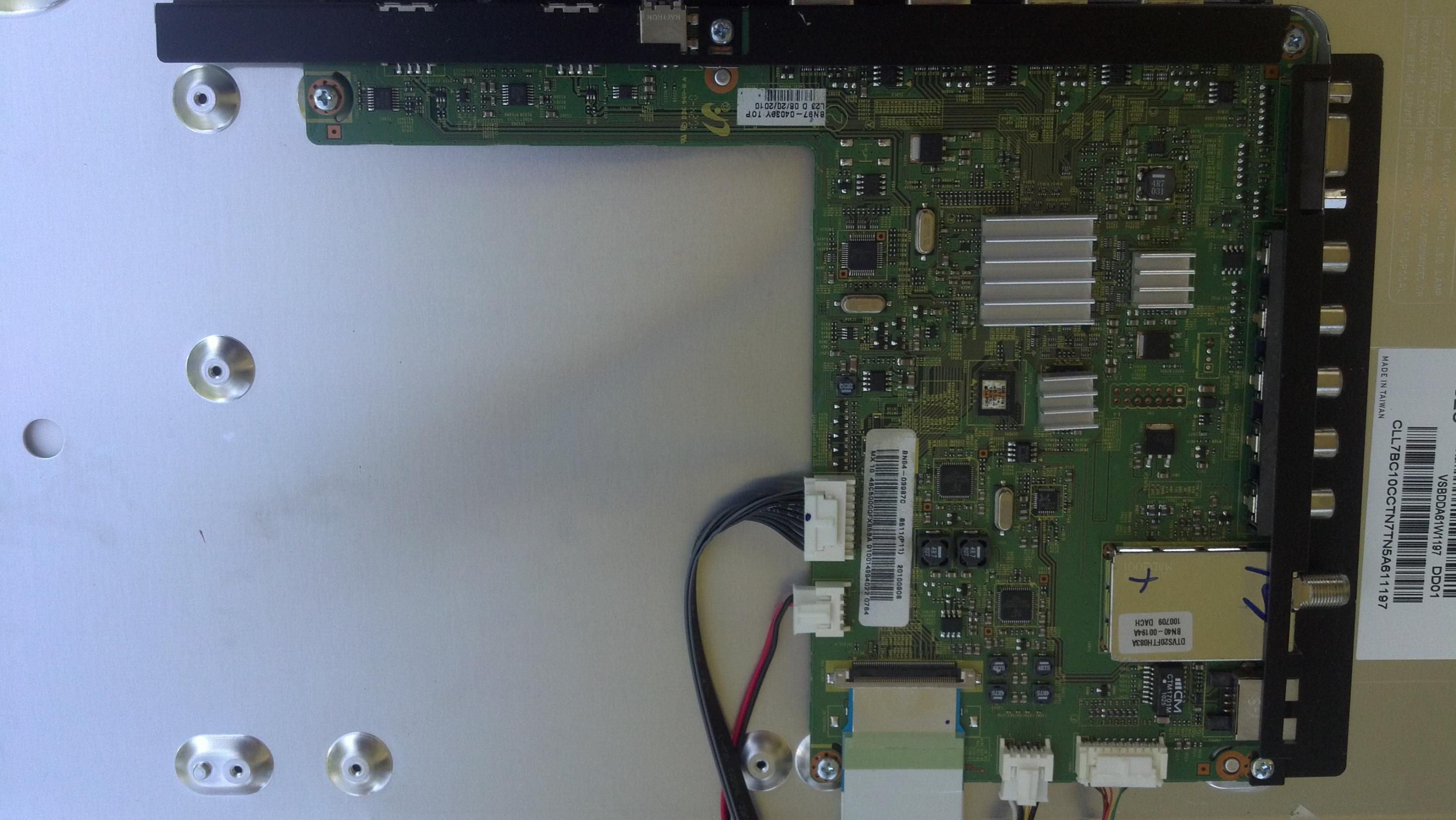

    Hi Guys,
    Hope you can help with my issue, I can use a meter and soldiering is not an issue.

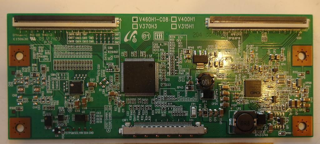

    I have a Samsung UN46C5000QF that has sound and no picture. I have attached a picture of the T Con board and the backlight working. If you need anymore pictures let me know

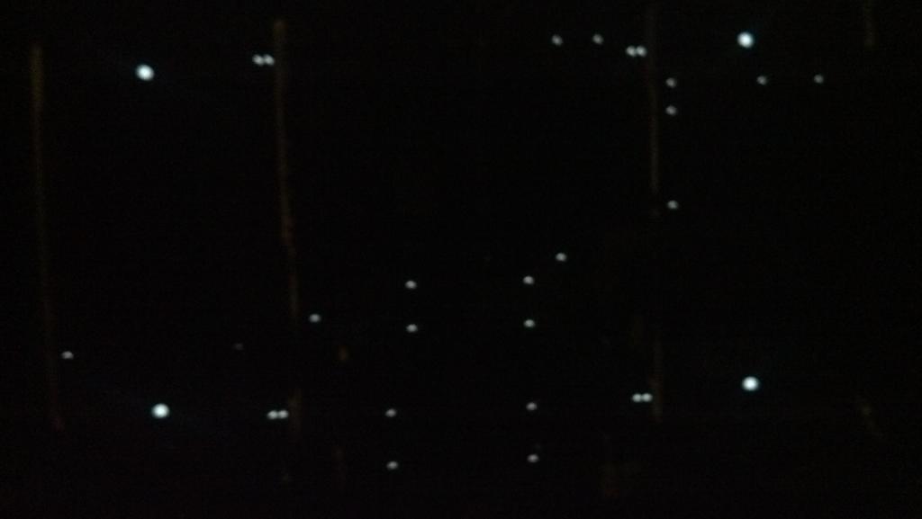

    I turned the TV off this morning when I left for work this morning and it was working fine & when I got home this afternoon I turned it on like normal and it makes the Samsung Boot Noise and i can hear the sound from the cable box or the xbox360. I can't see anything but i can turn it up and switch inputs.

    FP1 fuse it's good?

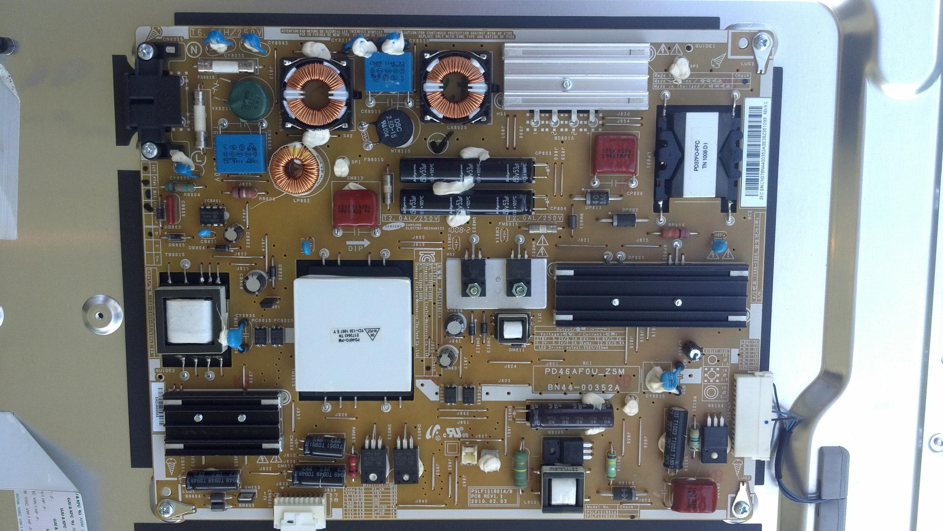

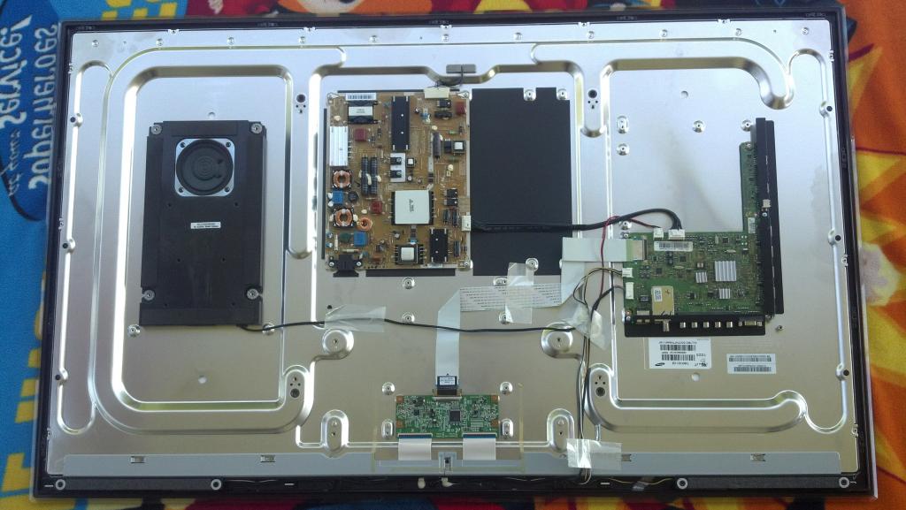

      I have attached a few more pics for you.
      Please help if you have anymore ideas, which board do you think is causing the issue?

          Re: Samsung UN46C5000QF (No Picture - Sound Working - Backlight Working)
          Unplug T-con and see if red light stays on.
              You're getting sound continuously, I missed that. I'd swap the T-con, if not, it may be a panel problem. Unlikely, though not impossible, to be a main board issue.
                  Swap t-con in first; if that fails, then swap in the main board, if it works, you know t-con was the only problem.
