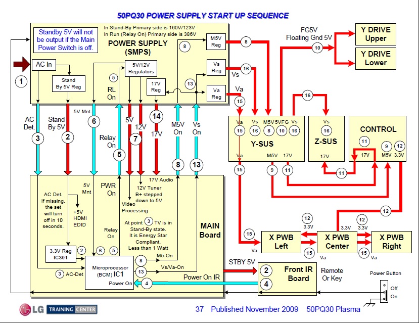

              Re: LG 50PX4R-ZB stuck in standby mode
              HELP NEEDED PLEASE !!!

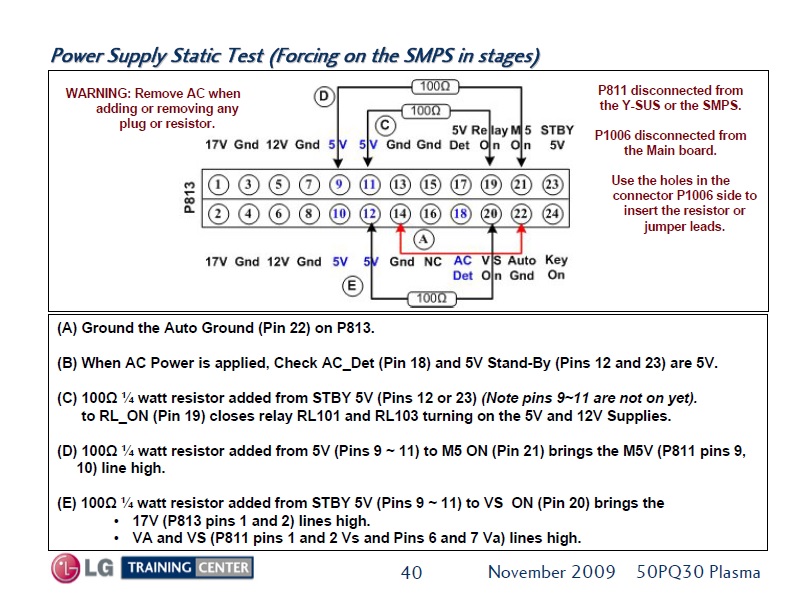

              I have just found a diagram which shows me that AC DET goes from the power supply to the main board I have tested and have 4.3 volts going from it BUT not 5v ??
              The diagram then tells me that the main board processor then switches the VS ON but if no AC DET the tv will turn off ?? well this is whats happening but the main board is getting AC DET 4.3v ???
              The diagram also says that I can force the VS ON by putting a 100 ohm resistor across STBY 5V and VS ON
              Will this get my TV working ???
              Thanks again for help I am literally tearing my hair out !!!
                  Originally posted by tom66
                  4.3V is fine for an AC detect circuit. Below 2V is generally considered bad.
                  Hi Tom
                  As mentioned I am a newb but I have looked at the manual for the power start up sequence which ive attached.
                  1. AC in PSU yes
                  2.STBY5V out to main board Yes
                  3.AC DET to main board Yes
                  4.power to front IR board Yes
                  5. RL ON (relay on 5v to PSU Yes
                  6. 5V MNT from PSU NO
                  Could this be the Problem ????
                  If I linked the 5v STBY to 5v MON and Vs ON could this in effect make the TV work ??

                    #89
                    sorry forgot to attach the picture !!

                            What about if I link the 5v to 5V MONI this might then trigger the VS ON ???
                            I will keep looking for the manual but its not looking good
                              #94
                              I don't think so; why do you think that will work?
                              It looks to me like your main board has a problem meaning it won't power up for some reason or another.
                              Even if you do jumper VS ON etc what do you intend to achieve? The PDP may glow (if the control board works), but will still not display any image, because the main board will not be sending it one.

                                          #100
                                          The force starting procedure is only used to get the power supply to fire up; not to get the TV to work. By force starting it, you can see if the voltages Vs, Va etc come up.
